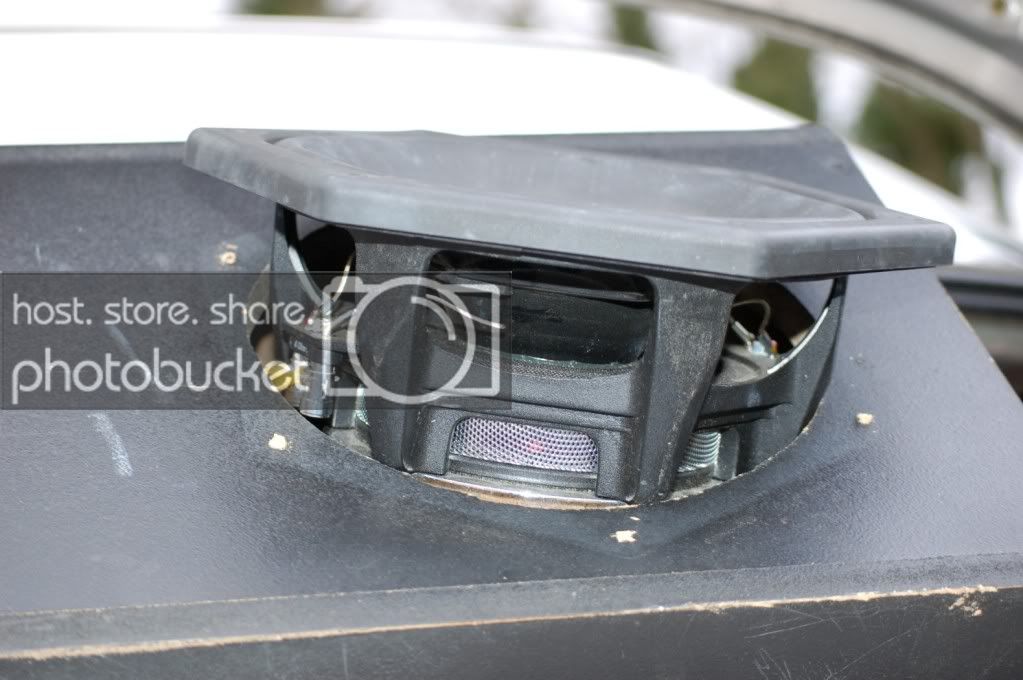

can this be fixed?
MasonSmitty
Sorry, my first sub here....
Xtant 1044...
what is that silver thing called? It separated from the woofer...what would be the best way to reattach it?
imo thats a much better replacement.
tinsels usually break from over excursion or just plain old age and lots of use.
if you go the re se way, build or have someone build the right box for it.
imo thats a much better replacement.tinsels usually break from over excursion or just plain old age and lots of use.
This was a custom box. 2.0cf tuned to 30hz. Really played the lows on this sub. Not as much punch as my previous Type-R, but pretty close. How would the RE SE 10" do with this box? Or should I have another built...something smaller?
