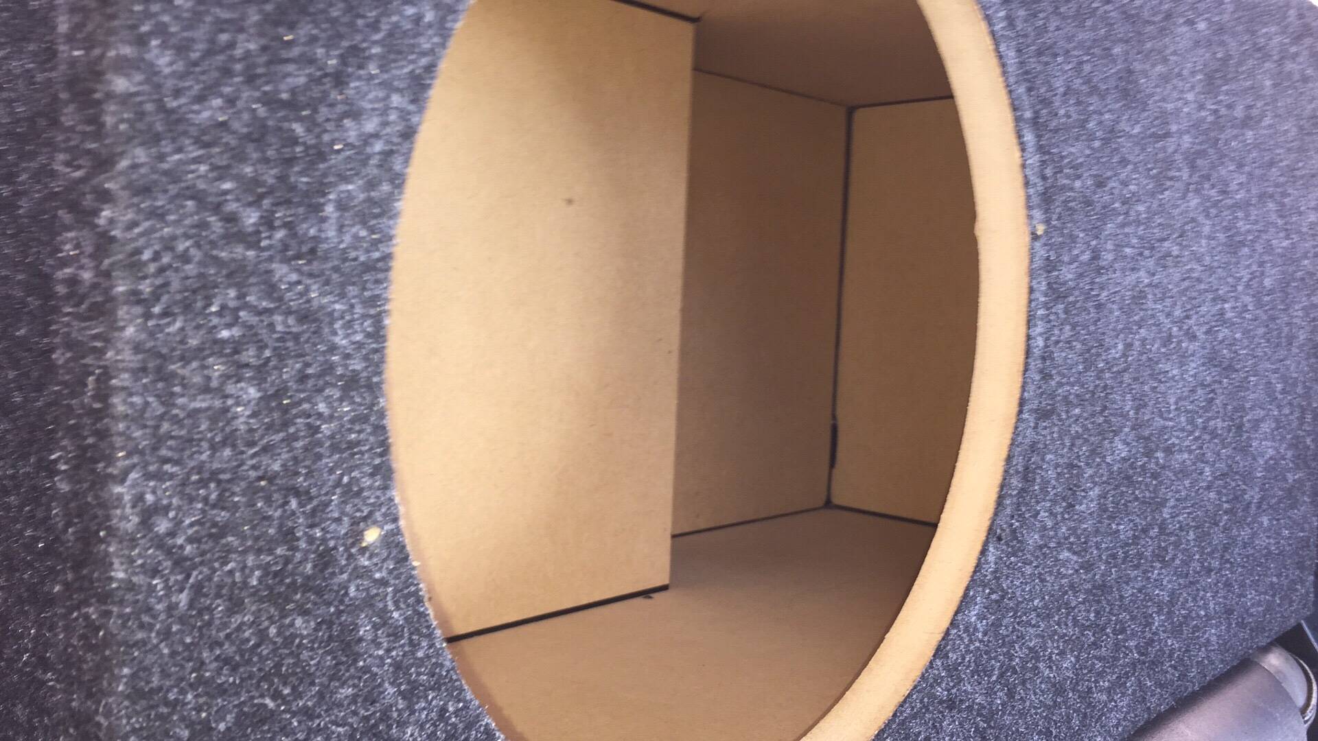

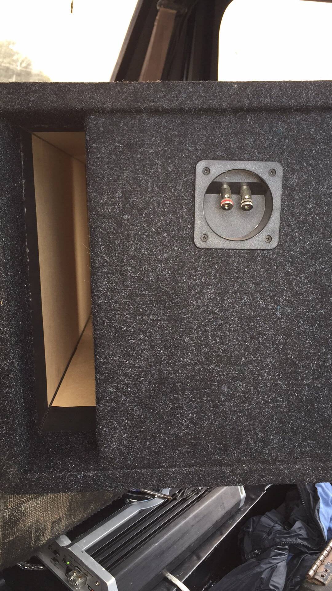

I have an atrend 12lsv box it is 2.5 cu ft tuned to 43hz and i was wondering If i could modify the port from the inside to lower it to around 33hz?
An already built box-
Decrease port area or length port.
Do not decrease internal volume (minus adding port length) or it will raise tuning.
Note that if shrinking port area, shrinking it too low can cause chuffing with a loss of SPL if it happens.
