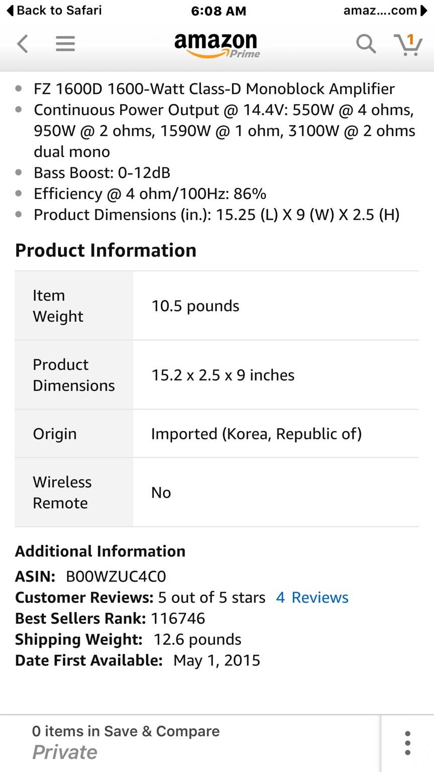

Can I power 2 sundown SA 12"a with this amp?
What's this 3100 mono @ 2 ohm ? Yet, 950 @ 2 ohm ?

You seriously are confused right now man. Go back and read the description properly. IDK where you are getting 1590 watts at 2 ohms.
550 @ 4 ohms
950 @ 2 ohms
1590 @ 1 ohms
When you have two amps strapped its
3100 @ 2 ohms BUT if you wire to a 2 ohm load, each amp will basically see 1 ohm each due to being strapped. the amps will not actually be at 2 ohms.
IF you wire to two ohms you will only see 950 watts. With the fsd 1600, you'll want to wire to half ohm. 0.5 ohms Dont be a fucking pussy about it, the amps will handle it.
You seriously are confused right now man. Go back and read the description properly550 @ 4 ohms
950 @ 2 ohms
1590 @ 1 ohms
