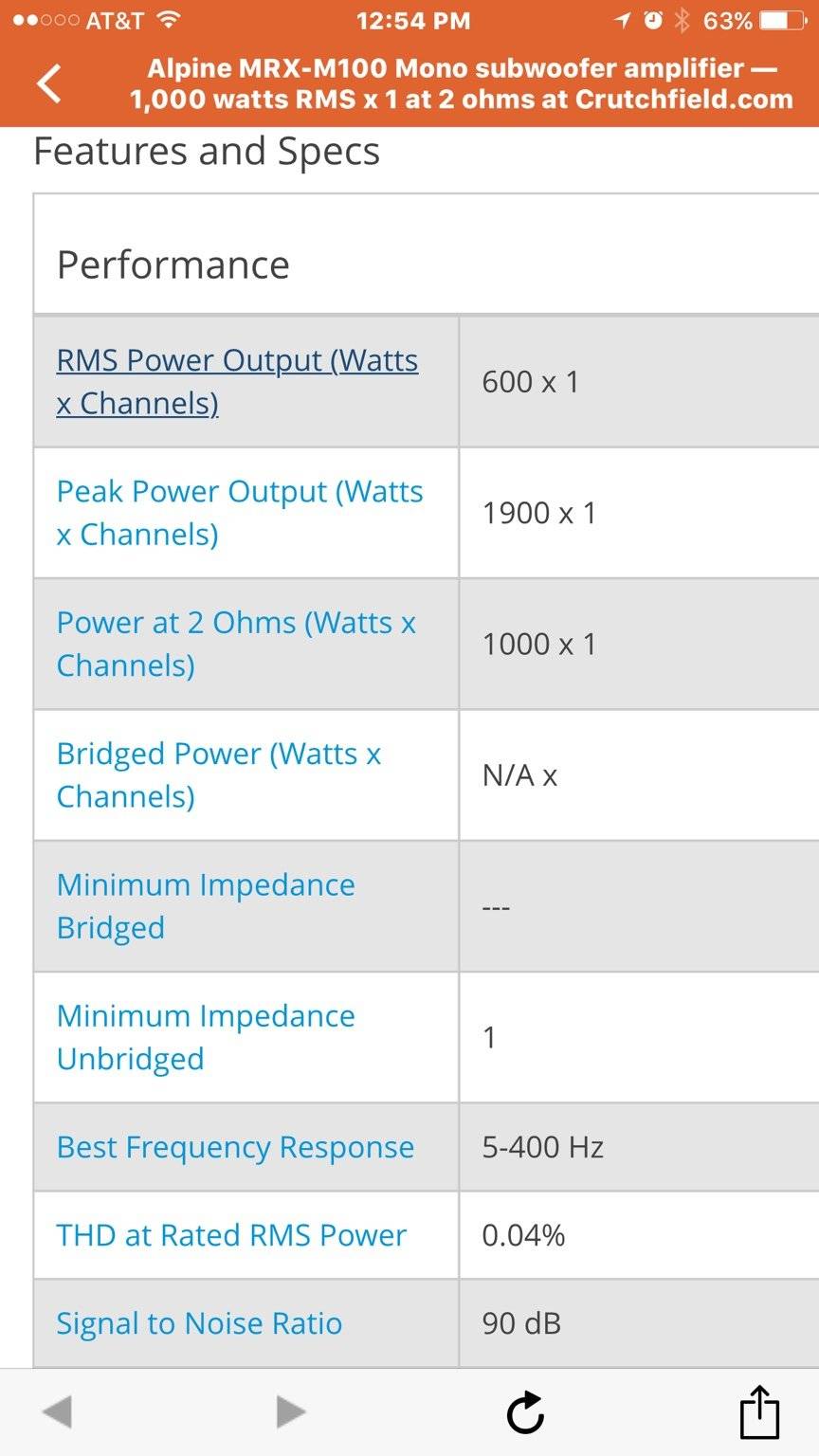

I have a alpine mrx-m100 amp and am wondering if I could decently power 2 sundowns SA 12"s with it .
Alpine MRX-M100 Mono subwoofer amplifier — 1,000 watts RMS x 1 at 2 ohms at Crutchfield.com
http://www.alpine-europe.com/index.php?id=1339&L=2&href=x-power-amplifiers2787/mrx-m100&level_num=product
When I checked resistance on one sub it read one ohm. They each have their own terminals which I will have to combine with a single channel monoblock. Will this change to 2 ohms when I combine ? It seems to be 1000 rms at 2 ohms and 1900 peak and at 750 rms X 2 = 1500 rms I feel I will push the amp. Think I'll be ok ?

If I wire the subs to 2 ohms I will only get 950 on this amp. The alpine will give me 1000 at 2 ohms - unless I wire to 1 ohm 1 can get more. Can I get these subs to 1 ohm though ?

What reliable website has this amp ? I did call alpine to question the capabilities of the MRX-M100 and they actually told it would handle the sundowns at 750 rms each = 1500. Not sure what my next move should be ....
If you have 2 dual 2 ohm subs, each one is wired in parallel to 1 ohm each. Wire the two subs in series and be at 2 ohm total and use the alpine.
That alpine is plenty of power to get them sounding good.
If you get a larger amp you will need to do some more upgrading like 1/0awg wire a second battery or even a high output alternator.
Use the alpine and see how you like it. The sa's get plenty loud off little power
