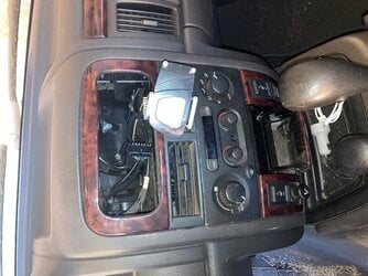

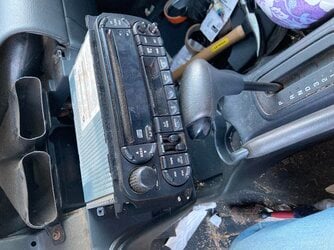

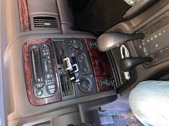

Last input of the day: Jeep Cherokee 1995 still has cassette. My aunty’s Cherokee but my brother owns the whole show. So I pulled the radio out just now. See pictures. Jeep grand Cherokee 4 wheel drive. Pop out lever on the radio. A little bigger than the pioneer
