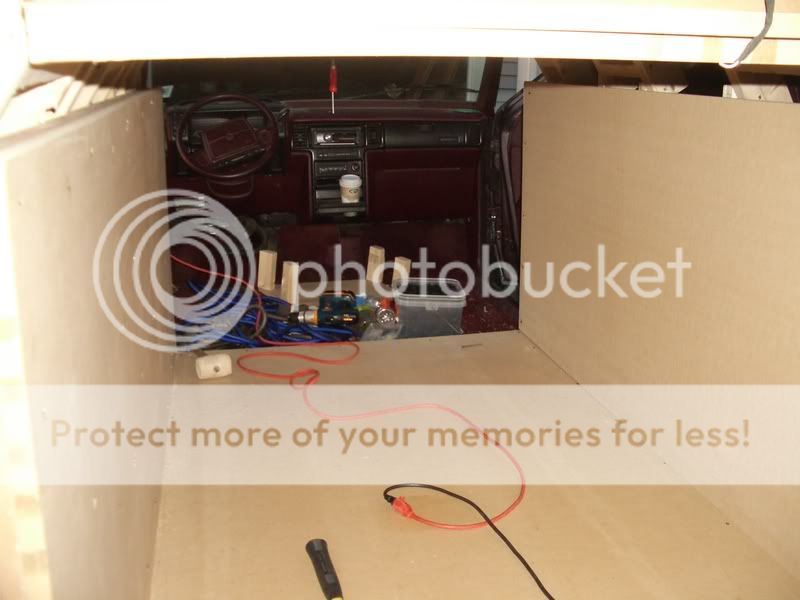

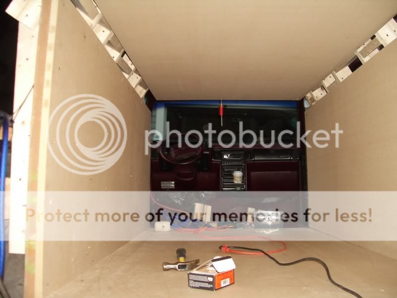

All layers on every wall are finally in and done!
Next is the corners. I think Im going to layer that with 1/4 mdf or plywood to get it perfectly flush. I cant use 3/4 there.
After that, comes making the adjustable back sliding wall.

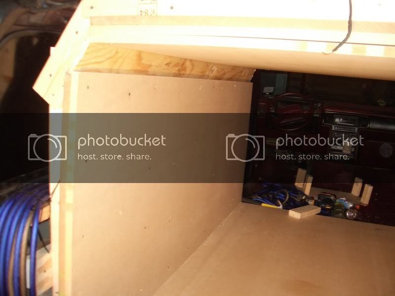

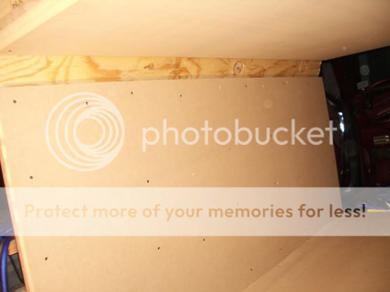

First layer of one corner piece in.
Im glad I made the first layer on the sides slightly taller than the other two.
The piece slides right down (well hammered down anyway) the channel to make a very tight and strong fit.
Ill get another layer in, and then eventually everything will be kitty haired for a smooth and better fit.
I know its plywood and not mdf, but there are 2x4 braces every six inches. Its very very strong.
More screws, more glue, and whatever you do...do not offset the subs. If you build up your floor more just notch out for the subs so that they can still fit on top of each other.
