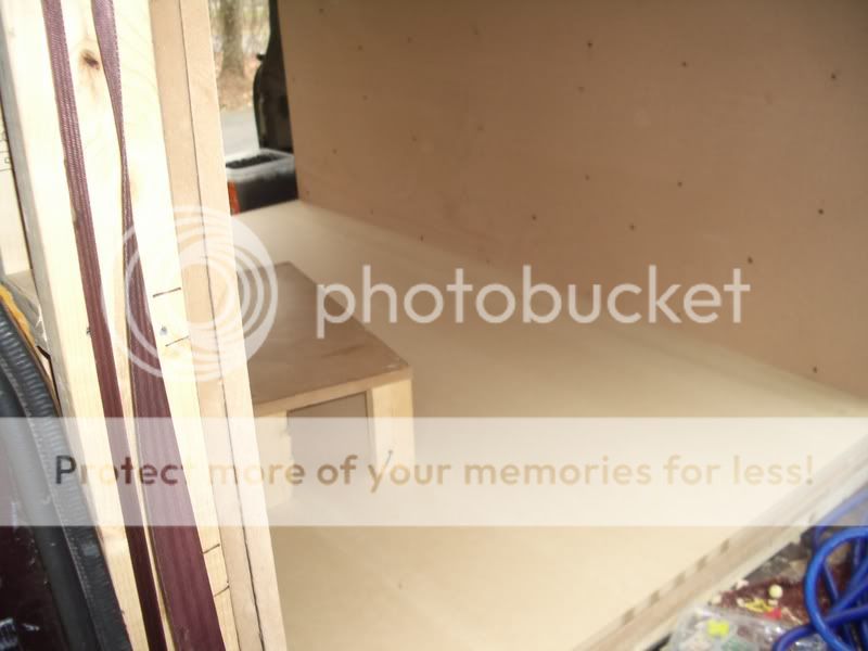

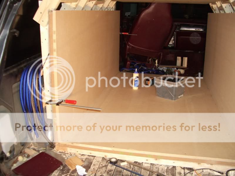

Last layer of the floor is in. Brings the total to 2.25" plus the 2x4 bracing on the bottom.
Its fcuking solid as hell.
But I wonder if bringing it up to 3" would be worth it? Hmmmm
You can see the variations in the mdf color.

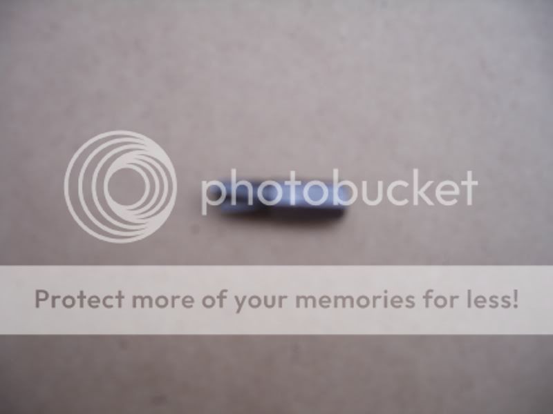

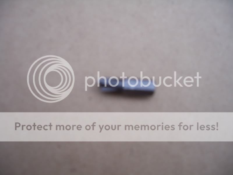

Okay well I have never seen this happen before.
I guess due to the cold and the torque on the screw, the screw bit broke off.
Weird.

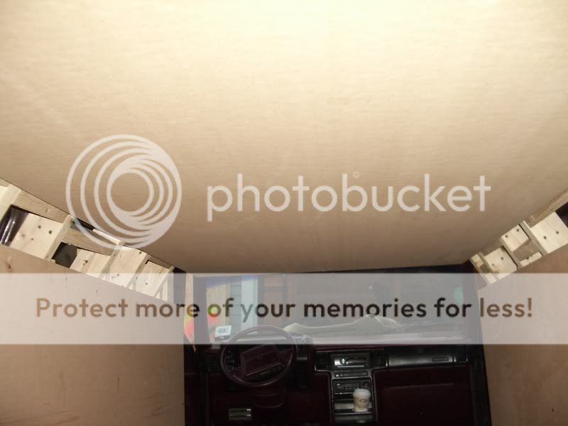

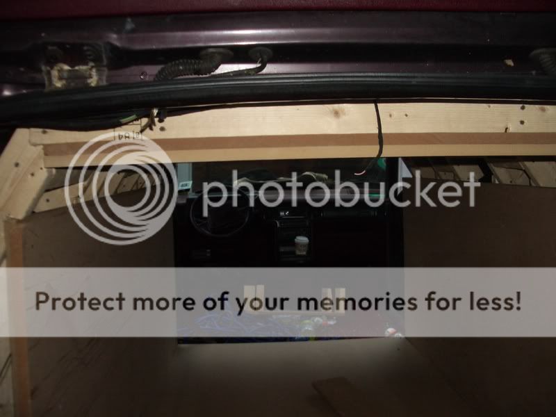

Got second layer of the roof in. Its the hardest of all sides. I do require help on the roof. I get down on my back and hold it up with my feet while someone clamps both sides into c-clamps while lining up the edges. Then I screw it in.
Corners come next.

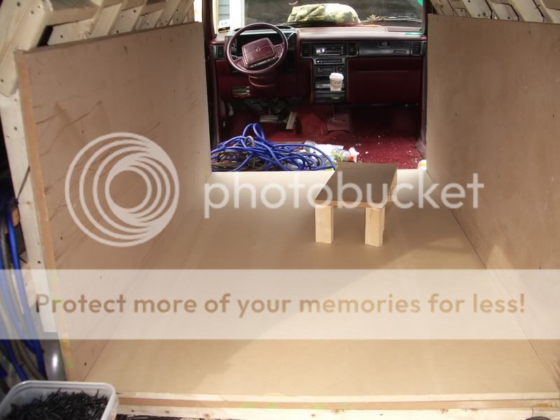

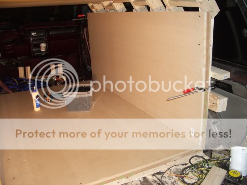

3rd layer on the right side is in!
I may have time to build a baffle and everything else on Sat and Fri. Hmmm... ::
I have more more sheet left, so Ill get the 3rd side in on the other side.
So all layers done on floor and 2 sides very soon.

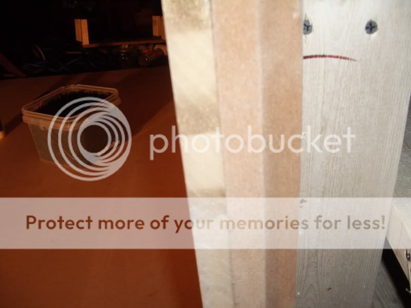

I decided Im doing the corners last. Going to get thinner mdf so I can slide it in and make everything flush. I forgot about the 3/4" corners when I built the frame. Oh well.
Gotta pick up a ton of 2.5" or 3" screws. My 2" screws keep snapping now and its pissing me off.
Nice and thick. Solid.
