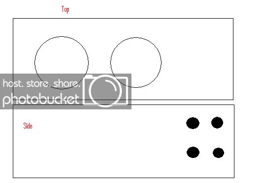

2. i wouldnt seal the trunk, put your seats down and face the subs towards inside the car.
3. i would run 1/0 into a distro block with 2 4gauge outputs.
4. i would use 3-4 4" aeroports and brace the inside of the box and resin it.

do 3cubes NET, do 4 4" aero ports EXTERNAL.
Have the woofers firing up, one behind the other. Have the aero-ports firing towards the driver side, remember external. Tune to around 38-40hz.

You can make a slot pot as big as you want. And you'd have to play around with the placement of the ports to find the loudest in your car.

Is that what you mean ngsm?
Yes... though not sure if having the subs in the back... and the ports near the front would give you a gain or not.
Also, deadening your vehicle "usually" raise the ResonantFrequency of your vehicle... so I would hold off until after you try. Because... you'll wnat yours to remain lower.
