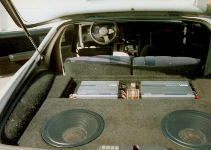

This pic is from 1996, a previous system. Plexi was to go over the amps with holes just big enough for the heatsinks, but I never got that far. All I have left of it is the box and amp rack w/ subs.
