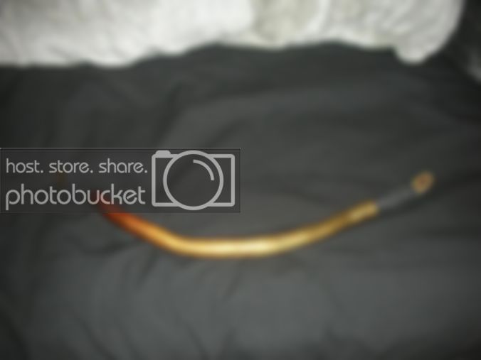

I removed this from my battery to ground as a part of my "big three" upgrade. I had a 4000 watt amp plus a couple of kinetik batteries, and everything worked fine for the 10-12 months that I was banging it. I recently started from scratch and did an un-install, and this is what I found. Any ideas on what happened? BTW the wire started out as silver strands and clear plastic sheathing.
looks more like a mix or crap that gets on it from being under the hood mixed with high under the hood temps mixed with high current draw. Its still conducting right? then there really isnt anything wrong. Discoloration is quite normal
did u have different sized power and ground wires? What guage is that? I had a ground wire melt once. I was using what came in an amp kit. And they had 4 guage for the power and 8 guage for the ground.
Is that near a heat source like a Turbo or Exhaust Manifold? Peel off the heat shrink, if its just discoloration in the PVC the jacketing under the heat shrink will be like new

Oil or grease will discolor the jacket of wire as well. If it is a clear silicone jacket, proximity to black rubber will discolor it exactly like what you have. Ask a scuba diver that has left his clear silicone seal mask and snorkel in a dive bag with a pair of black rubber fins.
