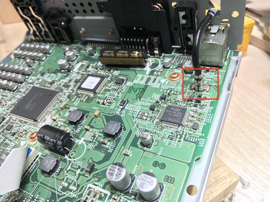

Hi! I was installing a new head unit into my van the other day (a BOSS Audio BV9976B) and didn't realize that the antenna wire was snagged on something when trying to slide it into my dash. Long story short, the antenna wire broke with only about 1 inch of clearance from the head unit to the end of the wire, making it very difficult to solder or use a butt connector. I briefly looked at the head unit to see how to remove the wire completely but couldn't find a simple solution in the 2 minutes I looked at it.
Does anyone know if it's possible to replace the entire length of wire from the internal part of the head unit, or is that just a huge pain?
Any other suggestions on what to do from this point?
If you're talking about the female FM connector that is hardwired to the head unit your only real option is either 1. open up the head unit and replace it or get a new head unit. Might contact Boss for a replacement but I'm not familiar with the internals of that particular HU or if there are any specific issues you might run into.
It was probably Gods way of telling you do not hook up a boss head unit. No offense, but boss head units are garbage. They sound like ****. Spend more than $20 on your head unit. You can find a good pioneer or kenwood head unit for $25 to $80 used on OfferUp or letgo. But first, You will have to pay a guy that does electrical work on cars to fix that. They charge by the hour. Anywhere from $70 to $90 an hour. So it’s about an hour of work.
This is for the female connector going into the head unit. I just don't understand how the inner part connects in the head unit and don't want to crack it open if it's completely not feasible. If anybody knows how they typically wire into the head unit, i could open it, purchase a new female wire and connect it in.
I don't know how Boss connects their FM to the mainboard but honestly? For what the Boss is worth plus the amount of time it will take in getting the parts, possibly getting something working, soldering etc, it would be way easier to just buy a new head unit instead of trying to repair it. You'd need to buy a Female FM plug extension for $5-$10, then you'd need to figure out how that connects to the HU main board. I found a photo of the internals of the DEH-P80 and it doesn't look like it'll be a walk in the park. There is a high likelihood you'll have to pull the mainboard out of the frame in order to repair it.

So the car audio shop I took it to just claimed "bad wiring" and now it all works. Not really sure what that means but case closed! thanks...
