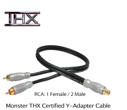

you use two y-adapters.
left RCA into y-adapter into channels 1 & 2. bridge channels 1 & 2 for left speaker
right RCA into y-adapter into channels 3 & 4. bridge channels 3 & 4 for right speaker
with y-adapter will have one female and two male and be located at the amp
