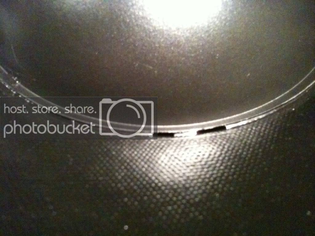

So I ordered two brand new sundown sa-12s and opened them last night. All seems well but one of the subs has about 3 inches of the dustcap on the subwoofer not glued onto the woofer. I think I have some speaker glue laying around from years ago, but was wondering if this is a big deal or of it's cosmetic only. The dustcap is on there sturdy, but who knows if it would to fall off after some use.

Glue it down and it should be fine. Sometimes little things can pass through QC I guess. But it should just be a cosmetic thing and should be an easy fix. If you wanna make a big deal out of it, Im sure Sundown will help you out. But its not worth the hassle since all ya need is a little epoxy or CA glue to fix it.
Sounds good. I'm actually trying not to make a big deal about it as I hate the hassle, even though I know Sundown has great rep. As long as the glue works I'll be happy. I just seems that the dustcap was not centered on the cone evenly so the edge of the dustcap that is not glued to the cone is lifted away from the woofer by a 1/8th of a cm or so. I just hope the glue will be thick enough.

If you aren't comfortable fixing it we can replace it -- typically we would catching anything like that in QC testing.
Check to make sure it's not simply the very edge lacking visible glue -- the cap may be glued down but not squished out to the edge.

take a piece of paper and slide it into the crack and see if it goes as far as you think like Jacob said the glue just might not have came to the edge of the dustcap.

I just tested to see if there was still glue under the space, but I was able to push a small piece of paper through it, so I don't think it's totally sealed. But at the same time I don't know if it's worth the shipping/waiting hassle. (for both parties.)
Here is a picture of what I'm talking about, there's a few other spots not seen in this photo:

We can still fix it if it's a problem down the line.
