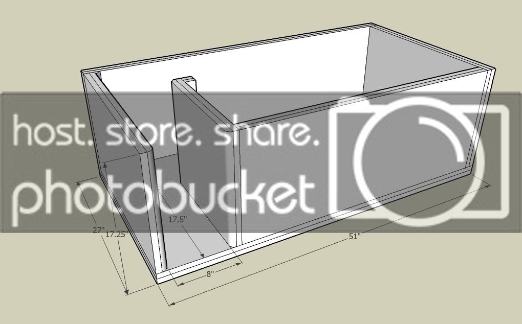

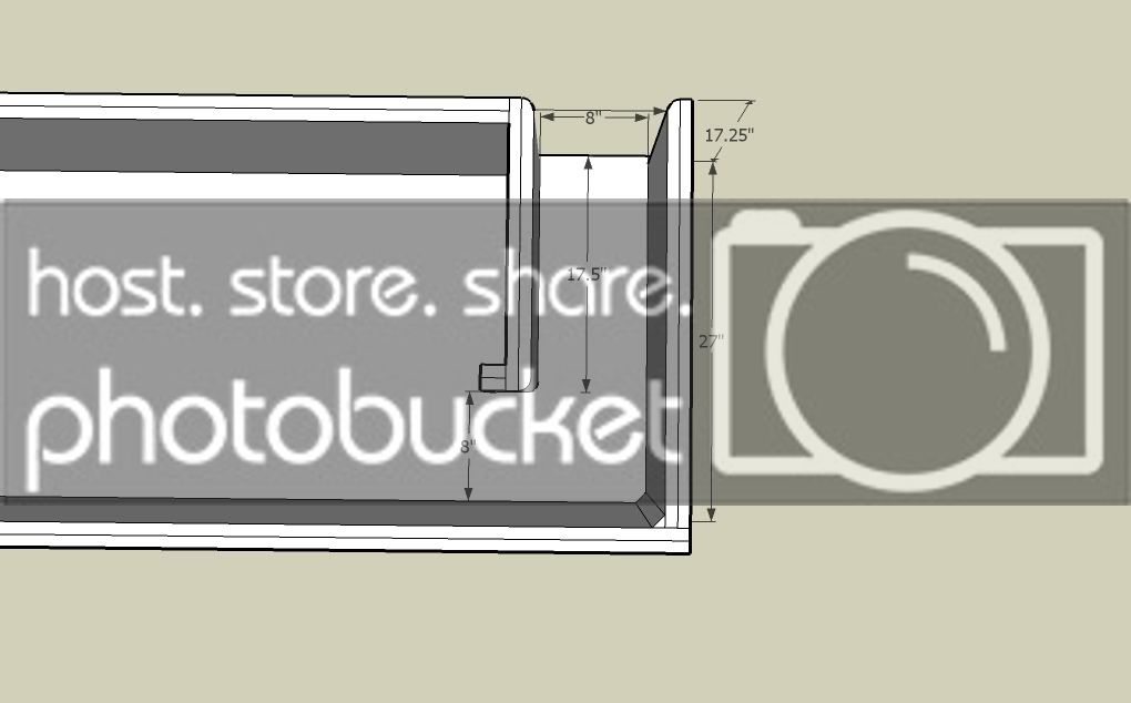

But here it is...7.5 cubes, 34Hz, and 126 sq inches of port..
Keep in mind the top two layers arent on...so the actual height is the 18.75" stated earlier..
Nice, could you do it with the cutouts for the 3 13'' w7s? or 13.5 whatever they are?.. and you would recommend port like that not on the bottom or nothing? Because that seems like it would be a tight fit for 3 13'' w7's
i jusr realized the front baffle isn't big enough to put all 3 subs in a single line...you would need around 44" to line them up side by side. Might have to go taller and shallower on the box
Yes, it will be a tight fit for the subs...most likely have to stagger them.
And I just did a quick search on how much it'll be to ship...and HOLY CRAP..lets just say theres no wayyoud pay that much to ship it out there //content.invisioncic.com/y282845/emoticons/crap.gif.7f4dd41e3e9b23fbd170a1ee6f65cecc.gif
And I forgot to add that the small bit of port after the corner is 1.5" long..
