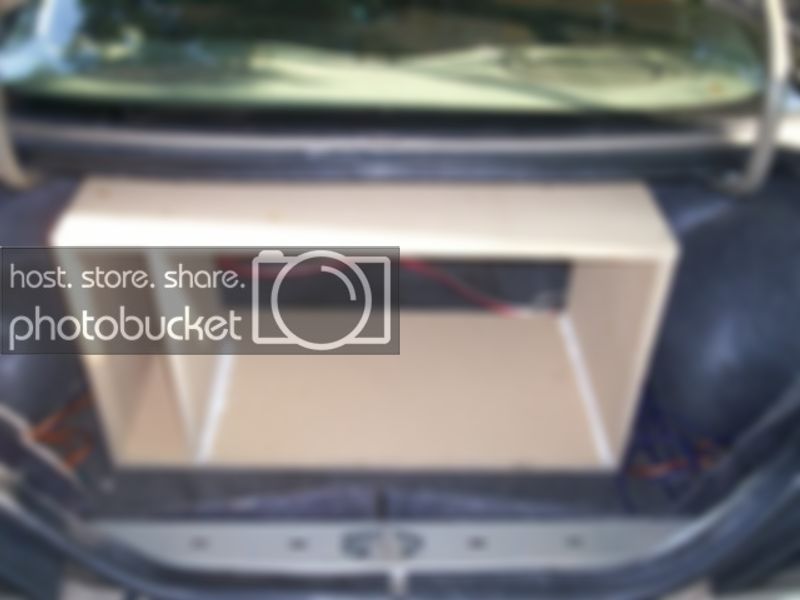

box set up in trunk car
trunk cars blow for boxes, but if you can get it in they get louddd
See if there's any possible way you could fit it with both facing back, you'll get less unnecessary rattle and it'll most likely be louder

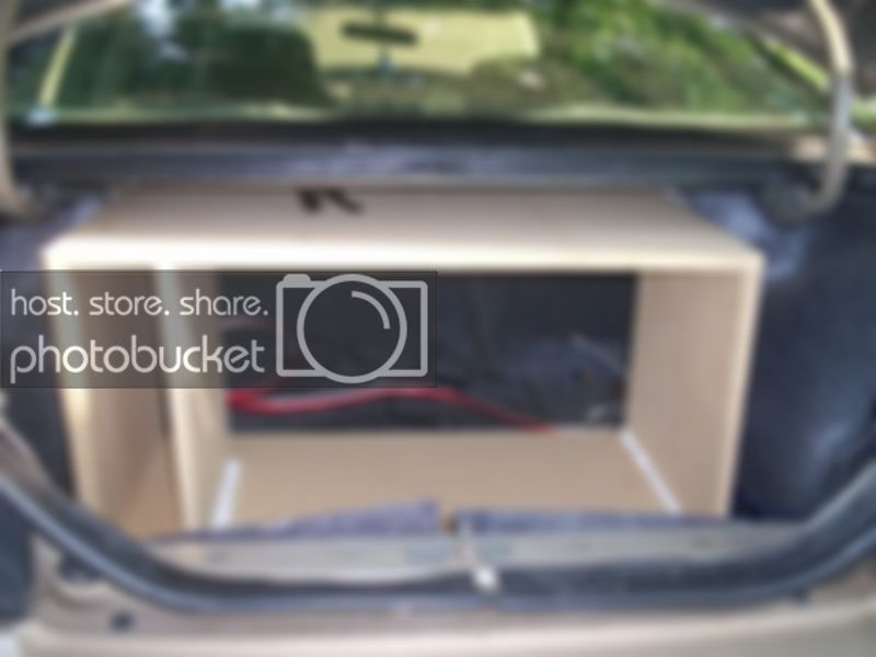

when i had my 01 grand am, I always had to build my boxes INSIDE the trunk. Just take off the front, back, and top, and then slide the rest in. That way, you can get the sub and port, to face the back.

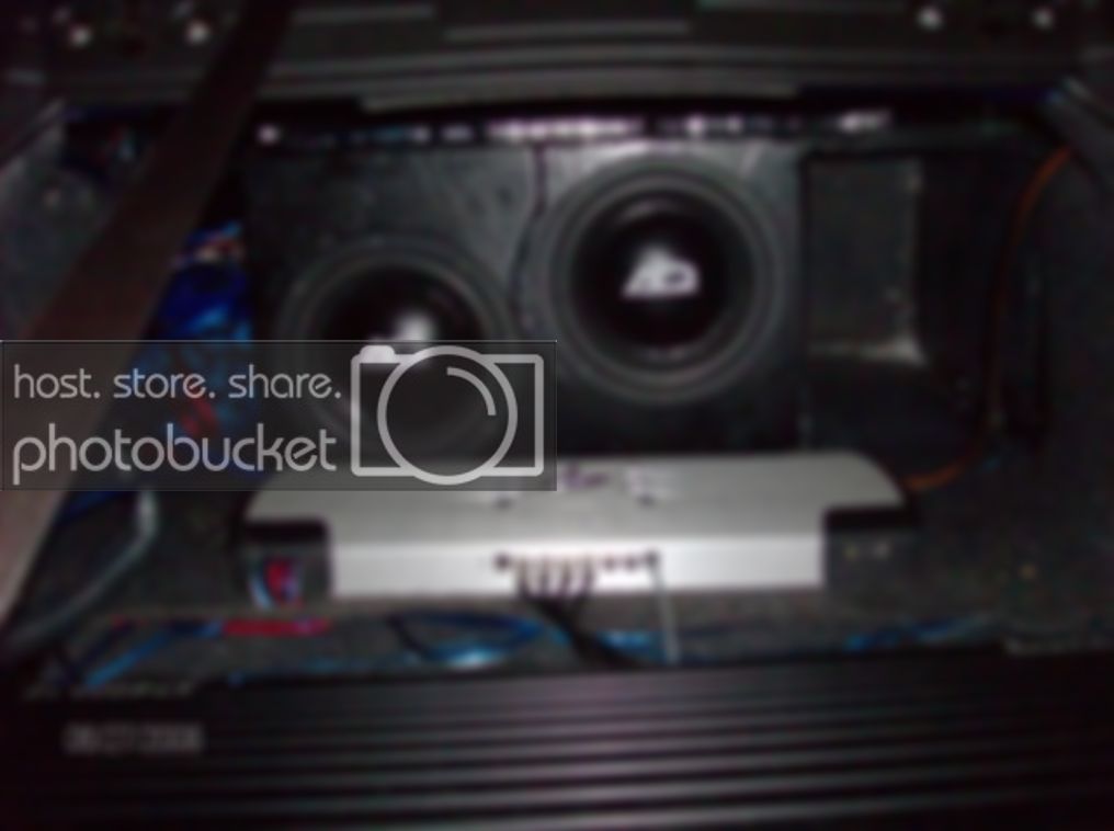

Examples are below: you gotta do what you gotta do to make it right, otherwise its not really worth it.
Then just screw on the remaining panels on while its inside the trunk.
LOL //content.invisioncic.com/y282845/emoticons/crazy.gif.c13912c32de98515d3142759a824dae7.gif I have waaaaay more trunk lid flex with them facing the rear. Meaning way way way more rattle.//content.invisioncic.com/y282845/emoticons/cool.gif.3bcaf8f141236c00f8044d07150e34f7.gif
Again, that's just my experience. Different cars respond differently. It's all about experiment.
