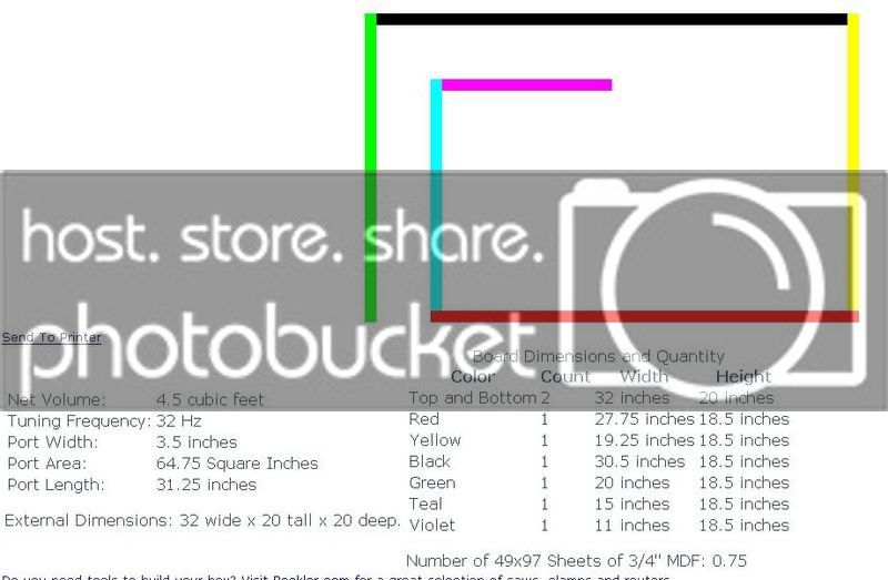

I just used the Decaf box tool and it came up with this
Would that be accurate?
Or should i still do this on paper?
Thanks for the quick reply.
Looks great. Thanks i appreciate it. Did you calculate for the mdf 3/4 thickness as well? Will the 25 1/2 piece board be inner or outer of the 2 30" pieces of wood? How about the 15" pieces? sorry cant tell from the angle.
The Top and Bottom are 30" (W) X 25.5" (D)
The box is 15" Tall external and 13.5" internal.
The triangle at the back has a hight, from point to base of triangle, of 1 3/8".
