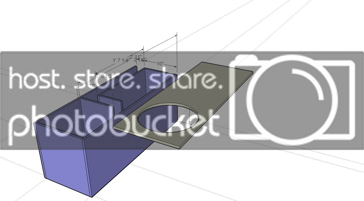

Well springbreak is finally here, and I've decided to use my free time to build my box for my xxx. I'm pretty much using Moe Lester's plans for 2.1 CuFt @ 28hz, but I plan on adding a little flair. If you guys would be so kind to check my plans I'd greatly appreciate it.
Box Plans:
I plan on adding a single brace spaced throughout the box
Here's the math for the brace at 1" thickness....
Displacement of entire "solid" brace is LxWxH:
(8.75)x(.75)x(13.5) Divided by 1728 = .051 CuFt
Displacement of "Hollow" part of brace is LxWxH:
(6.75)x(.75)x(11.5) Divided by 1728 = .033 CuFt
By taking the displacement of the entire brace and subtracting the hollow piece's displacement I get a net displacement of .009 Cuft, and since I'm using two I have a total displacement of .018 Cuft.
[2.31] total box volume - [.018] Brace - [.19] Driver displacement = 2.102 CuFt... Perfection =D plus room to spare for triangular corner bracing =D
Yeah thats going to be hard to make an exact square. And that slot is going to be a brace itself. But im not arguing with ya. Good luck on your project dude.
No worries my uncle is a carpenter =D
I wouldn't do the brace that way.I'll throw a 3-D up of how I'd do it tomorrow.
I'd really appreciate the help. Quite the gentlemen =)
And yes it's going to be a picture frame type bracing. I don't think it's reall nessesary, but couldn't hurt. I also want to incorporate the rabbited edge like Bj's post.

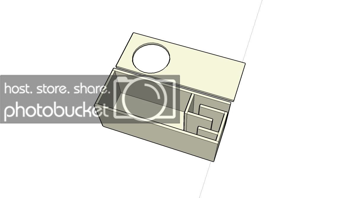

Well... I revised my plans significantly thanks to the input of your great folks. Especially Mountaineer Man, Death By Bass, and Jordantyler for helping me out with my design.
To the details, I've decided to get rid of the left brace closest to the port since the port doubles as a brace itself (As noted by Death By Bass). I've moved the subs mounting position to the right. By doing this, it allows me to put a single brace in the middle of the entire box. Since I have some extra airspace to work with. I'm going to go with Jordantyler's method of bracing with crossbeams in combination with the picture frame method. This is what it's going to look like:
Unfourtunatly, there might be some problems with my modifications. This topic was brought up in another thread so check it out.
Here are two examples of ported boxes....
First one...in this box the port divides the box in half...thus like nG said giving the air an "option" on where to travel. which isnt good.
Second box...in this box the air has only one path, that is to exit the box out of the port...
The problem that I think will happen is this:
Im afraid my design will have two directions of airflow(Wavy arrows represent airflow)... which is bad according to chevyaudio.
Am I just thinking about it too much, or is it an okay design?
