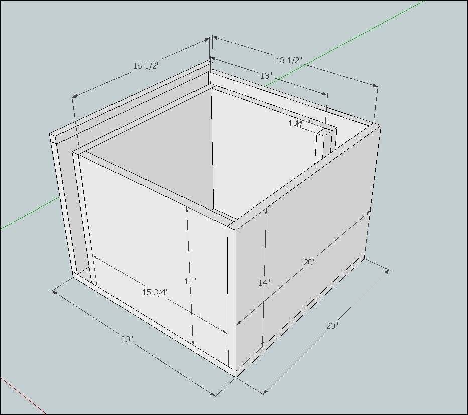

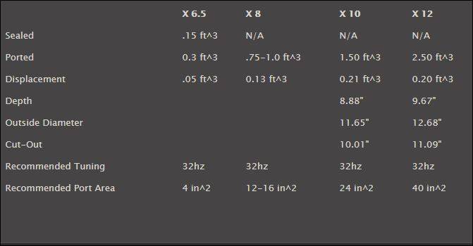

So I am putting a Sundown X-12 D2. Powered by a Exile Audio 2500.1. XS battery and probably no Capacitor. At the moment I am just planning to build the box using Sundown's recommend design from their website. Now I am just seeking help from you guys on here if that box is appropriate for the setup that I am working with. As you can see this is not going inside a car so I will lose the benefit of a cabin. As far as music that I will listen to, everything from Country to Rap to Rock. There is nothing more specific but other then the more beer I drink the more rap I will play.
Tell me, is the recommended box going to be fine? Should it be altered some? If so then how and why should it? Is the SD X-12 a bad or good choice?

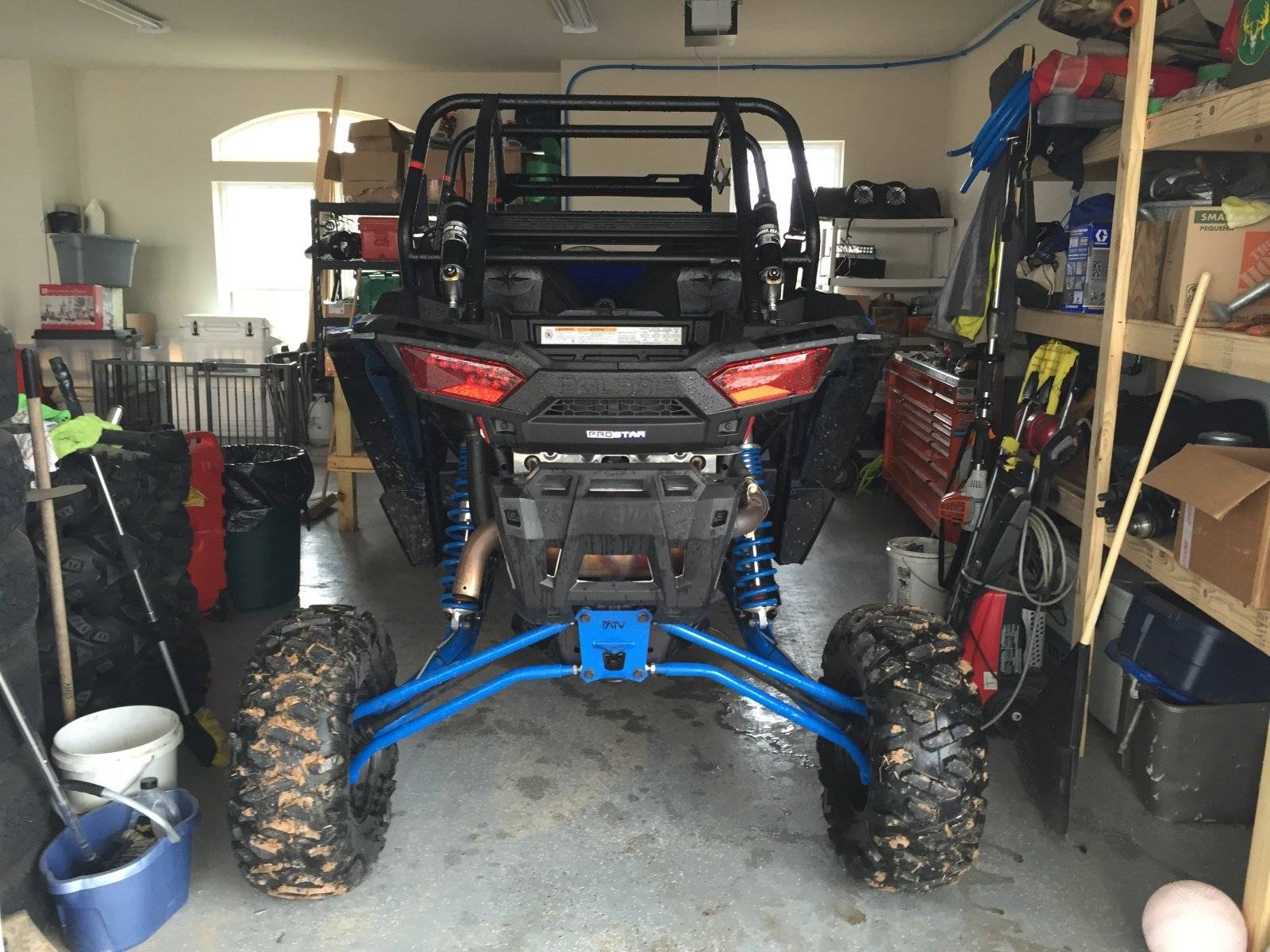

Here is what the Sub/box is going in. Right in the bed using about the front half of it. Firing forward
