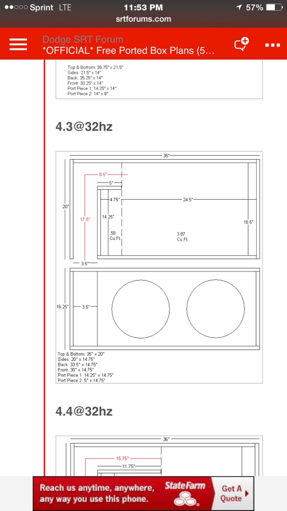

Box for two hds212
Will the ones for the dodge work in my car and be right

as long as the box will fit in the trunk, it should work fine.

Is that box at 4.3 for 12s or 15s

12's bruh.. look at the measurements for the front piece.. it's 30 x 14.75, 15's wouldn't fit
