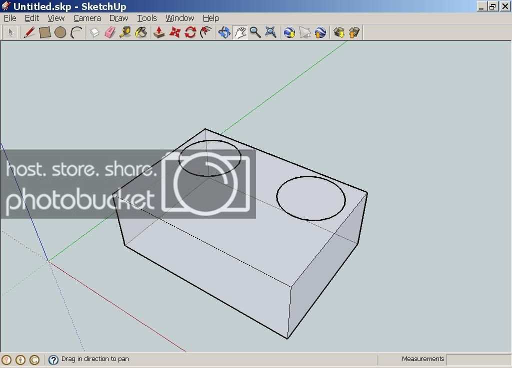

Two Alpine type r 12's will go into it facing towards the roof of the vehicle.
Length (Depth) = 26"
Width = 37"
Height = 13"
So what should the port calculate to?
According to the re box calc. they say the port length is 34.75". Is this correct?
I'm usin .75" MDF of course.
I listen to mainly hip/hop, rap.
Tuning probably around 33hz.
Plan on using a Hifonics 1208d so 1000wrms.
Here is a mockup
The port will be below the subs at the back of the box on the same face or the face just below that. I just need the best size!
