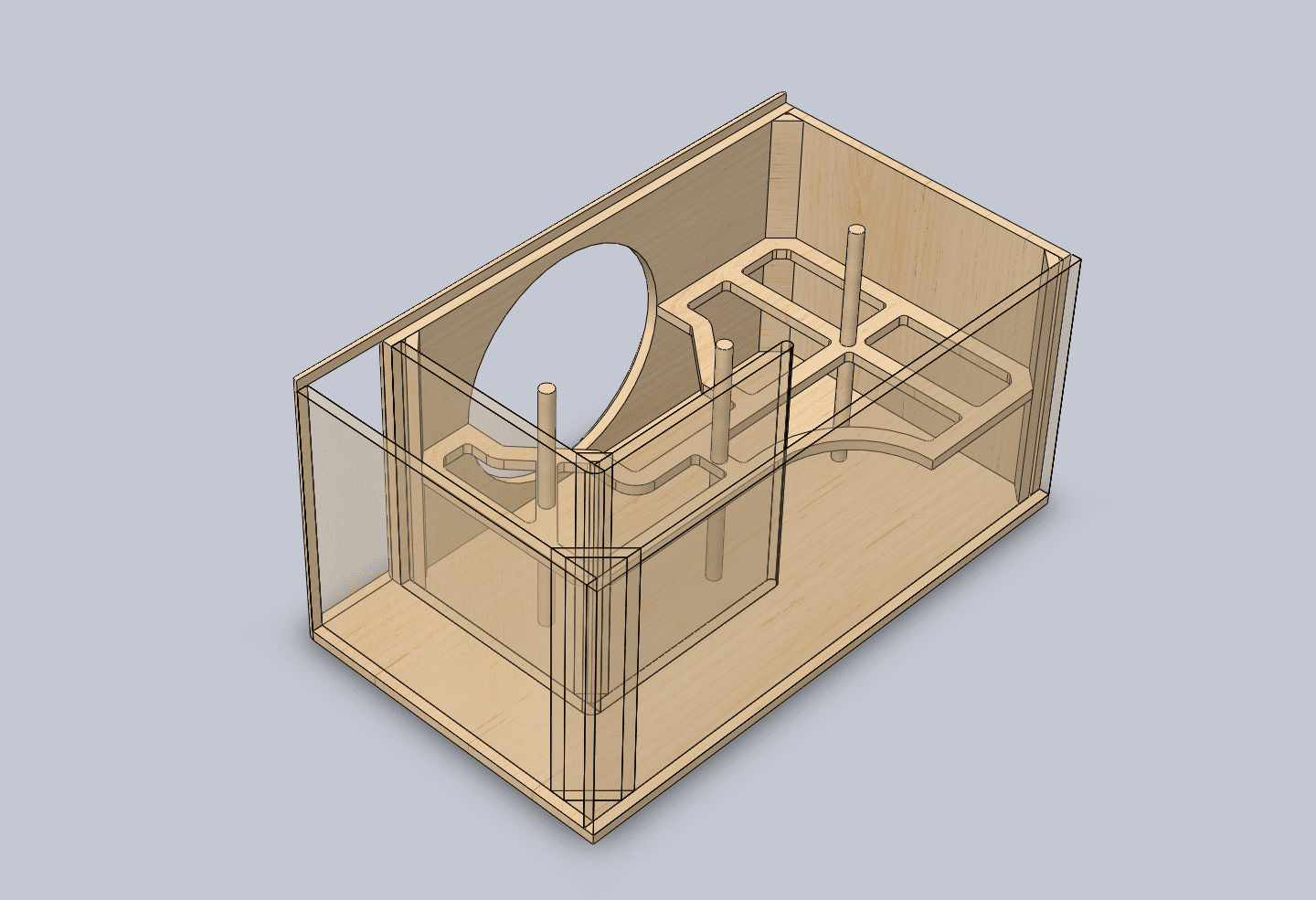

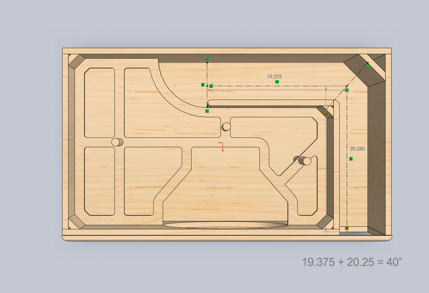

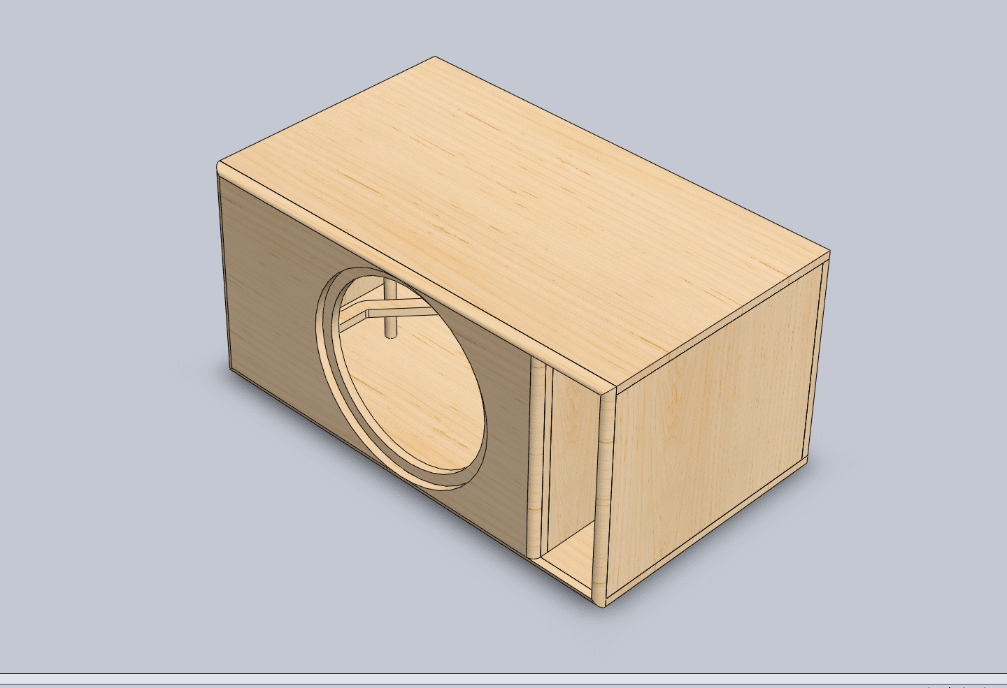

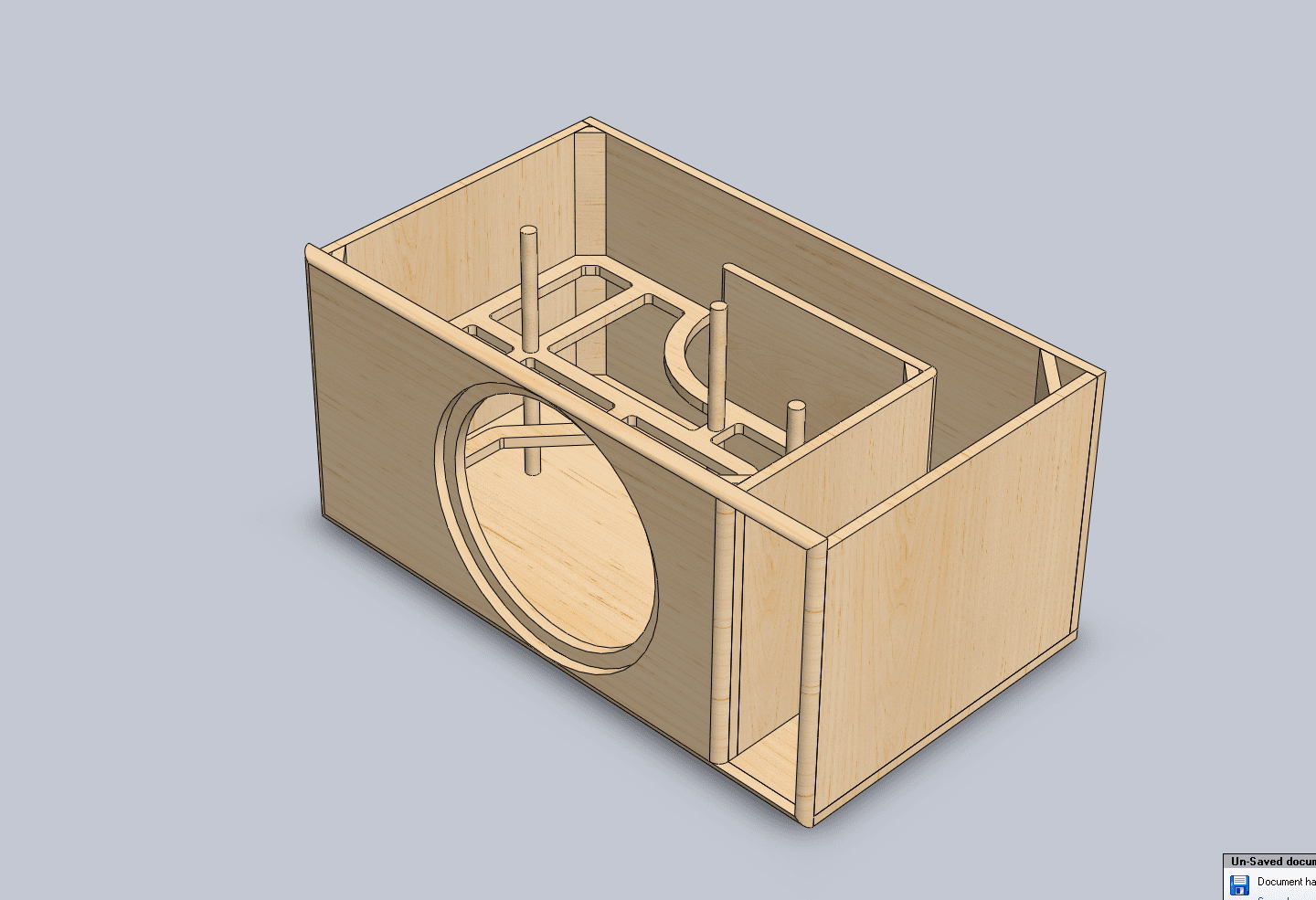

Box for my HDC18 (hopefully)
T.I.K.
F*ck it, we'll do it live
Box Dimensions: 41.25 x 20 x 23.5
Gross Volume: 9.35ft^3
- .25 Driver Displacement
- .10 Bracing Displacement
Net Volume: ~6.5ft^3
Port Dimensions: 5.75 x 18.5 x 40
Tuning: ~30hz
Don't worry, I'm handy with a jigsaw //content.invisioncic.com/y282845/emoticons/biggrin.gif.d71a5d36fcbab170f2364c9f2e3946cb.gif
