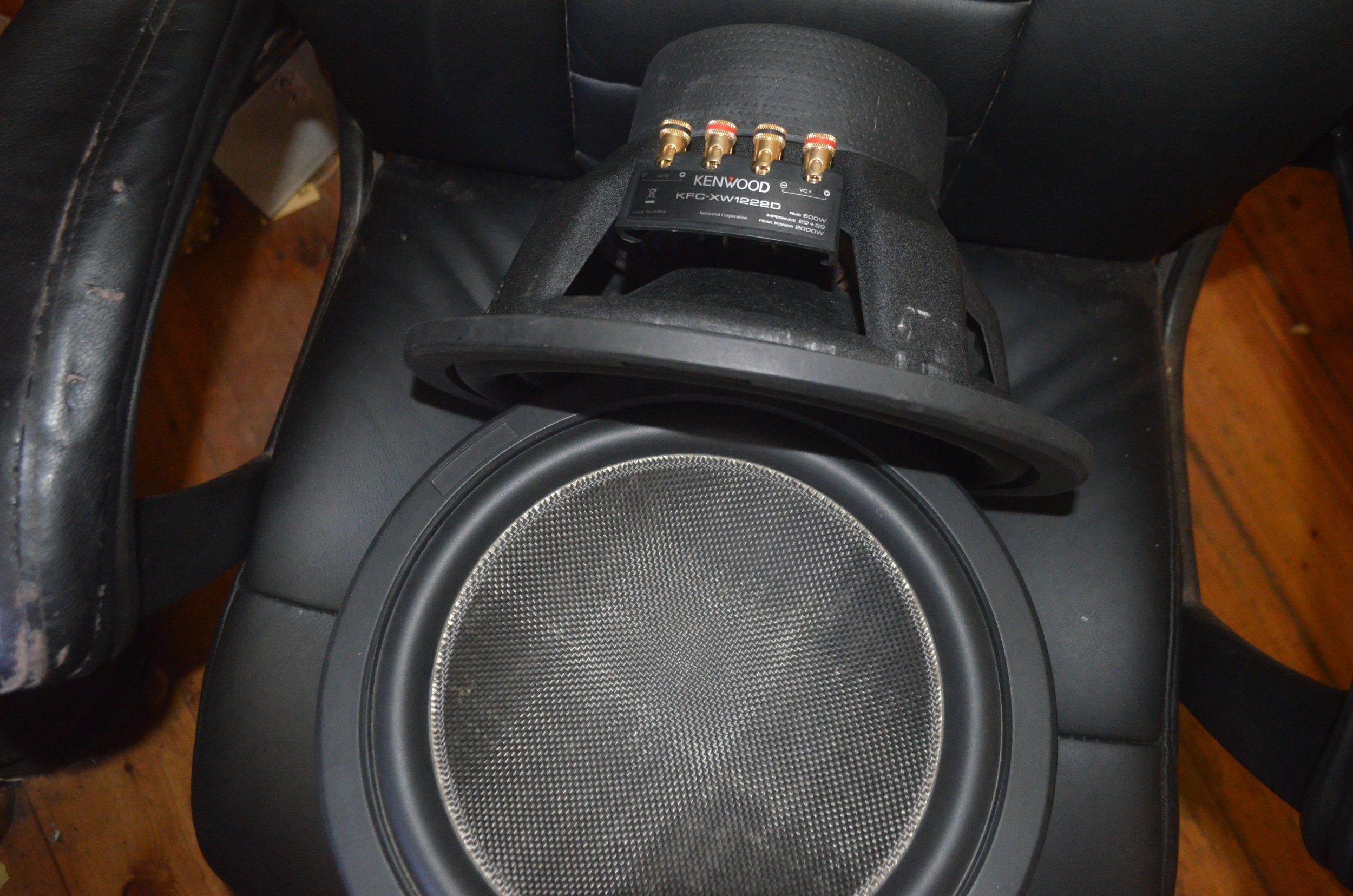

I have two Kenwood KFC XW 1222D subs . 12 inch Dual coil 2 ohm 2x 300 RMS 2x 1000 Max
Closed box advice is 35.4 liter for one So I need 70.8 liter. ( 18.7 US Gallon )
Ported box 42.5 liter .for one .
I would like to go for a closed box. but can I make it a bit smaller, and id zo how manny %.
And what are the drawbacks if I go lets say 25 % smaller?
Nominale impedantie (Z)2Ω + 2Ω
DC weerstand (Re)1.5Ω + 1.5Ω
Resonantiefrequentie (FSO)28,3Hz
Mechanische Q factor (QMS)5,813
Electrische Q factor (QES)0,55
Totale Q-factor (QTS)0,5
Spreekspoel inductantie (LBM)0,5mH
Force factor (BL)6,56T/m
Peak excursion (Xmax)5,9mm
Moving mass (MMS)176,8gr.
Volume Accoustic Compliance (VAS)61,03liter
Piston Area (SD)0,049m²
Displacement3030cc
Inhoudsvolume gesloten subwooferkist35,4liter
Afmetingen Gesloten Kist (BxHxD)375 x 370 x 355mm ( 19mm dik MDF)
