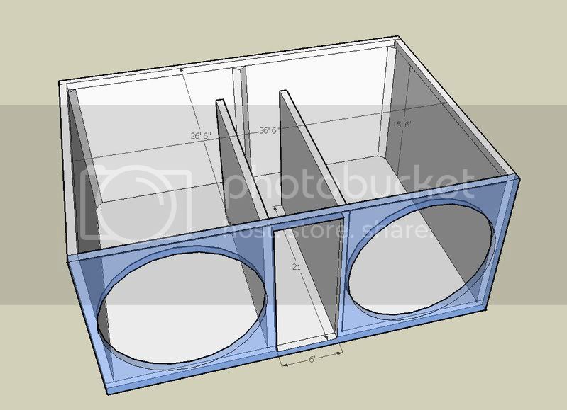

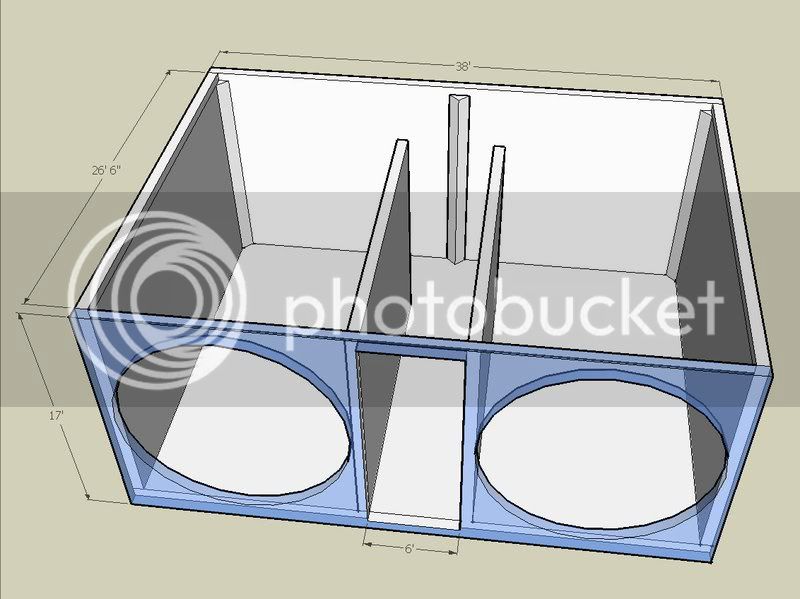

well i plan on building a ported box in the trunk of my civic. it will be facing foward and i will attempt to seal the cabin from the trunk in the process. well this is a design i came up with(foot = inches)
i beleive the total air space is about 7cu after displacment and the tuning is at 30-31hz.
it is pretty much the max dimensions i can use w/o making an odd shaped box in the trunk.
question: would this be ok for 2 xxx15's or should i go bigger?
are my port calculations off?
should i squeeze out another cube of air space?

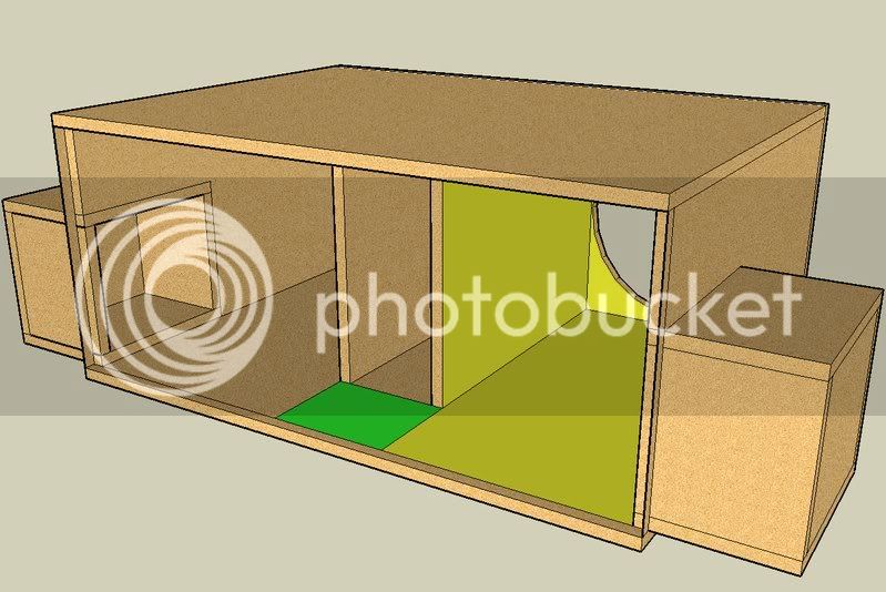

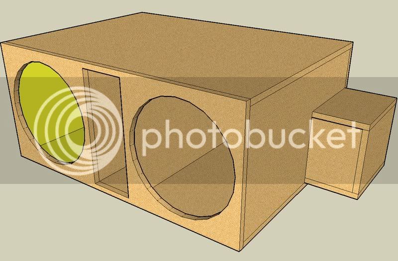

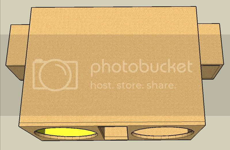

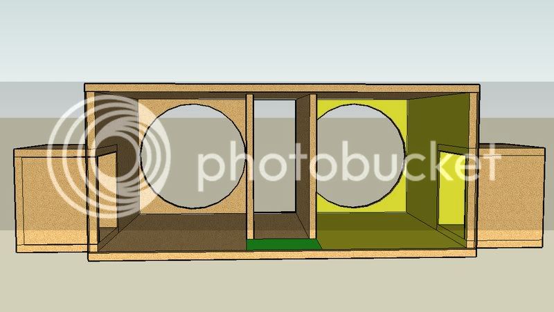

after a little more measuring to try to gain as much space as possible i was able to get the enclosures airspace close to the recommended specs for the subs.
i came up with these cavities that are located right behind the wheel well.
here's what i could look like.
the area in yellow gives me a total air space of 3.774cu.
both sub areas combined air space is 7.548.cu
i did not take the green portion into count as it is the area right behind the port though it counts for 0.42cu. though adding it would give me a total of 7.968cu.
well!!
my new question is would the cavities positioned on the side of the box be OK for trying to add more airspace to the enclosure?
also can anyone tell if my port calcs are off?
