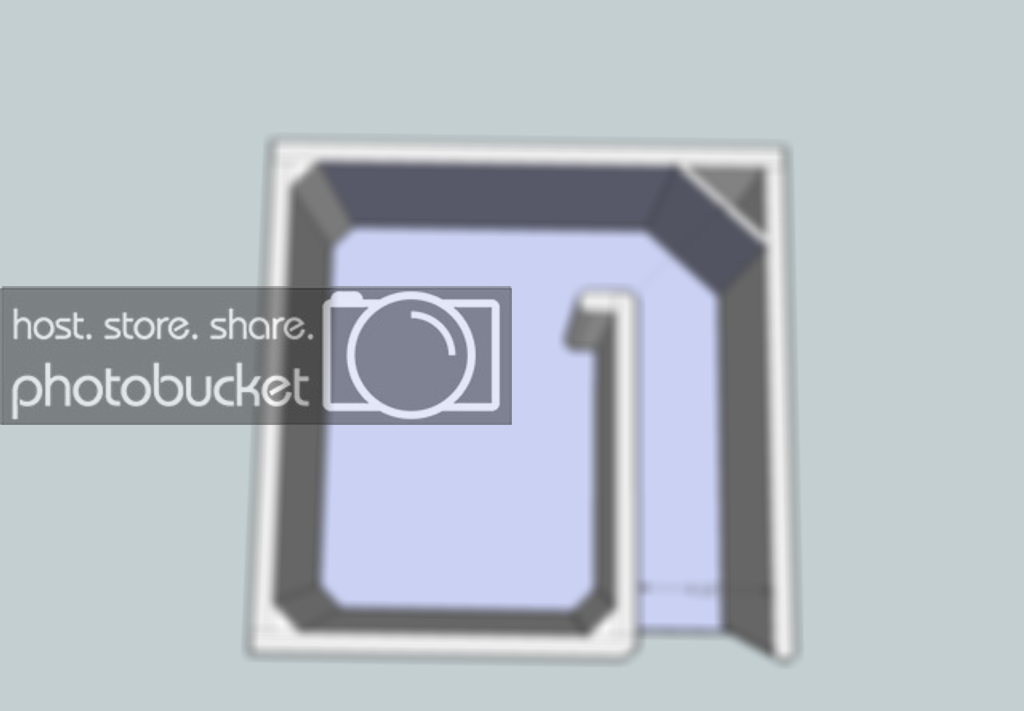

im going with 4 cubes each woofer after displacement. also going double baffle only on the woofer side. using a windowed brace between the woofers for support.
will post a screen of the box sketchup after I get back from peddling this amp.
decent design?
This was my original layout (modified for 4 cubes per). Since I already have the MDF, I figure I might as well stick with it. It's hard to make up my mind. I think that this might sound good when all is said and done.
What do you think might be better? I'm open to suggestions.
No problem with doubling everything if you have the mdf and don't mind the extra time cutting/building. I don't think it's necessary, but it's not going to hurt anything, obviously. What side will the subs be mounted on?
