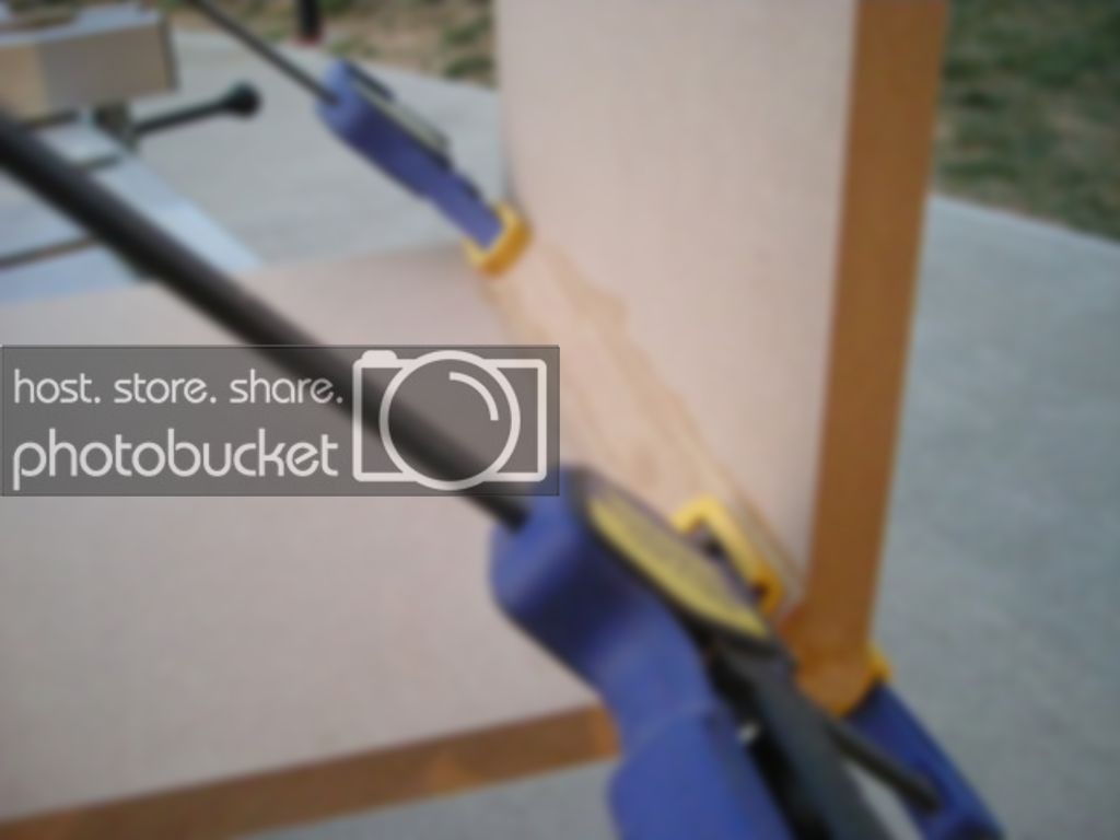

So instead of a 90 degree and where the port breaks I need to make it 45?

No, no bending (though it is possible...but i wont go into that)...you simply make the box just how it looks in the designer...but once everythings together (without the top on yet)...cut 45 degree inserts the height of the enclosure to put in the corners to strengthen them and also help out flow and also help keep your port the same width (or atleast closer)..
Like this..
Just put it in the corner with some good wood glue and clamp in place
Ok...it still is showing on side to 18.25 and the other side to be 17.5.
How does that work out?
