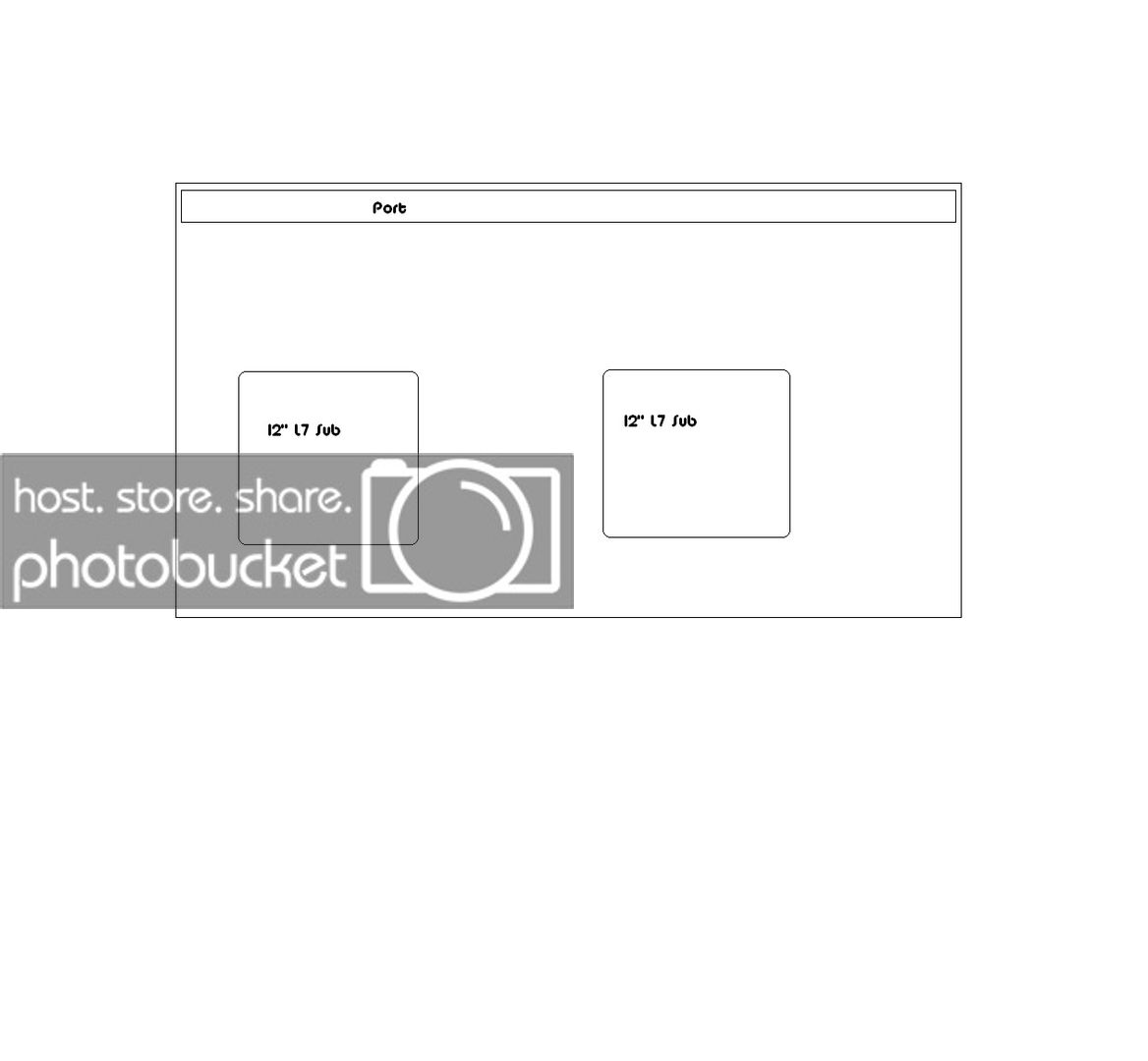

Alright, I guess I'm going to try and accomplish a mini wall in my Caprice... Only problem is my designing program is cheap, and I can't do it in my head... So this is where yall come in... I have alot of room to work with... The MAX dimensions are 55 Wide x 23 High x 20 Deep... I really need it to be 55 wide and 23 high, but the 20 deep can vary... This box wihh be for two 12" 05 L7's... With a 1200D pushin them... I'd like it to be tuned around 35 Hz... And the port and subs to be set up with the pic... Thanks in advance...
lol... Tampa is about 8 hours away from me... I'm at what the call the,"Tip Of The Glock"... I really want to make a wedge design, because It would look alot better in my car... But I can't get any designers to help me... I want 2.5 cubes per sub, tuned around 35Hz... But I have absolutly noooo idea on how to put the port on the front of a wedge box... I can build the box myself, I've built some really nice boxes, but I just can't design worth a s**t... So if somebody could help me design a wedge box that's 55 wide x 23high x 20 deep, and it doesn't matter what the top is, tuned to 35Hz, I'd really appreciate it... Hell, I'll send you $5... lol, I know, big spender...
im up for the task bro.
rather see you do a wedge box, and port it in the middle - not a full on wedge persay, but i think you get what i mean with that horrible ascii art.
top view
_______
\__/ \__/
if that makes any sense.
if not, then ill shorten the port so it doesnt go all the way across the top, and still get you your wedge.
I have Term-Pro and Bassbox 6 programs if you want a computer suggested box, I am 1/2 way through 4 l7 15's in a wall ported right now, they are tuned at 36.5hz and both programs were helpful what are the max dimensions you are dealing with and what year subs, what impedence, wiring config., and rms power. if you can get that info to me I'll run it up on my programs if that helps. My experience with sqaure solo's ported has been biggest box recommended by factory is the loudest if it will fit in your space put a divider in use 1 port for each sub and build it just like kicker recommends
