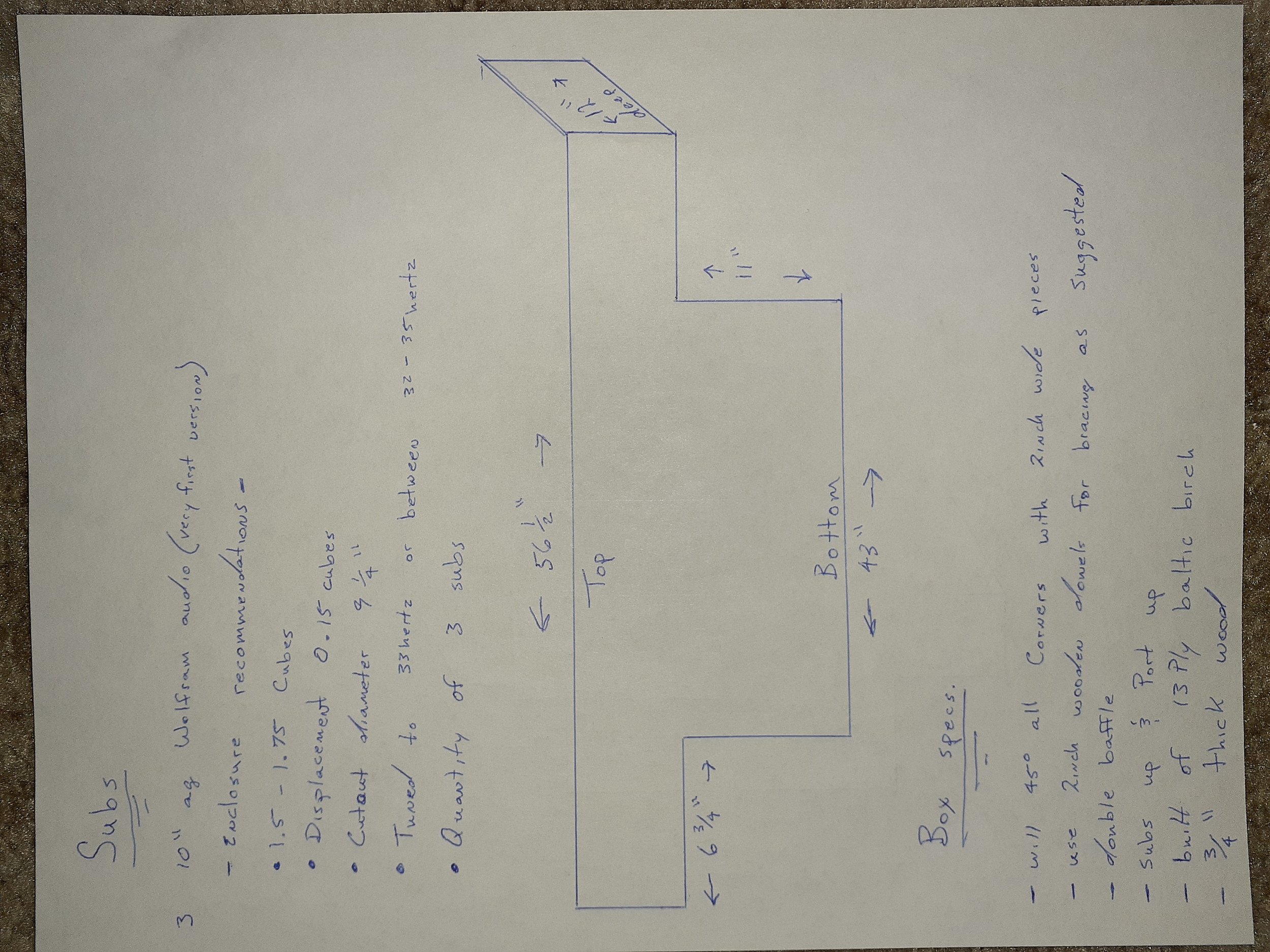

Needing help building a box. I can't seem to find an app that will help with this complex box design. Any help would be greatly appreciated.

I forgot to put the missing variable is 9 inches. Also thinking of doing fo ports not sure how to do that. But one slot port on either side face up. I know louder with subs up port back as this will be in a toyota 4runner. But I don't wanna mess up the hatch and also gotta haul stuff.
Just need something to calculate the port length. If you really want to learn, find the port length formula and calculate the frequency.
With dual slot ports and the non-square design the apps don't help with that. That's my only struggle. I am using THE ULTIMATE CAR AUDIO app. It doesn't give me the option. That's where I'm currently hung up.

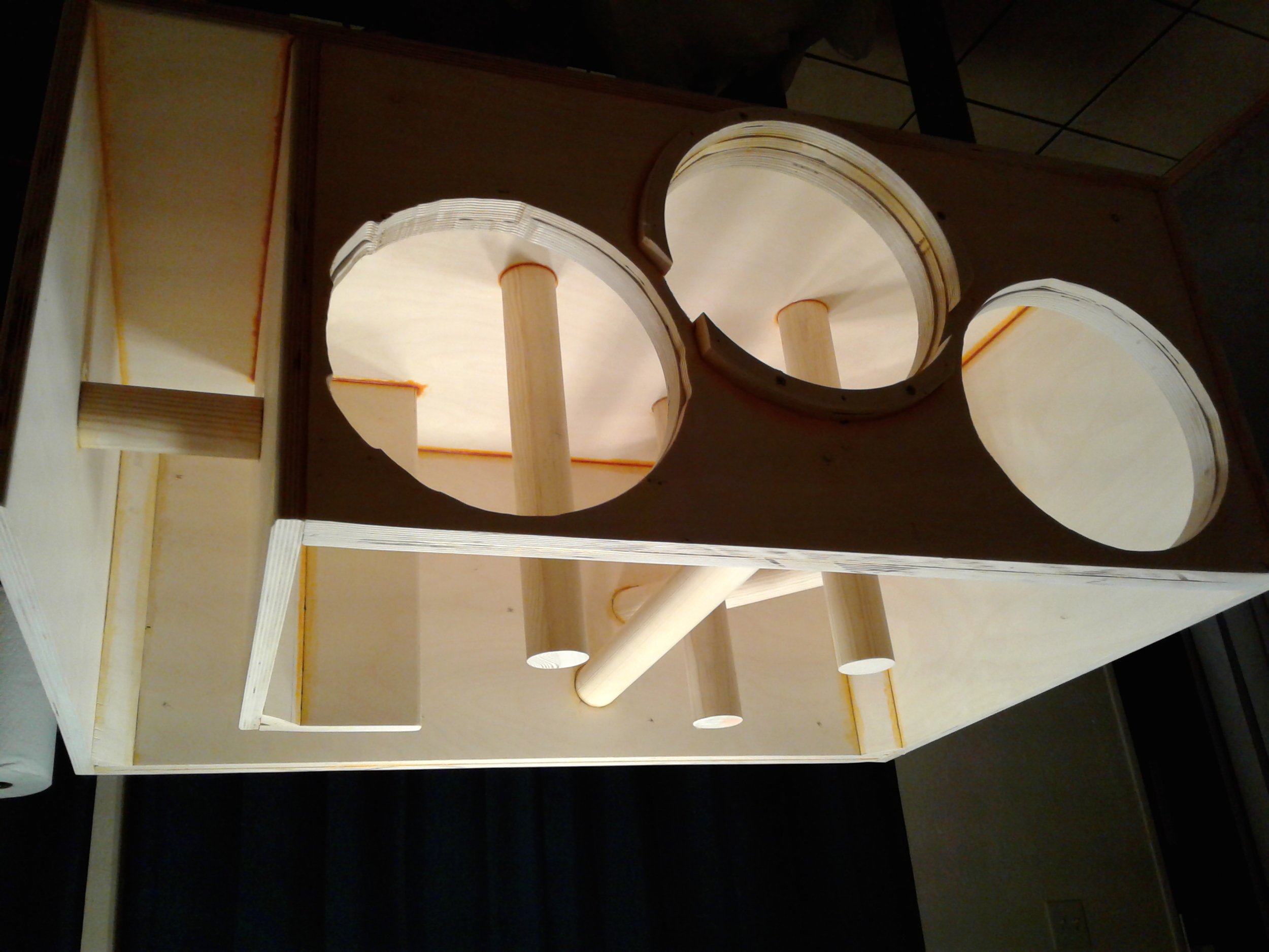

My last box build. This one is a bit more complex than the rectangular build. Thank u for ur help.
