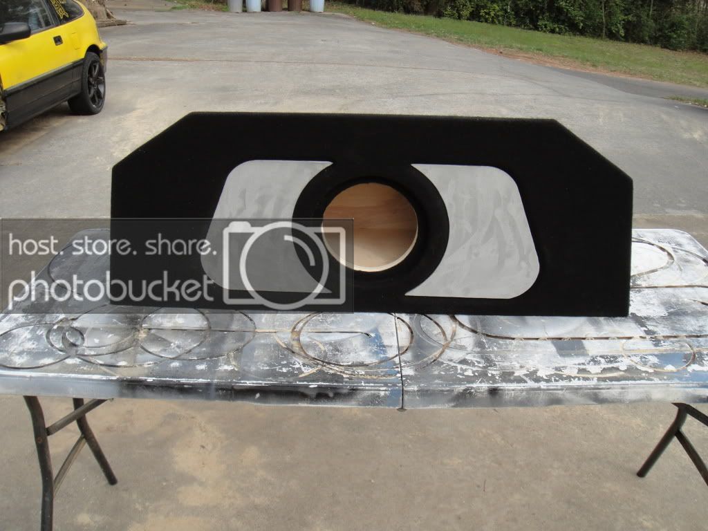

Ok everyone this box is for Zach's single 8" JL Audio W7.
Box is 1 cubic foot with 12 square inches of port tuned to 34Hz and is custom fitted for his 09 Nissan Maxima.
More to come so stay posted................
Good build. Im a fan of Tite Bond as well. fantastic wood glue.
For sealing and bonding the inside edges i recomend Power Grab construction adhesive. It is really good stuff. (have some pics on my build page)
