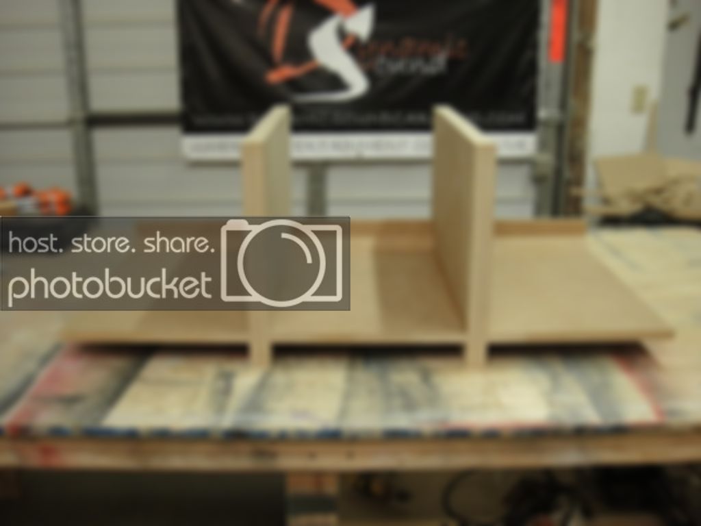

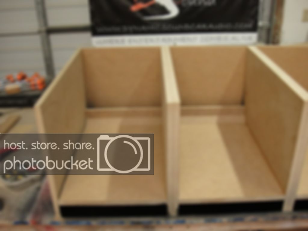

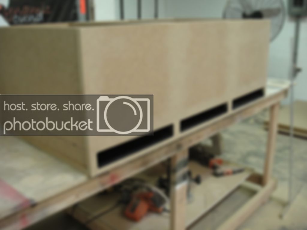

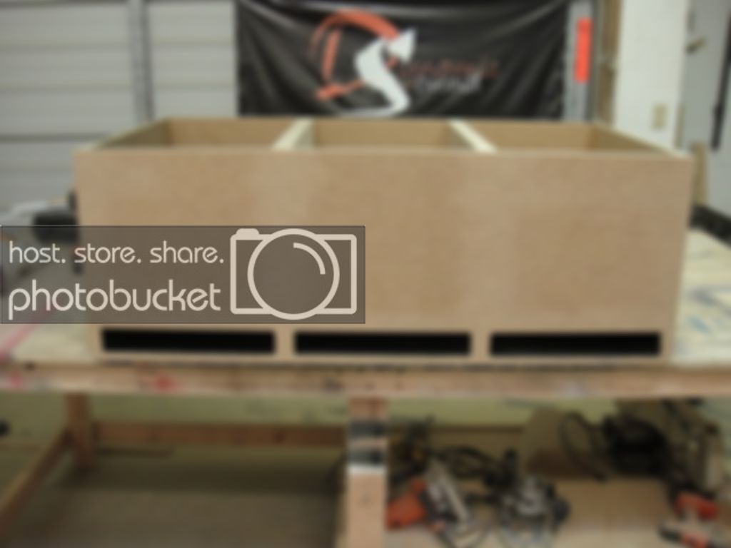

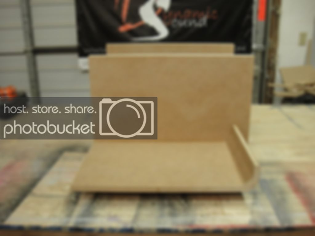

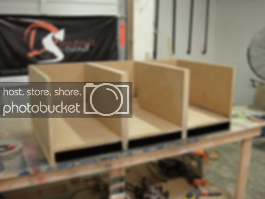

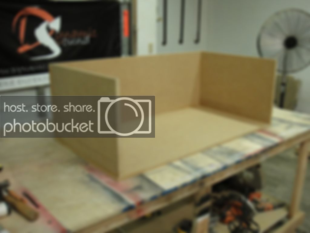

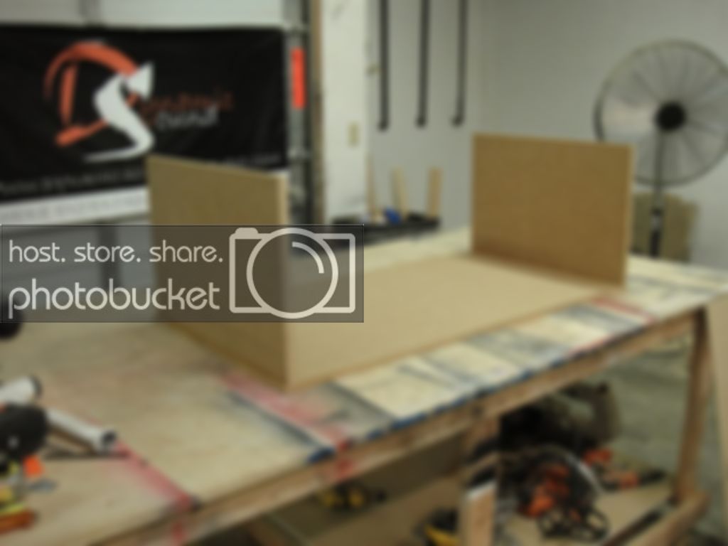

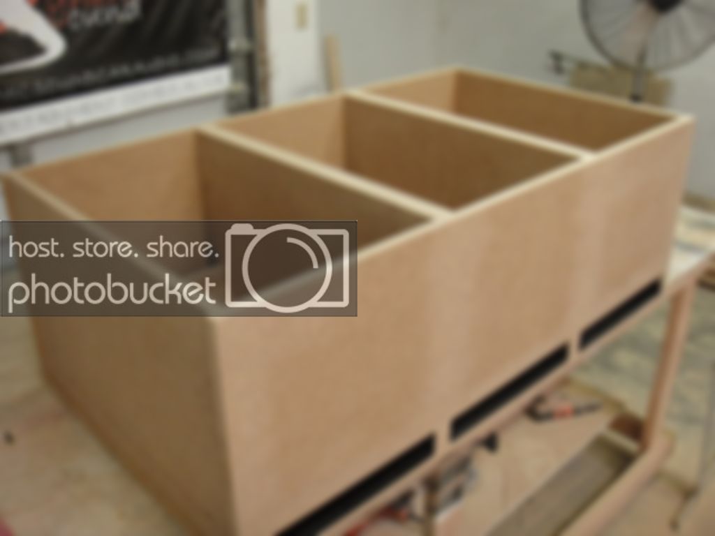

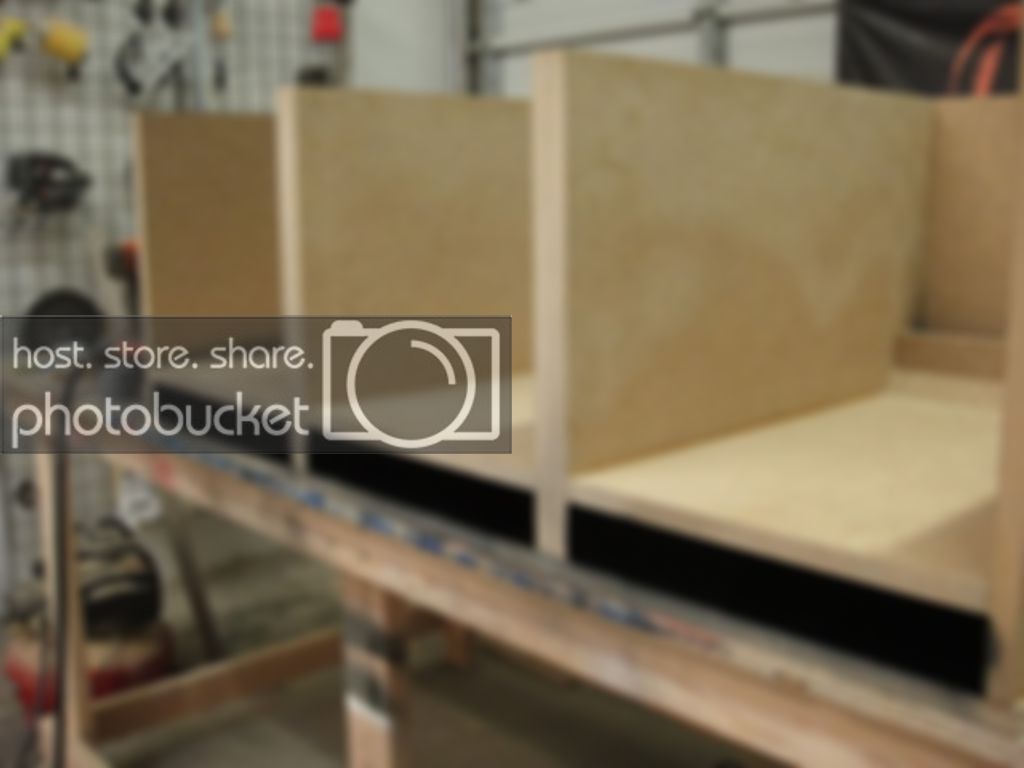

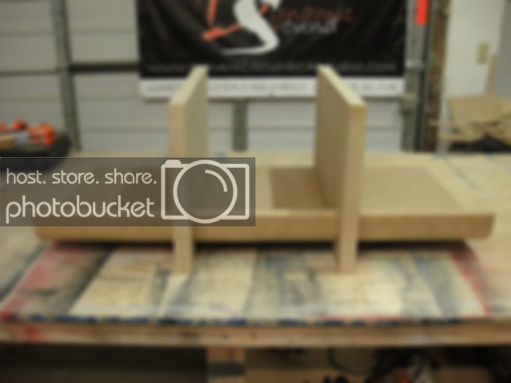

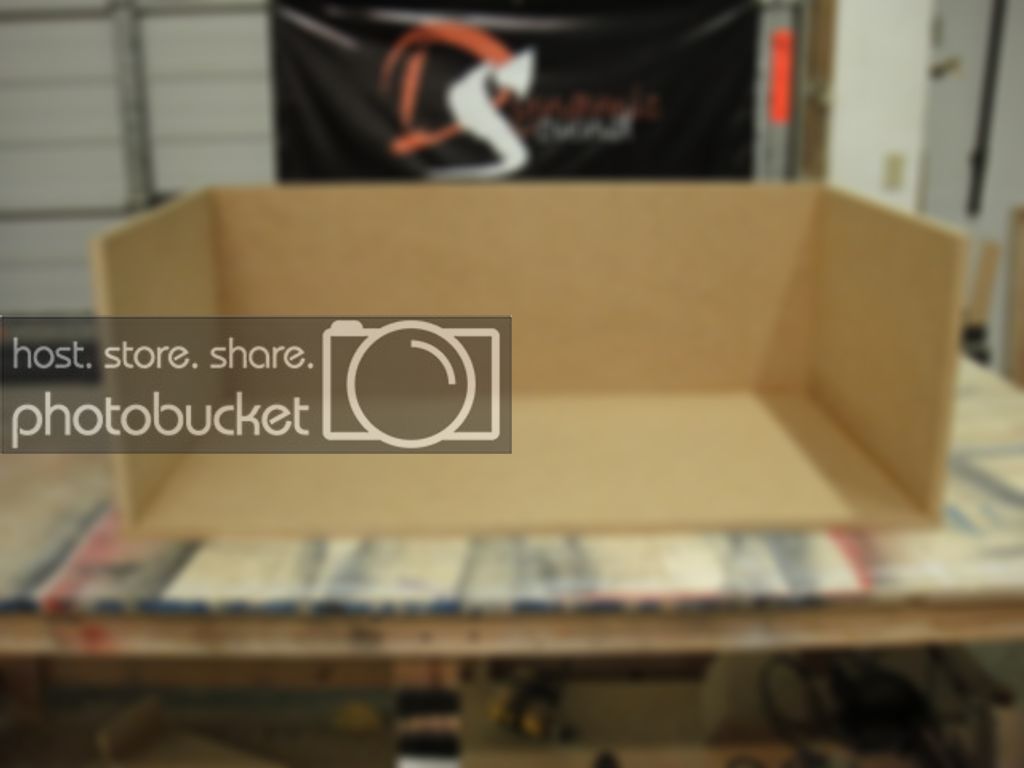

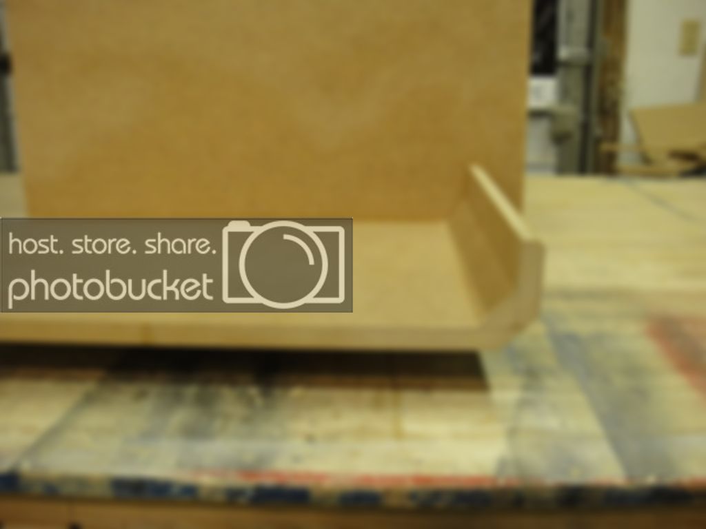

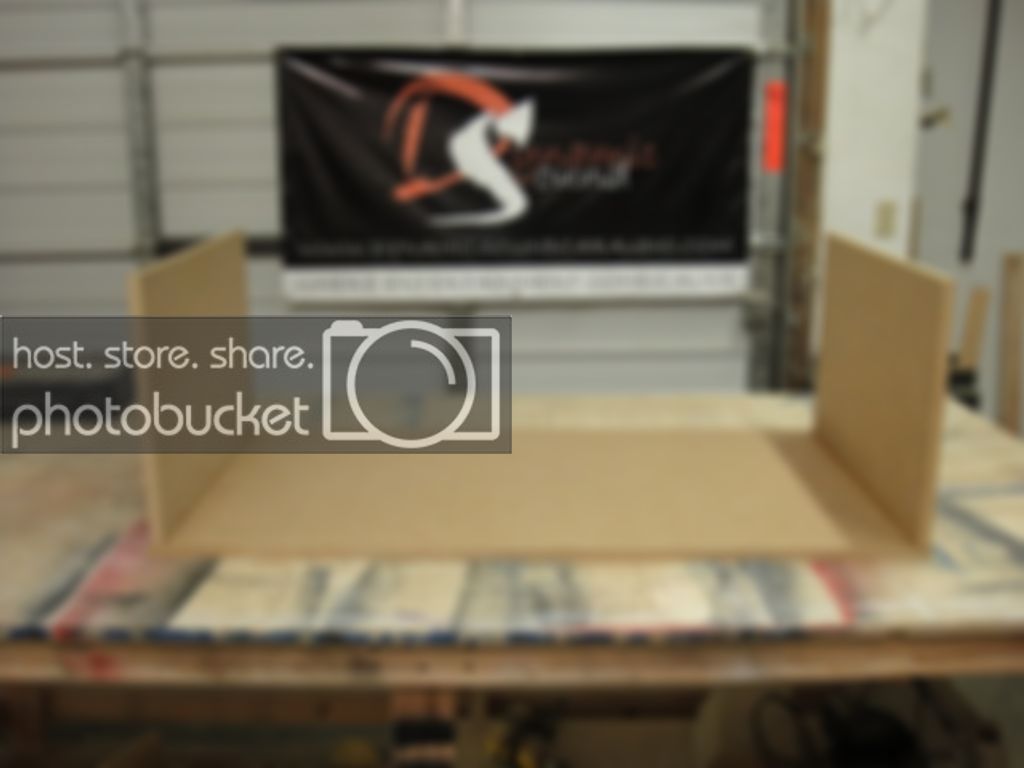

Ok everyone this box is for Utley's three JL Audio 13W7's and is going into an 07 Tahoe.
Box is 7.14 cubic feet after displacement with 84 square inches of port tuned to 32Hz.
