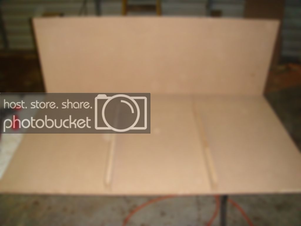

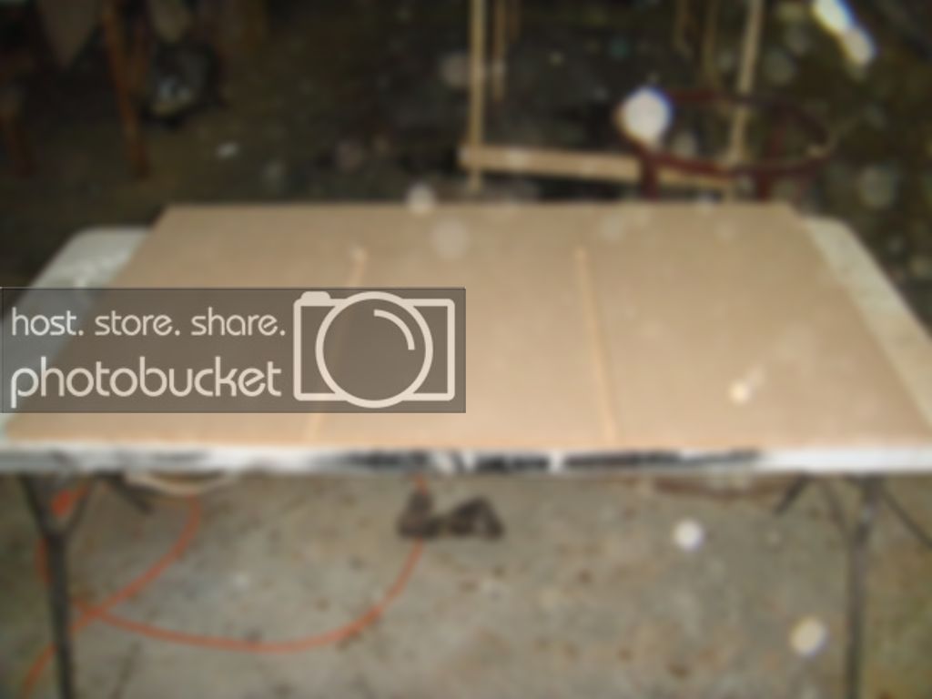

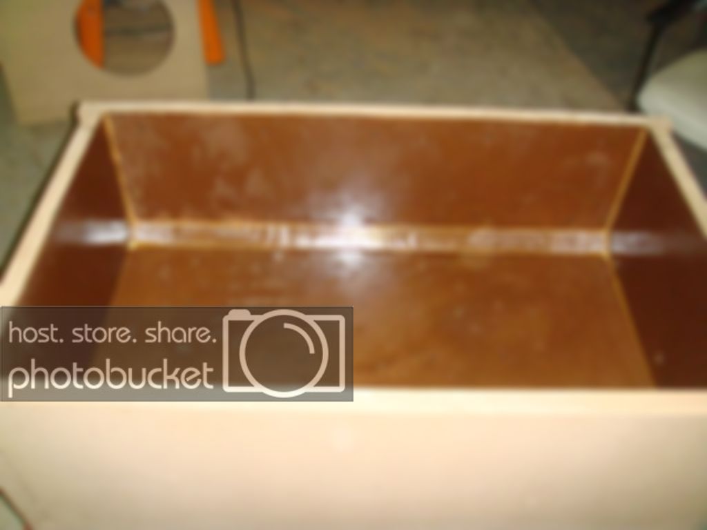

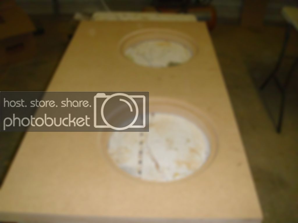

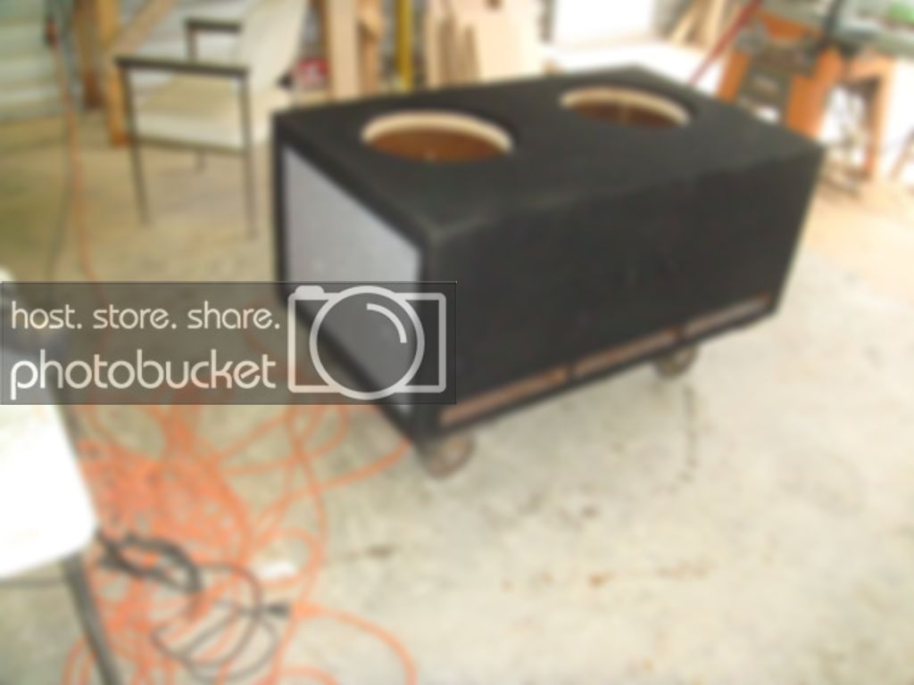

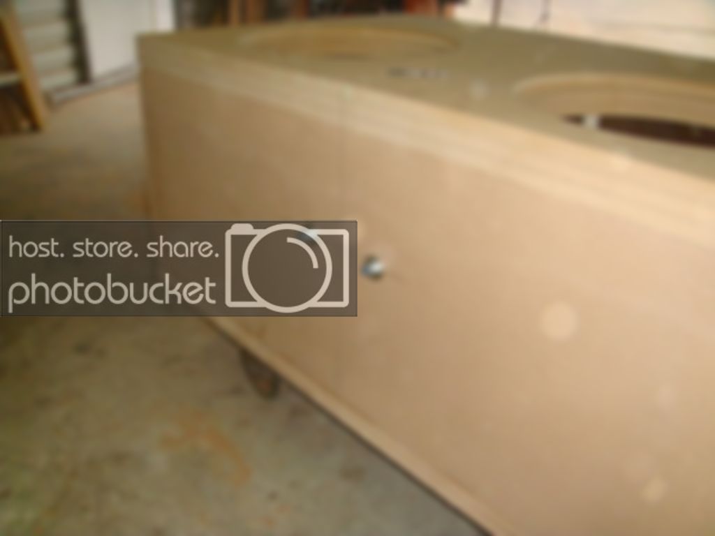

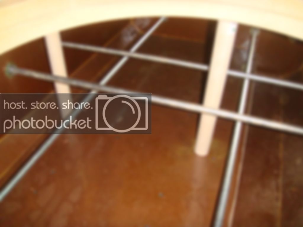

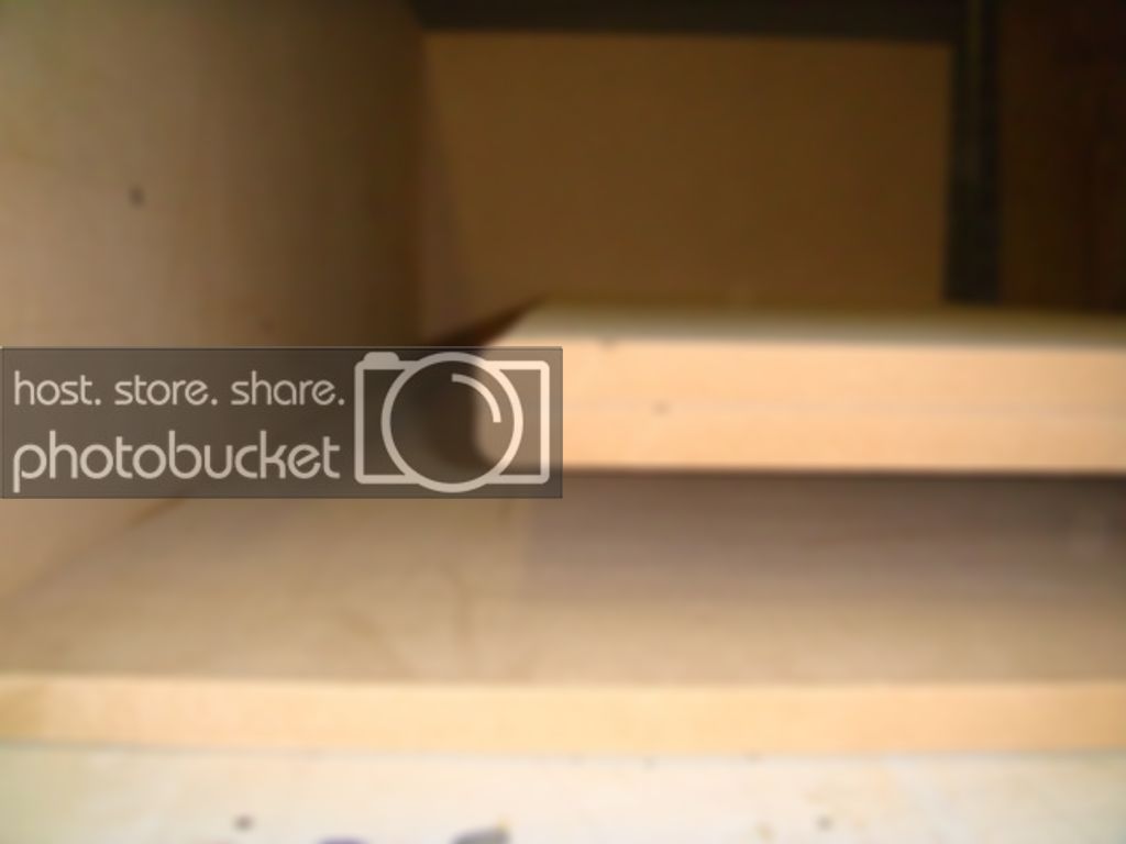

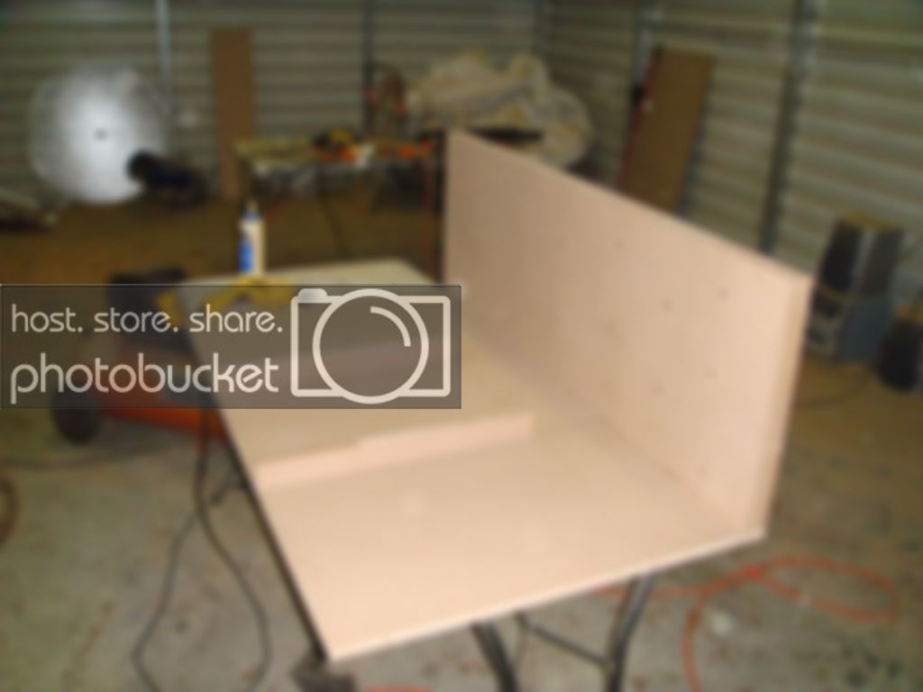

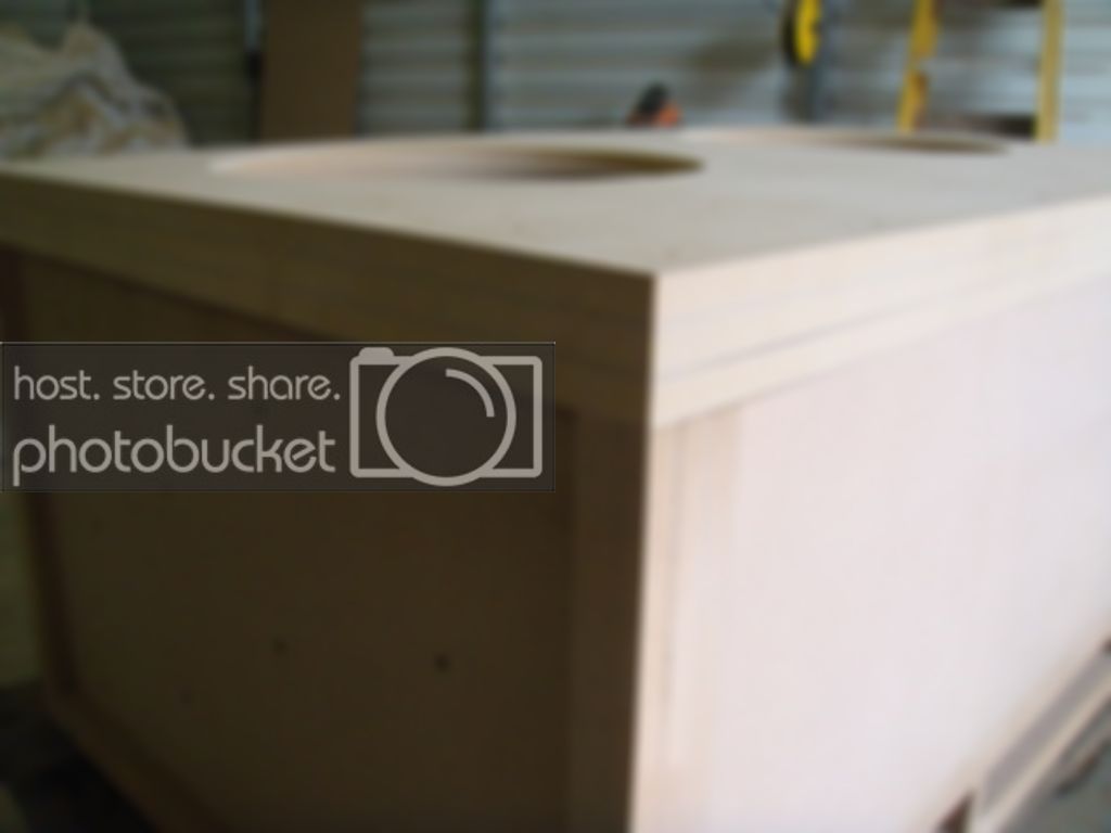

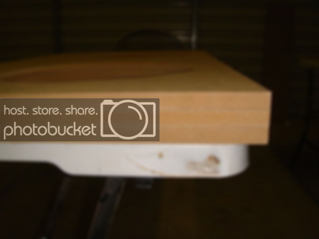

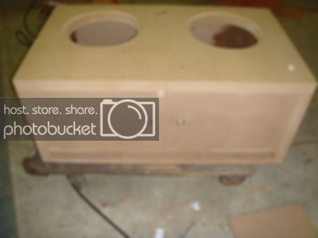

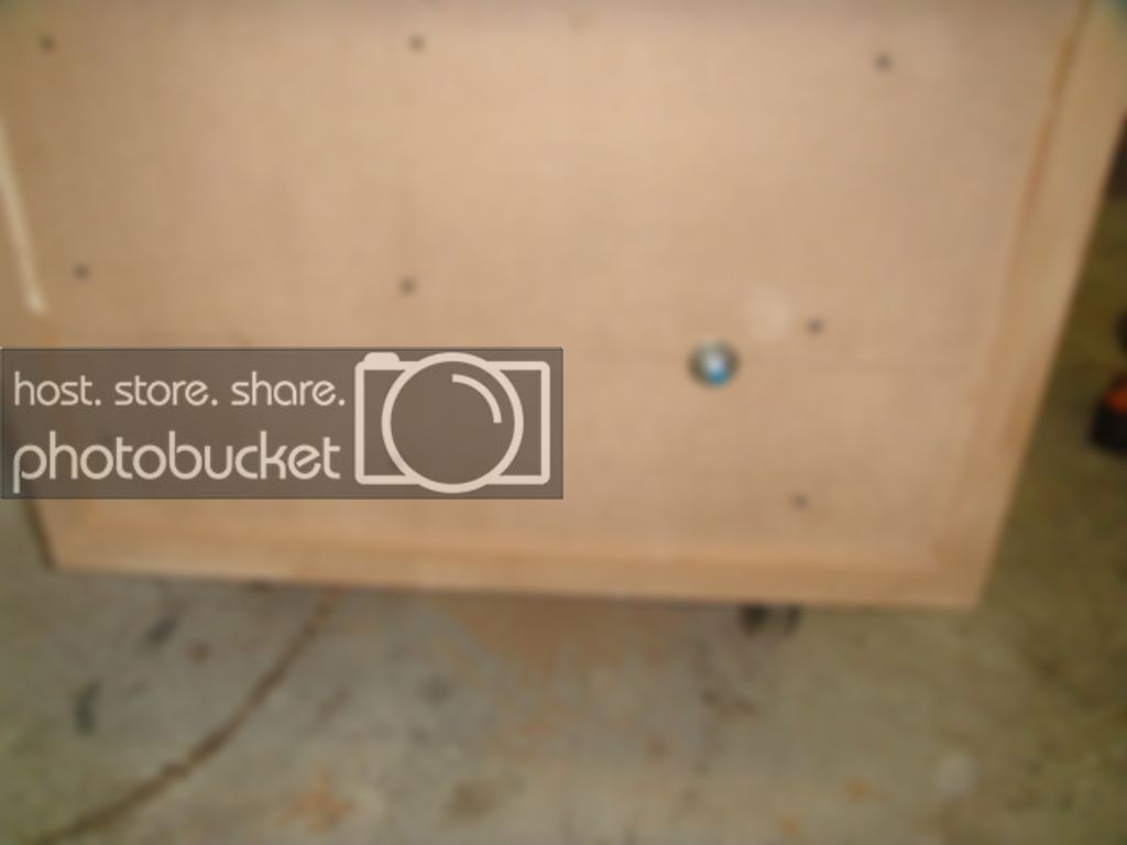

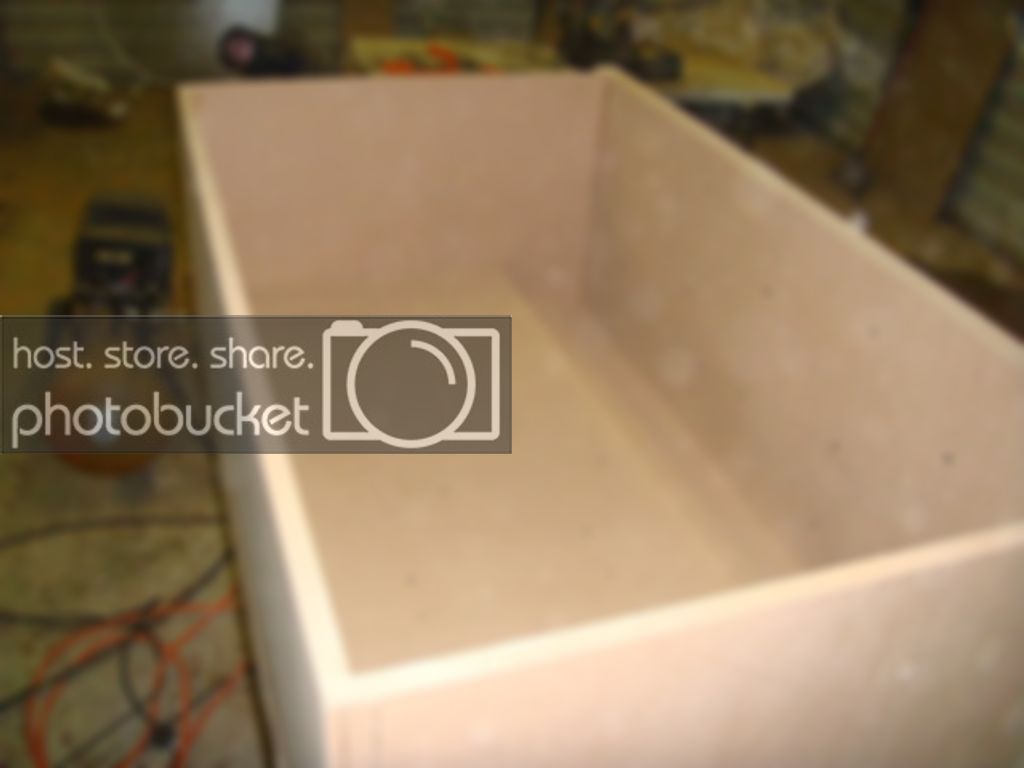

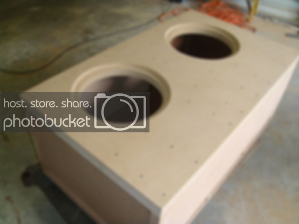

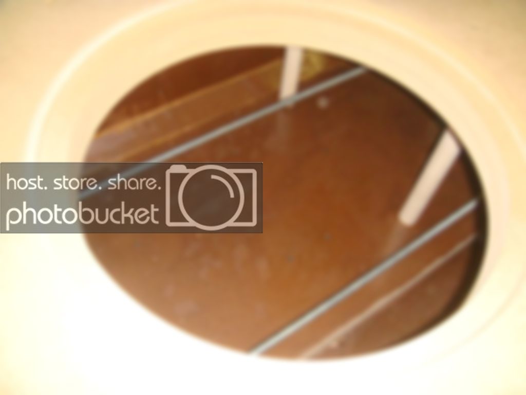

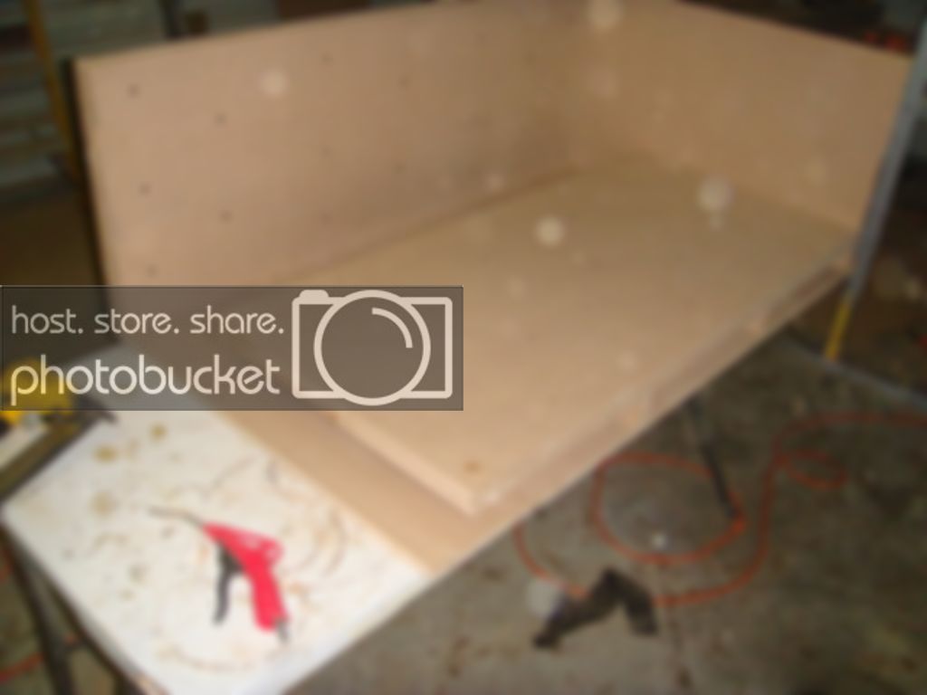

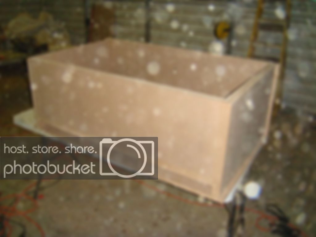

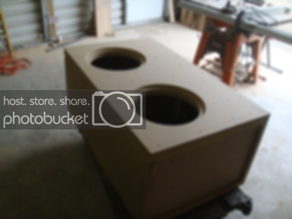

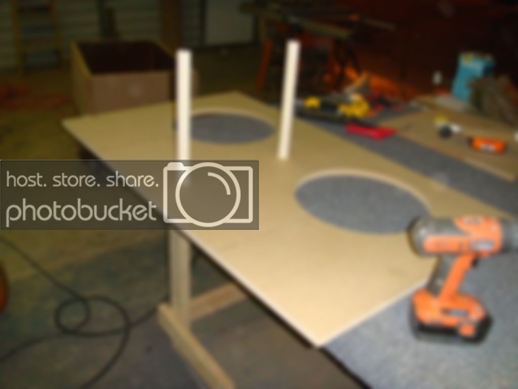

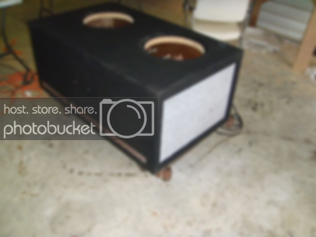

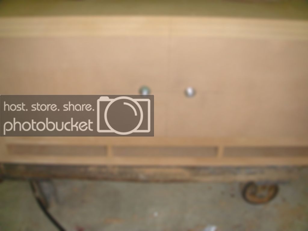

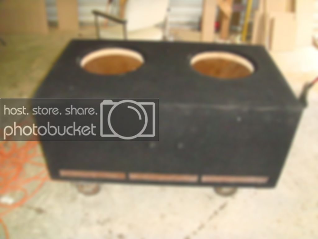

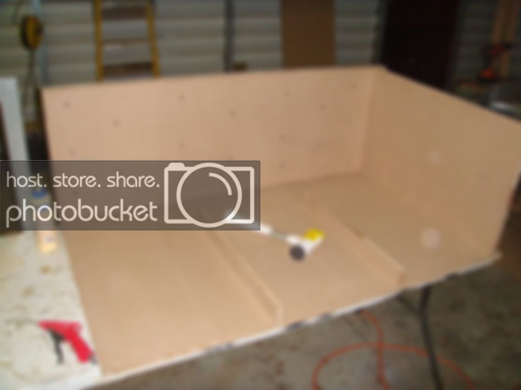

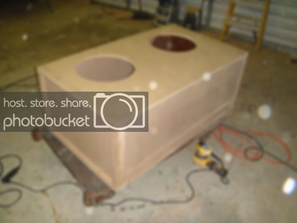

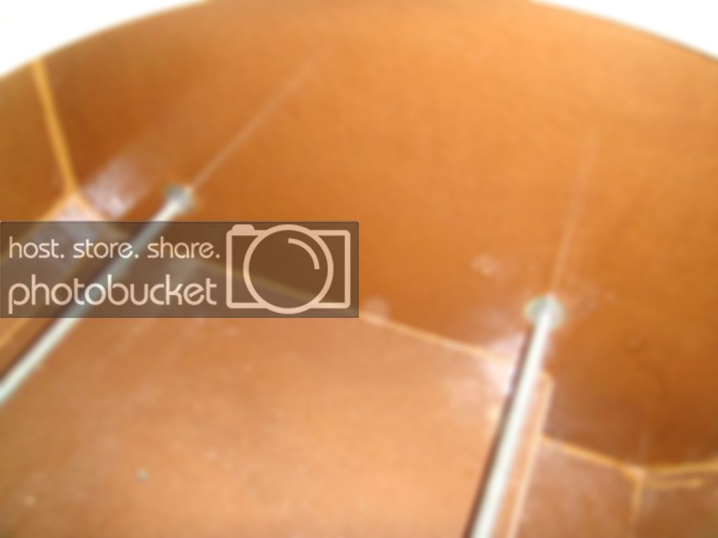

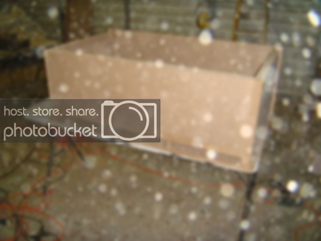

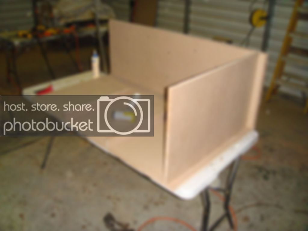

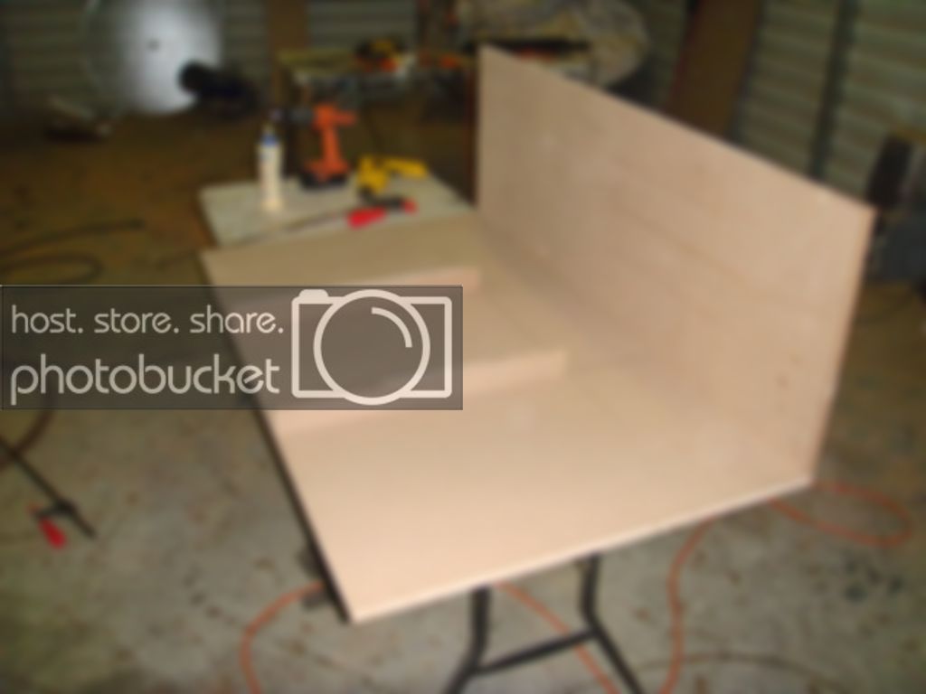

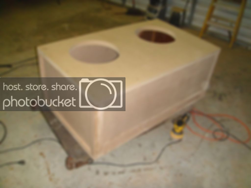

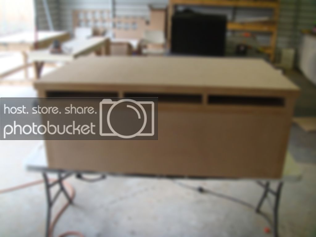

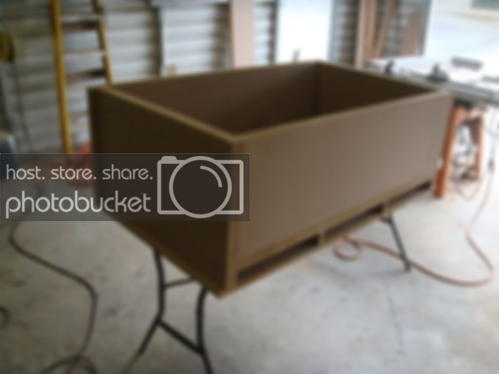

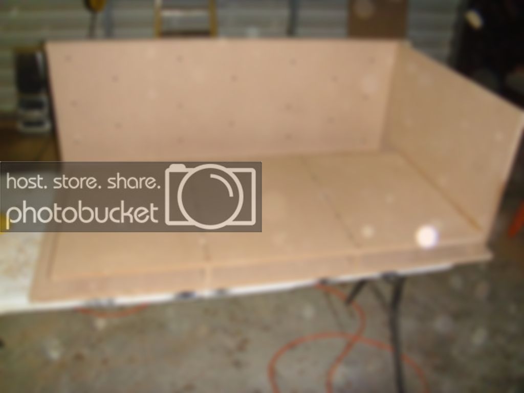

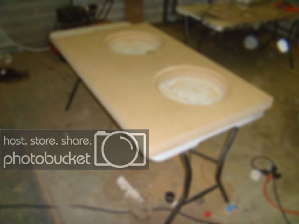

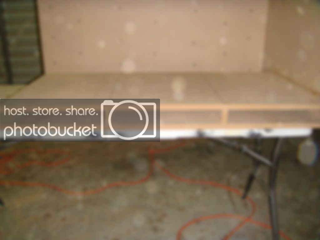

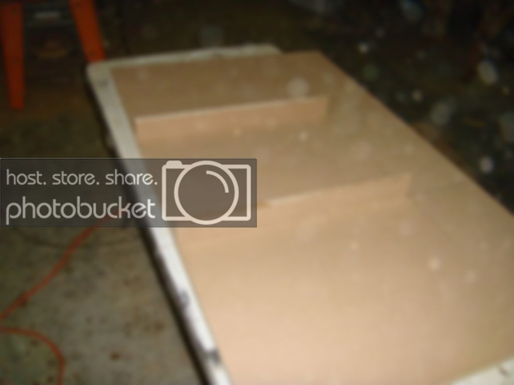

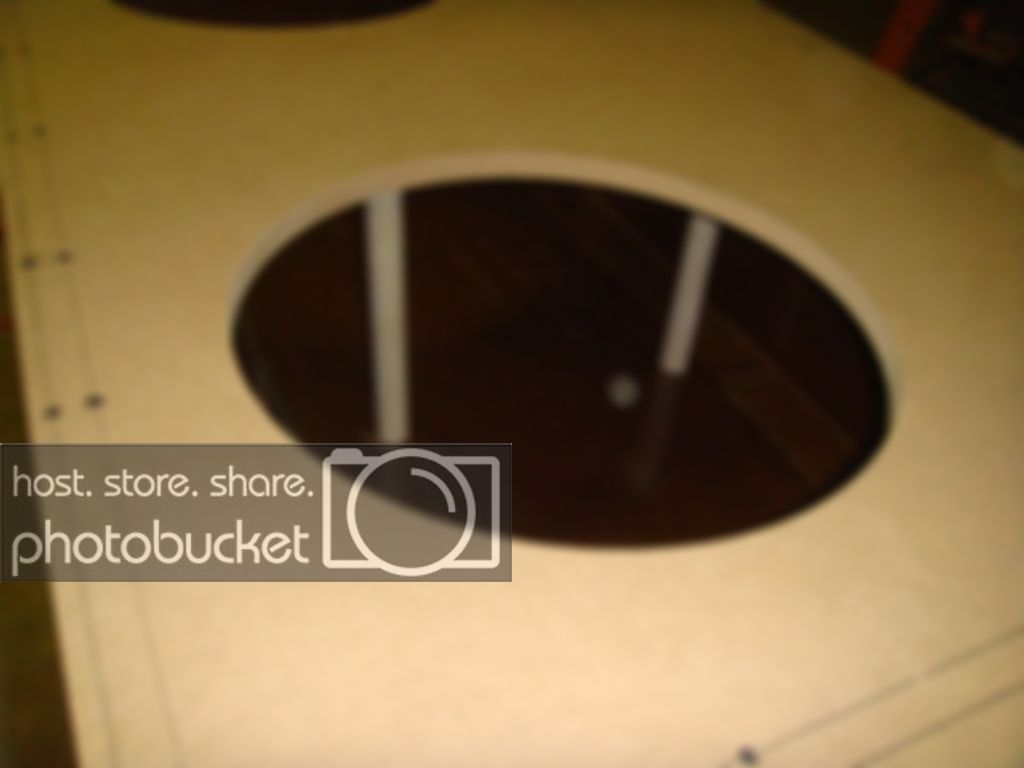

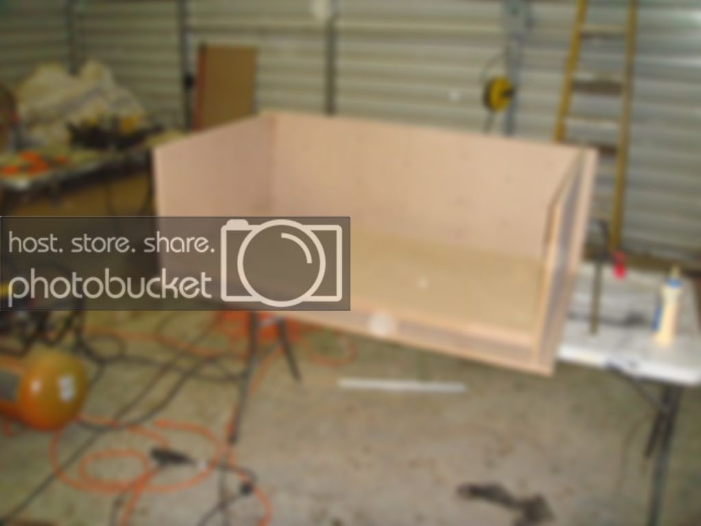

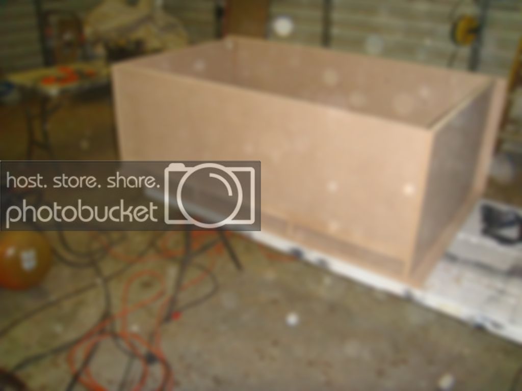

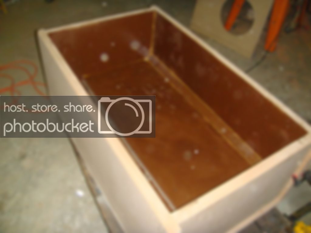

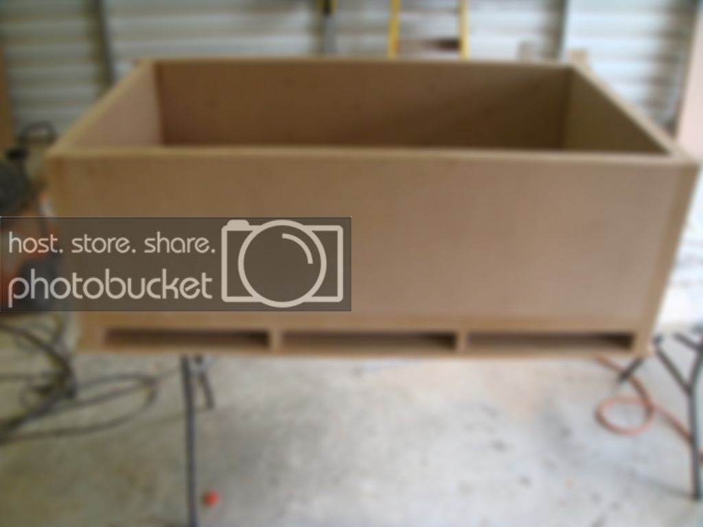

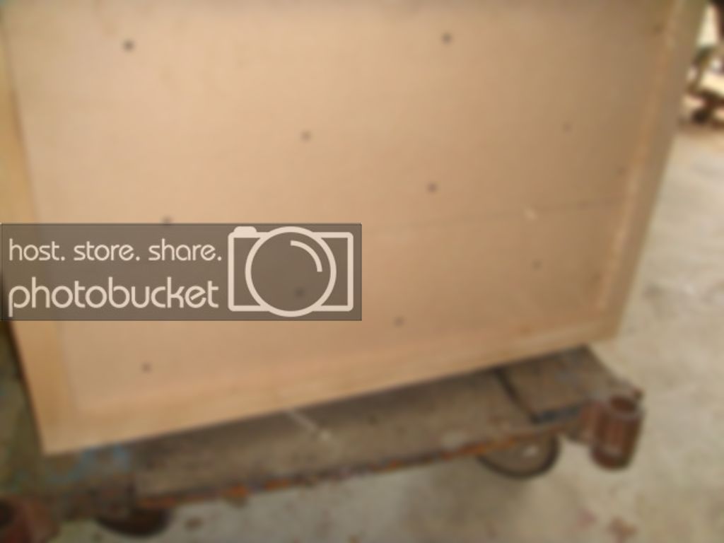

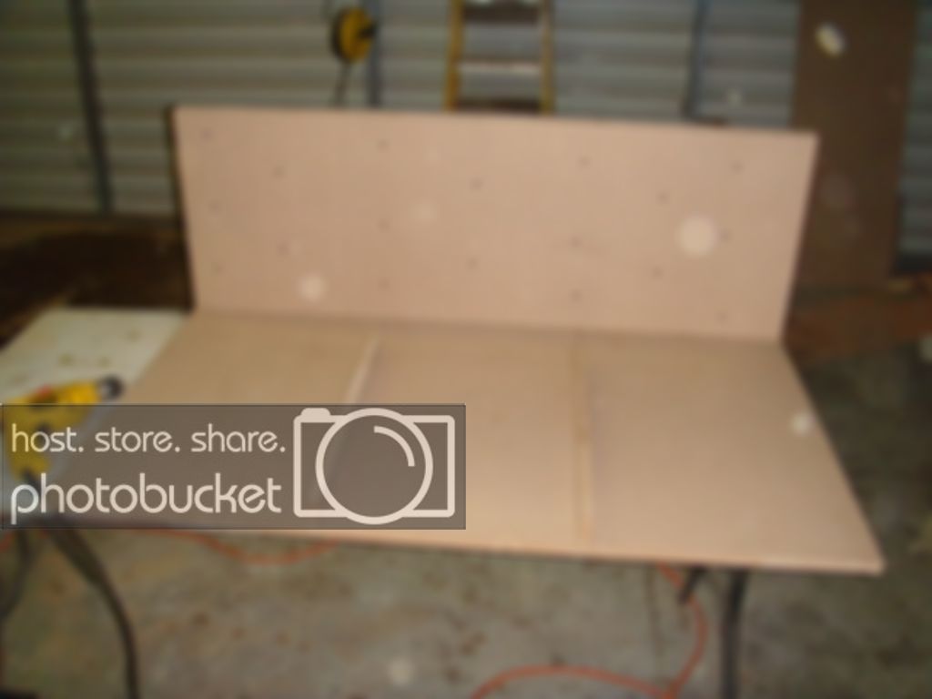

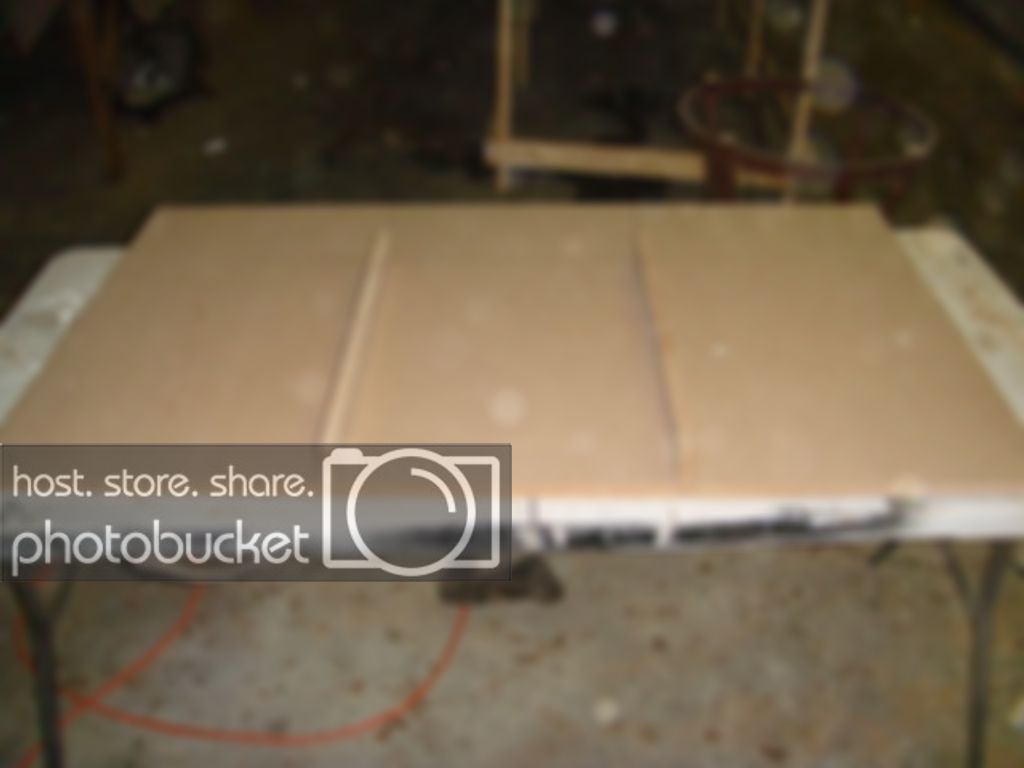

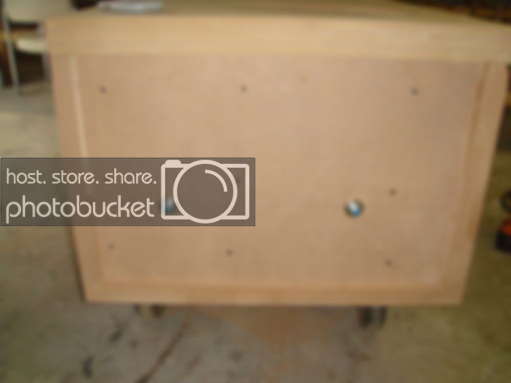

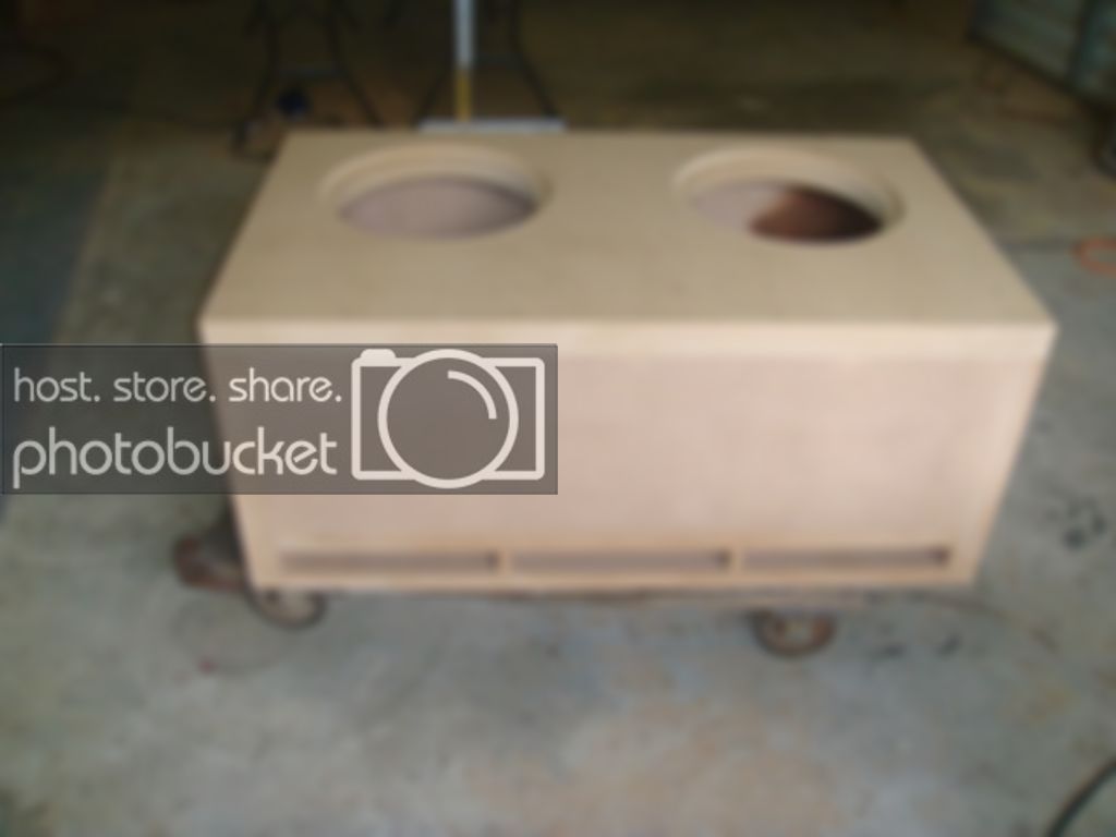

Ok everyone this box is for Steve Miller's 2 15" prototype Alpha Max's. Box is 8.5 cubic feet after all displacements. Box has 80 square inches of port tuned to 32Hz. Box is 1-1/2" thick all the way around with a 2-1/4" top plate.
On with the pics....................
