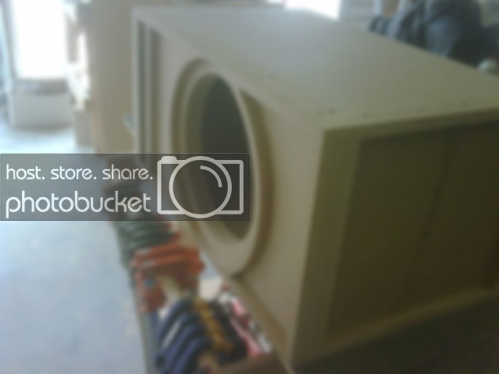

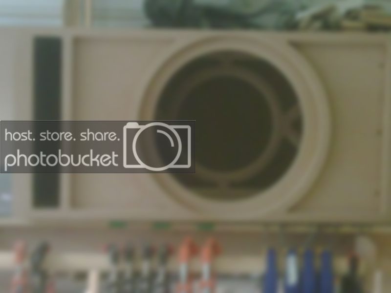

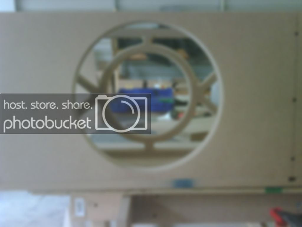

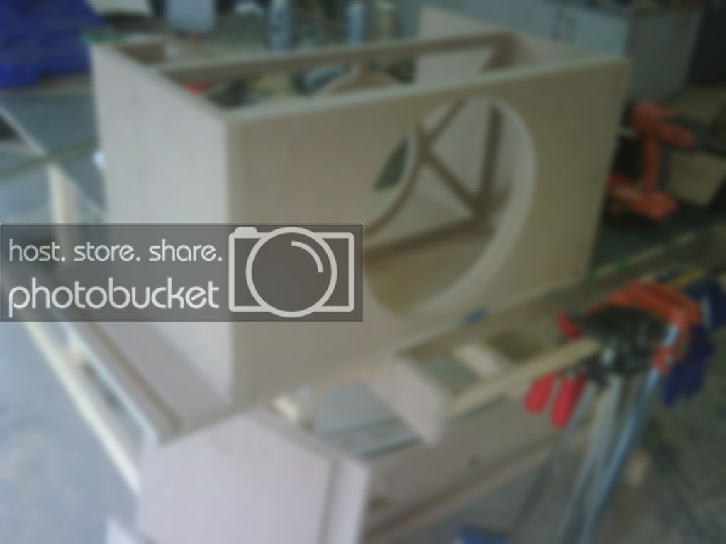

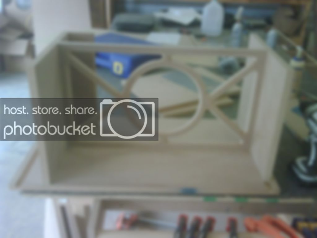

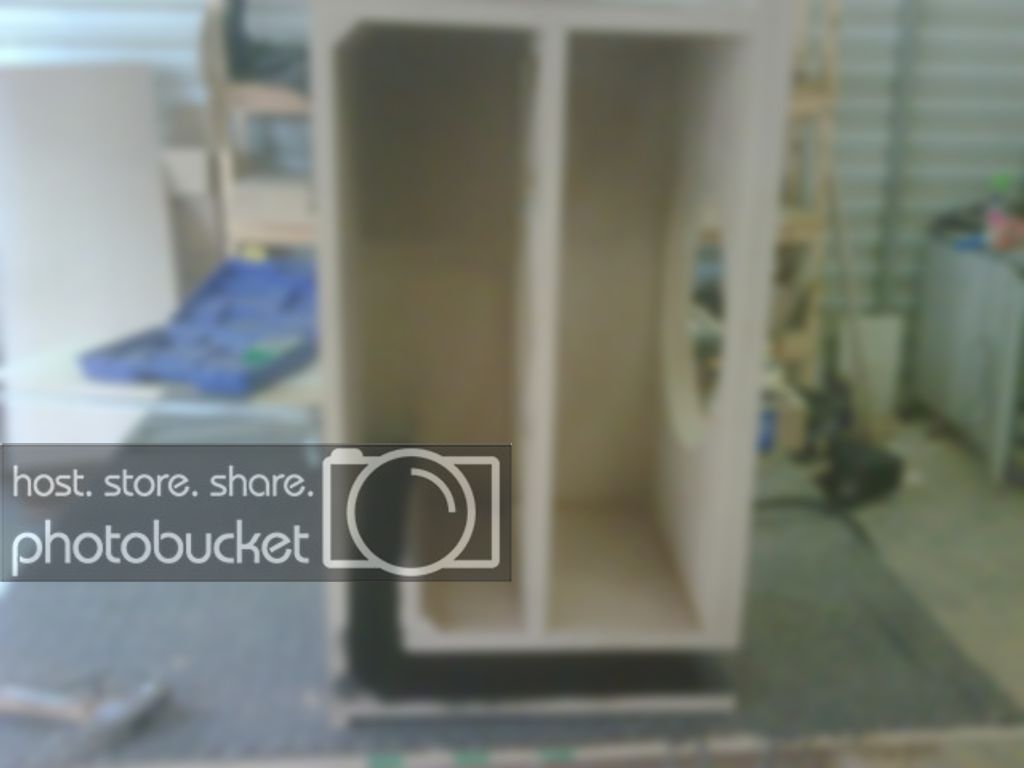

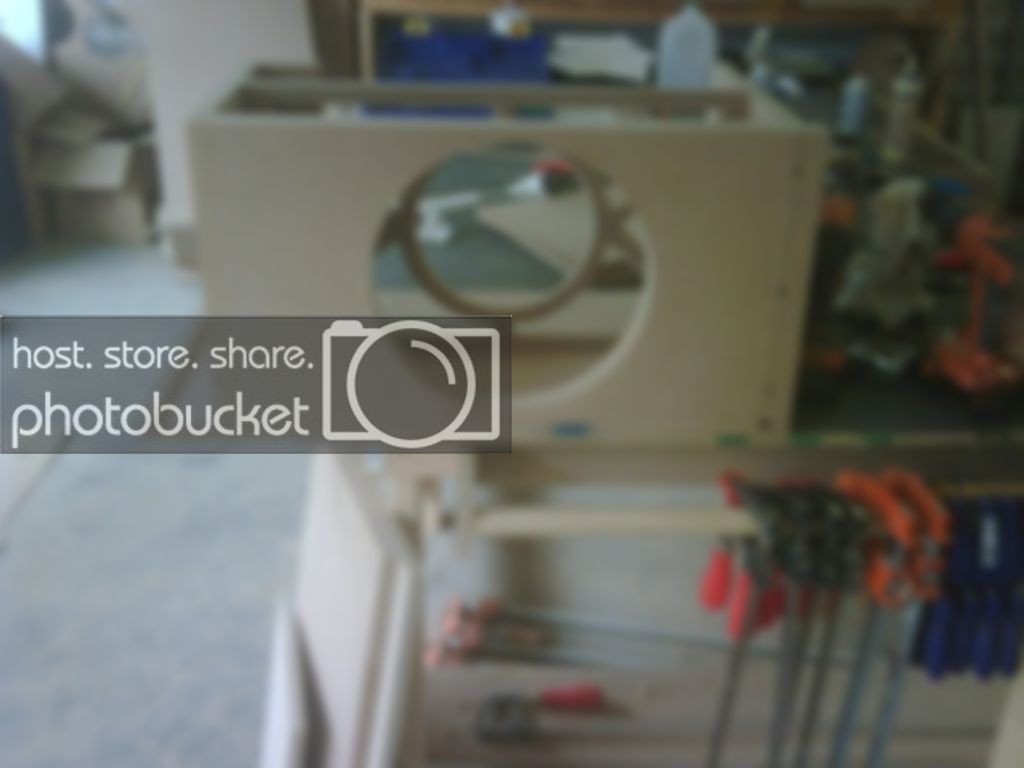

Ok everyone this box is for Rayj211's single 13" JL Audio W7.
Box is 2.5 cubic feet with 31 square inches of port tuned to 35Hz...........

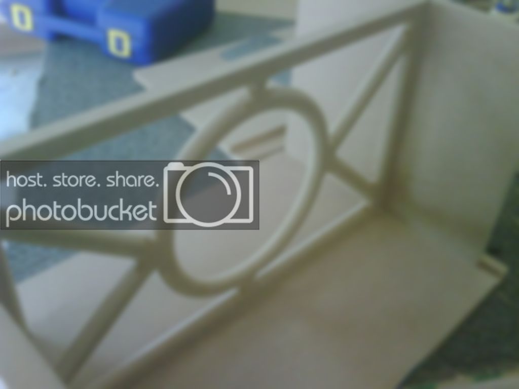

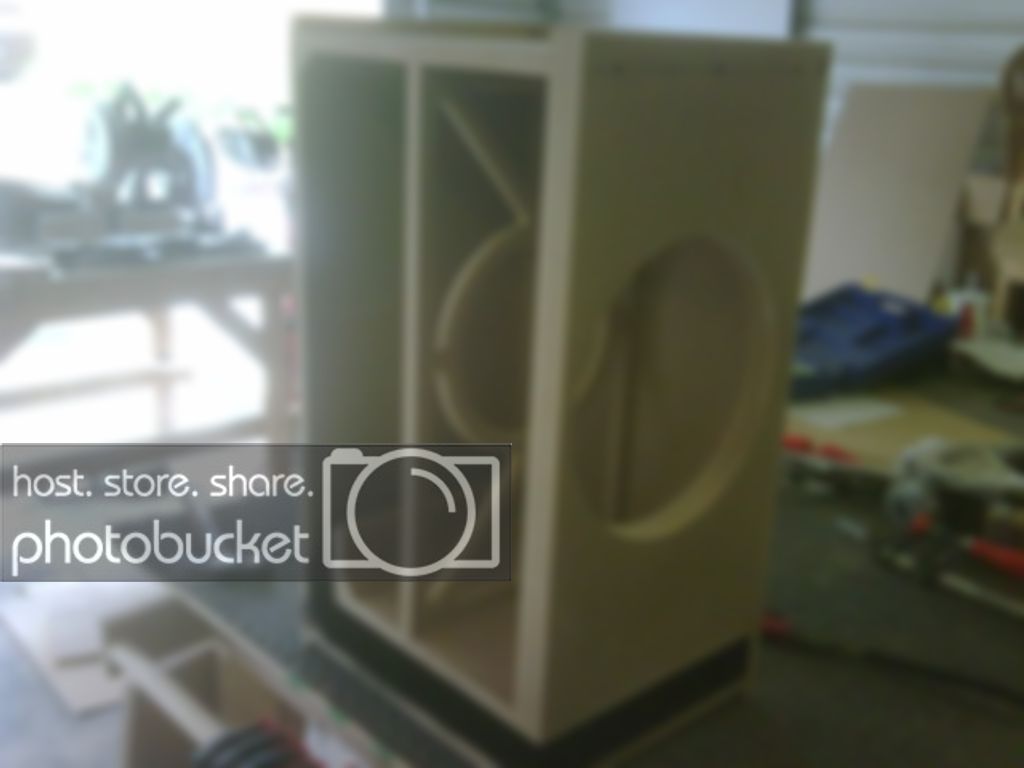

looks good so far good sir. i like the brace looks pretty clean. how come no kerf?? i love the way thoze look!! wait its not my box.... hahaha nice job. you gona wrap it??
Thanks, the customer did not want to pay for a kefered port.
