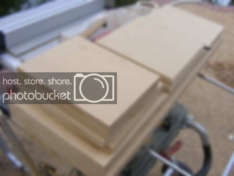

Ok so while i was working on the dash bezel inbetween sanding and what not i built this.

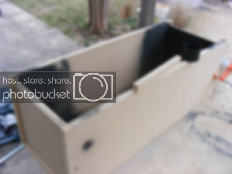

Wood cut edges rabbeted and rounded ports for you rounded port fanboys
Almost all together, 2 ports 1.5" wide on each side with subs on the middle

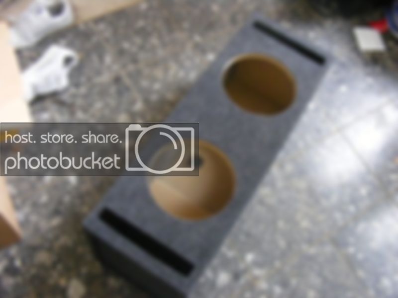

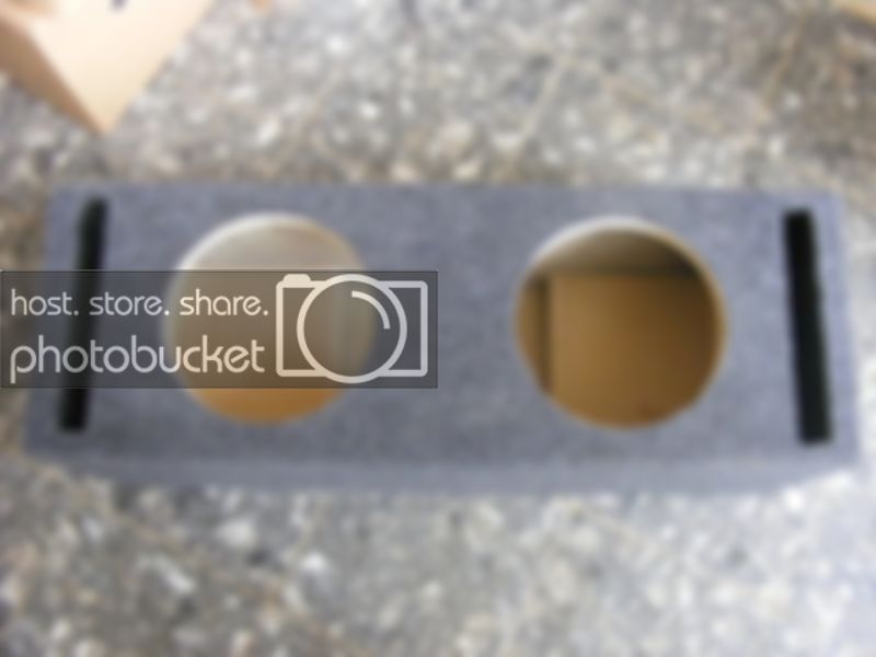

did you rabbet the sides so you can tuck the carpet in there? so theres a seam on the bottom lets say, and then just a sheet of carpet for each side with it tucked all around? what size/kind of rabbet bit do you use?? clean
Yep, makes carpeting tons easier, and i do a 1/8 by 1/8 rabbet
Can you expand on this rabbeting technique? I've never heard of it before and I'm interested in learning. I don't think I've ever done it like that.
Yea, its really simply actually. I have an adustable rabbet bit This one
I dont use a router table I just use my fixed base.
Get the berring for 1/8" and set depth to 1/8", rabbet all four edges. This leaves you with a 1/8" by 1/8" inset on the end caps for you to tuck carpet.
If i need to go more in detail let me know.
^Do you have any detailed pictures? I think I'm still not grasping the concept of what a rabbet bit does. Are you going to the DFW meet? Maybe you can show me there.
Yes i am, ill rabbet a piece of wood and bring the bit and everything to explain more
