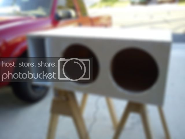

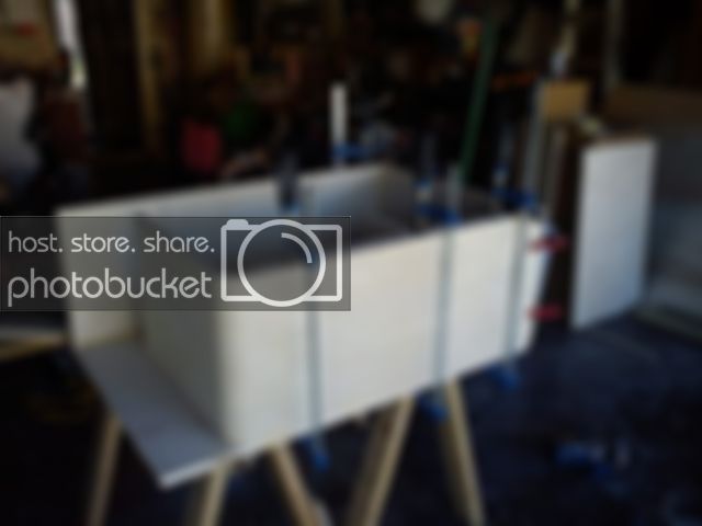

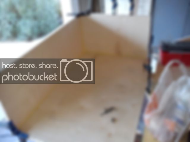

Box is 4.25ft^3@ 34hz for two psi platform 12s ill upload a pic of the design later

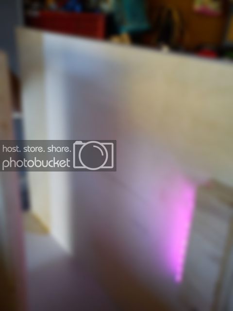

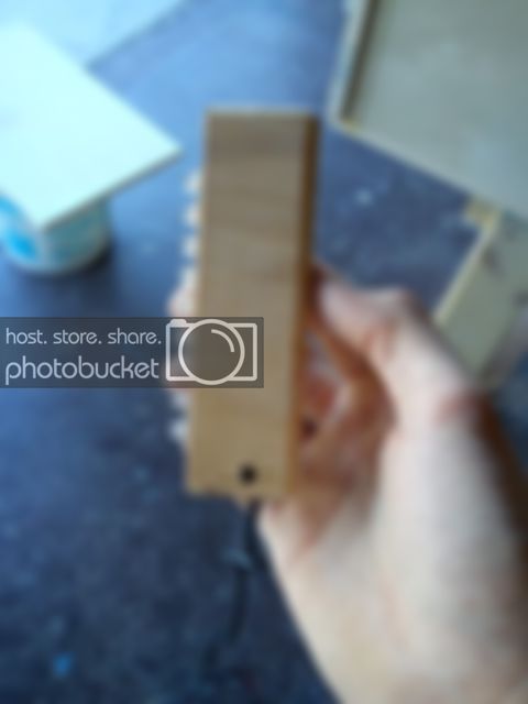

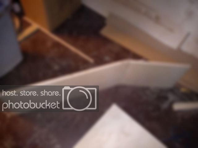

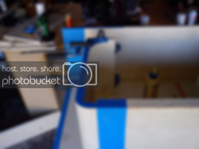

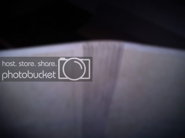

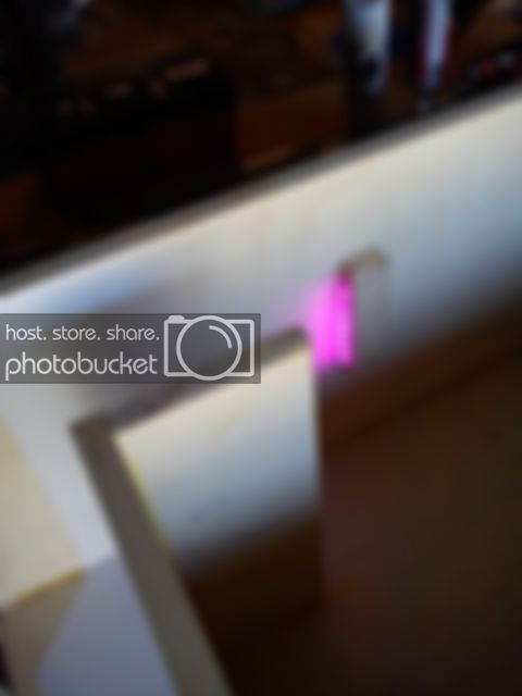

this is how i put LEDs in. using my router table and a 1/4" bt i cut a dado groove. pinches the leds in there nice. also roundover edges to keep it smooth

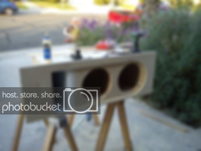

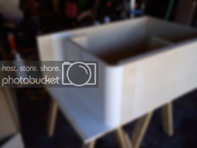

le port

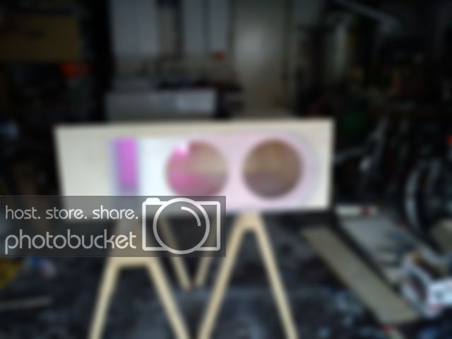

two layers of resin

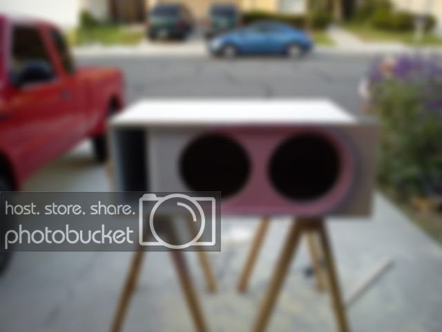

no trim:
with trim:

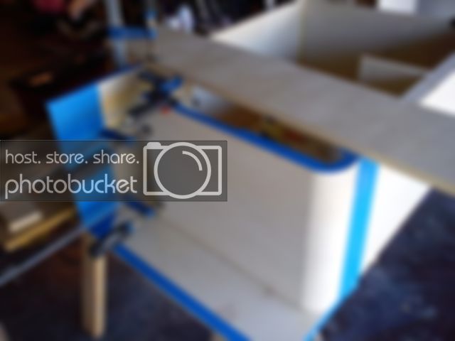

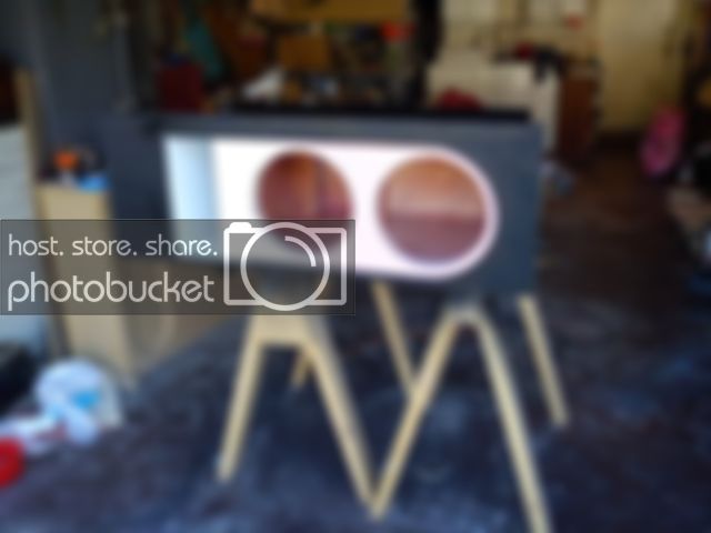

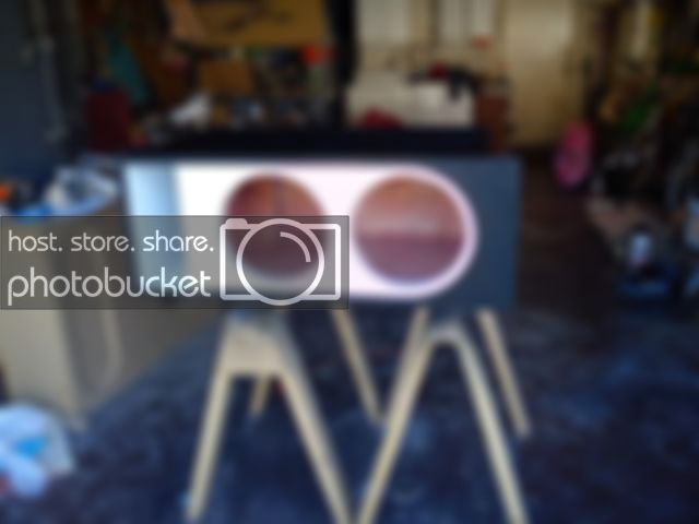

i really wanted to keep it one piece BUT its going from cali to florida. guaranteed breakage lol had to do the trim pieces with wooden dowels
haha! thanks guys. im going to do a couple more coats of a darker pink to the right. if you can tell right now its a white to light pink fade. customer wants a darker pink on the right
