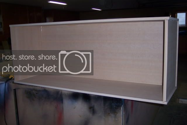

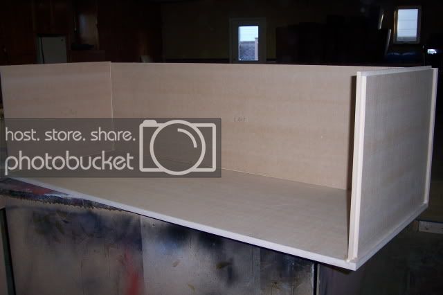

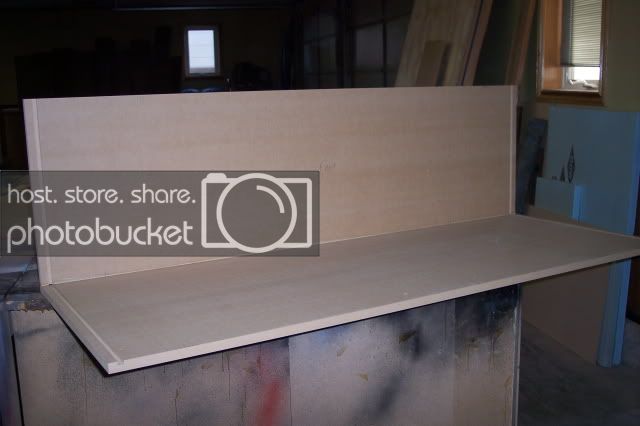

Got a nice BIG sealed box for a quartet of 15" Havocs. Pretty straight forward build with a decent amount of internal bracing. Onto the pics...

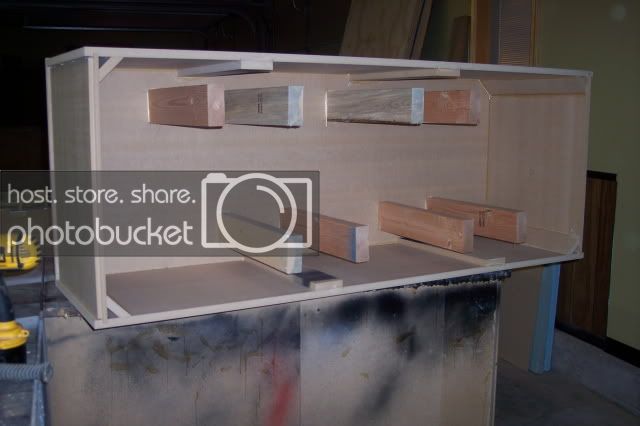

Haha. Nice. But, to be honest, kinda looks like you just randomly threw in planks of wood for the bracing. If it works, it works.
I think its the angle of the pic, and the fact that the top panel isnt on. There actually is a reason as to where the bracing is placed. //content.invisioncic.com/y282845/emoticons/wink.gif.608e3ea05f1a9f98611af0861652f8fb.gif
The 2x4's running top to bottom are staggered to fit the woofers between them. I don't really expect the 3/4" strips on the front and back walls to do much. If we can't easily fit any extra bracing front to back I'm just going to threaded rod it in a few places.
Pretty simple really. We have over 160 lbs of drivers up firing. We dont want any flex //content.invisioncic.com/y282845/emoticons/wink.gif.608e3ea05f1a9f98611af0861652f8fb.gif
