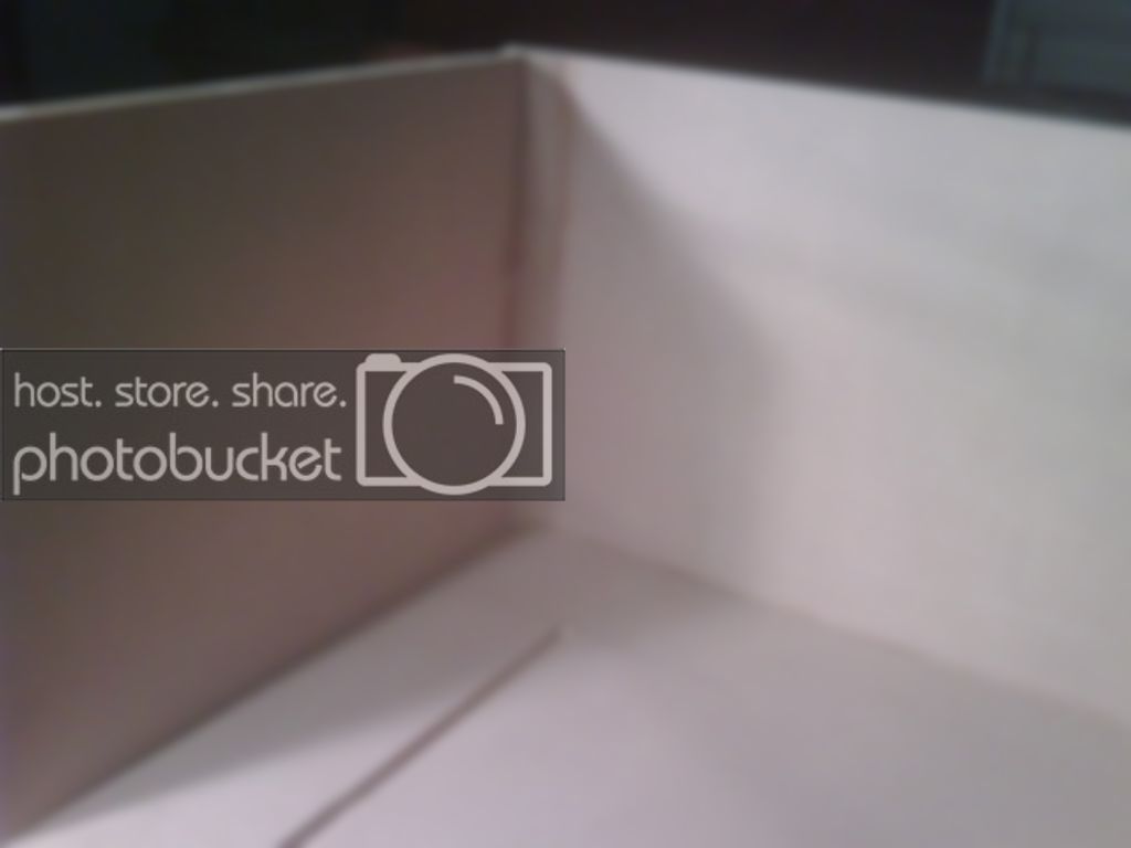

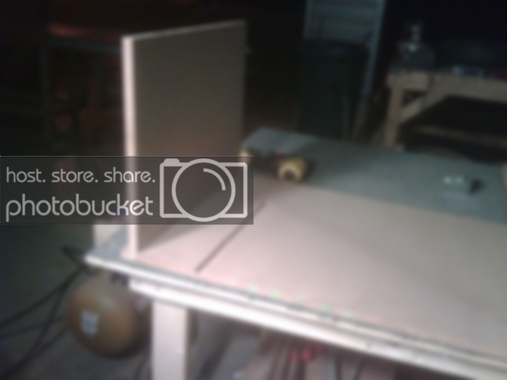

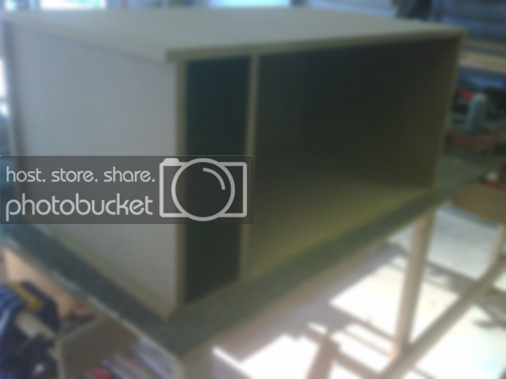

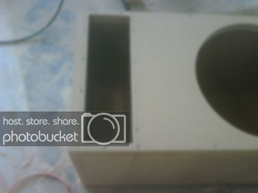

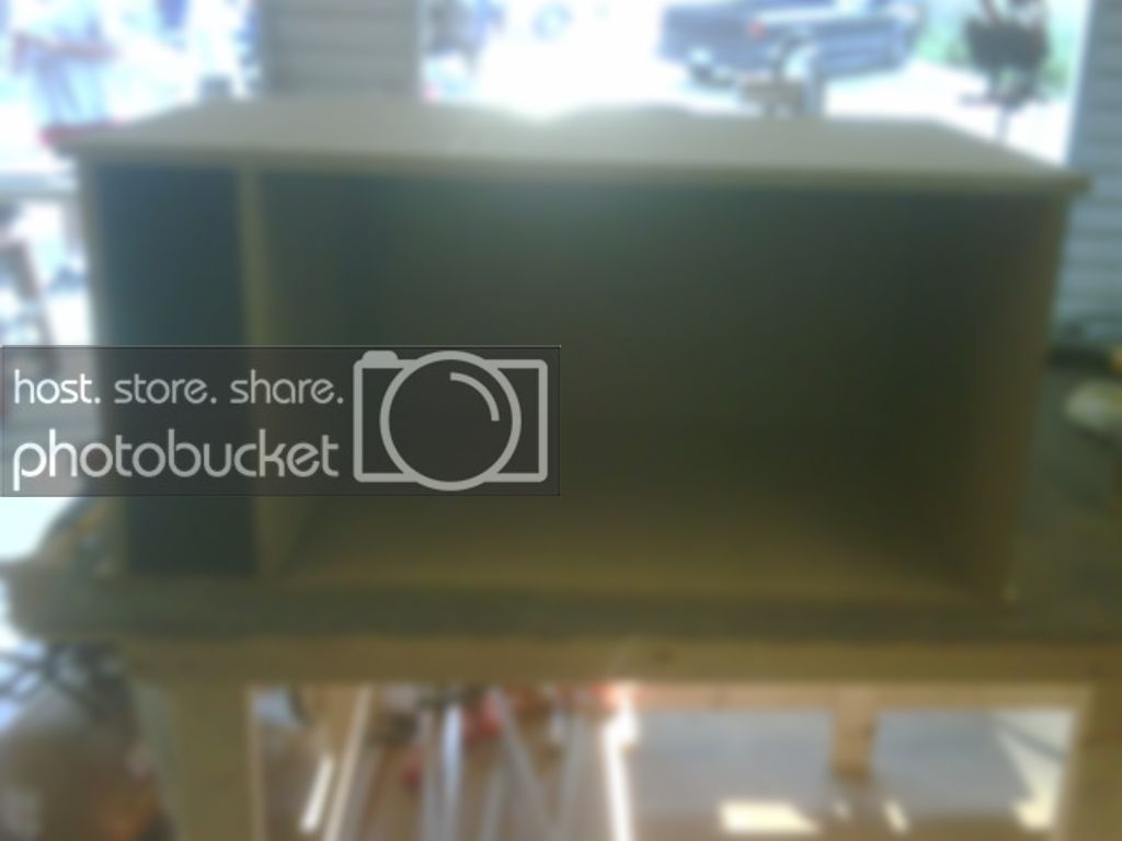

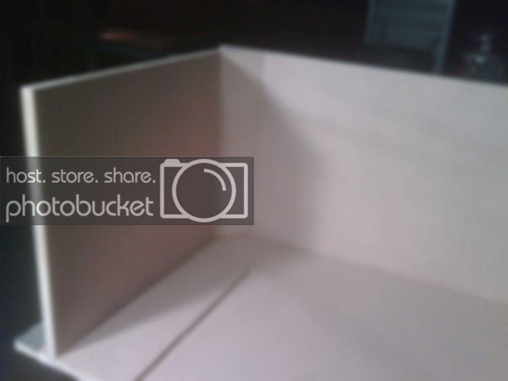

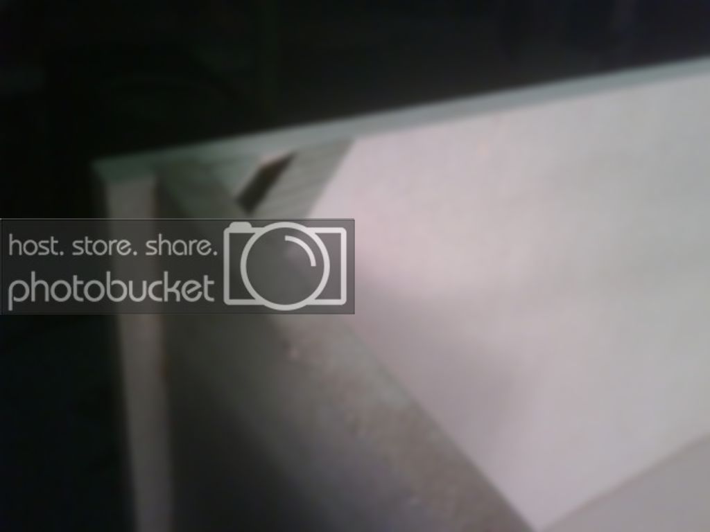

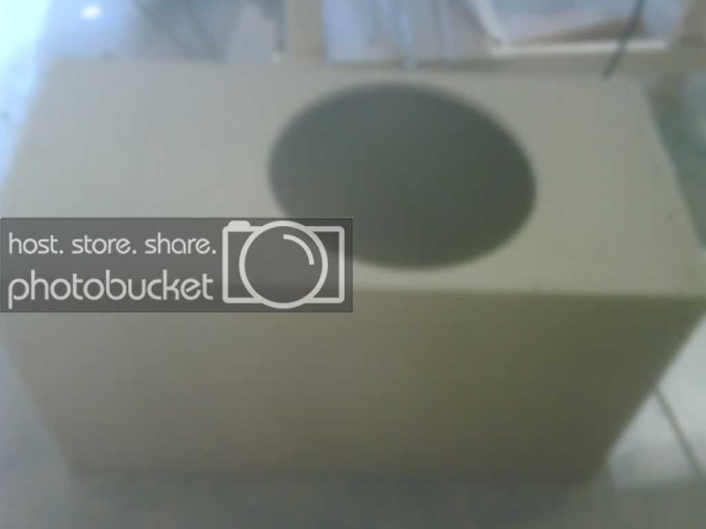

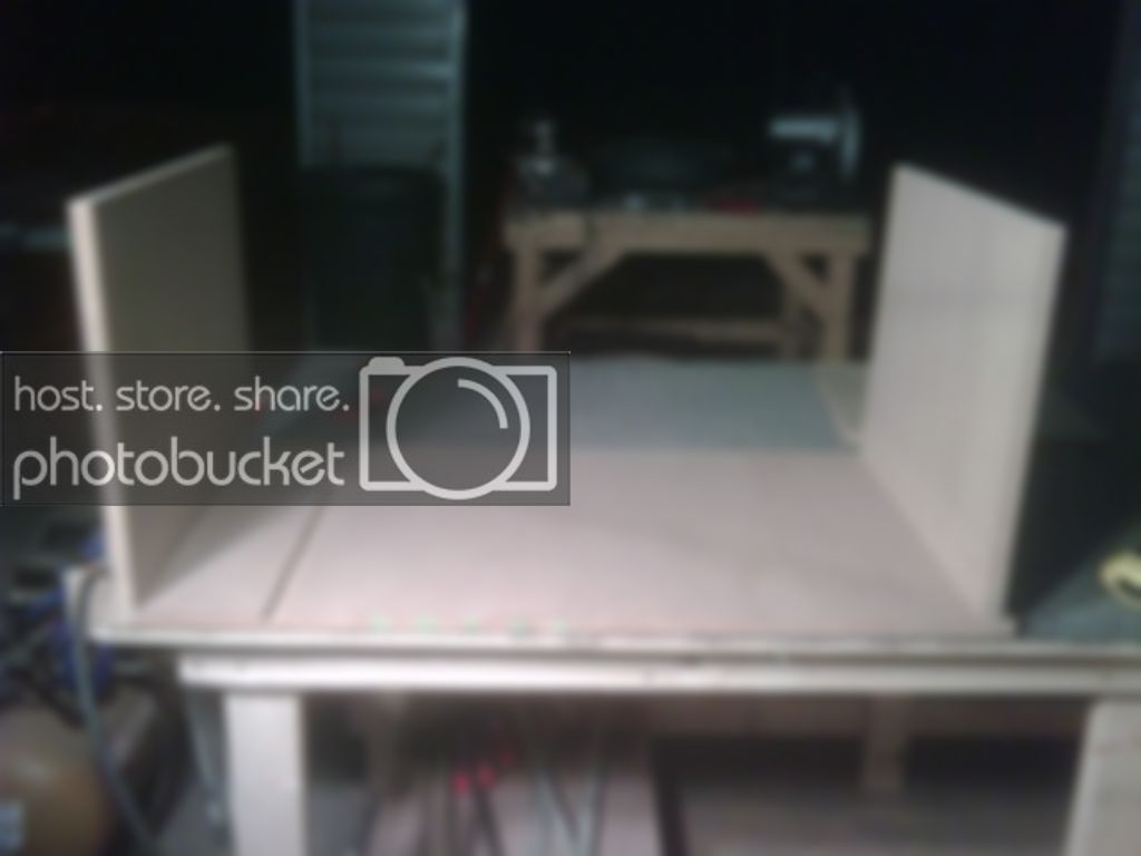

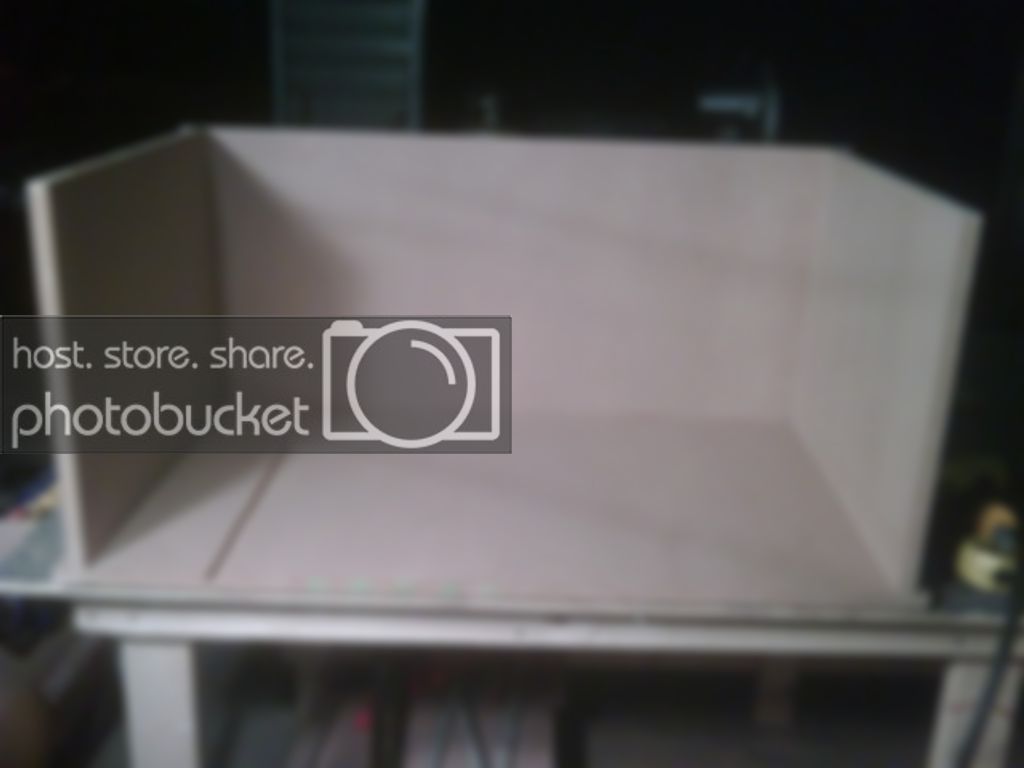

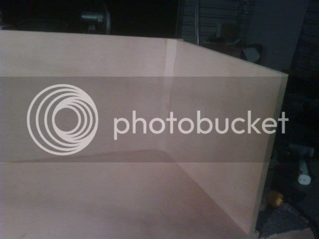

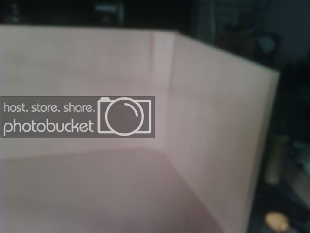

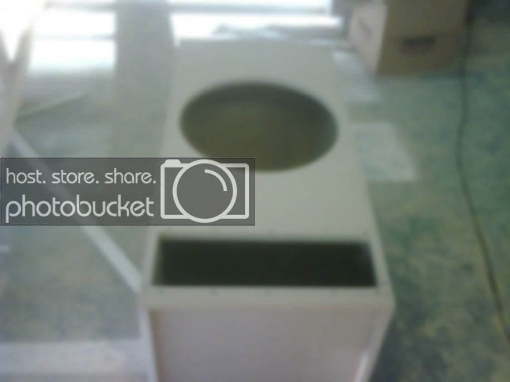

Ok everyone this box is for dnice3183 's single 18" Audio Que HDC3.
Box is 6.0 cubic feet after displacement with 97 square inches of port tuned to 38Hz.
More to come so stay posted........................

And just to be on topic //content.invisioncic.com/y282845/emoticons/tongue.gif.6130eb82179565f6db8d26d6001dcd24.gif Nice box... as I've noticed with your other box builds, your recessed router cuts make for a flawless, perfectly square box. //content.invisioncic.com/y282845/emoticons/thumbsupwink.gif.129404938effda6ad9cca39e7f4b58a3.gif
