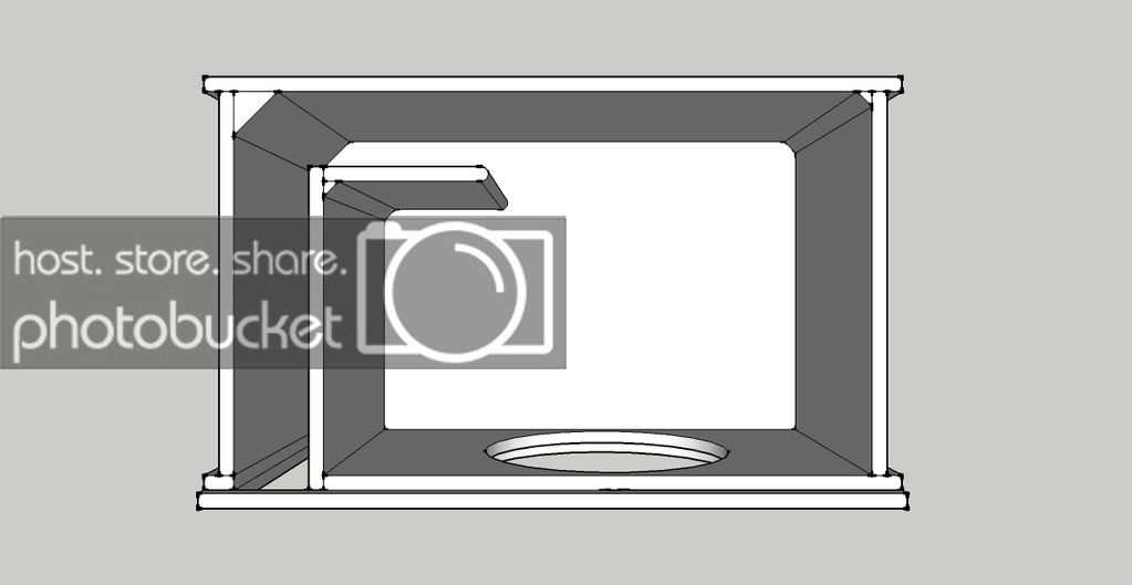

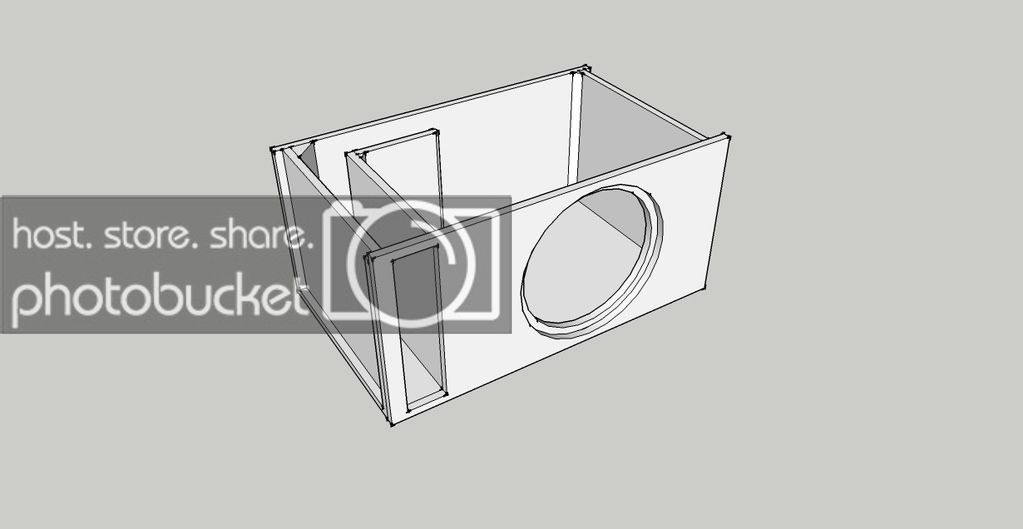

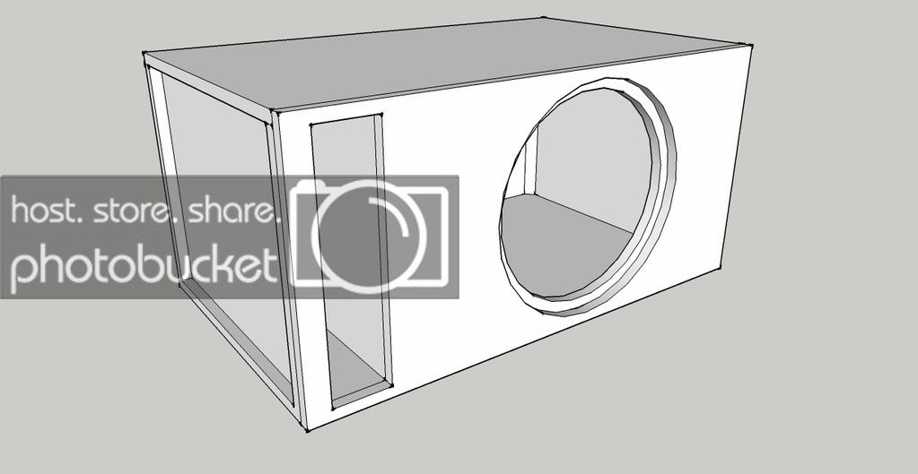

Ok guys this bos is for DEV01 and his single 15" FI BL. Box is 4.2 cubic feet after all displacements. Box will have 58 square inches of port tuned to 32Hz. Box will have a double baffle and sub will be flushed.
Here is the design..................
nice designs. but i still dont understand why you always make the sides double like the baffle when you could just make the side walls 3/4 longer. less wood, less cuts. but nice nonetheless. i got to learn me some google sketchup or w/e program this is. customers love seeing it before its built.
Na, when I build it The front will be one entire piece. I just render it that way because I am lazy:fyi:
