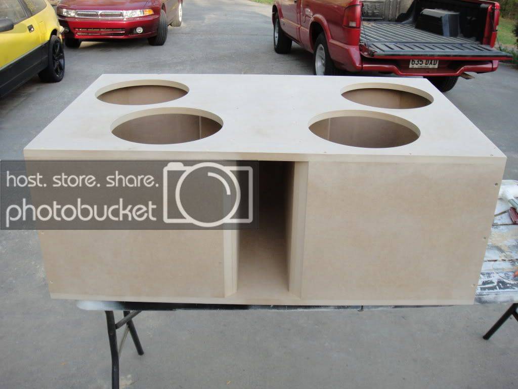

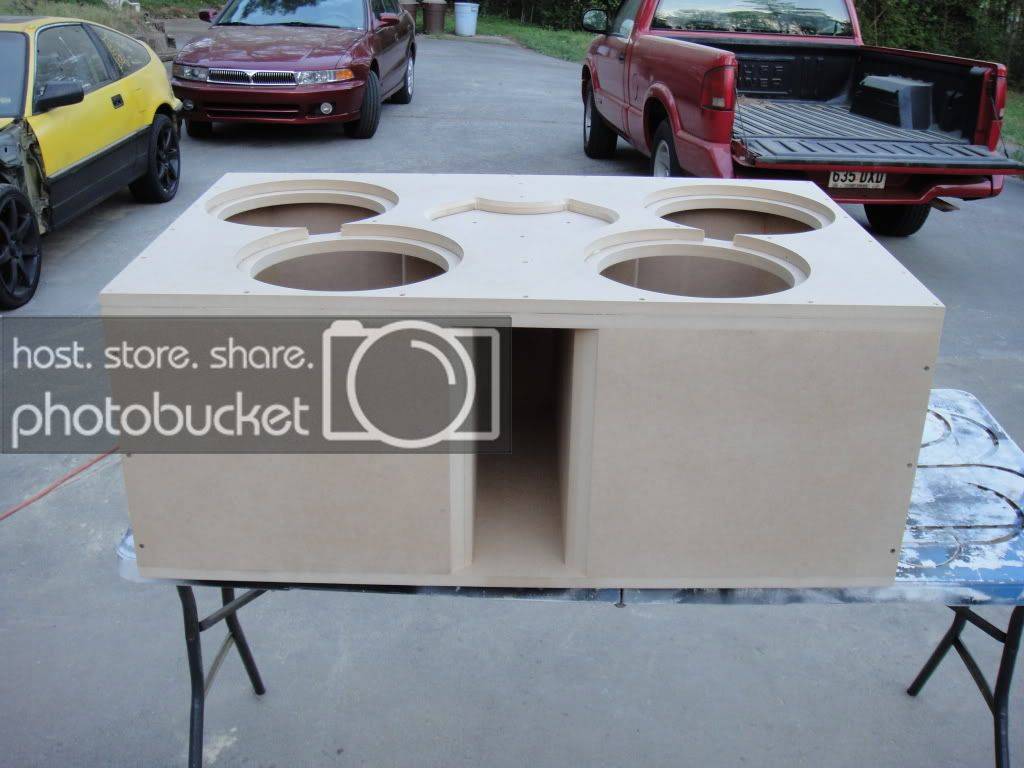

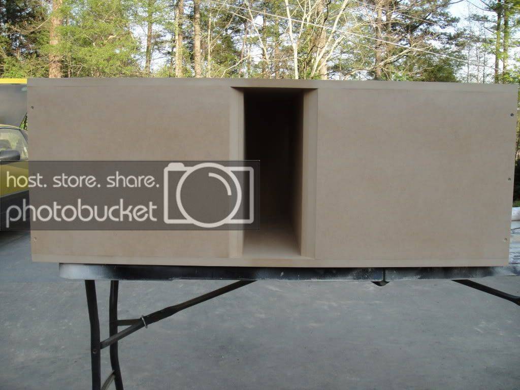

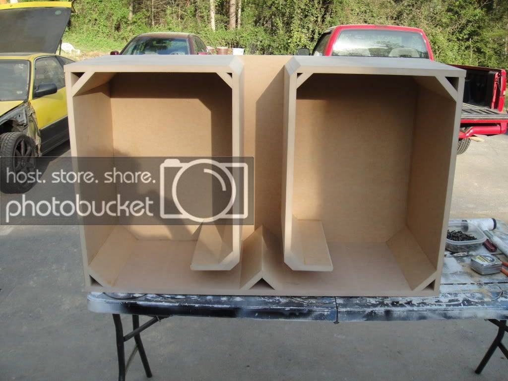

Ok everyone this box is for David's four Kicker CVT 12's
Box is 6.8 cubic feet after displacement with 80 square inches of port tuned to 31Hz
"CVT"? As in thin mount? Box looks awesome, as usual, but why would he have thin mount subs to have a huge box? No big deal, just kind of bugs me
I know it seams like it is big but it is near what Kicker calls for (Their sealed "SQ" box is 4.6 cubic feet for a single 12) LOL

Just an "in general" rant here but if thats the case, why even make them thin mount ? Stupid Kicker IMO.

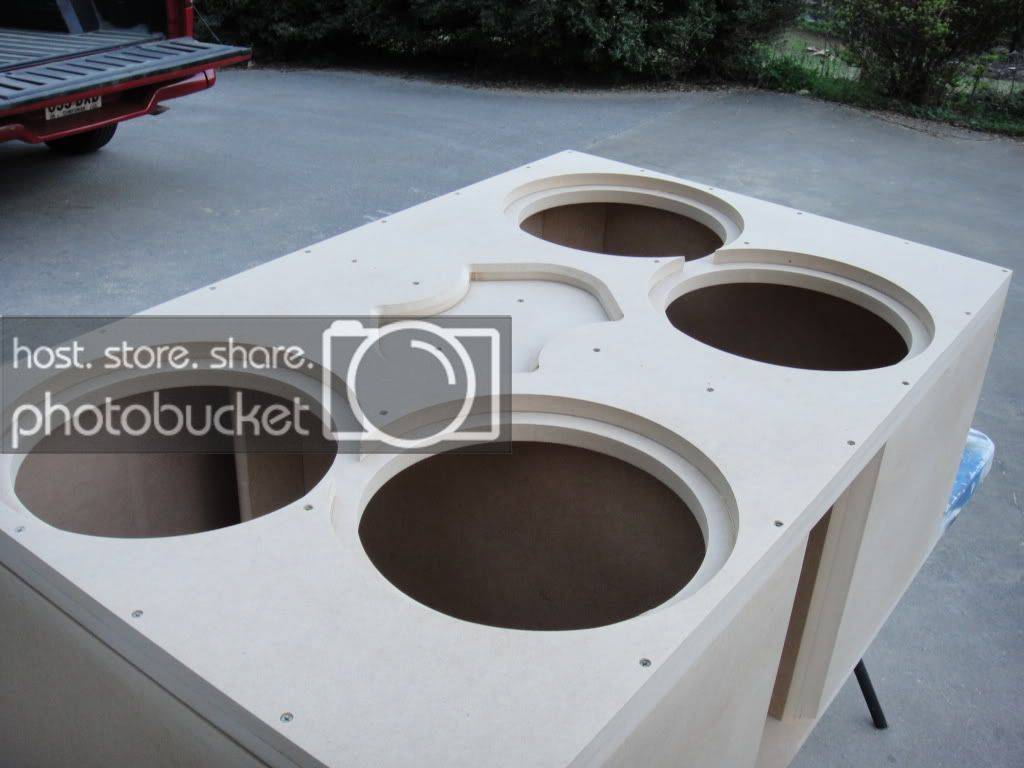

you're boxes make me so mad....all of your cuts are "perfect"...all of ur angles are "perfect".....my boxes look decent, and all my cuts aren't off no more than like 1/64th of an inch, which isn't horrible, considering i use a circular saw....but your's look so perfect....i envy your work

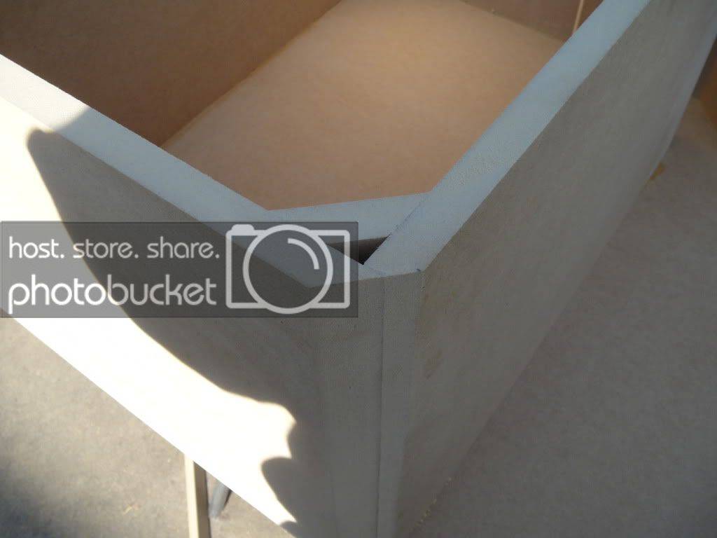

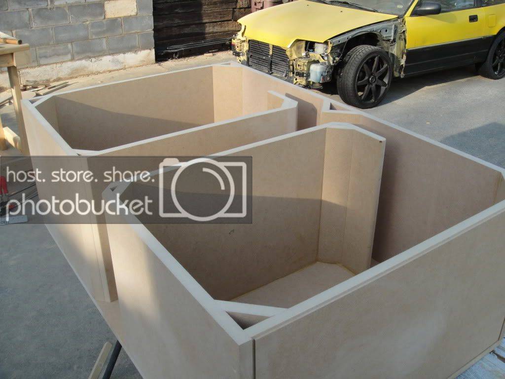

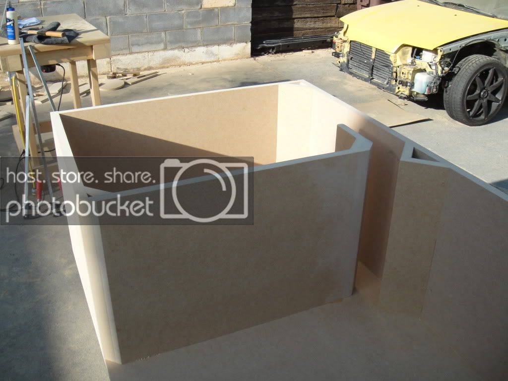

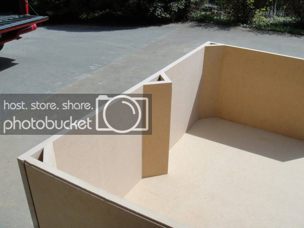

those angle for the port .. is the worst joint ever
Thanks, I try.....................
The panels were clamped for 3 hours before I cut them and the box is going to only be seeing 1K so they will be fine.
