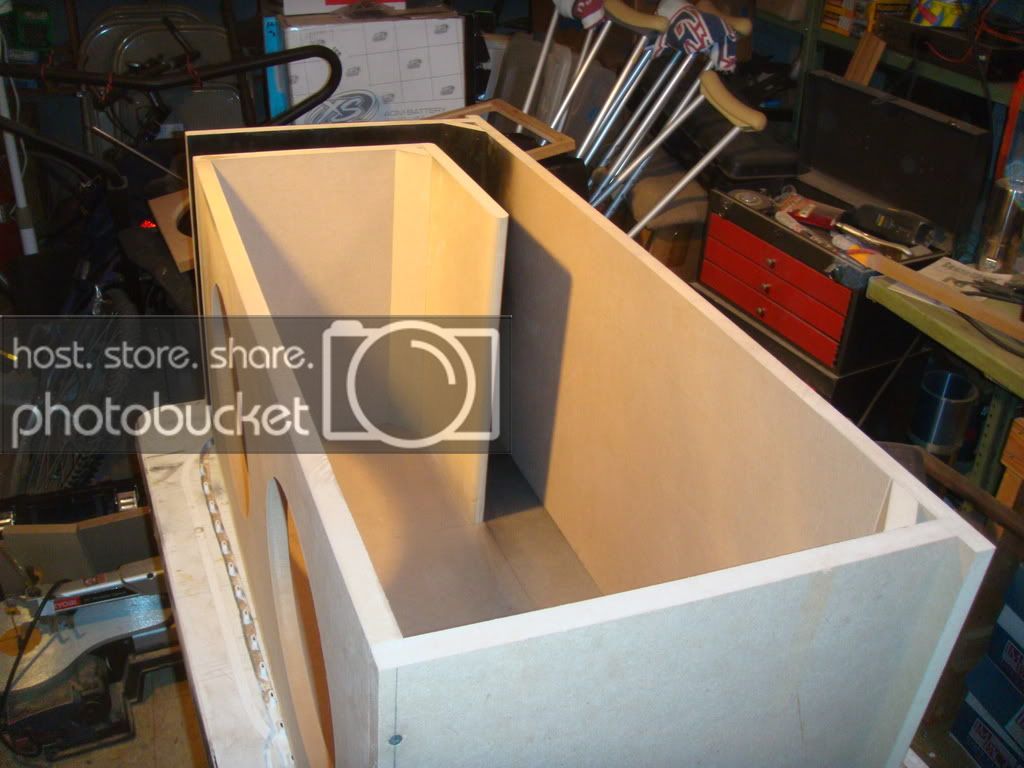

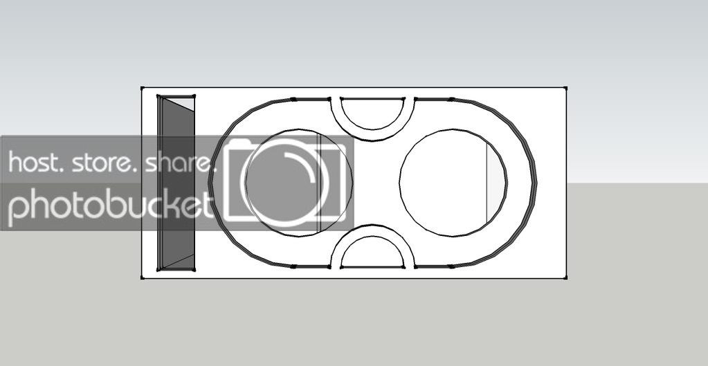

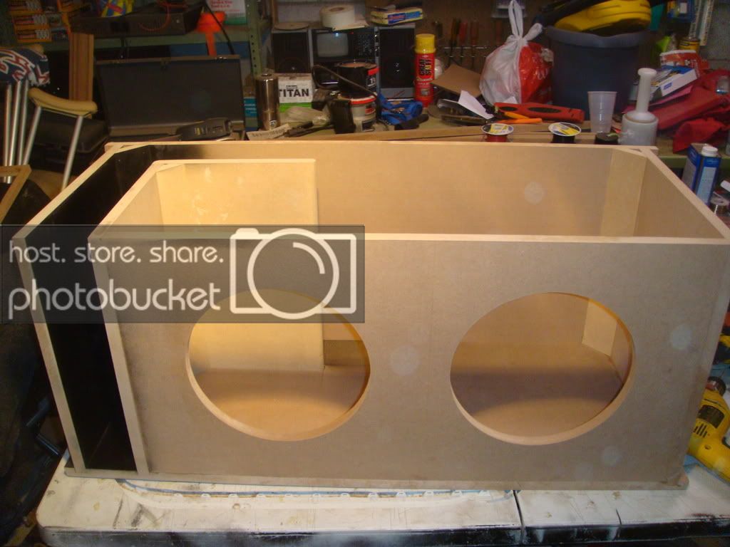

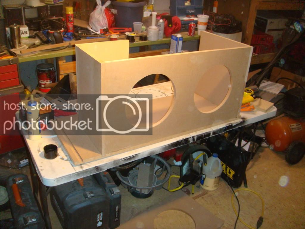

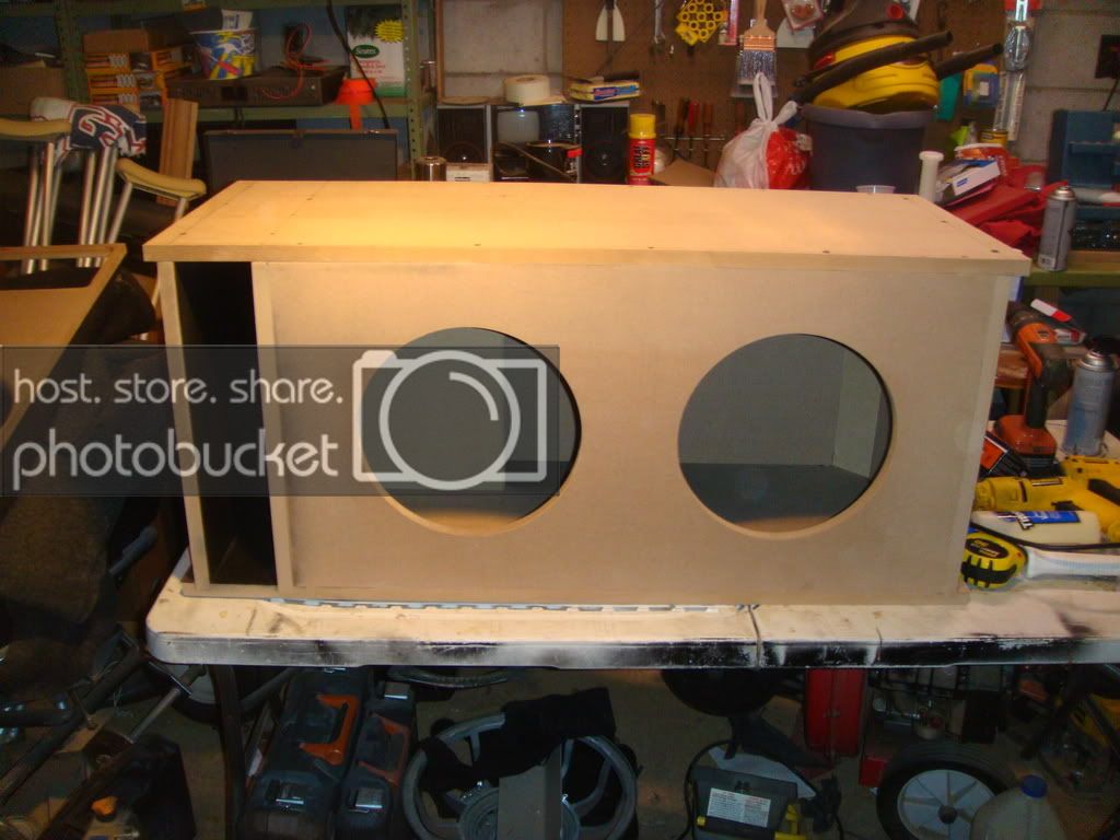

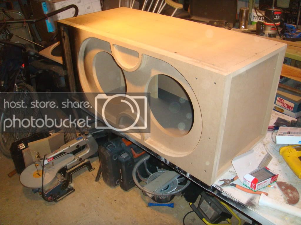

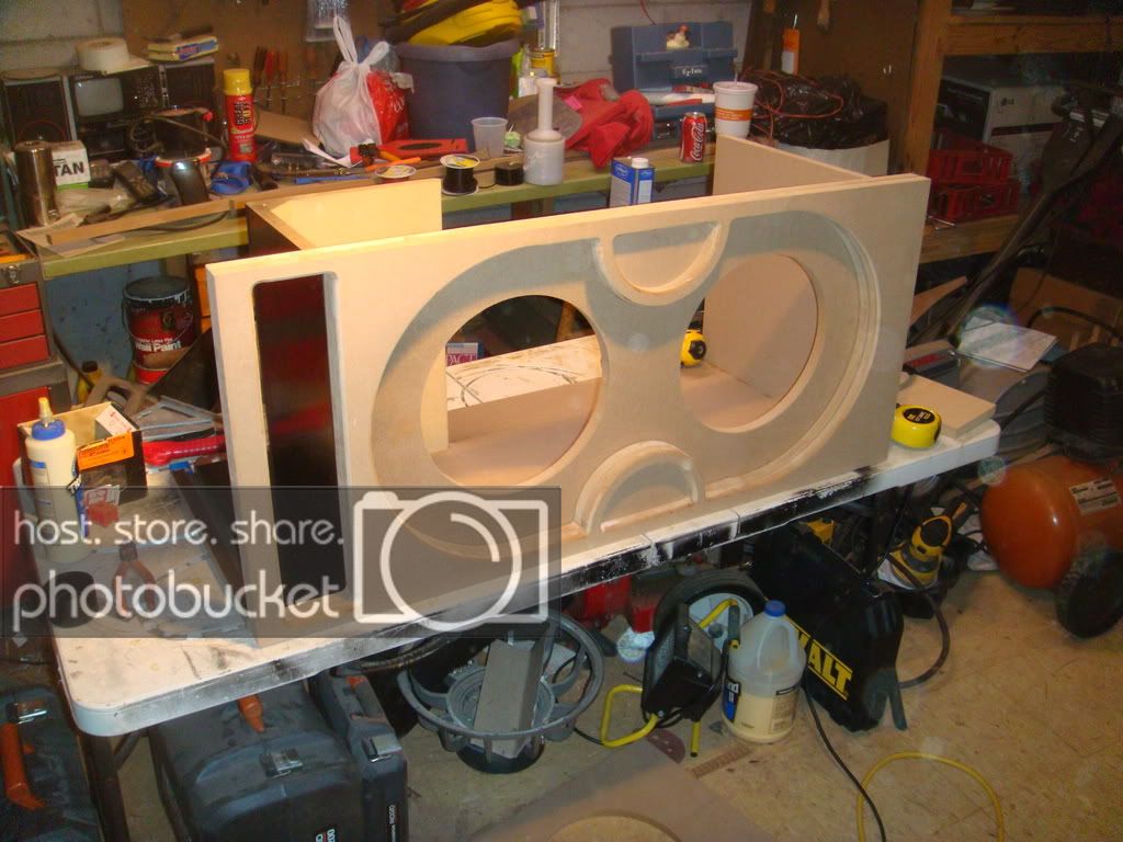

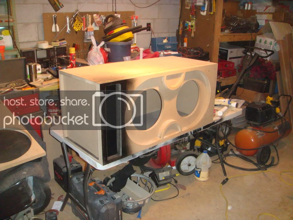

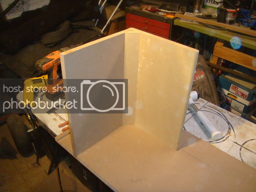

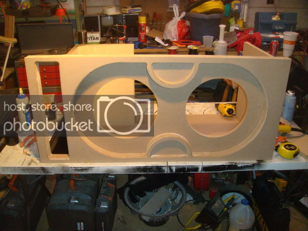

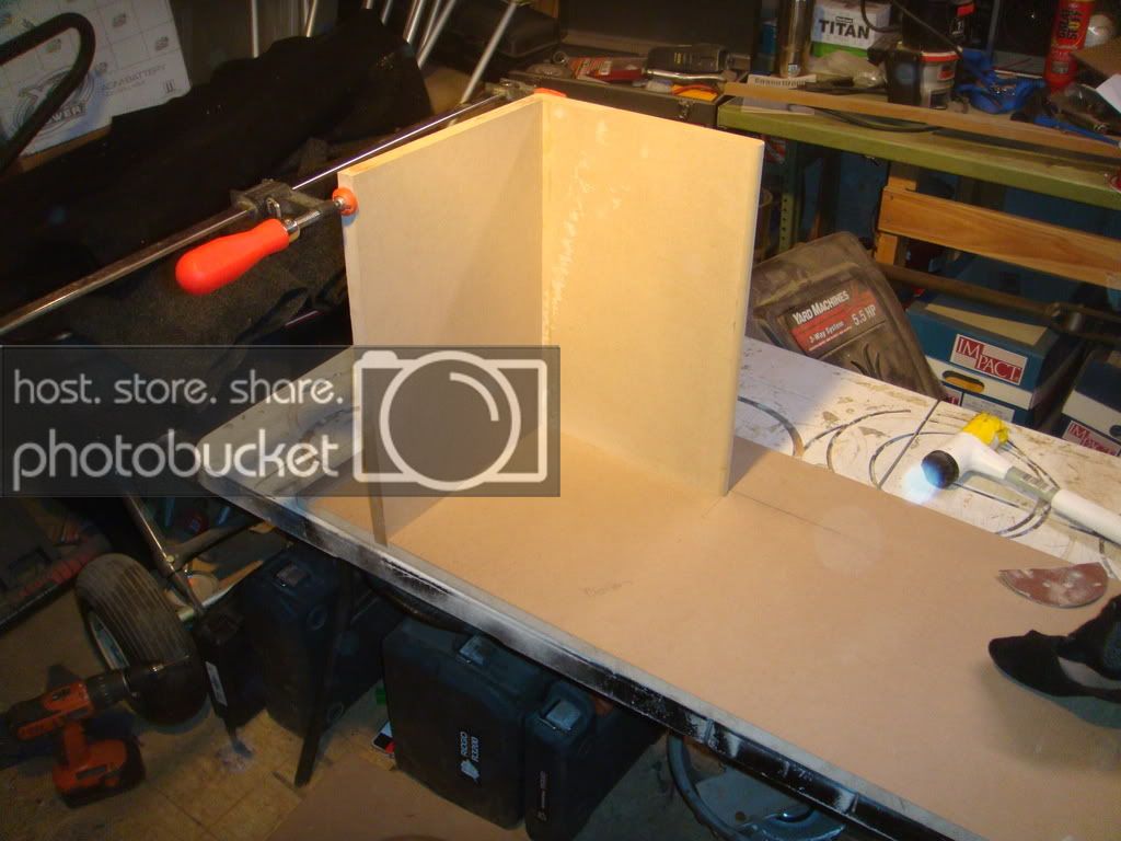

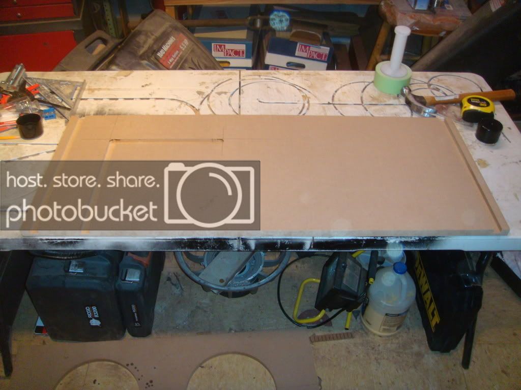

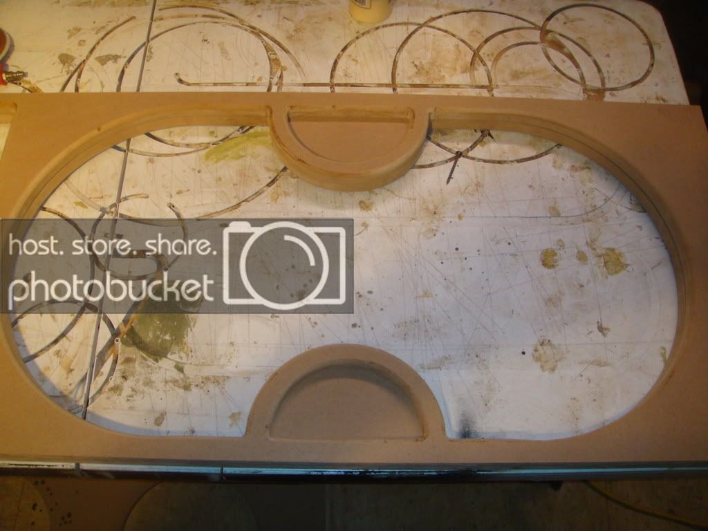

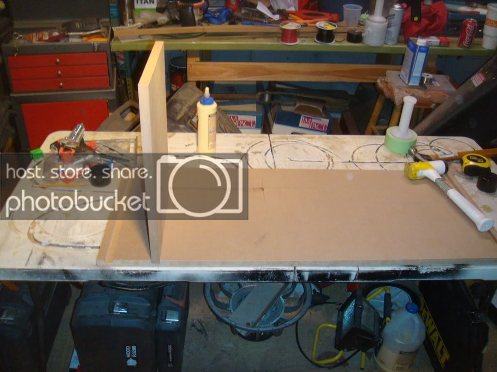

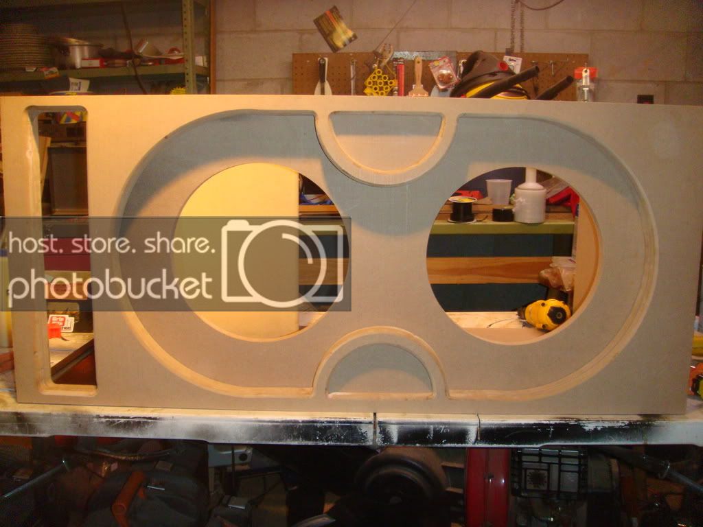

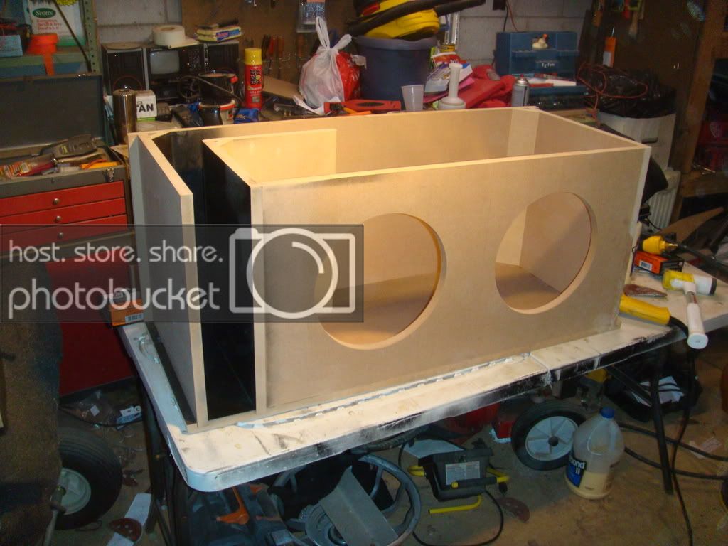

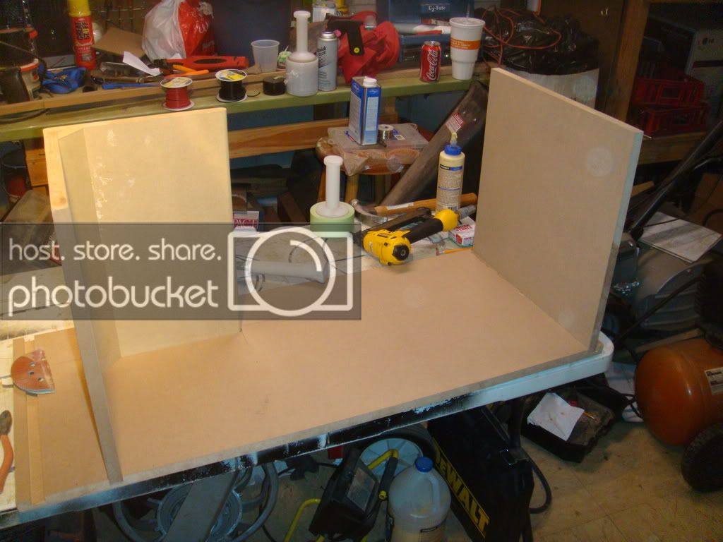

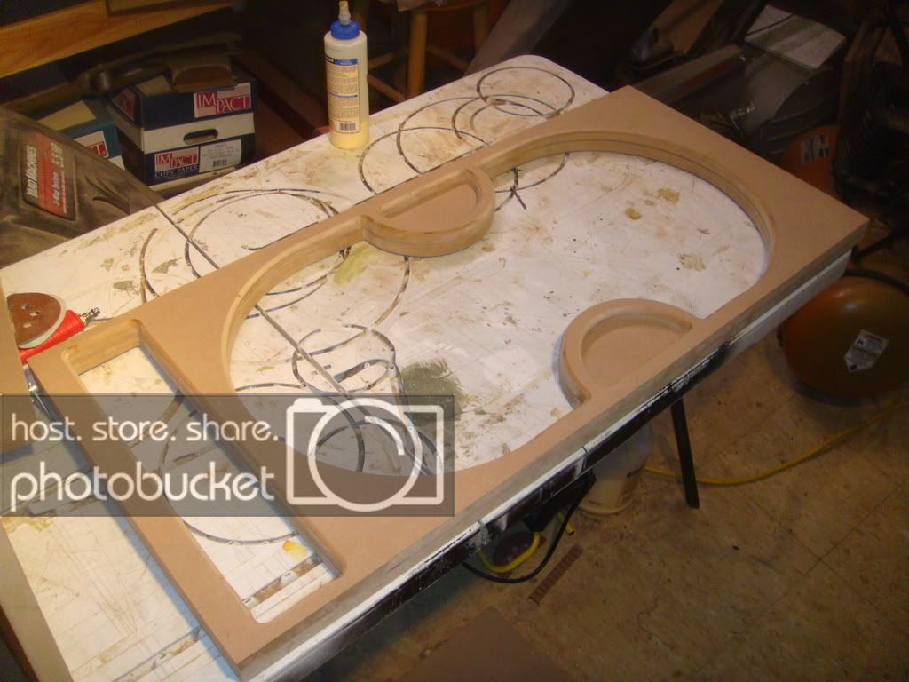

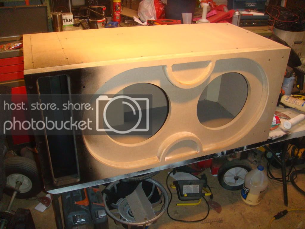

Ok everyone this box is for bigcoupebmw's 2-12" JL W7's. The box is 4.25 cubic feet after all displacements. Box has 57 square inches of port tuned to 32Hz.
Here is the design................
very nice mike! one day i shall build as clean as you! the box i just did came out clean to //content.invisioncic.com/y282845/emoticons/biggrin.gif.d71a5d36fcbab170f2364c9f2e3946cb.gif im on my way there! i like that design very cool and unique.
