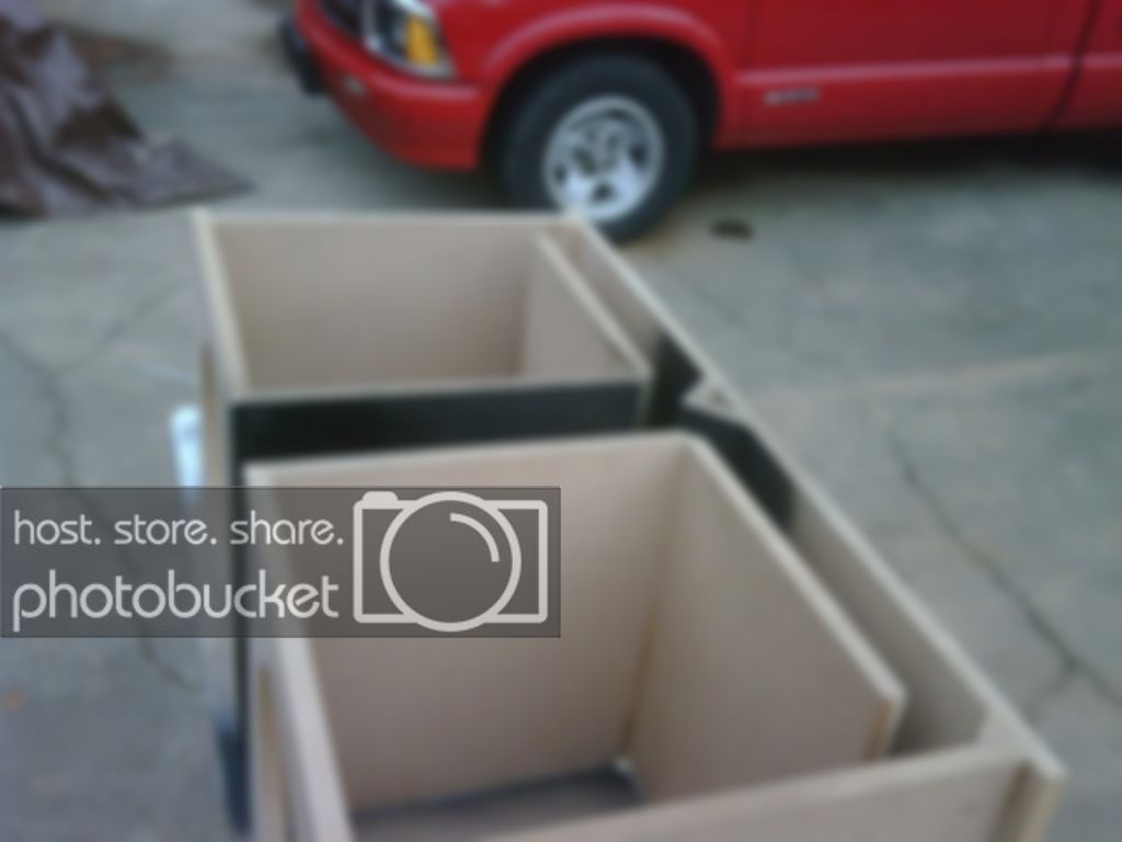

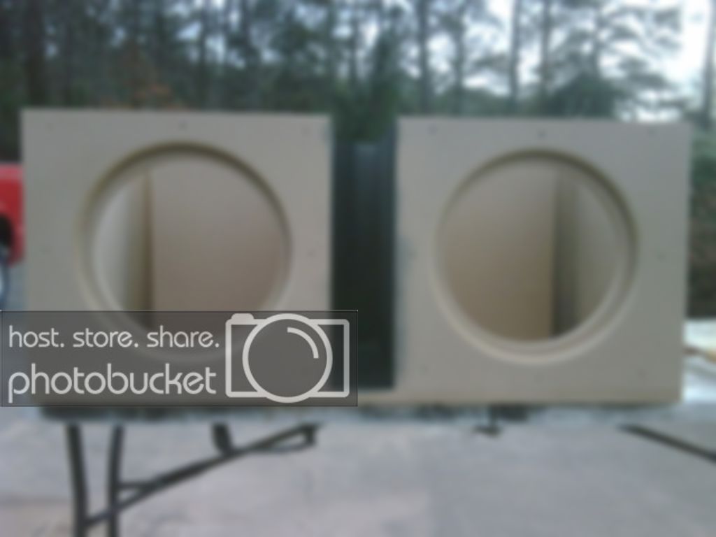

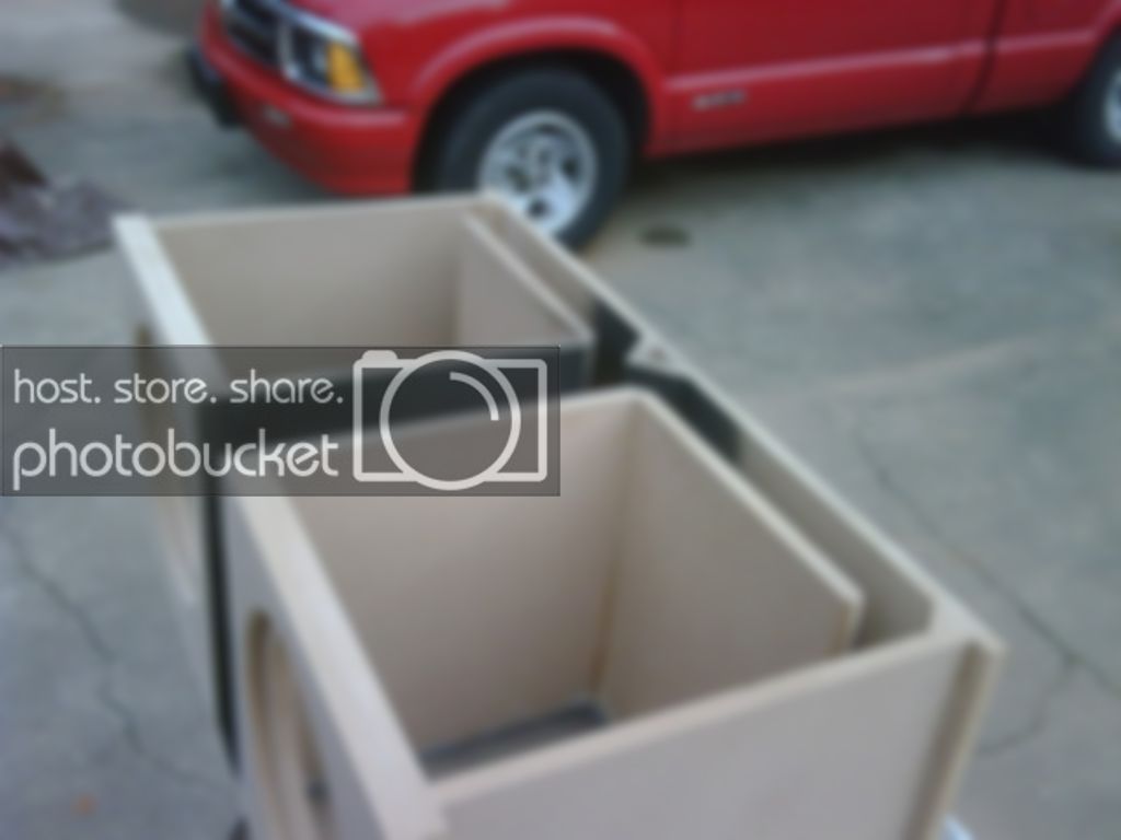

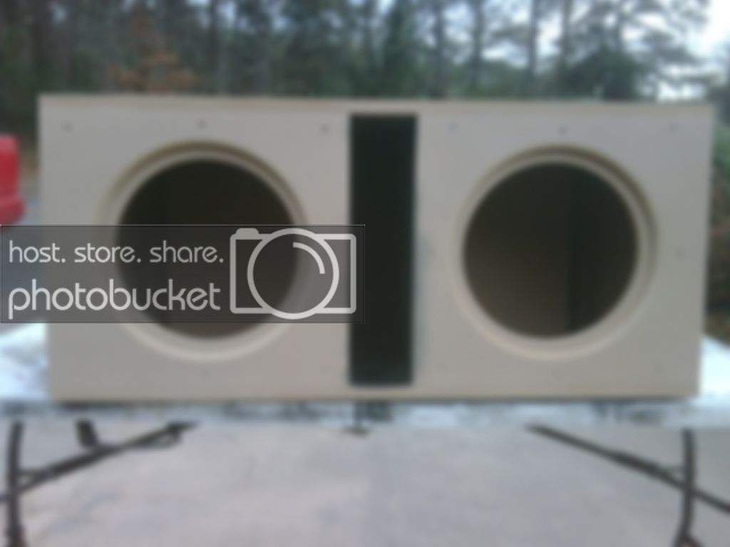

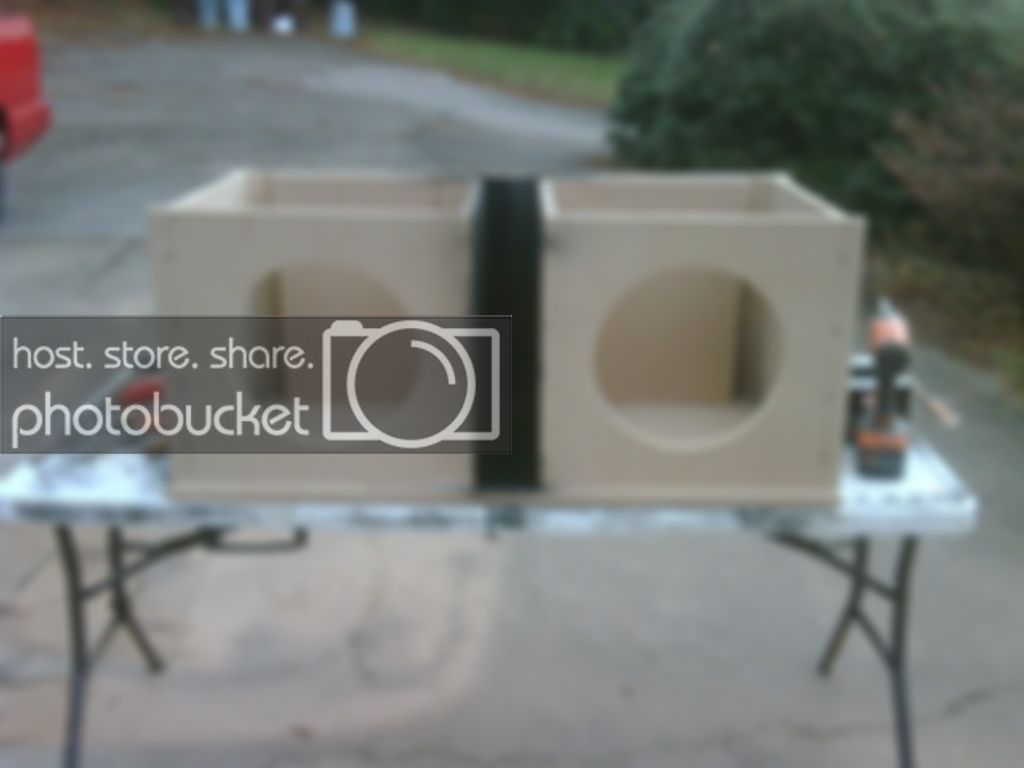

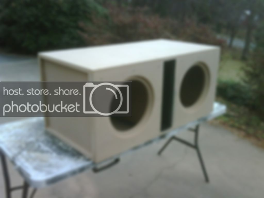

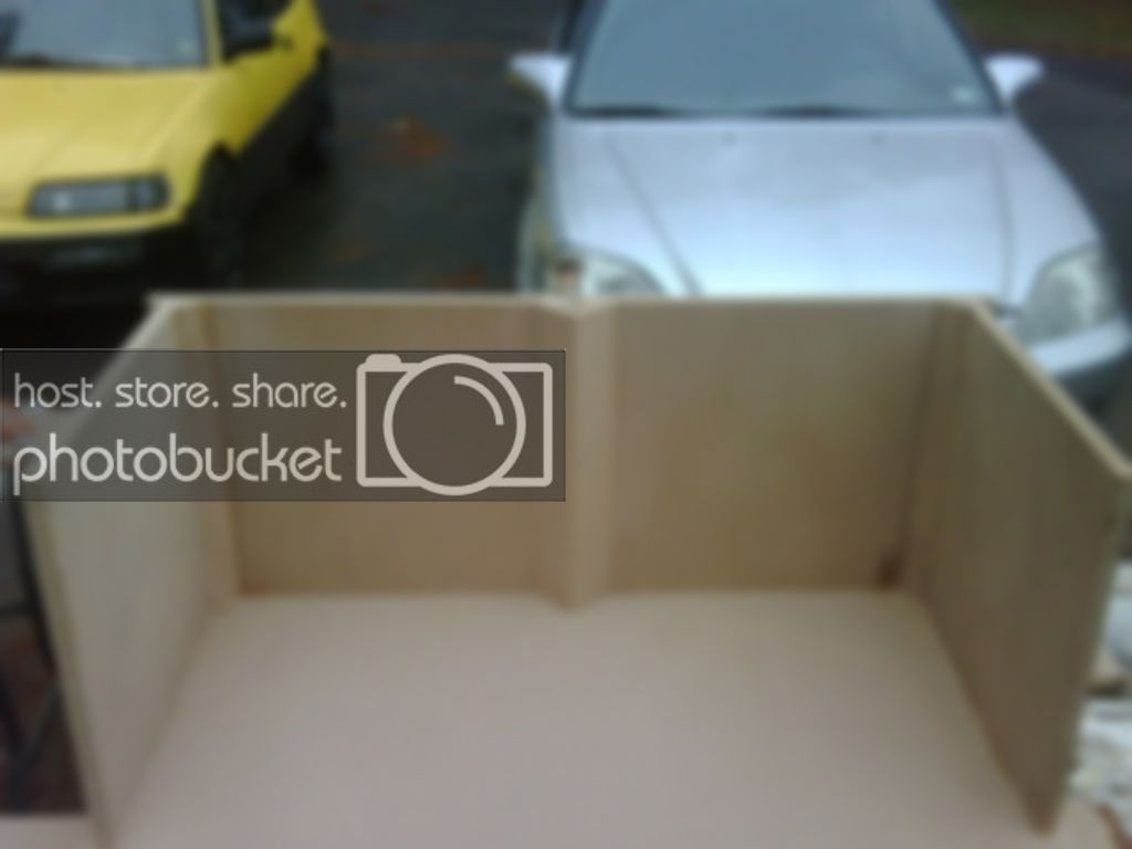

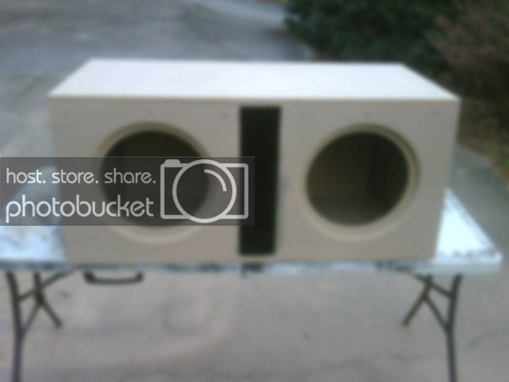

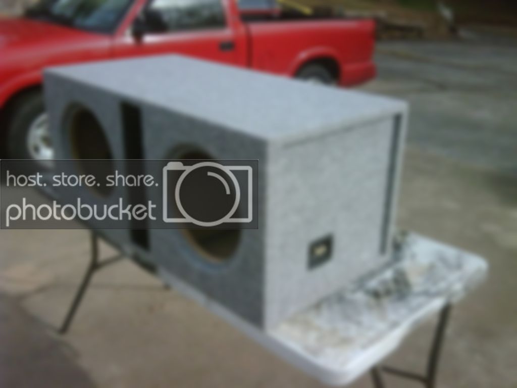

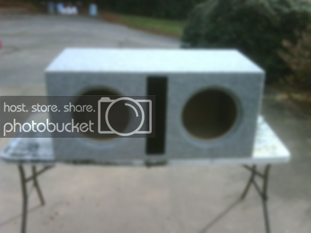

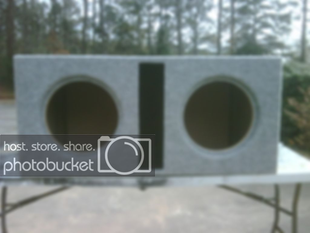

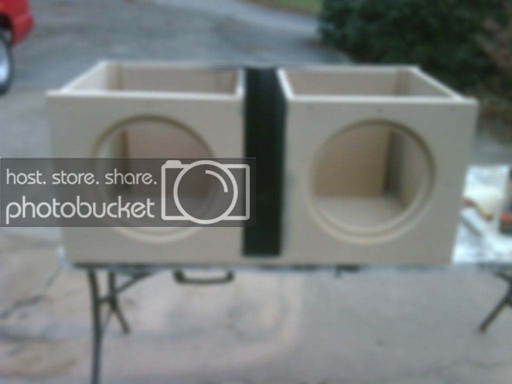

Ok everyone this box is for Bellestar13's friends two 12" Kicker CVR's....
Box is 4.2 cubic feet with 66 square inches of port tuned to 34Hz
Beautiful Mike, you do quality work....but x2 on only CVRs going in there, be nice for a beefer sub //content.invisioncic.com/y282845/emoticons/biggrin.gif.d71a5d36fcbab170f2364c9f2e3946cb.gif
Thanks, for the price point they are nice.

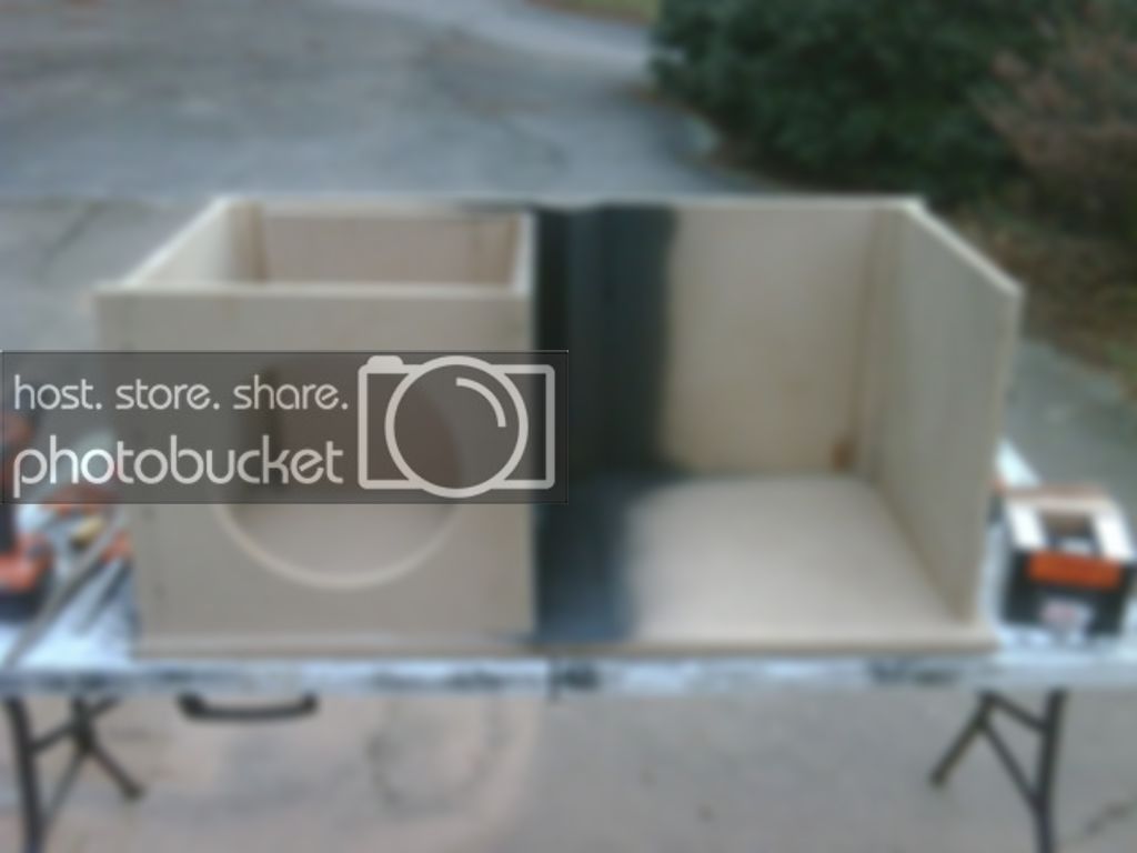

Nice box, but overkill for Cvr's! You could have made a plain ported and he wouldn't have known the difference. No need for that double baffle.
My customers pay for quality and thats what they get. It does not matter if it is for a $1,500 sub for a $10 sub //content.invisioncic.com/y282845/emoticons/biggrin.gif.d71a5d36fcbab170f2364c9f2e3946cb.gif
