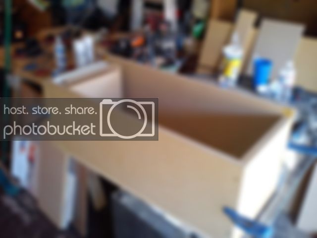

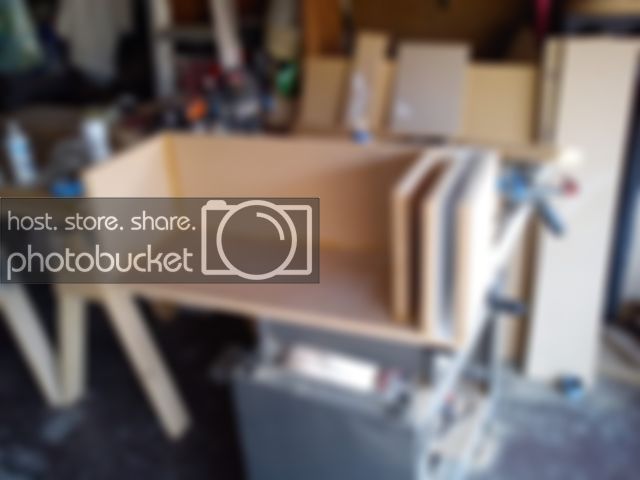

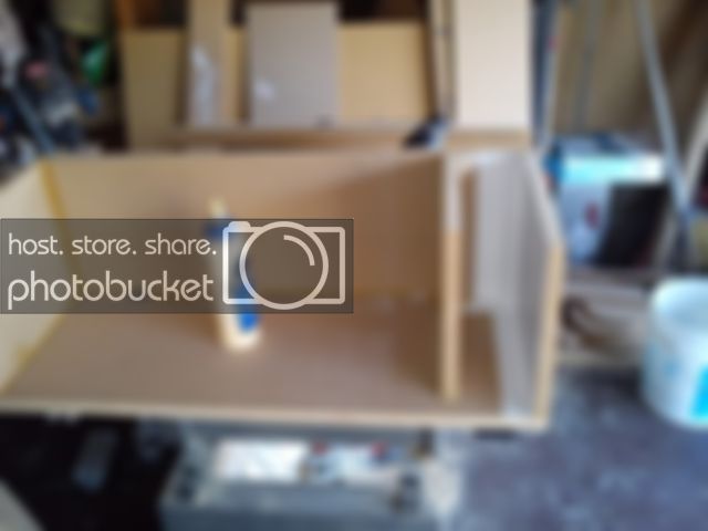

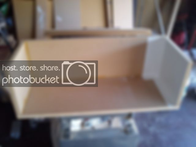

I believe this box is 1.4ft^3 @ 38hz iirc. i didnt design it, just built it. enjoy

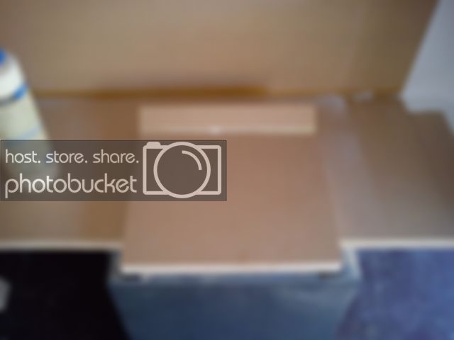

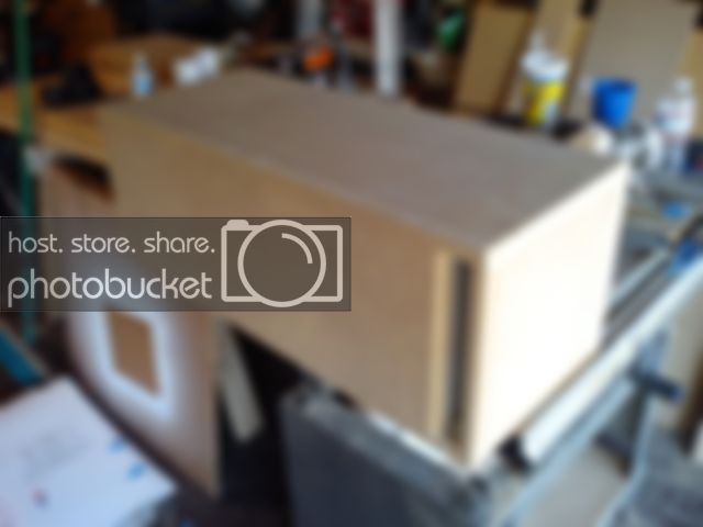

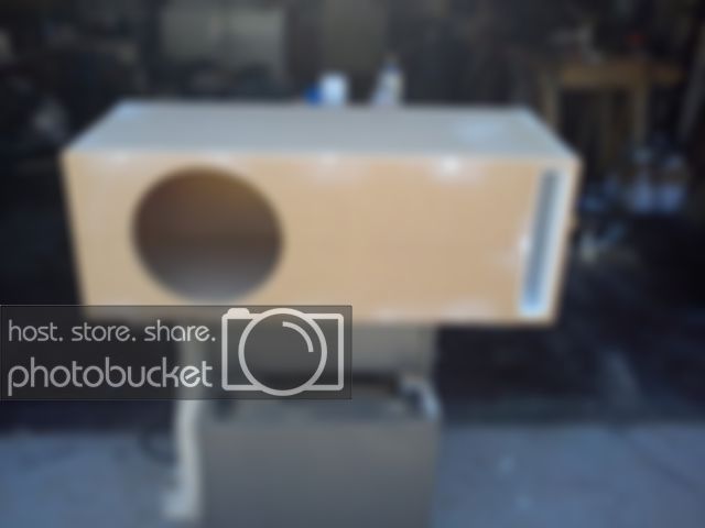

how did you do that port like that?
super secret! no, lol jk, notice the front piece where the sub is mounted. it is put on over every edge. this si so i can flush trim along the inside of the port, then i go with a roundover bit and dig in about 1/16" with my plunge router to get a small lip . viola, fancy port.
