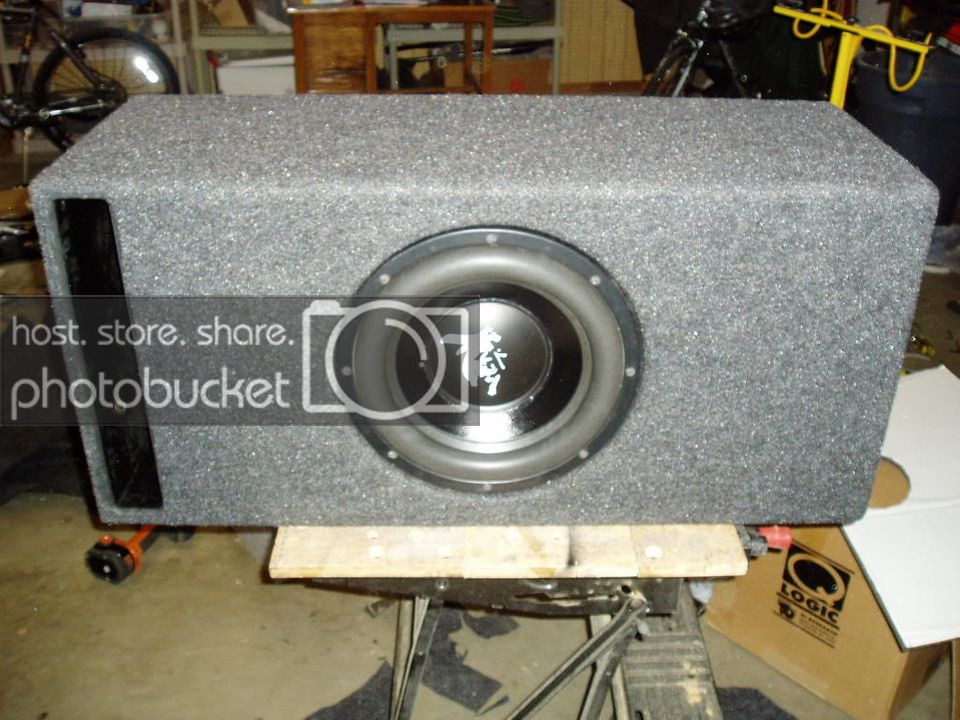

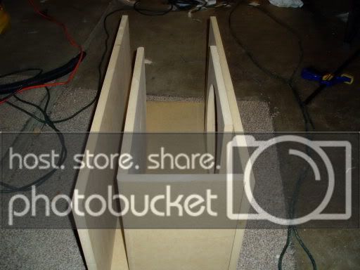

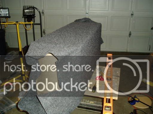

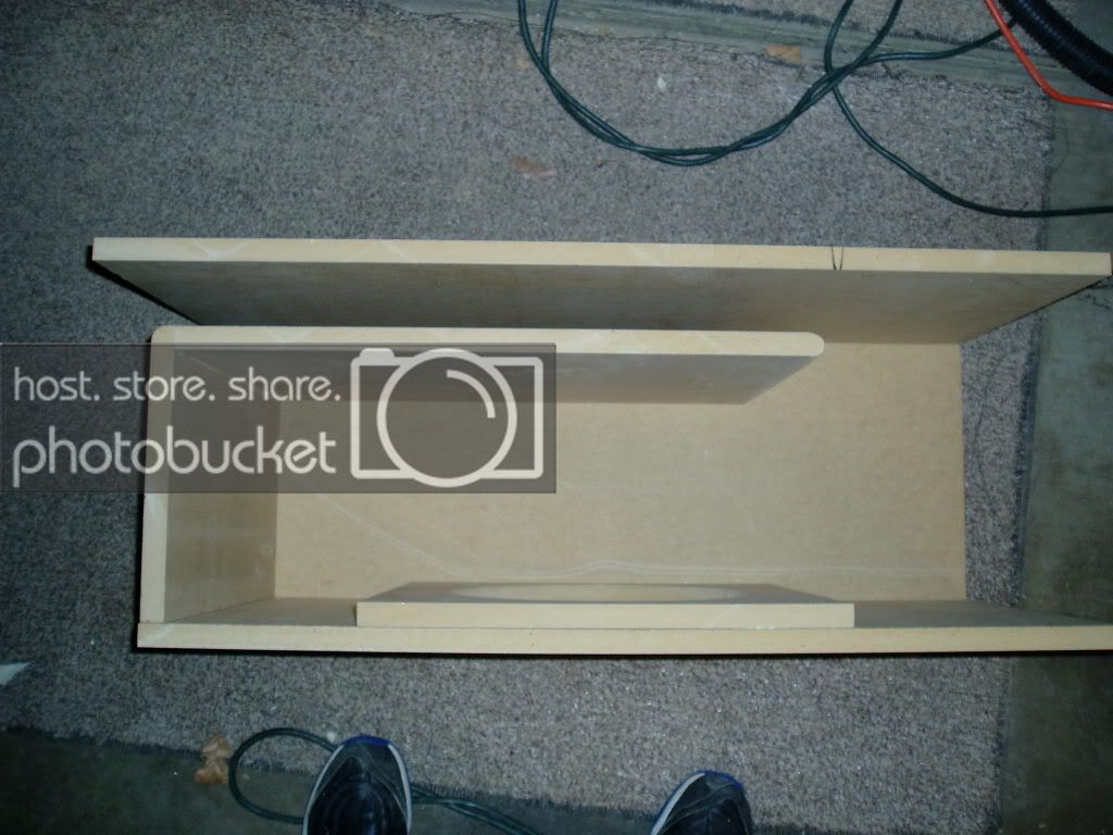

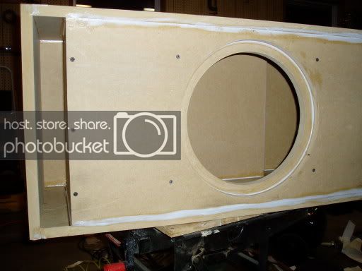

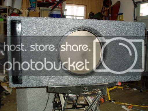

I will finish up tomorow and use a router on all corners and carpet. It is 2.3 cubes tuned to 29 hz with 29 inches of port area
looks good... i wanna see taht 12inch brahma i got a 15 //content.invisioncic.com/y282845/emoticons/frown.gif.a3531fa0534503350665a1e957861287.gif but i blew it i think lol. looks good man hope to see u at some shows

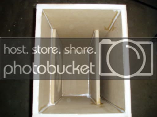

Excellent work man, but you put the caulk on the outside as well //content.invisioncic.com/y282845/emoticons/frown.gif.a3531fa0534503350665a1e957861287.gif
lol, we have seen some of your gingerbread houses //content.invisioncic.com/y282845/emoticons/wink.gif.608e3ea05f1a9f98611af0861652f8fb.gif//content.invisioncic.com/y282845/emoticons/smile.gif.1ebc41e1811405b213edfc4622c41e27.gif
Yeah, that's why I made the comment //content.invisioncic.com/y282845/emoticons/frown.gif.a3531fa0534503350665a1e957861287.gif
haha gingerbread houses...//content.invisioncic.com/y282845/emoticons/yumyum.gif.0556df42231b304b9c995aefd13928a8.gif

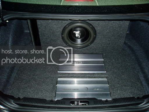

lookin good man, this goin in that ford as well or a different car?
Yes it is going in the Ford Fivehundred, it is a company car and I am really pleased with it so far. Sometimes I put caulk on the outside if I cannot reach it on the inside actually I always put caulk on the outside just to be safe, then I carpet it using gel contact cement whick also fills in any cracks.
