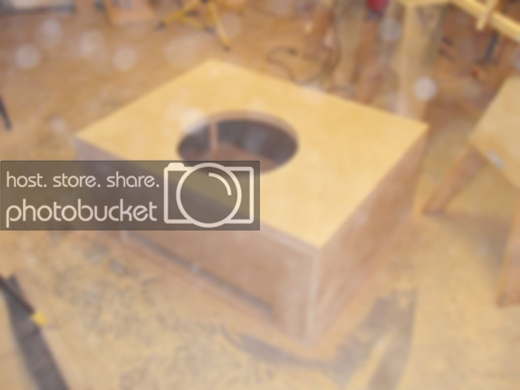

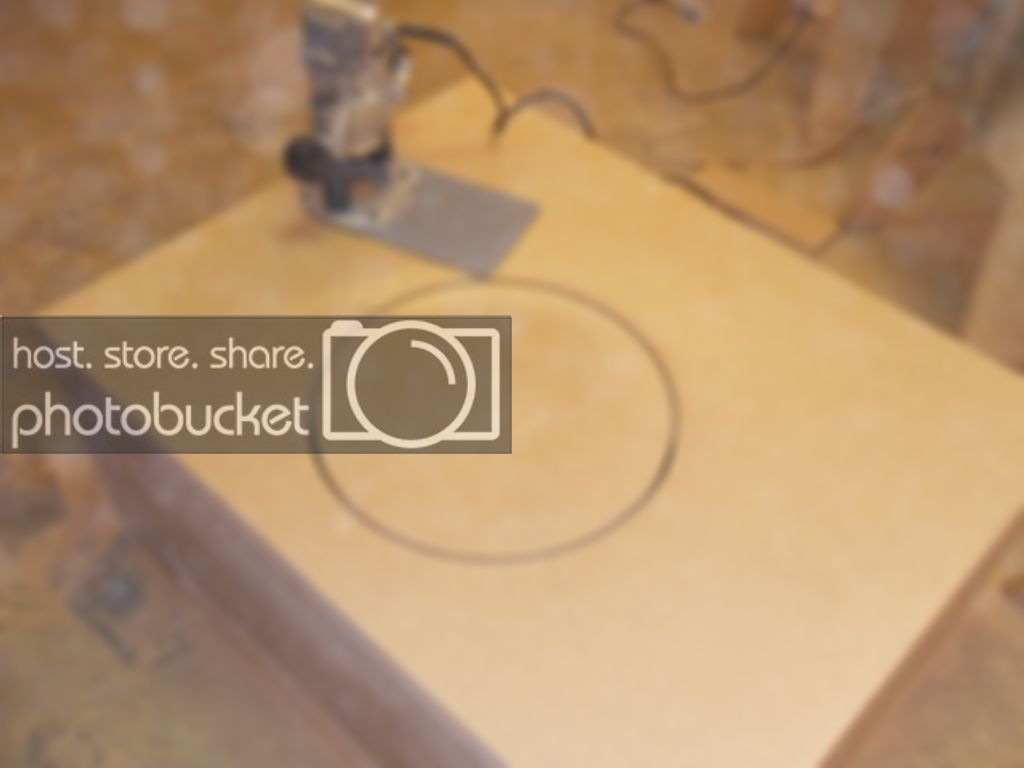

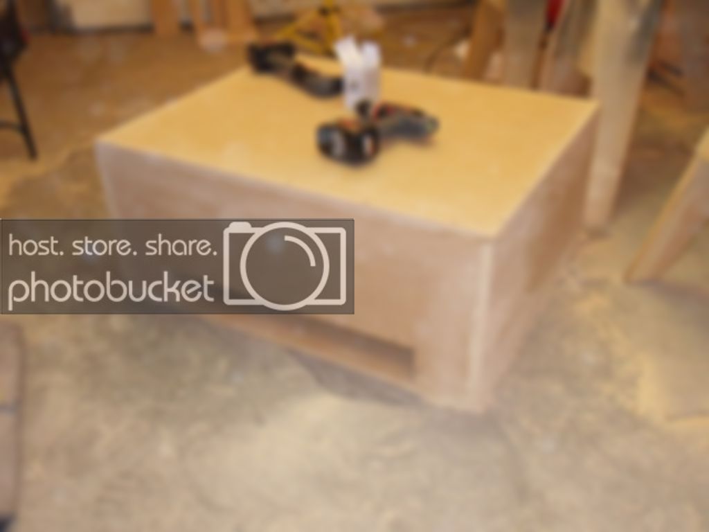

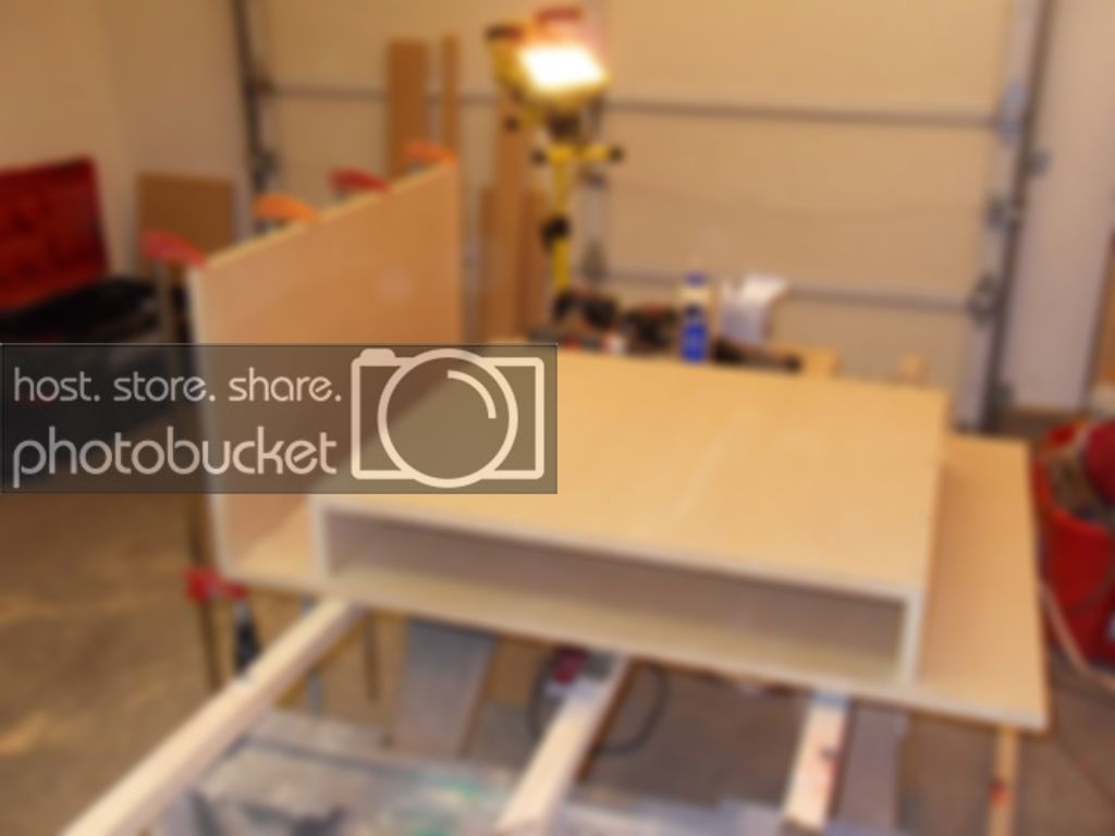

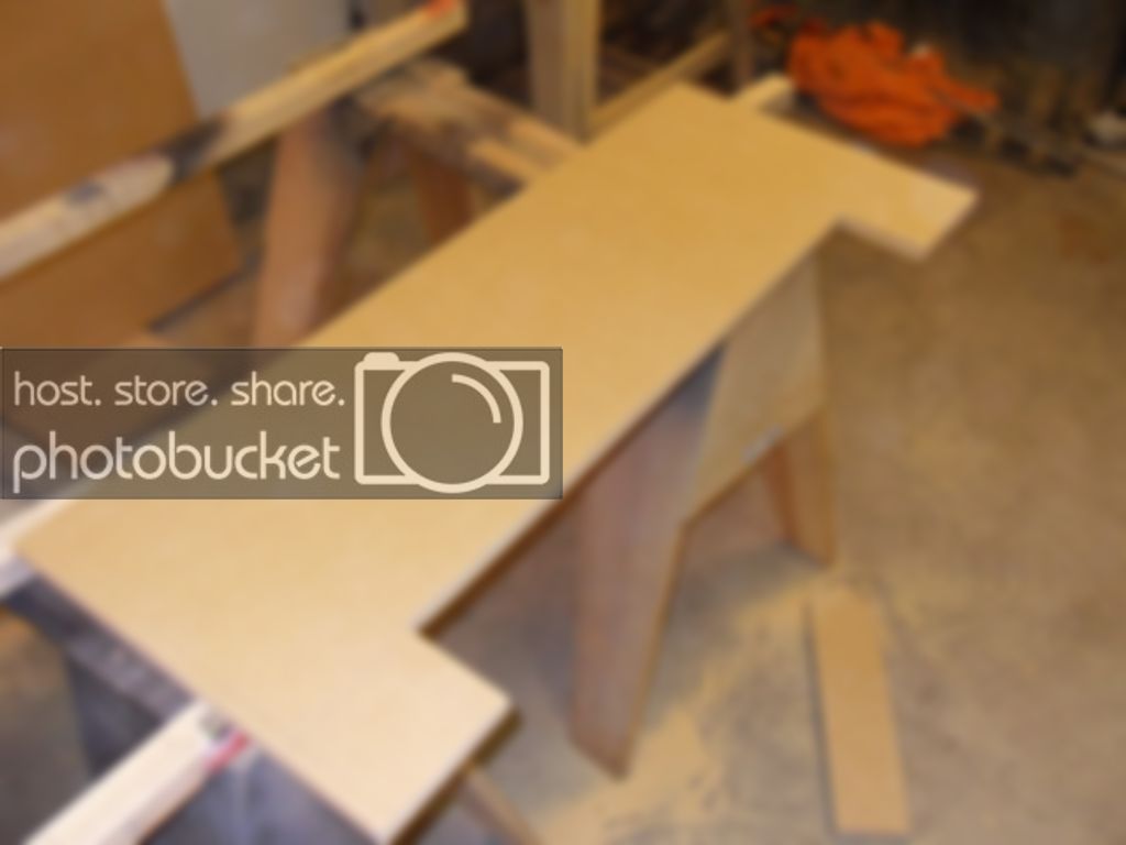

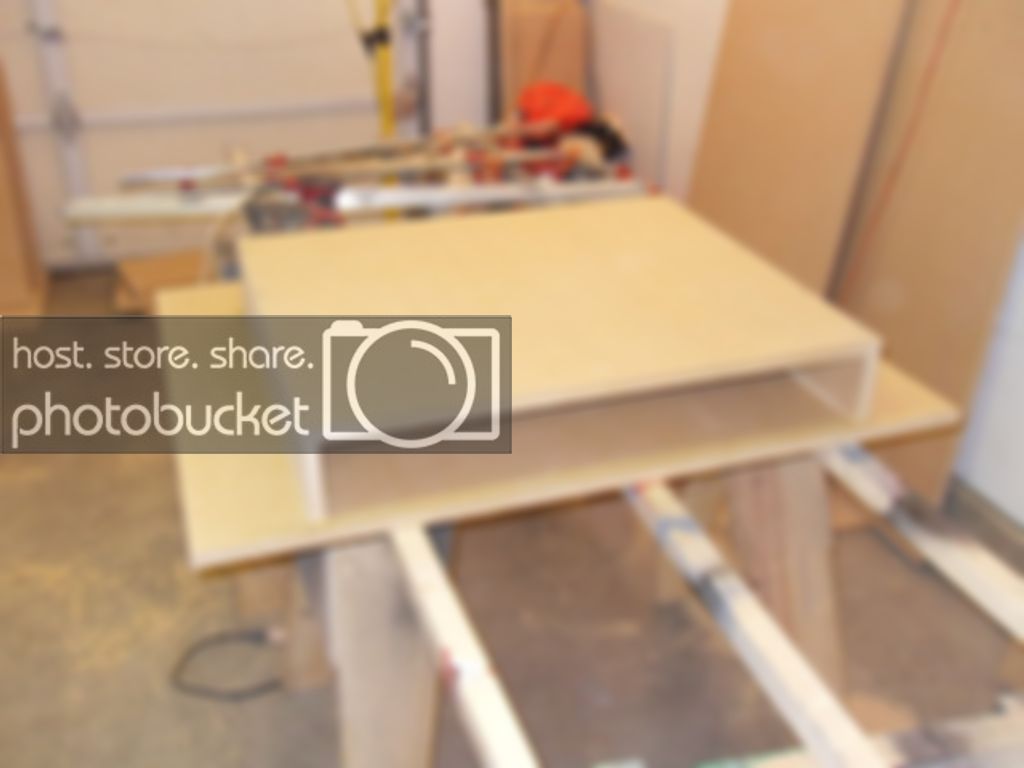

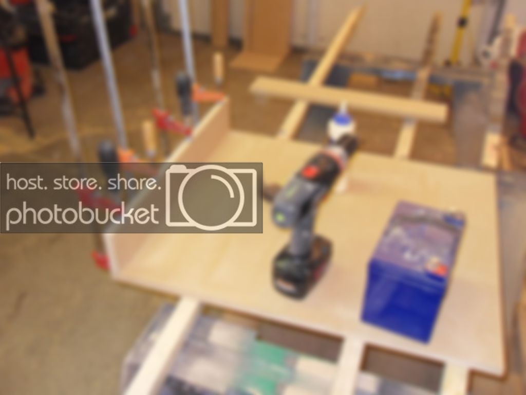

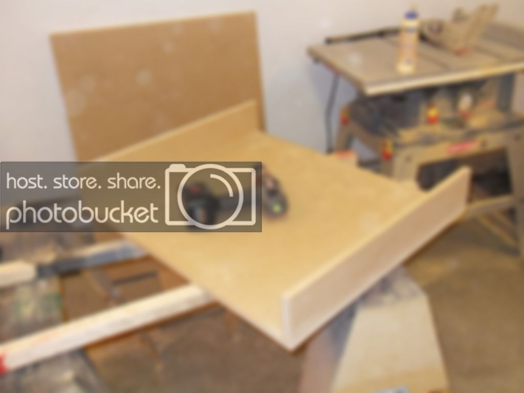

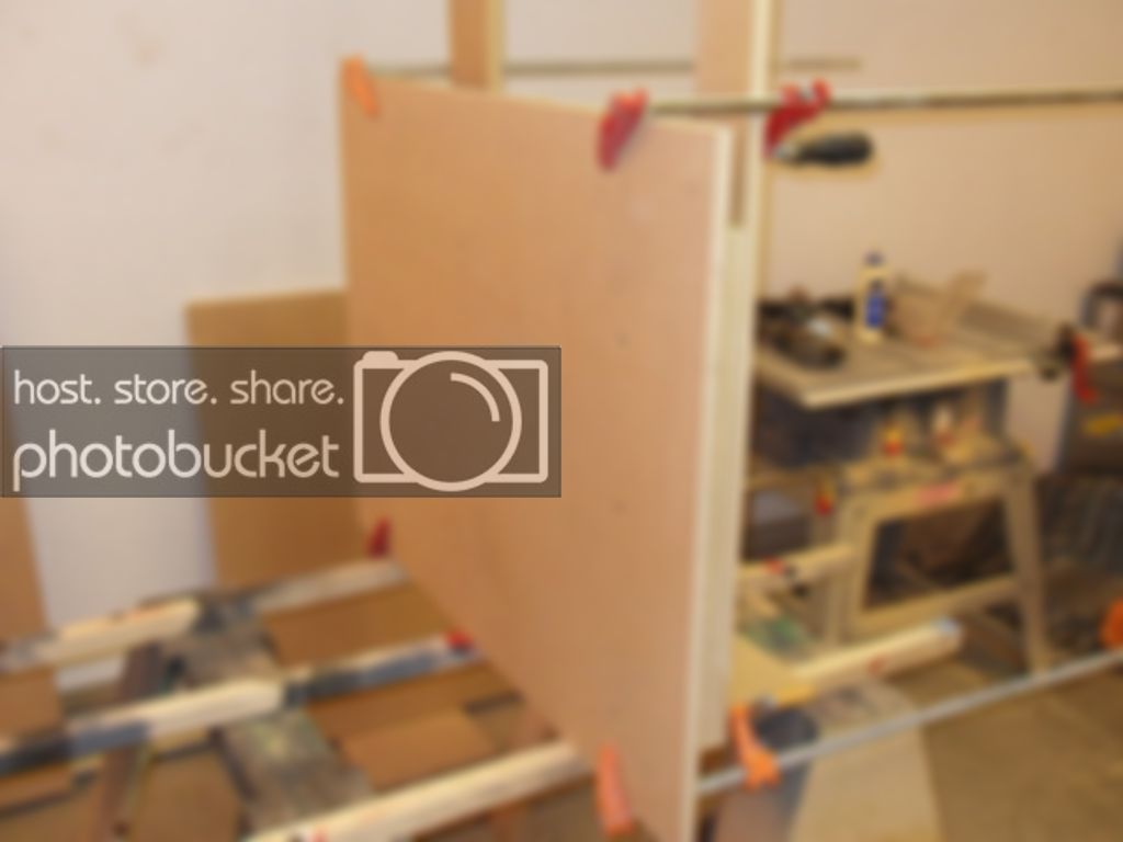

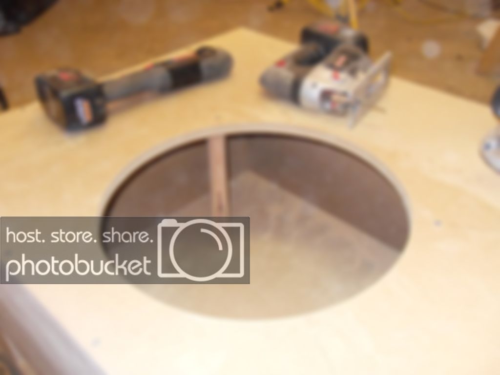

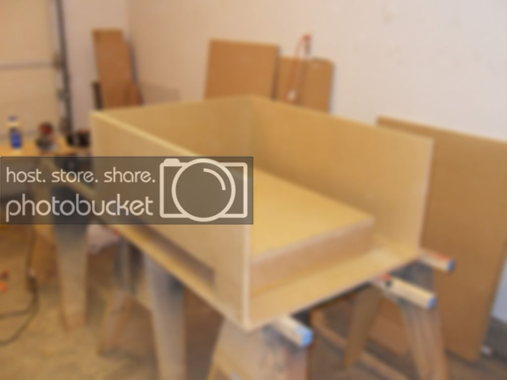

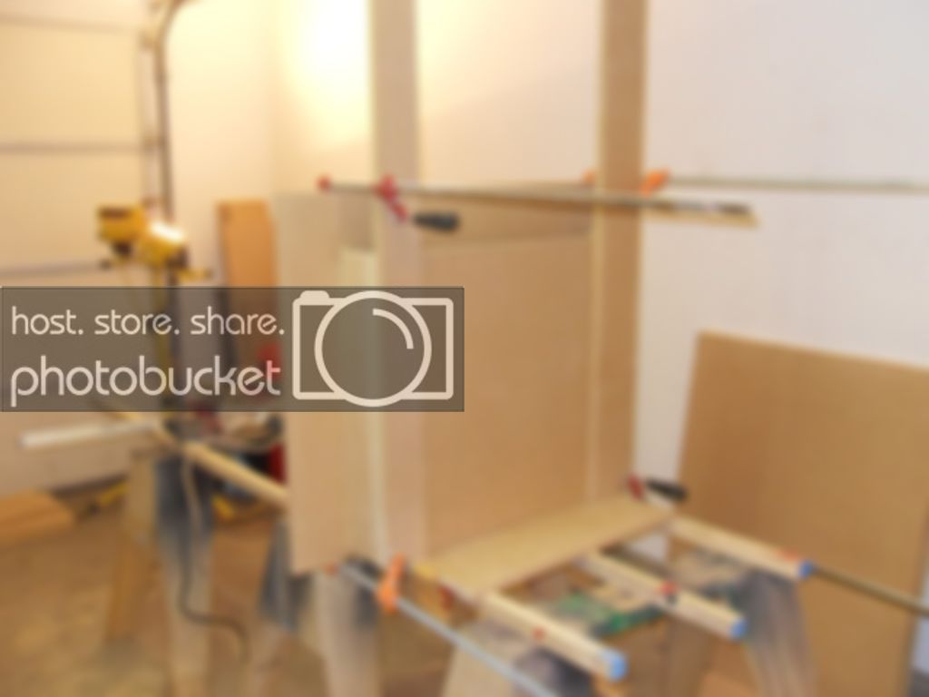

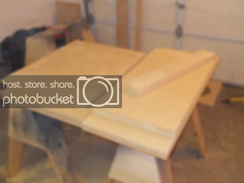

This is a box build for a local guy here.
Box is 8 cubic feet, 35hz, double baffle (although no flush mount as requested), big *** dowel rod for extra bracing.
Driver will be an 18" Fi BTL. This is all going into a ford explorer (lol, gonna be LOUD)
Pics:
Wood all cut and ready to go:

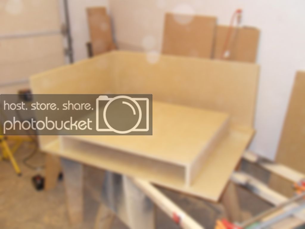

Building the port:
because thats how i wanted //content.invisioncic.com/y282845/emoticons/wink.gif.608e3ea05f1a9f98611af0861652f8fb.gif i i had the room to spare so why not? and plus Fi's recommendations are 5-8ft^3.

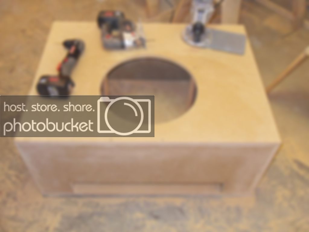

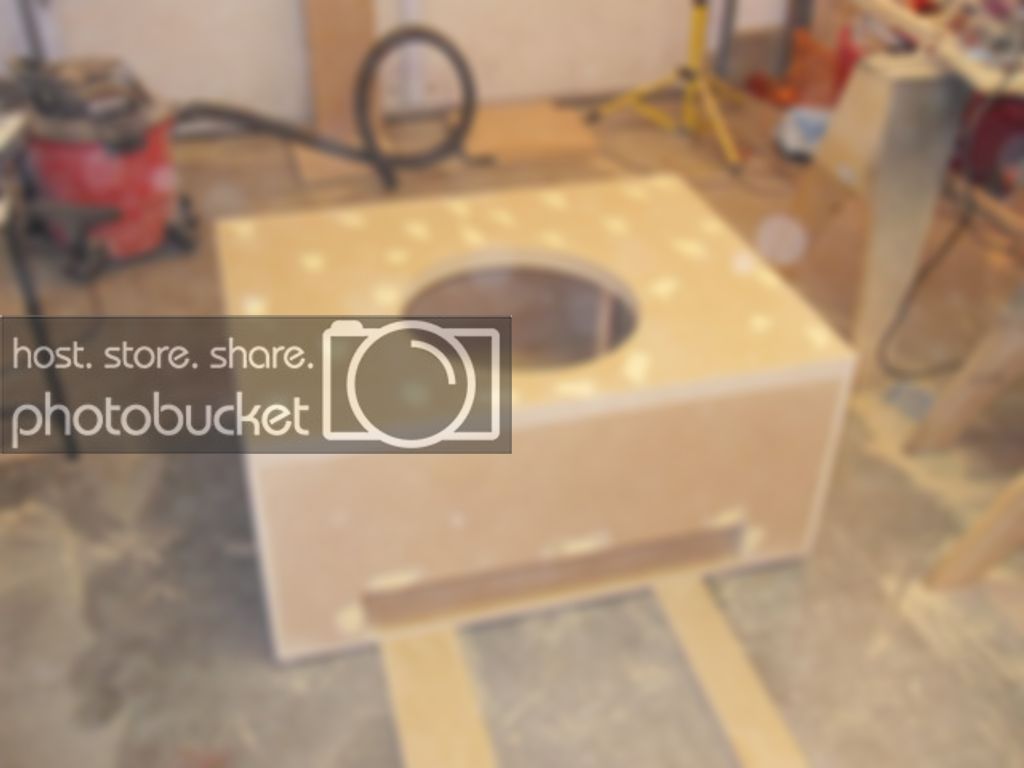

I have to get myself one of those router jigs. Box looks good. What kind frequency response did the customer want?
good question. He just wanted 8cu ft @ 35-ish hz.
Seeing as its going in an explorer, im hoping he wanted strong output in the mid-high 30's, because thats what he's gonna get, lol.
