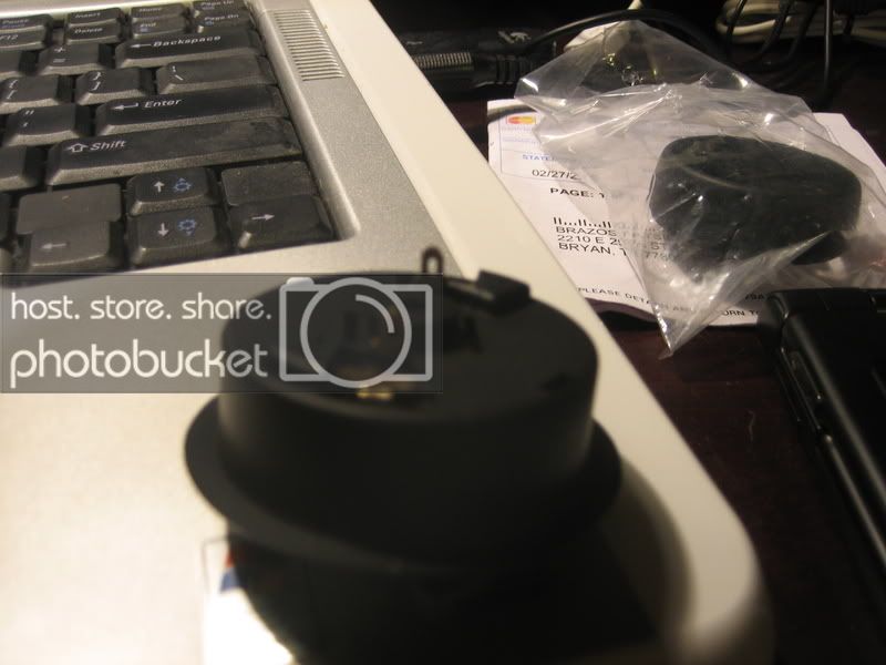

I still haven't figured out how to mount the tweeters using the terminals they use. I've called Boston the last two days and no one ever picks up so I've left a message yesterday but still haven't got a call back. The terminals on the tweeter cups are tiny and there's no spade terminal that is small enough, but they do include some wiring which looks like it's what should be used, but the terminal on that wiring is actually too small. Very frustrating.

Phase is 100% checked and ok. Still haven't talked to Boston yet about how to mount the dang tweeters without soldering the wire onto the terminals though.
This is what the tweet terminals look like:
Too small for even a 22 awg female spade terminal... Ridiculous. They included wiring that is supposed to be used that already has females on one end but they are actually too small and don't go onto the terminal. Might just be a QC issue on their side or something, I'm not sure because they won't call me back. I've left them voicemails two days in a row now, and now it's the weekend.

why not mount the tweets on to the mids using the adapter for the time being? they snap right in.
Yeah, that is an option, but that requires running another wire through the door jamb. I had to take both doors off the hinges to run that wire...
