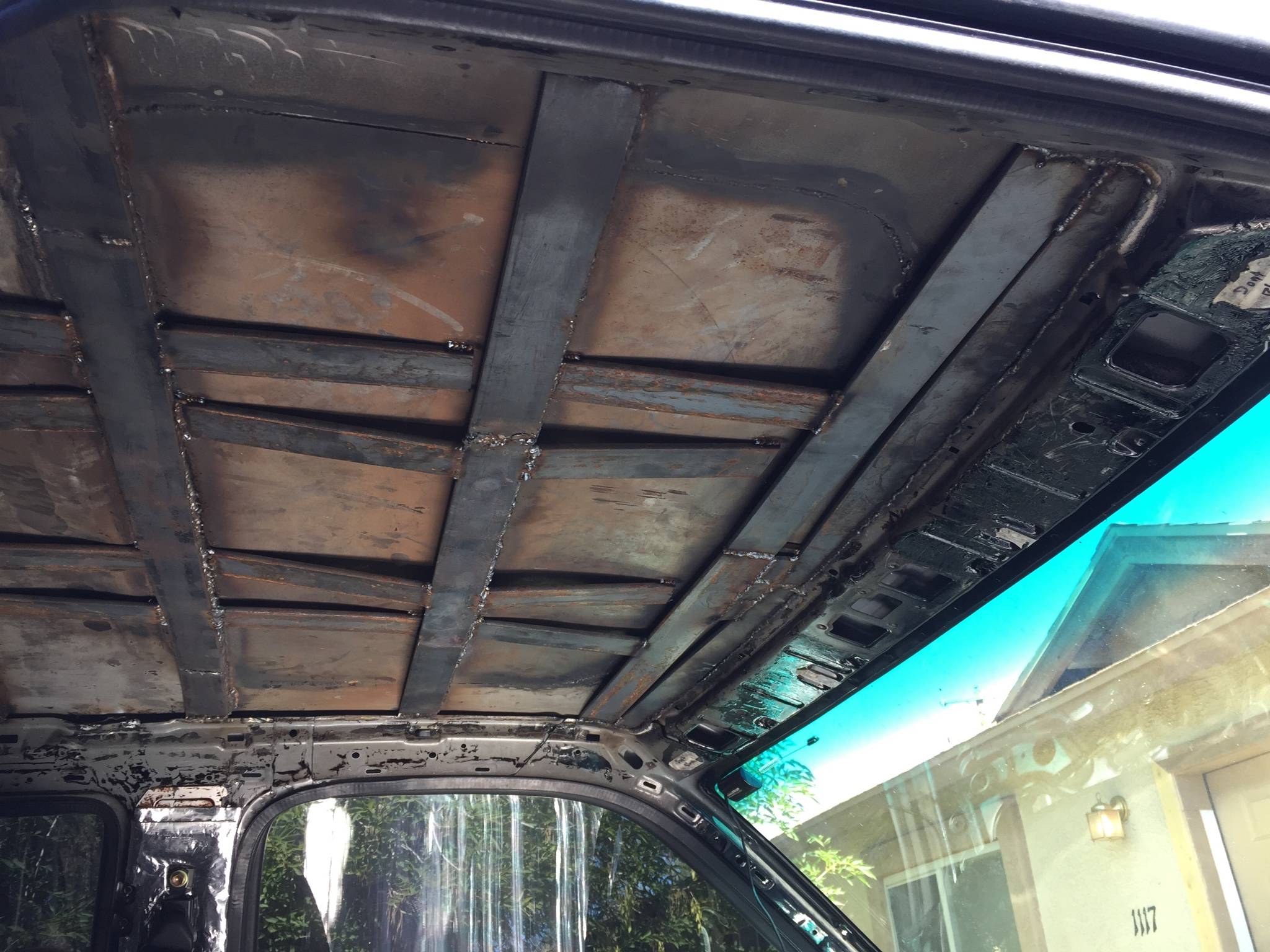

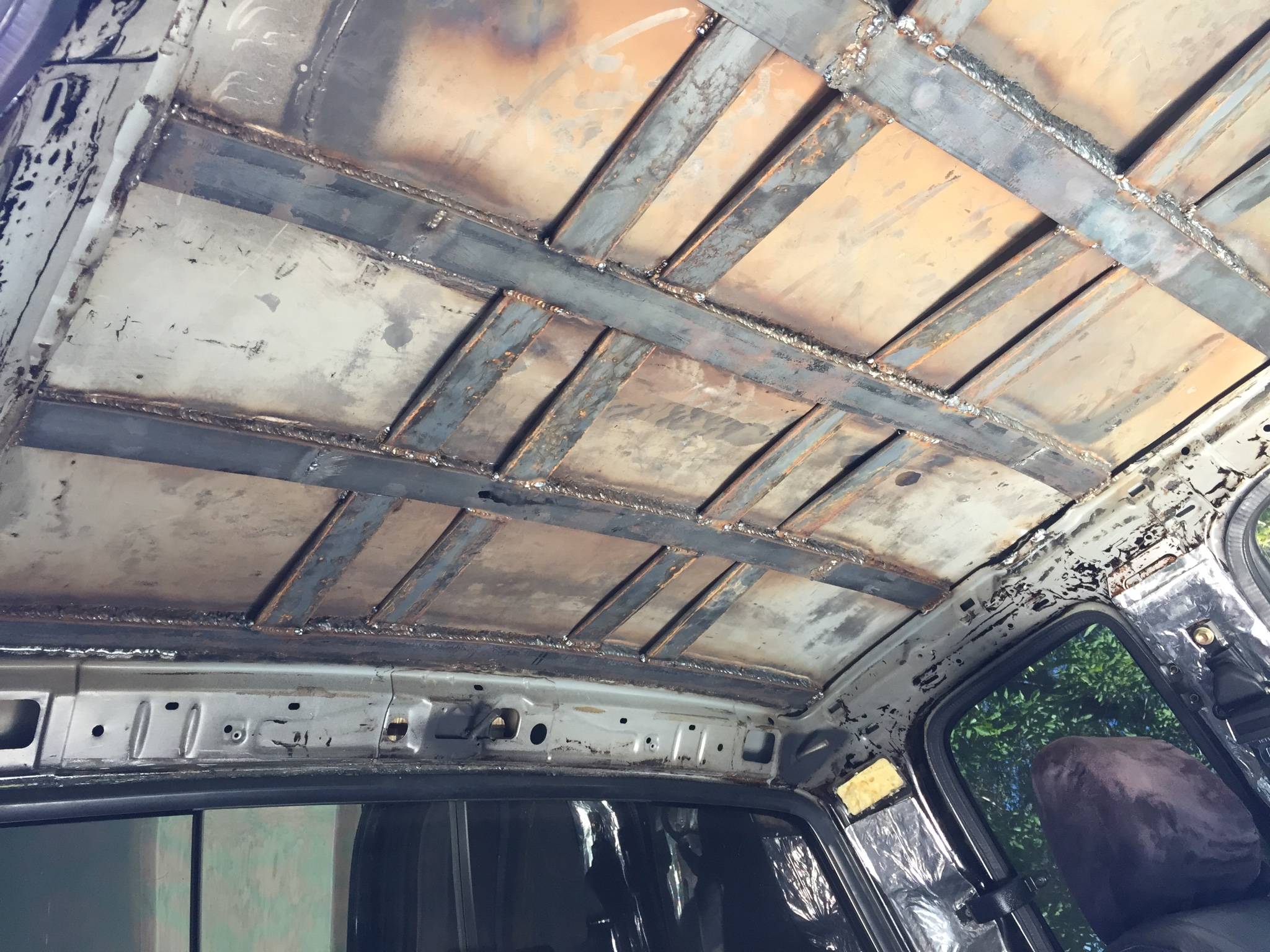

Roof is 90% done. A little more welding and grinding then it will be sprayed with Second Skin Spectrum. No flex zone //content.invisioncic.com/y282845/emoticons/biggrin.gif.d71a5d36fcbab170f2364c9f2e3946cb.gif haha

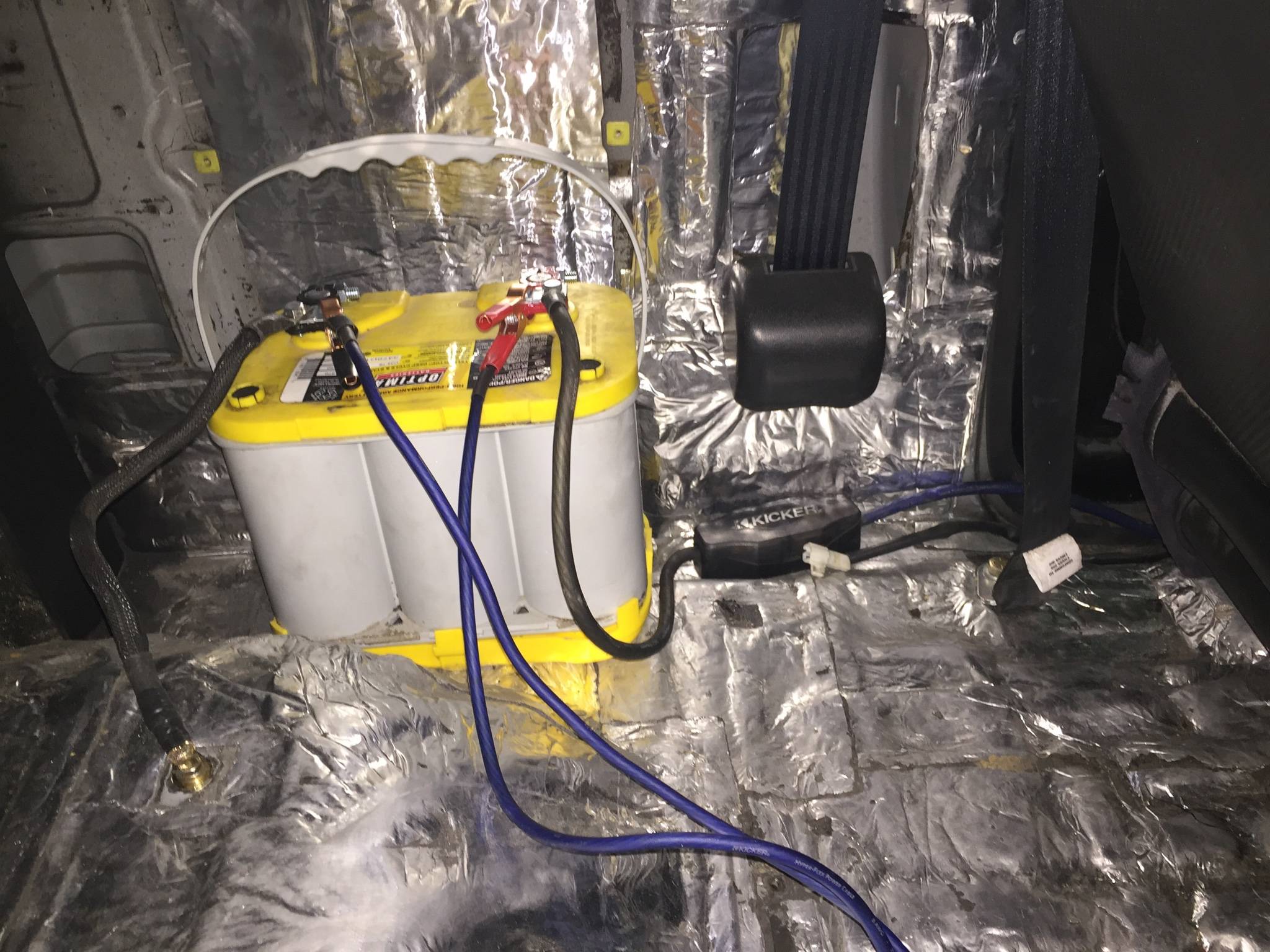

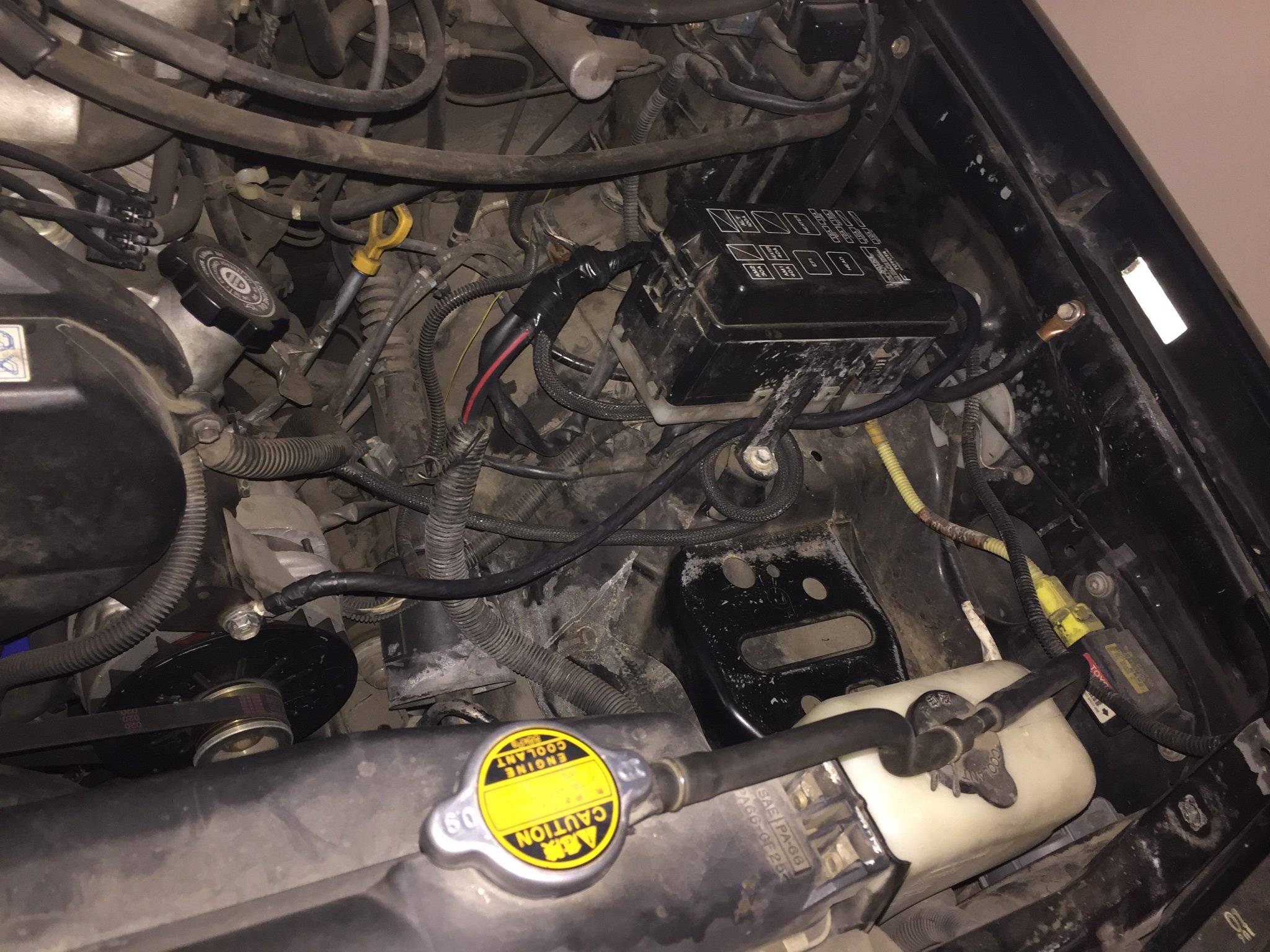

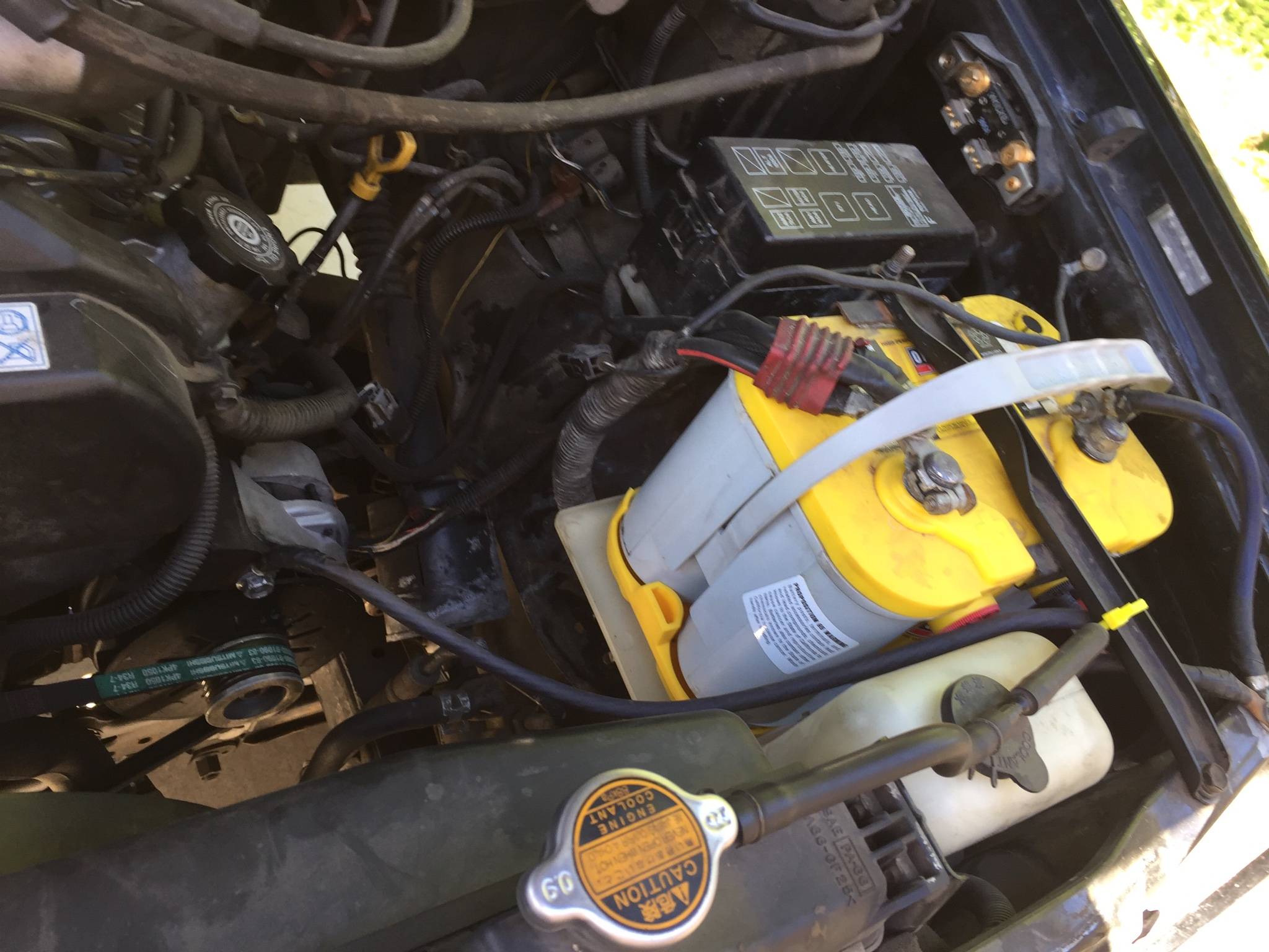

Got the battery relocated. Going to drop the truck back off at the shop today to get the roof finished up.

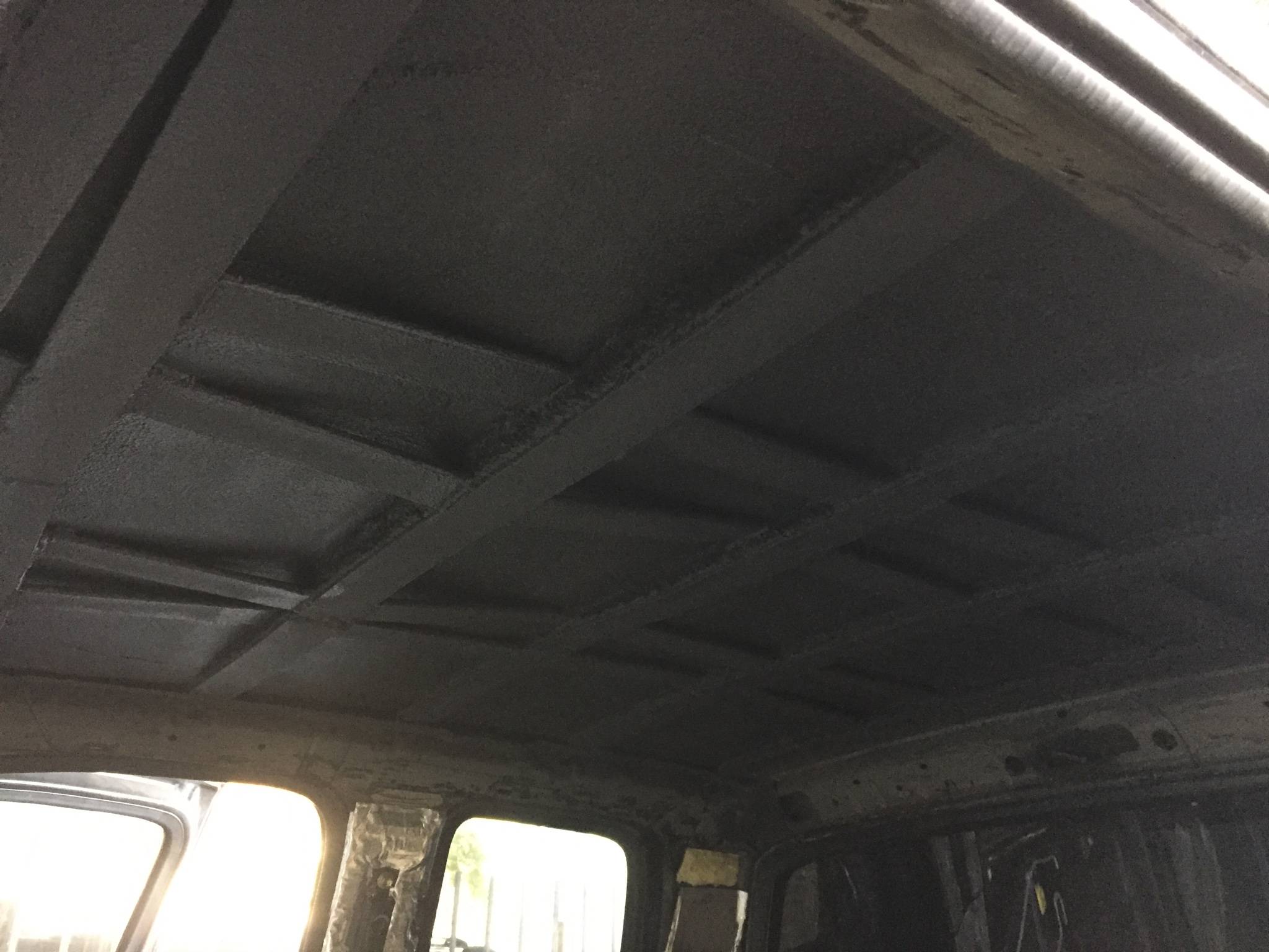

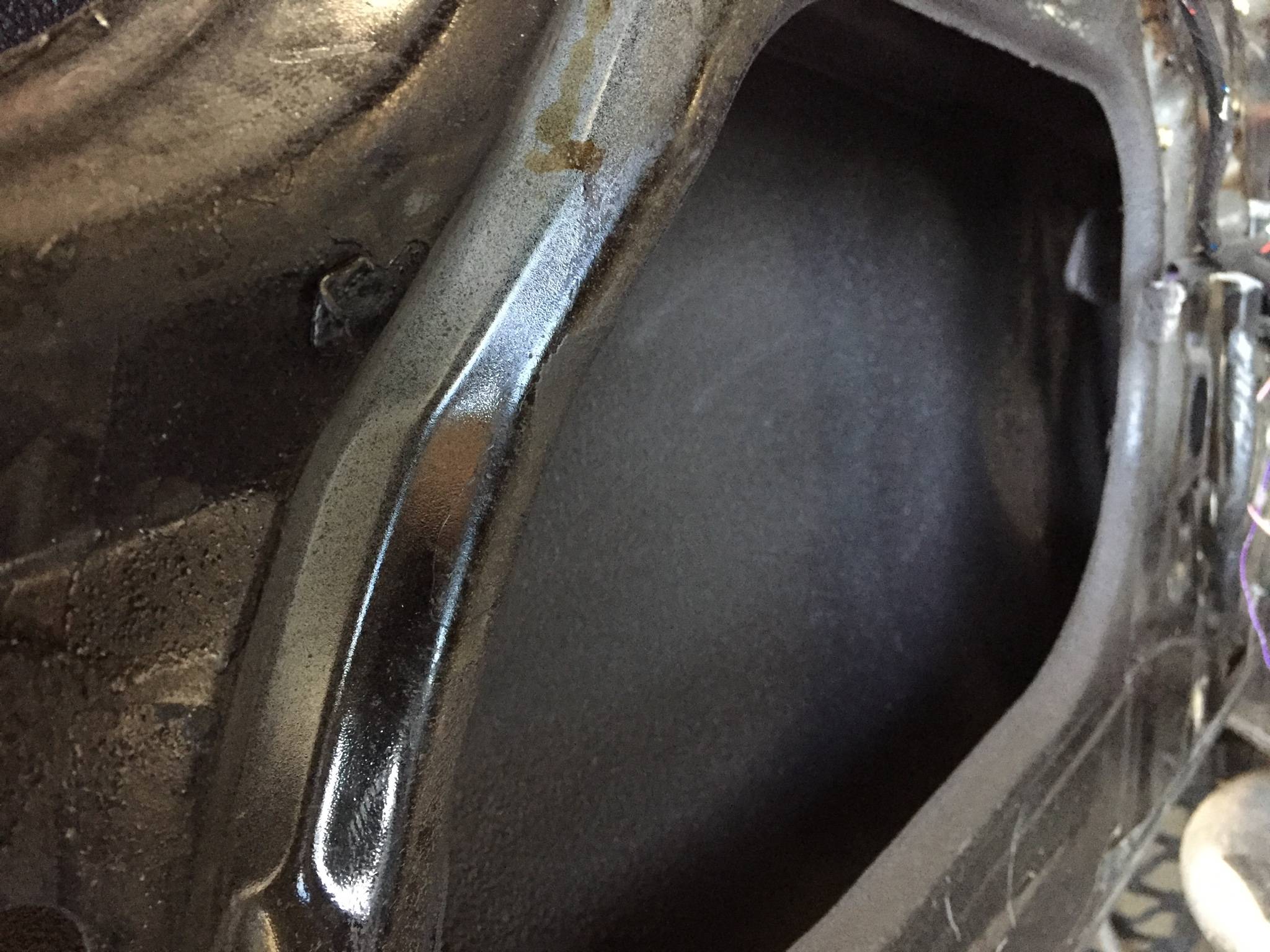

4 layers of second skin spectrum got sprayed on the inside of the roof. I'll probably do one or two more coats because we have so much left. Each door has about 8 layers sprayed. They are definitely solid enough. I used about 2.5 gallons to do all of this.

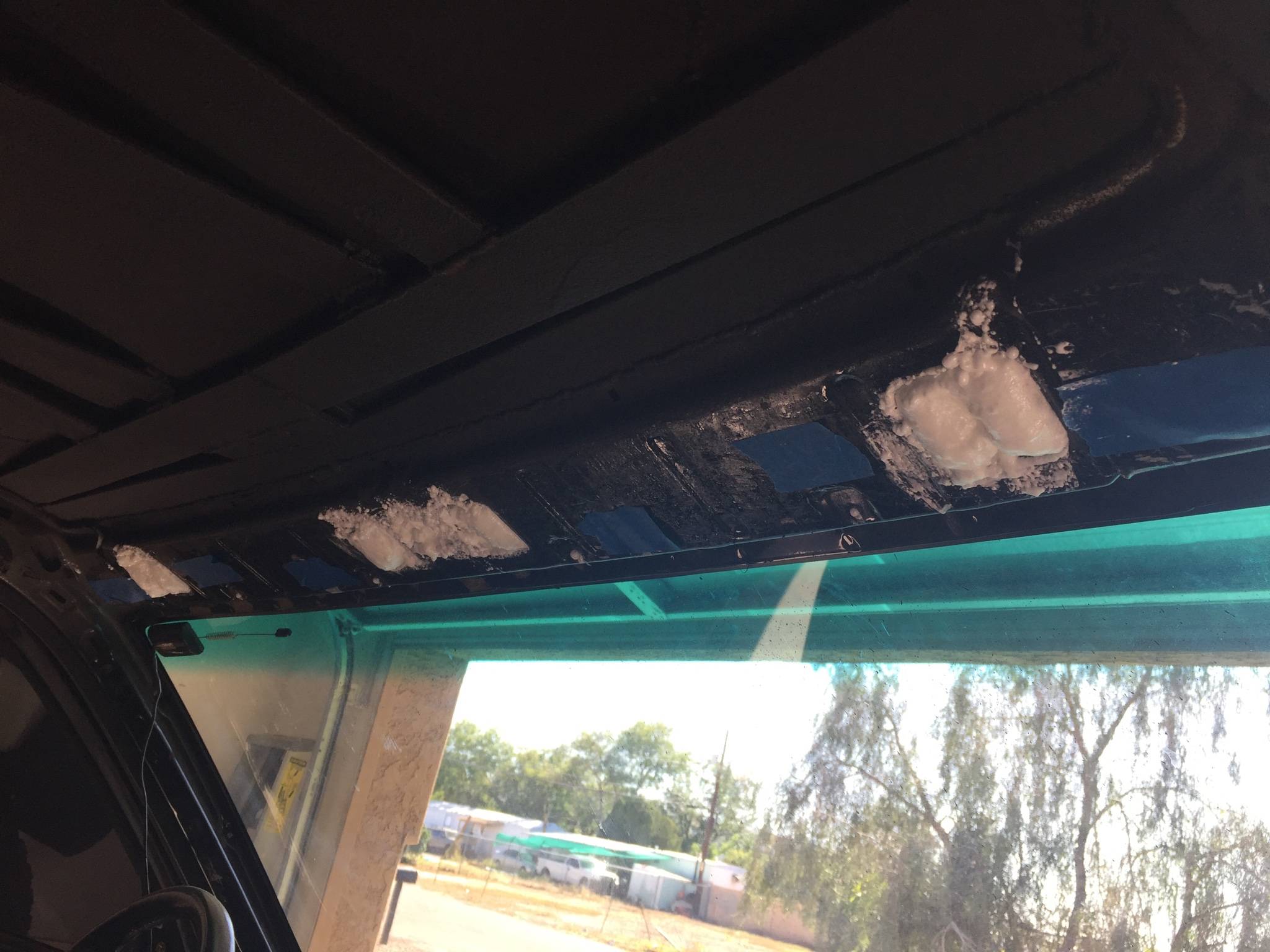

I spray foamed the front and rear cross brace. I used loc tite this time (blue can, white foam) and it is definitely denser than great stuff. It's a few dollars more and you get a little less but it seems worth it.

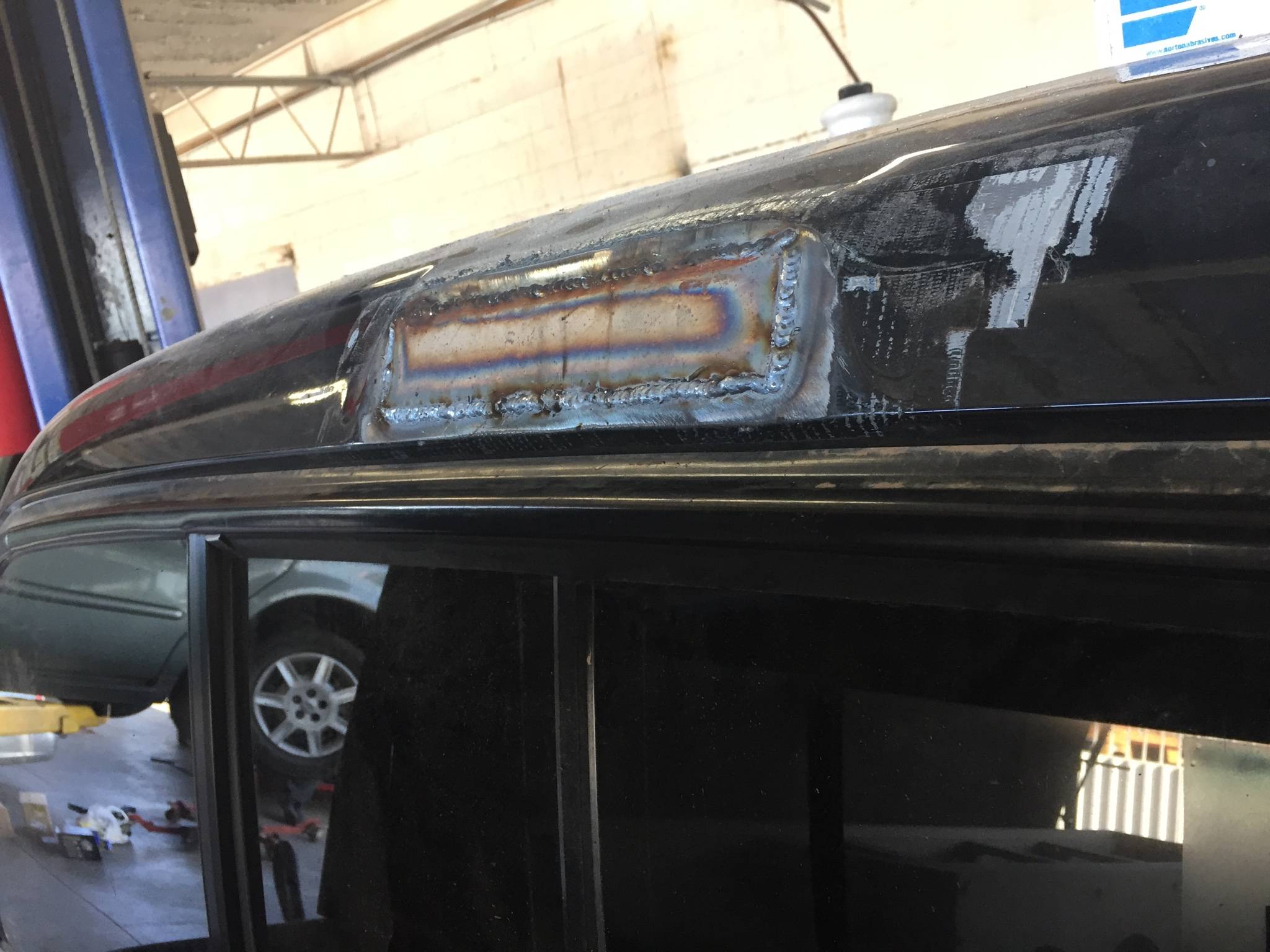

Third brake light was removed and welded shut. It got ground down today.

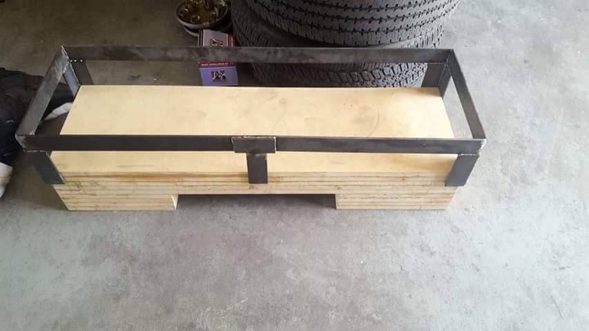

Battery rack is nice and solid for the 420 lbs worth of Reikkens.

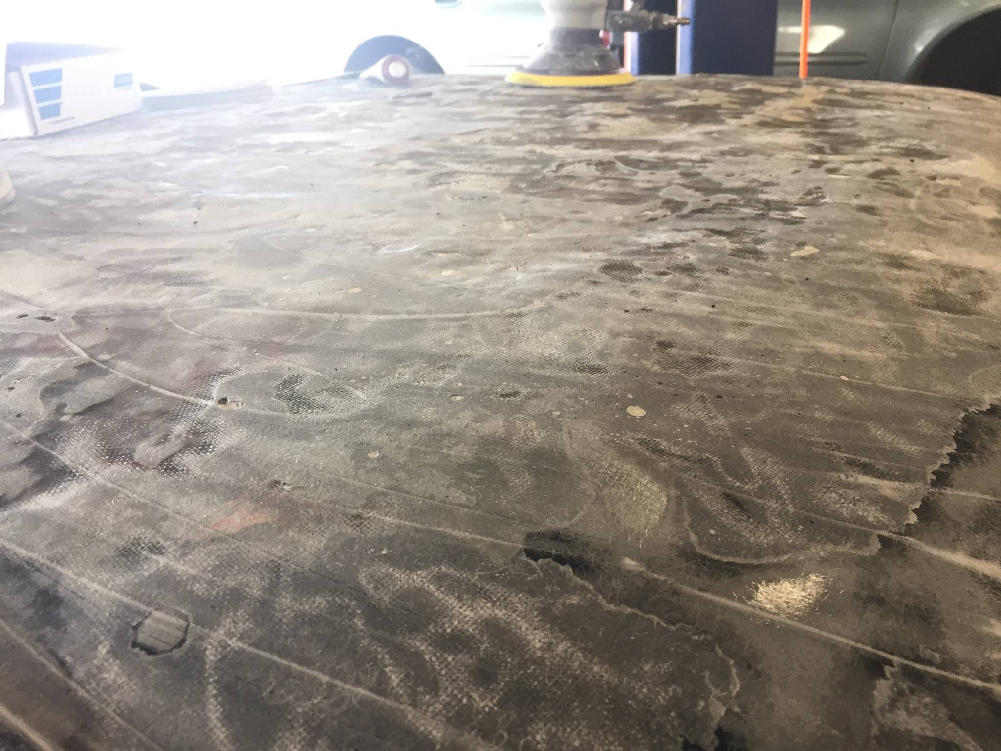

The outside of the roof still needs some sanding and filler to even it out. We are afraid the filler or resin/mat might crack over time because of the vibration. We hope that it won't with all the steel and second skin sprectrum up there, but just to be safe we will be vinyl wrapping the roof instead of painting it.

Oh no...Optima battery?!?!
Nice collection of stickers you got there. Just started putting mine on my garage door.
Lol the optima will get sold as soon as the Reikkens are installed.

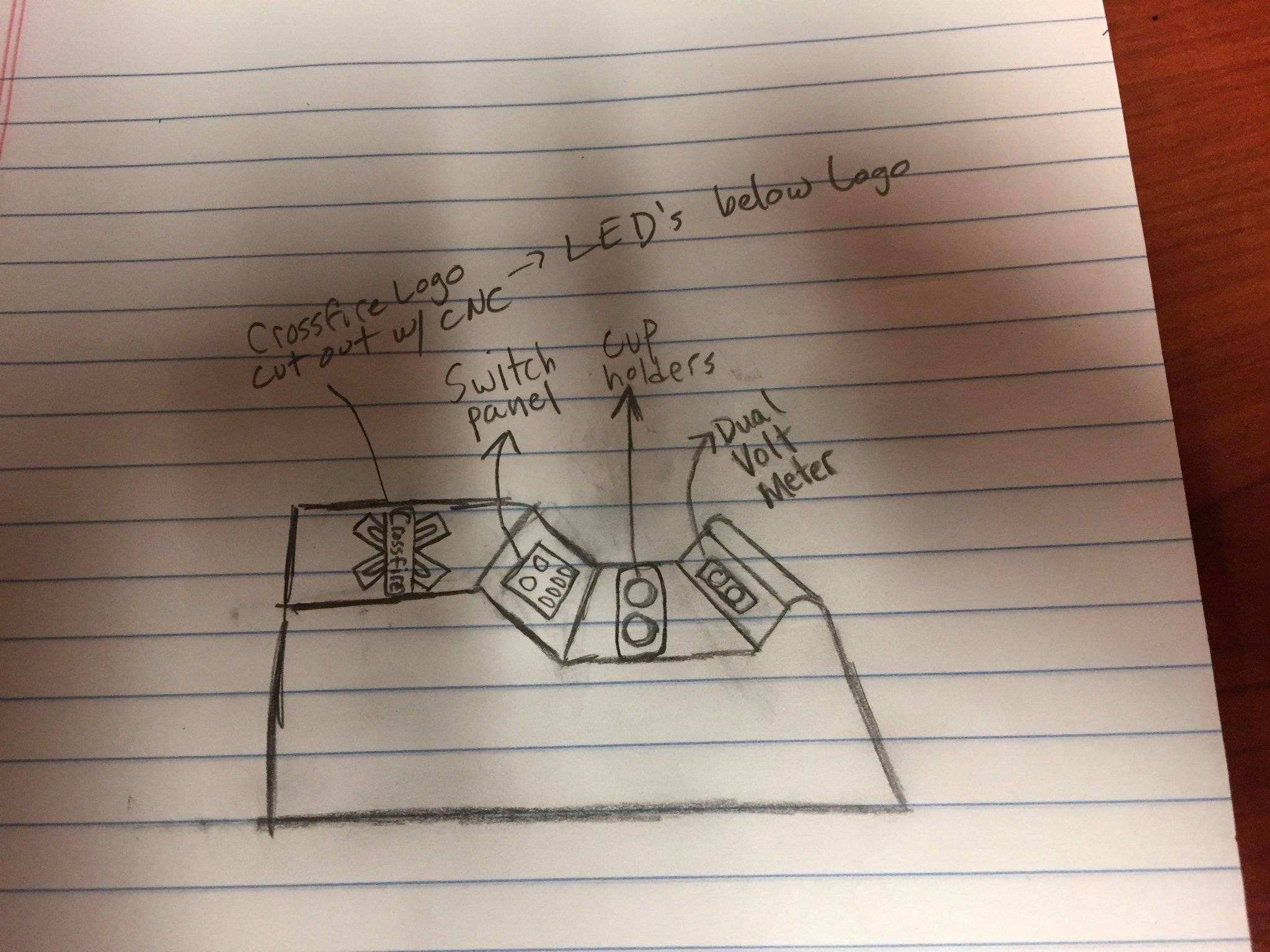

Center console design
LED cup holders

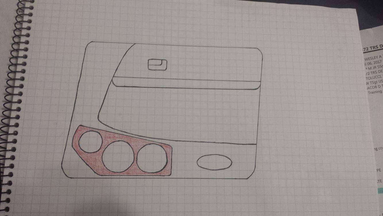

Door design

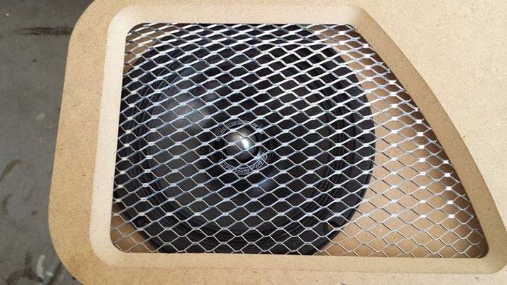

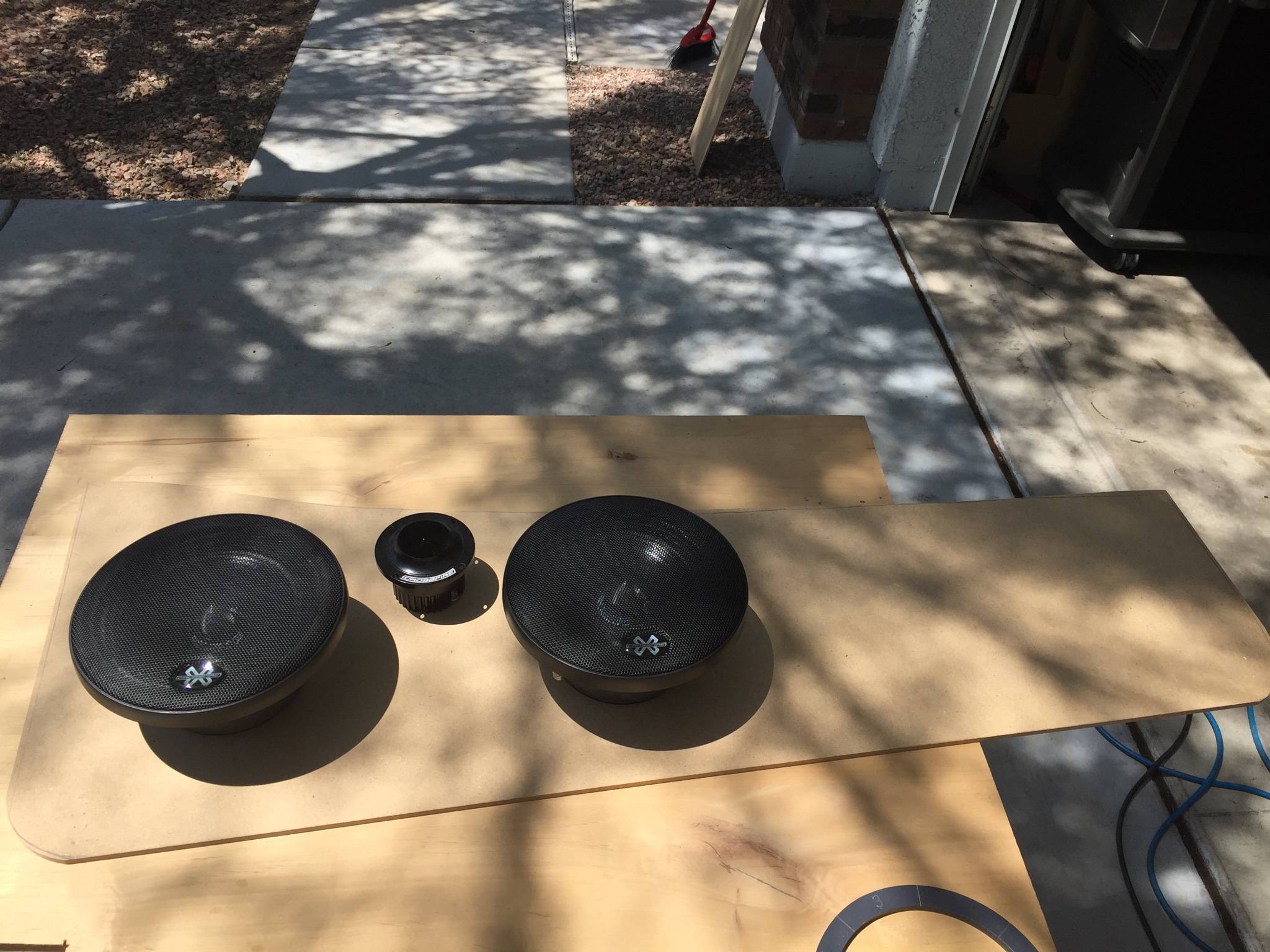

Part of the door mock template. I think I'll do tweeter first then the two 6.5s like in the design above. We just wanted to see what it would look like with the tweet in the middle. The problem with this placement is the second 6.5 would be completely suffocated by the seat.

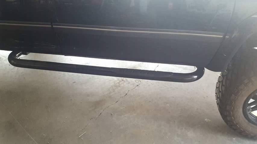

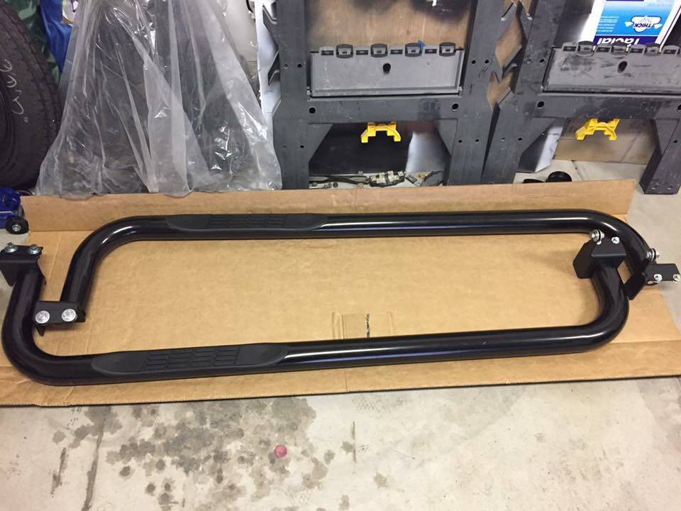

New black nerf bars installed. 30% off so I had to pick them up. Direct bolt on was nice!

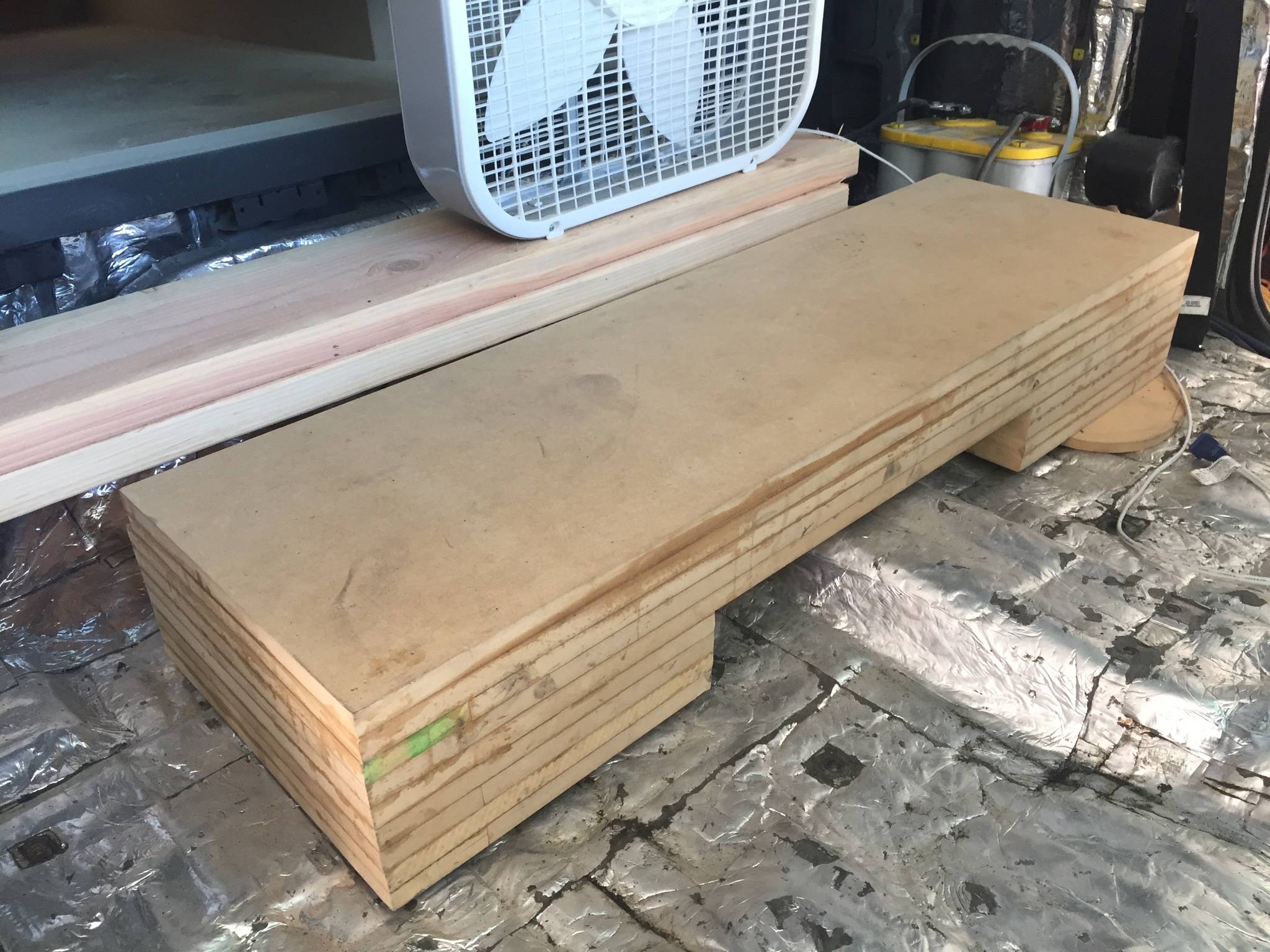

Battery rack is almost done. Needs to be ground down and bolted to the wood base.

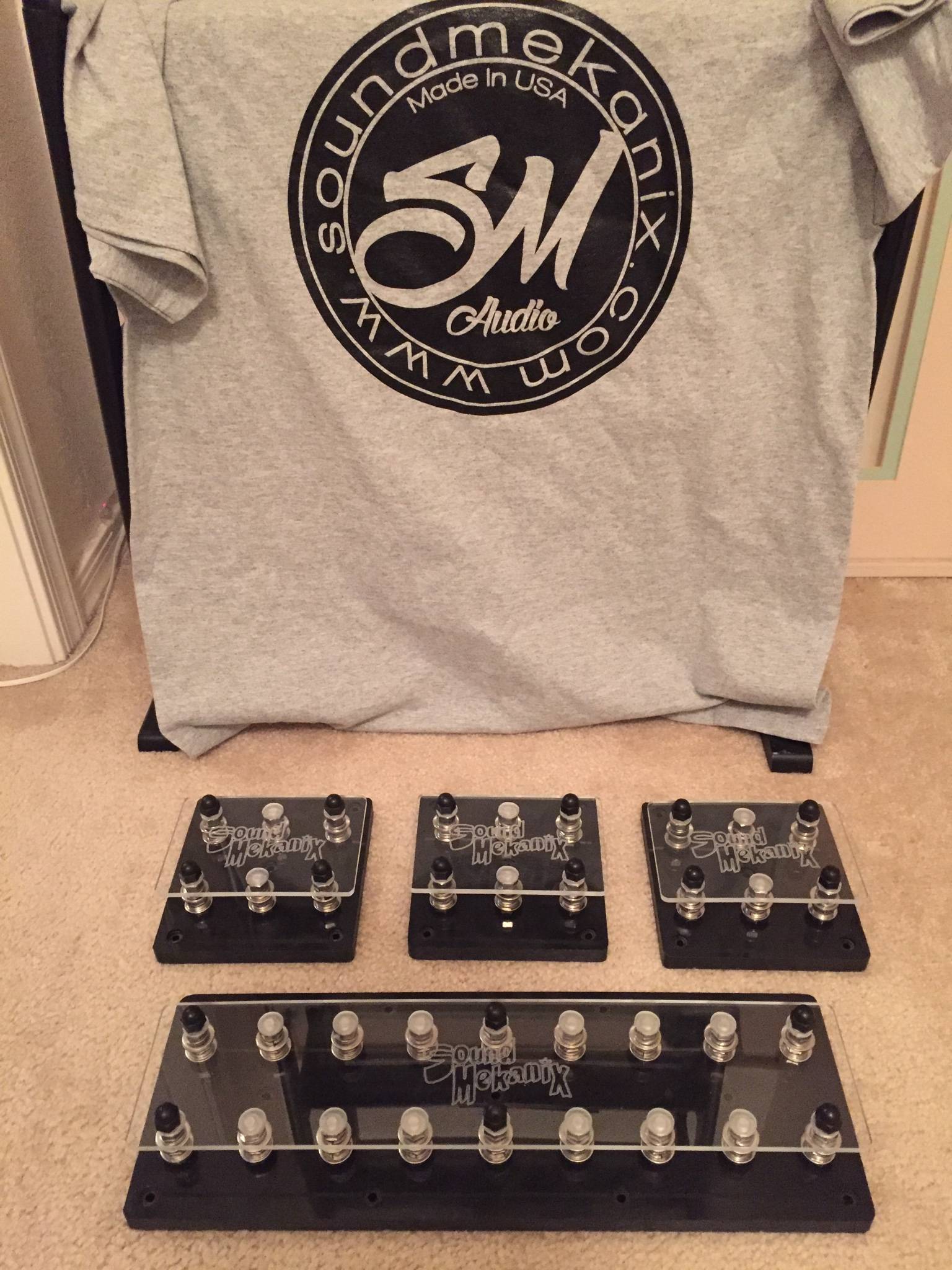

More 3 spot Sound Mekanix fuse blocks and a custom 9 spot fuse block

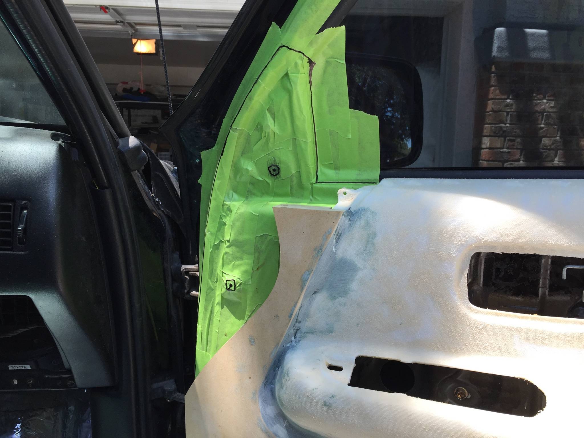

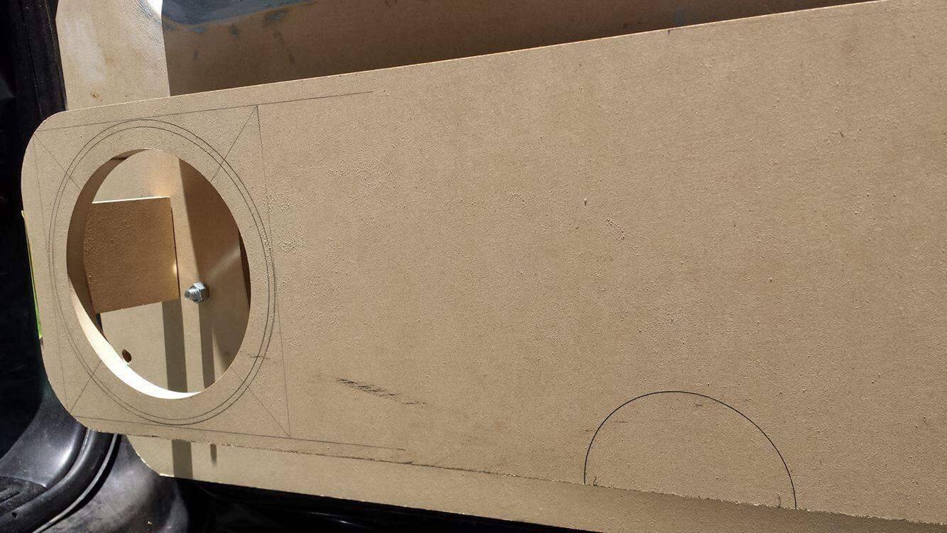

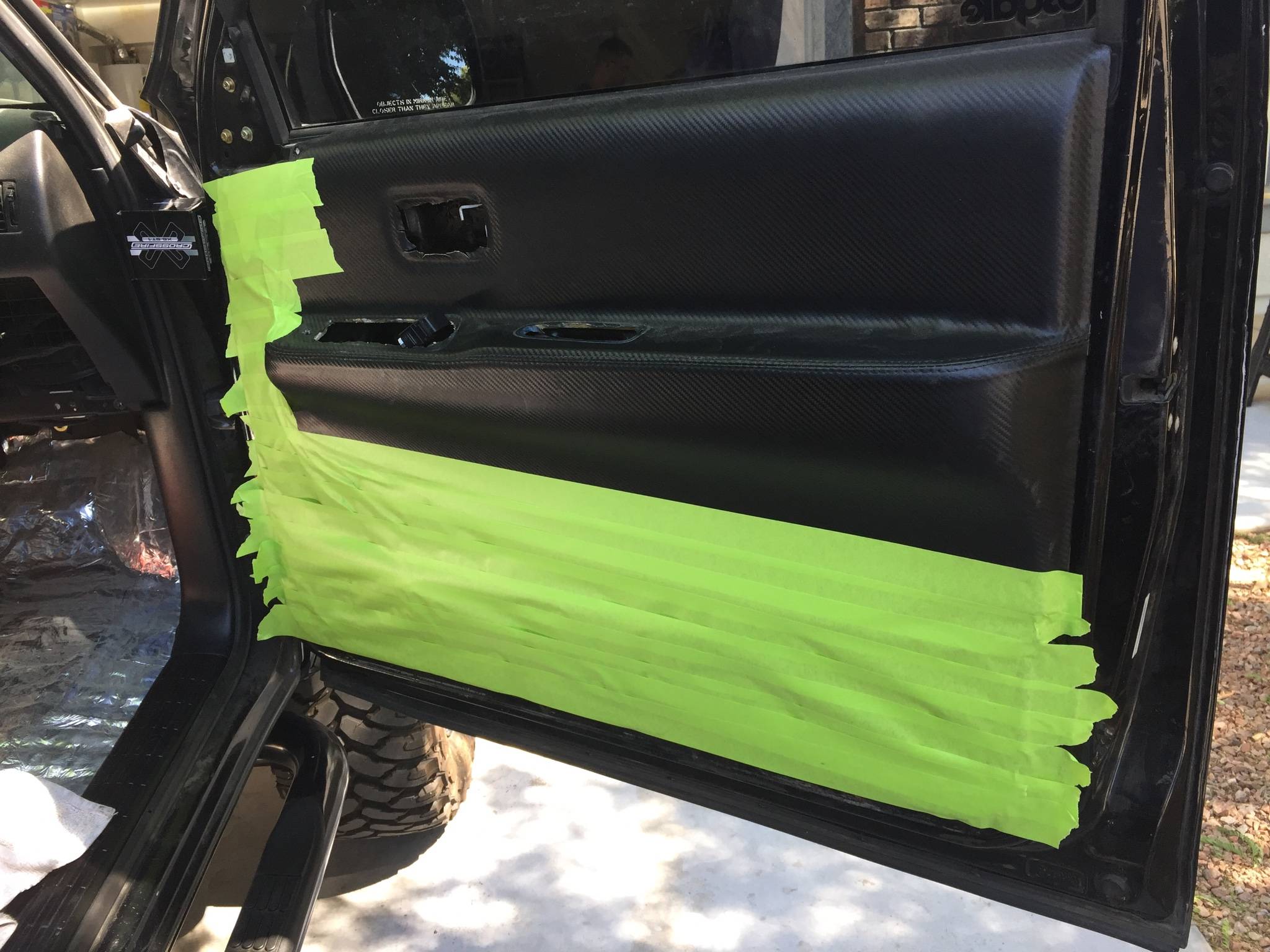

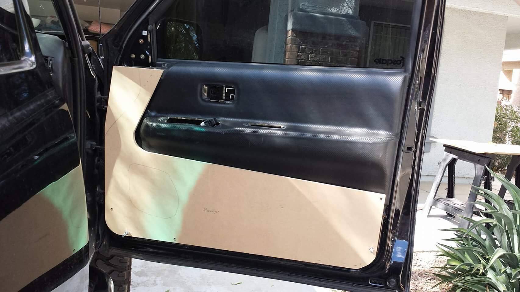

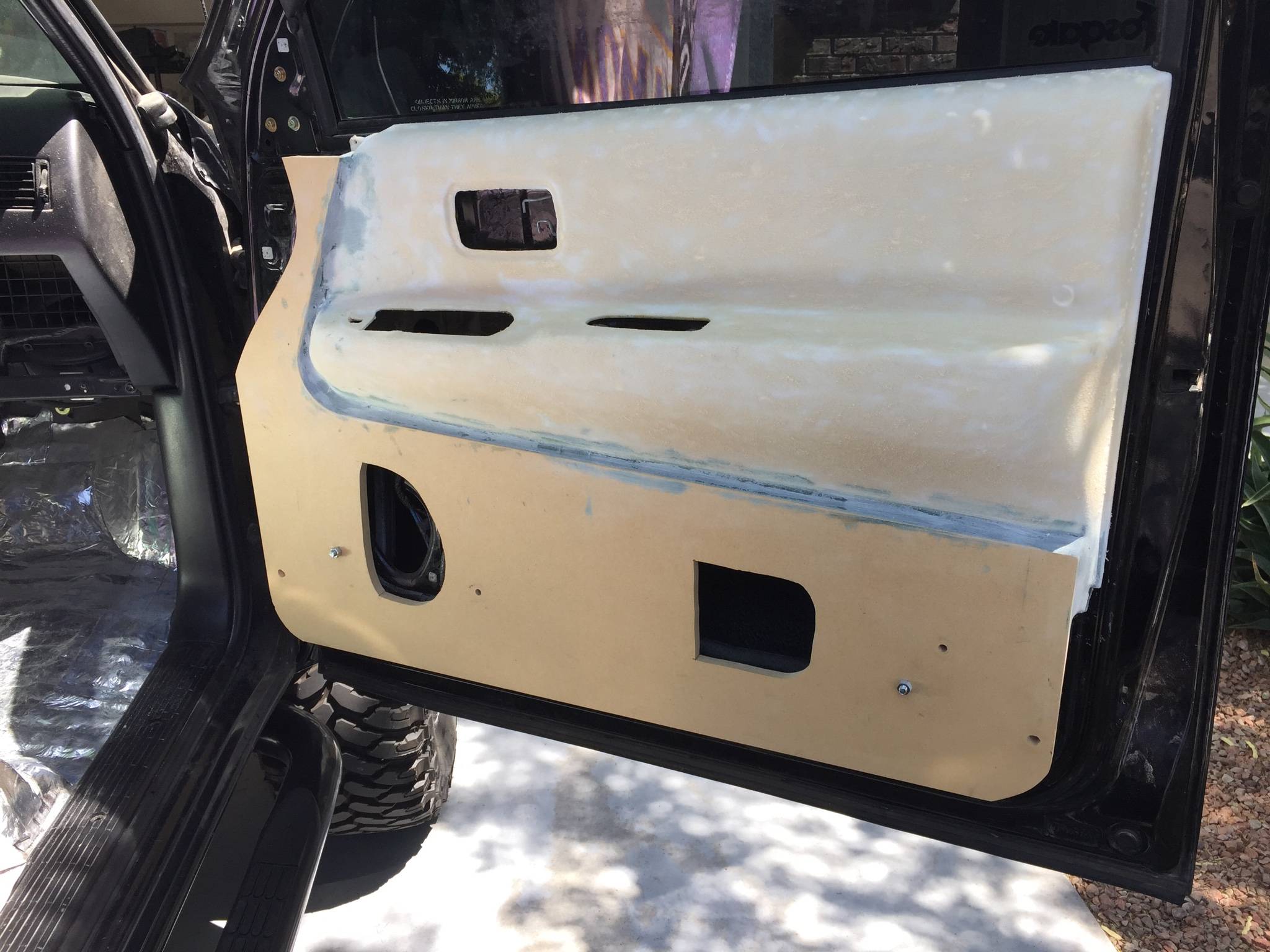

Used masking tape to get a rough outline of the door panel base

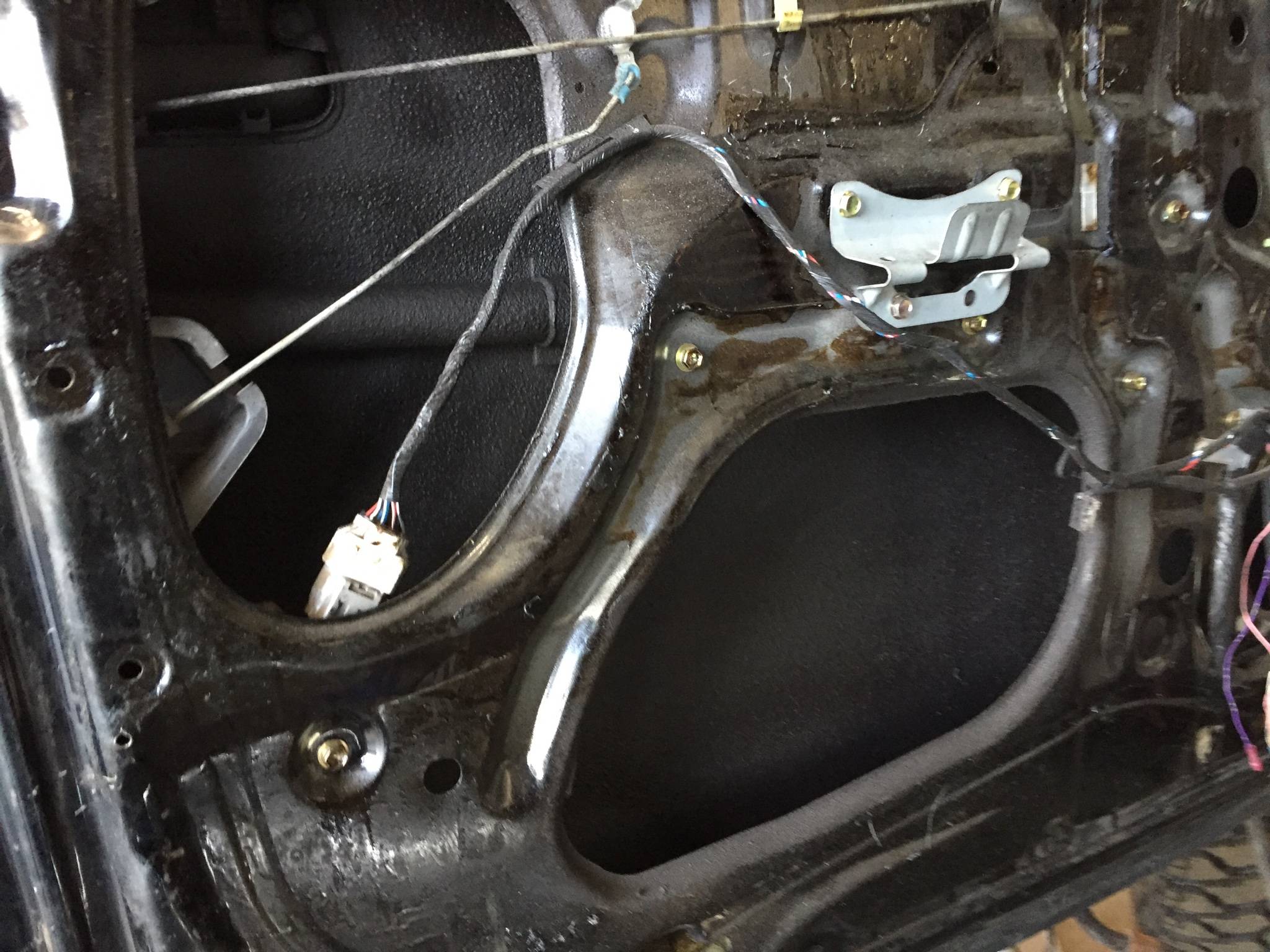

The two large holes in the door are for access to the bolts that will hold the panel in place. The holes and bolts will be covered with a pressed panel
We connected the wood door panel to the top portion of the oem panel using fiberglass reinforced body filler. It's a solid single piece door panel now
We decided to go with 1 6.5 and 1 tweet on each door since the mounting depth of these speakers is crazy deep and I don't have very much room between the door and my seats. It's getting tricky that's for sure! The center console will have 1 6.5 on each side and then the other 4 6.5s and 2 tweets will go in the rear somewhere I'm thinking.

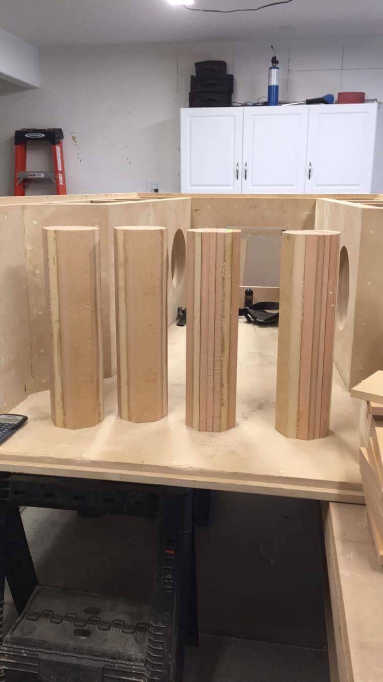

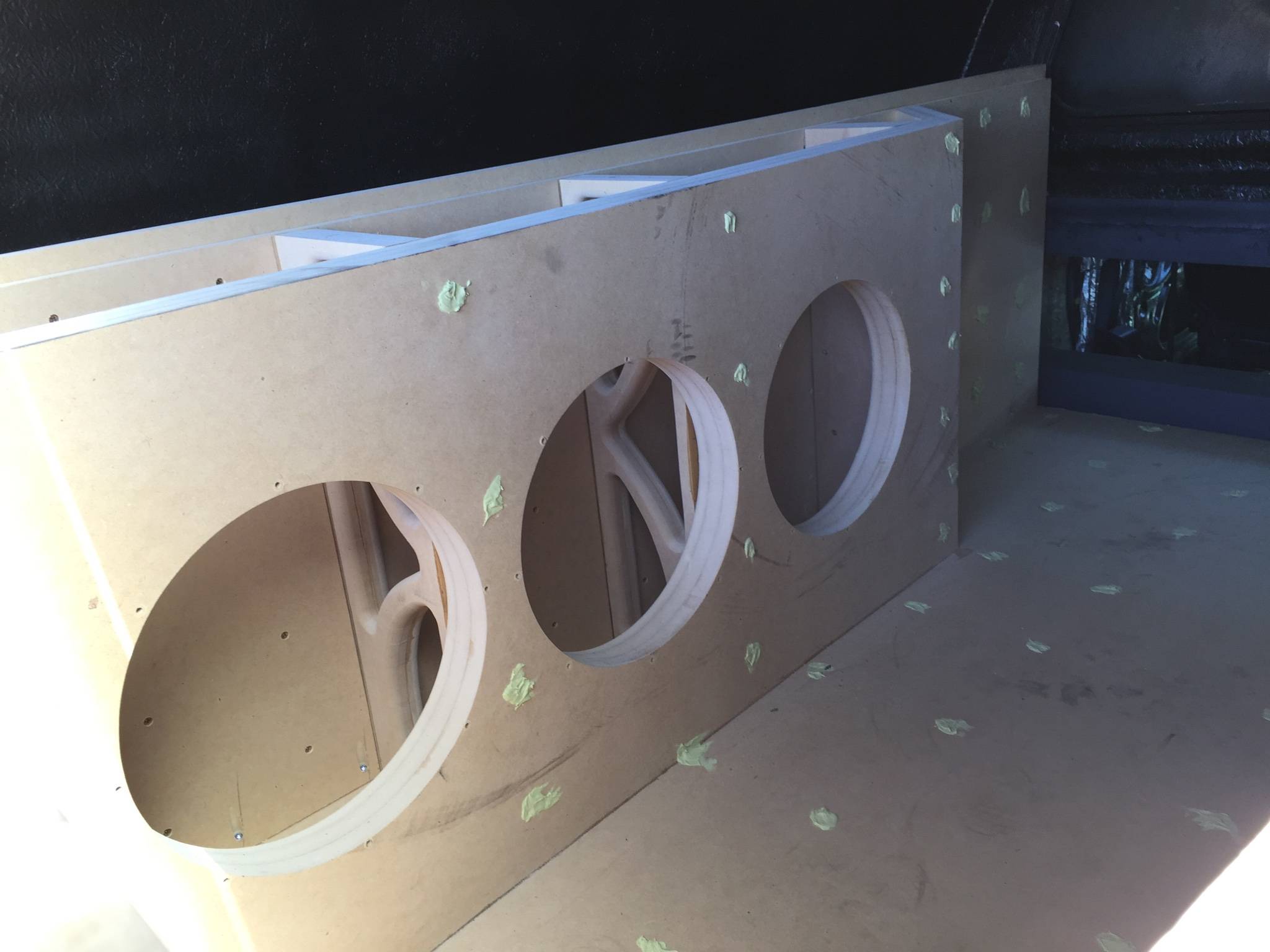

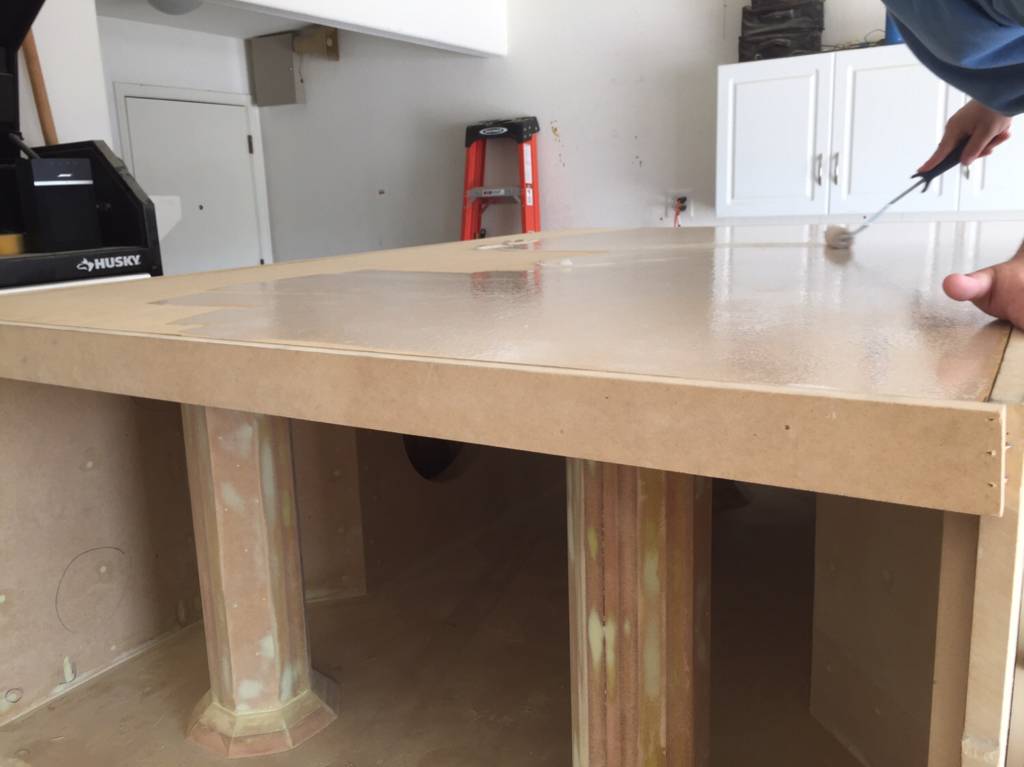

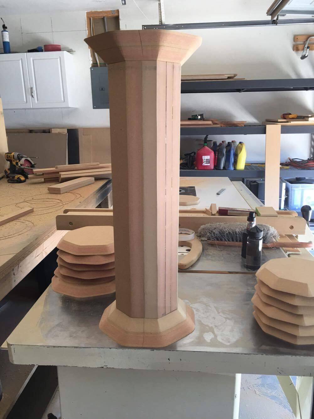

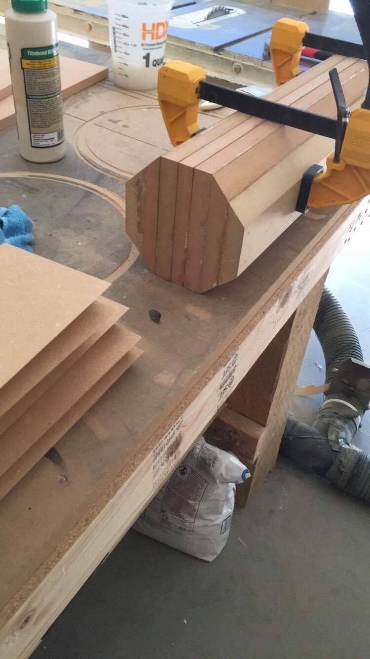

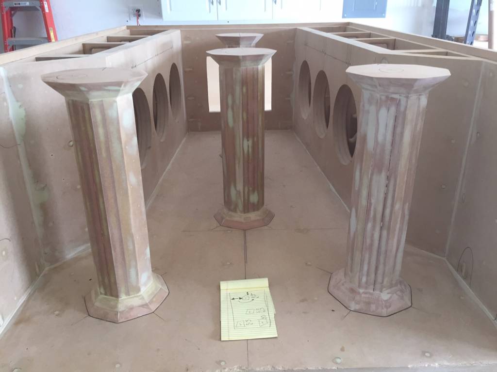

Bracing for the ported side of the box is coming together better than I ever could have imagined. 5" diameter hexagon pillars. My buddy put a lot of work into these. They are crazy solid and look pretty sweet in my opinion

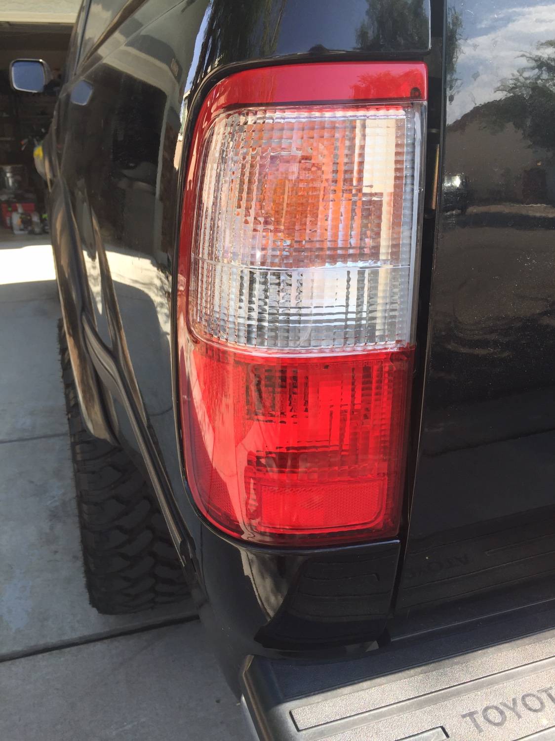

New tail lights installed. They will be blacked out after it cools down more.

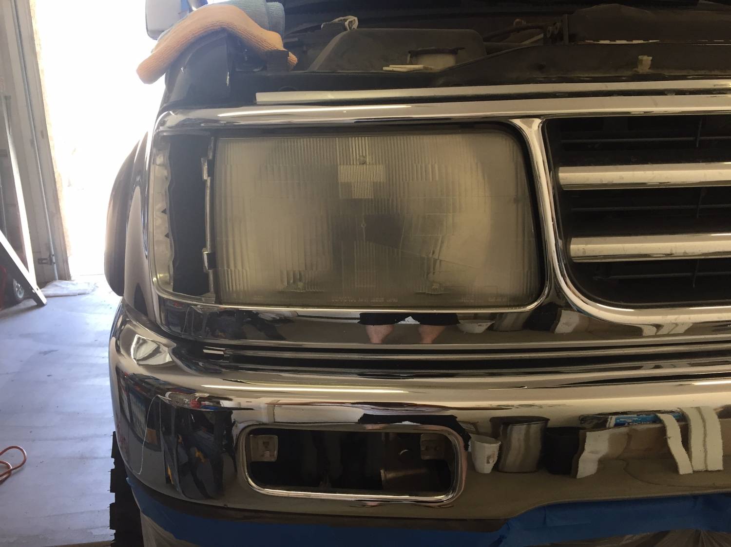

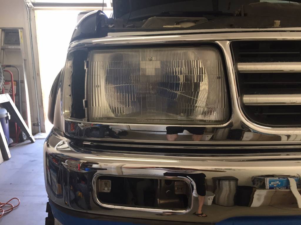

Polished my headlights. Installed new headlight bulbs and new red interior dash bulbs.
Before
After

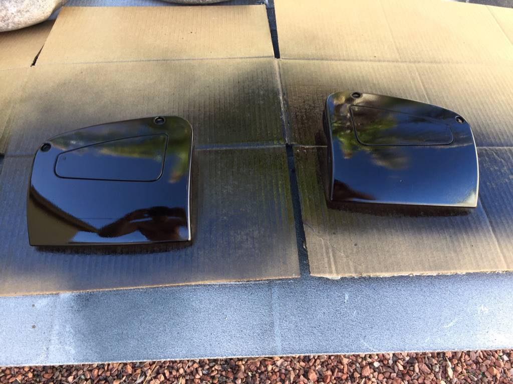

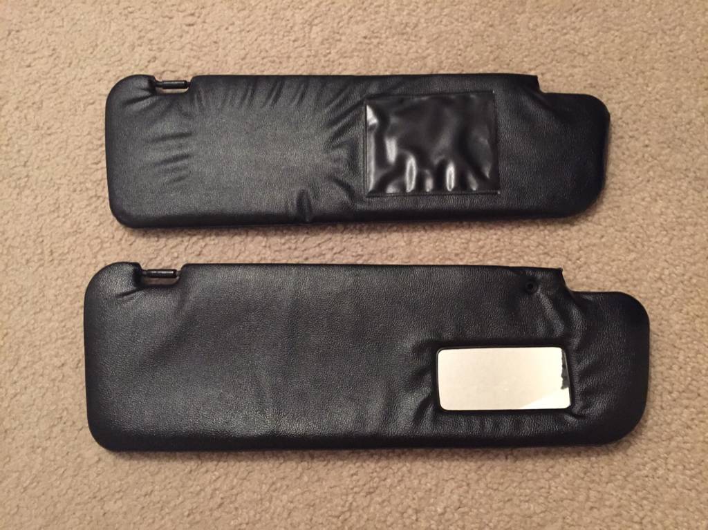

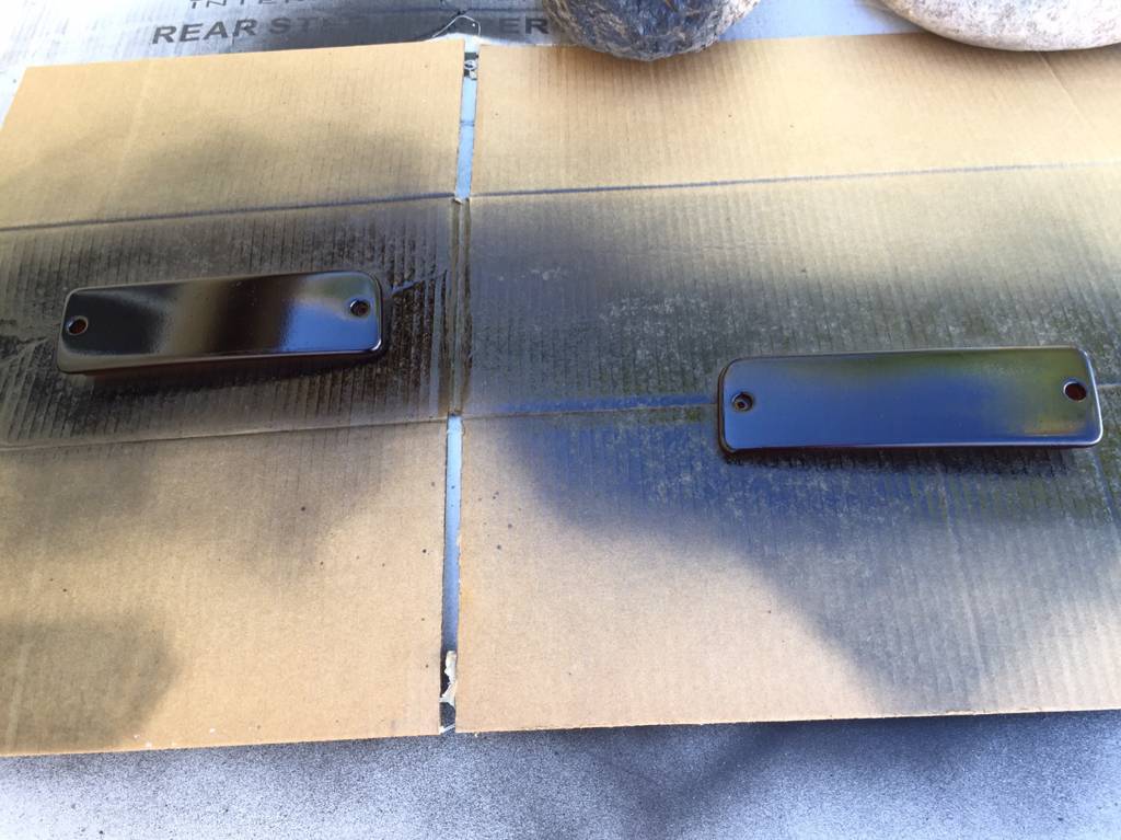

Painted my visors black

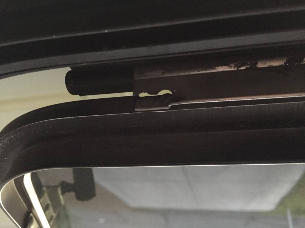

The hinge on my camper shell window is starting to crack. We are going to drill out the rivets and reinforce it with a new plate that will bolt in and be glued with 3M 5200

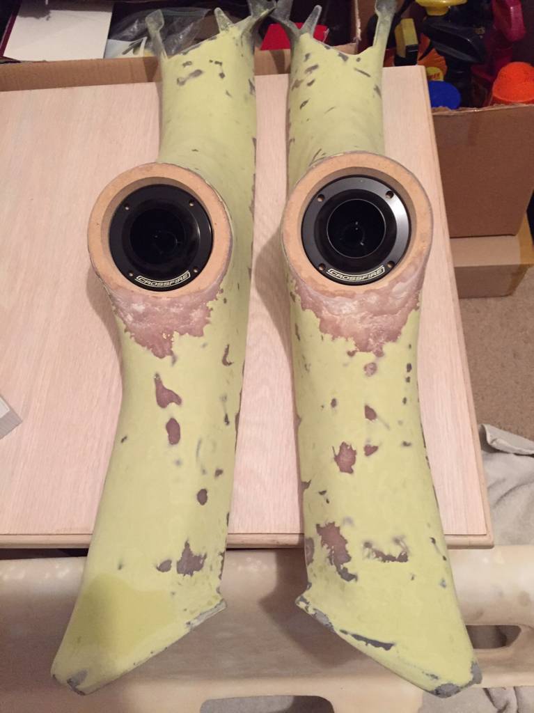

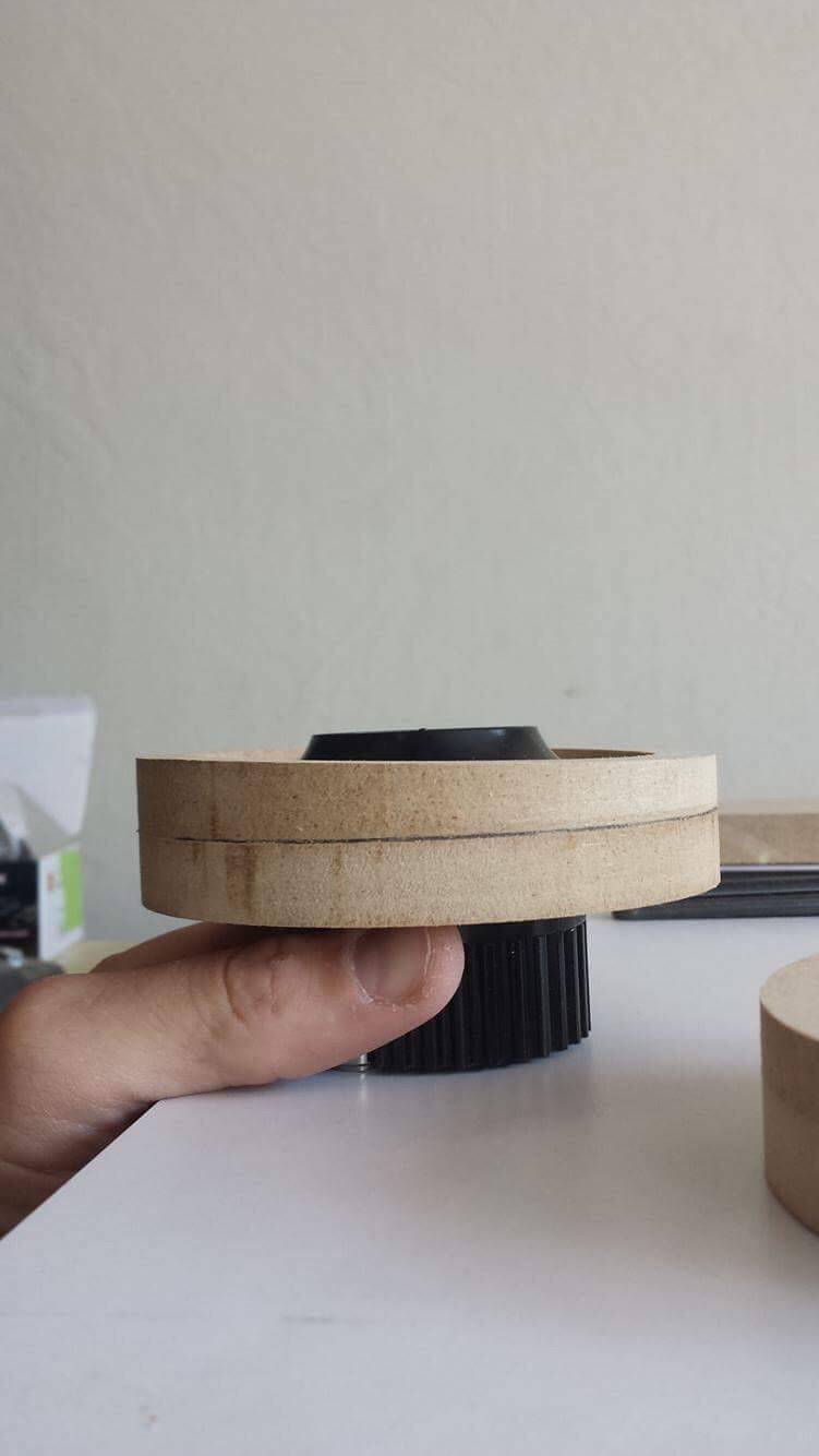

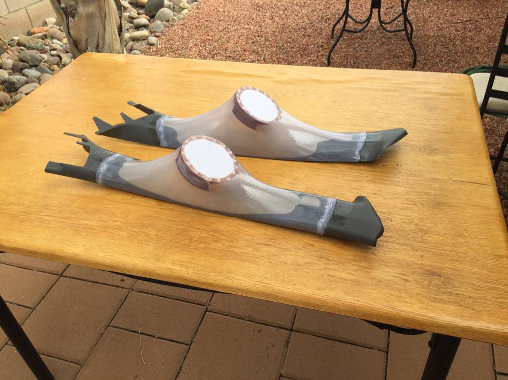

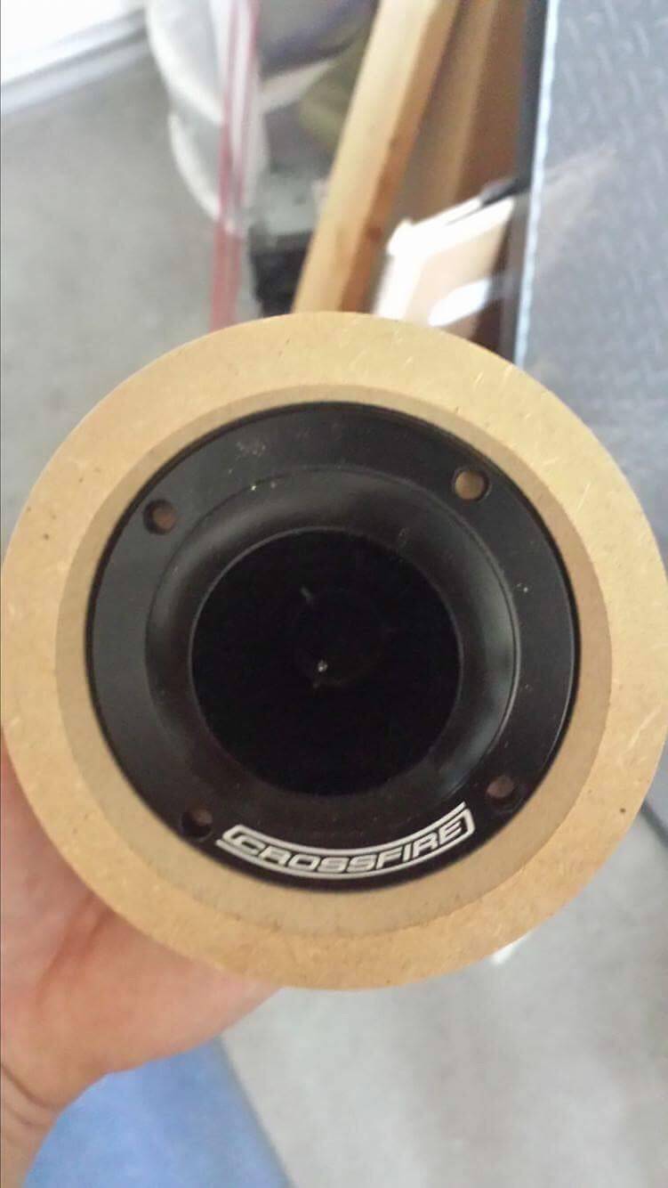

We had to change things up a bit to avoid clearance issues. Originally we were going to do 2 6.5s and 1 super tweet on each door, and 2 6.5s and 1 super tweet on each side of the center console. Instead we are doing 1 6.5 on each door and 1 super tweet in each A pillar. Then 1 6.5 on each side of the center console. The remaining 4 6.5s and 2 super tweets will go in the rear

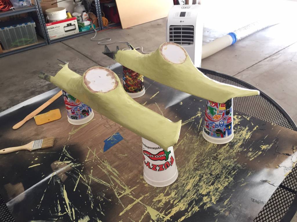

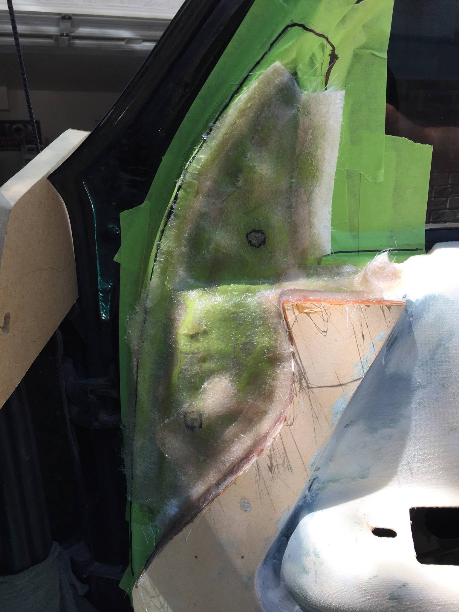

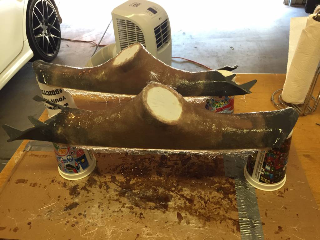

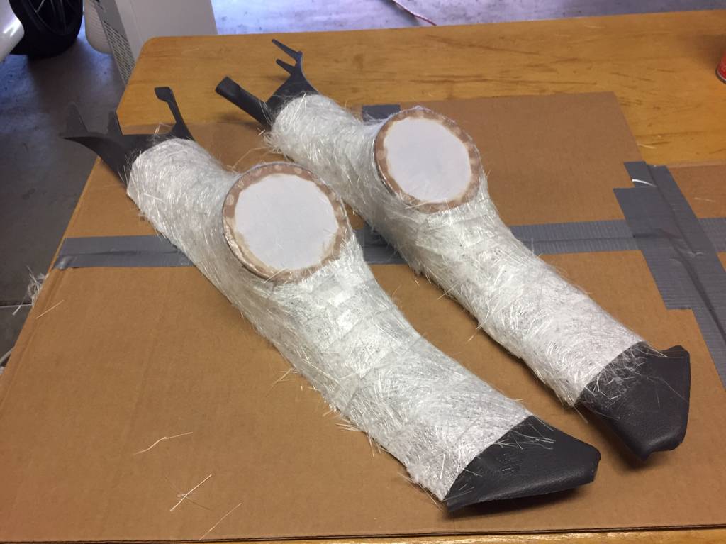

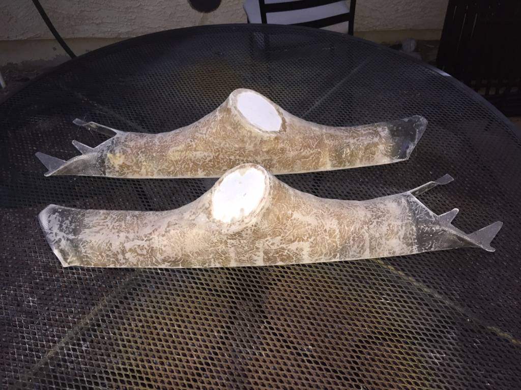

Started fiberglassing the A pillars

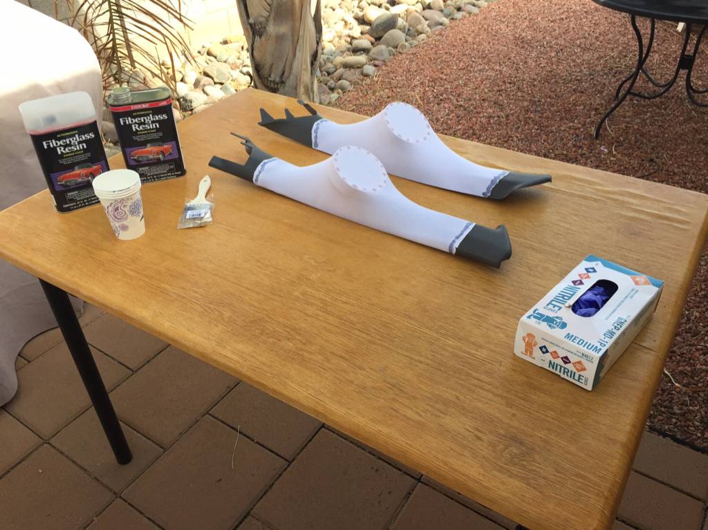

I do 2 layers of resin first to harden the material. This helps prevent sagging when applying mat and resin.
2 layers of mat. They are pretty solid!

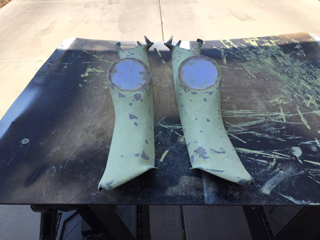

Sanded down high spots
2 layers of milkshake
First pass of sanding. Going to do one more pass of sanding then body fill any low spots

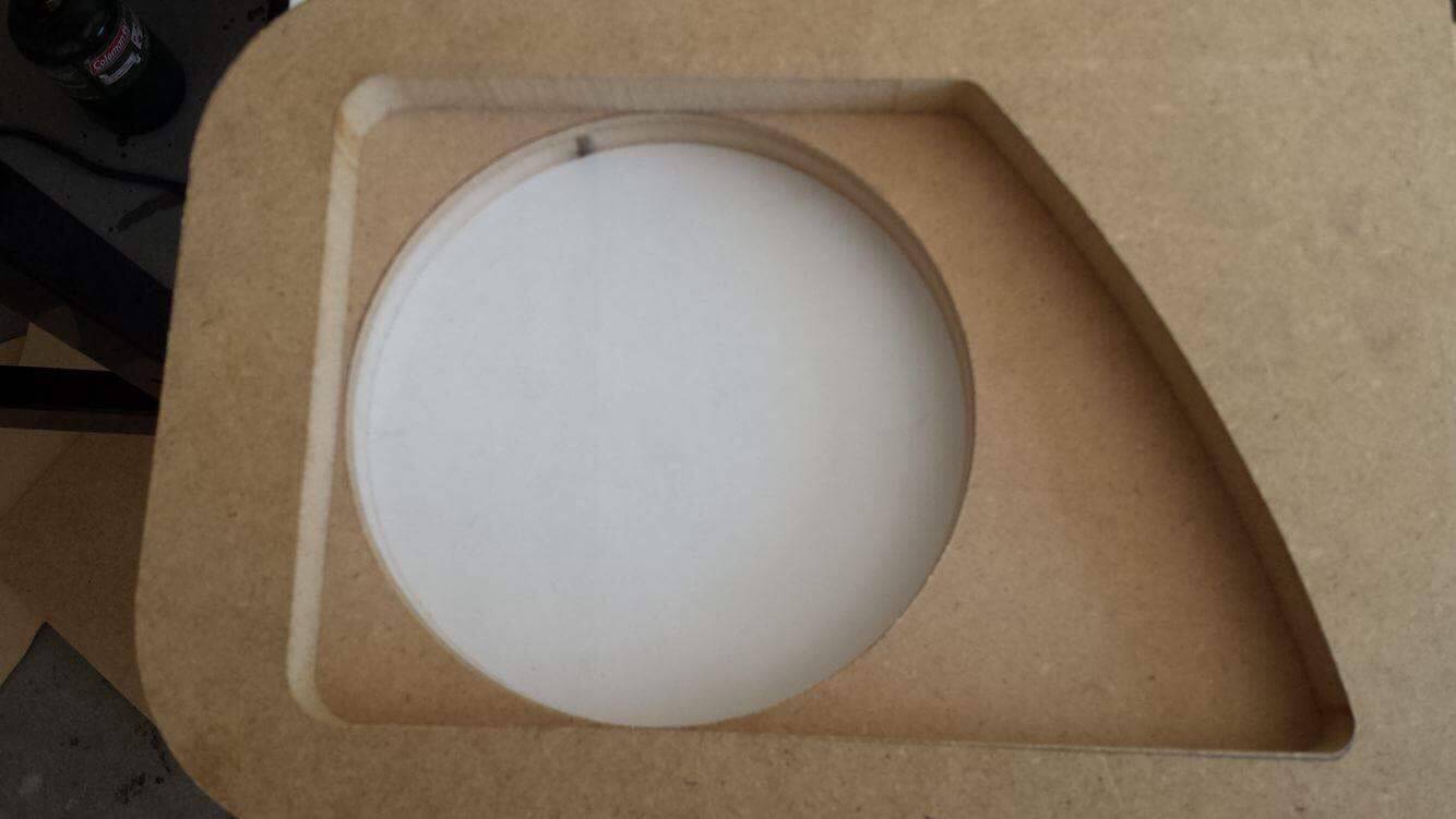

Flush mount chamfered lip looking good imo. Will be wrapped in black vinyl along with the rest of the interior modifications being done.

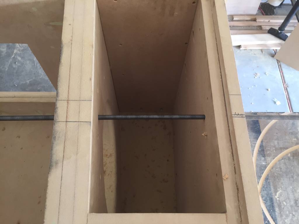

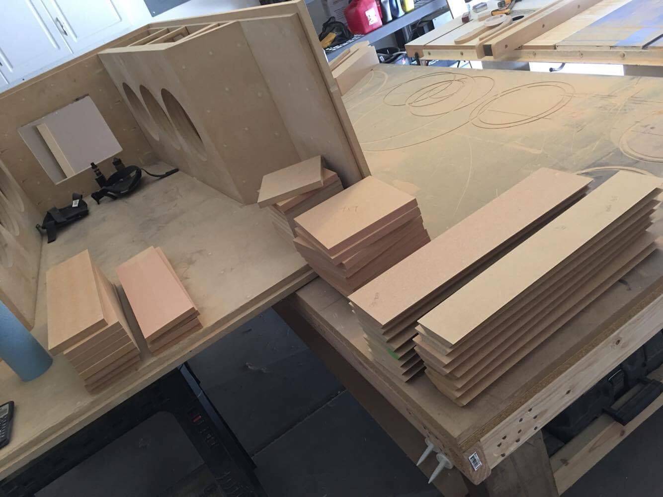

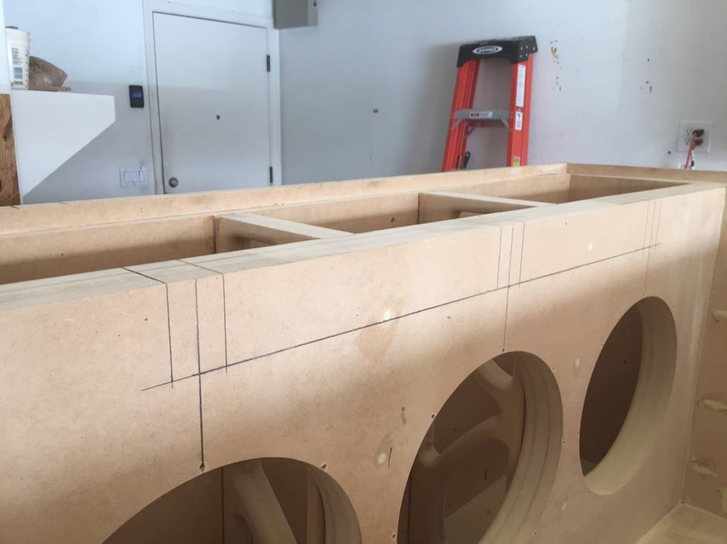

Box is getting worked on again! We got a ton done this past weekend. We will be doing final touches in order to prepare for paint hopefully by the end of the month. Inside of box will be white. Bracing pillars will be black. Beauty panels for outside of the box will be wrapped in black vinyl.

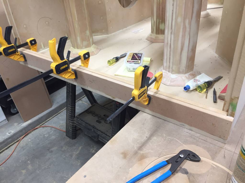

Glued and screwed the two top layers together. The top of the box will be removable in order to easily access the subs if needed.

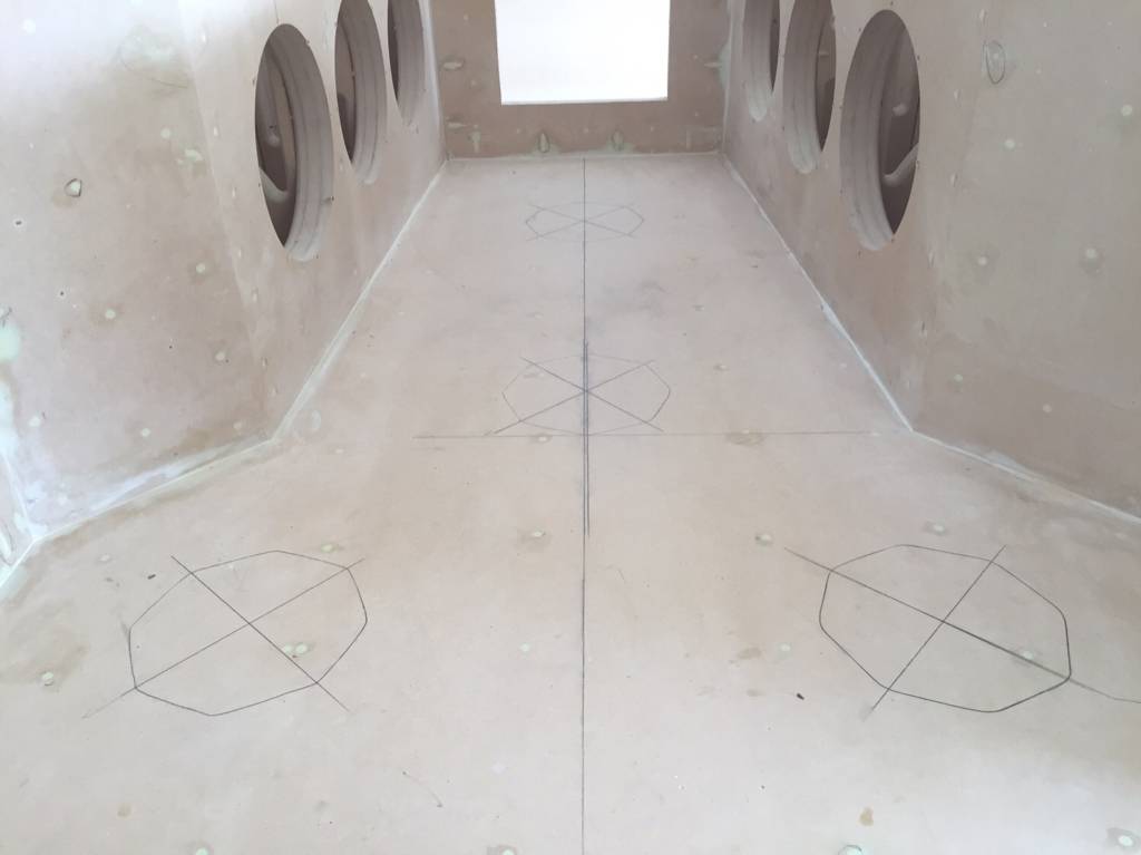

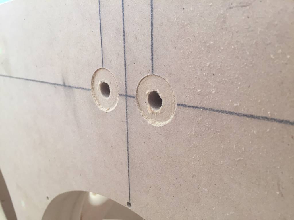

Lined up where the sub terminals will go.

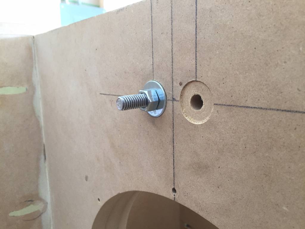

Flush mount washers for terminals
Using 3/8" 6061 aluminum threaded rod

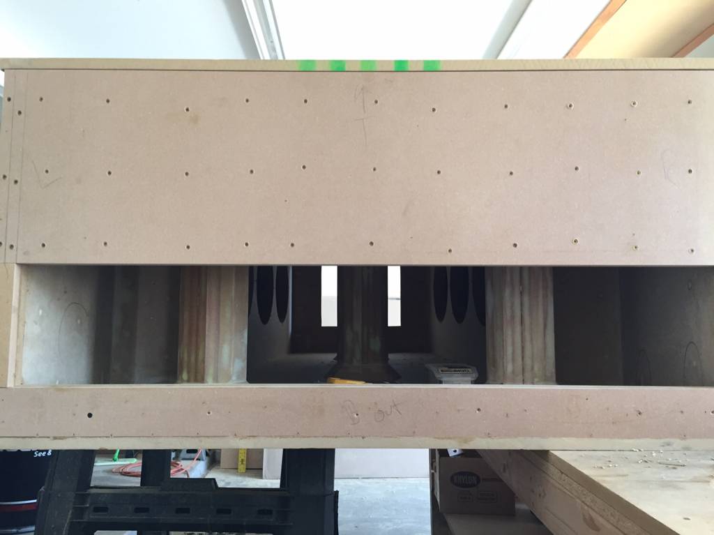

Got the bracing all lined up and in place. Used 3 GRK screws per pillar to secure them to the bottom of the box. They will also be glued in place once the box is painted.
The box has been dubbed the Roman Empire because of the bracing lol.

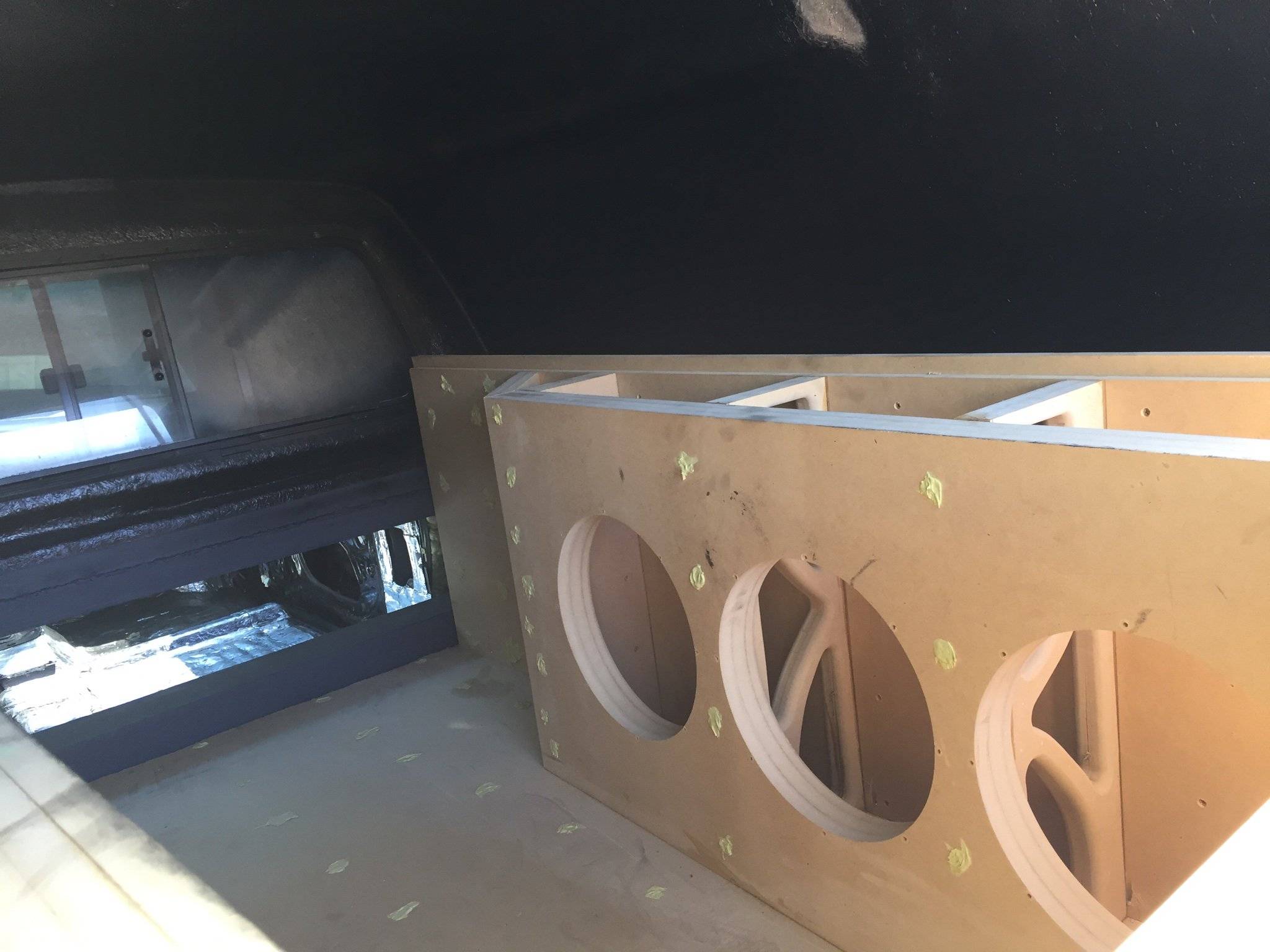

Front of the box is done. Once we get the box loaded up in the truck, we will make the port and determine how to attach it since it will be removable.

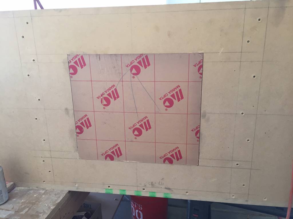

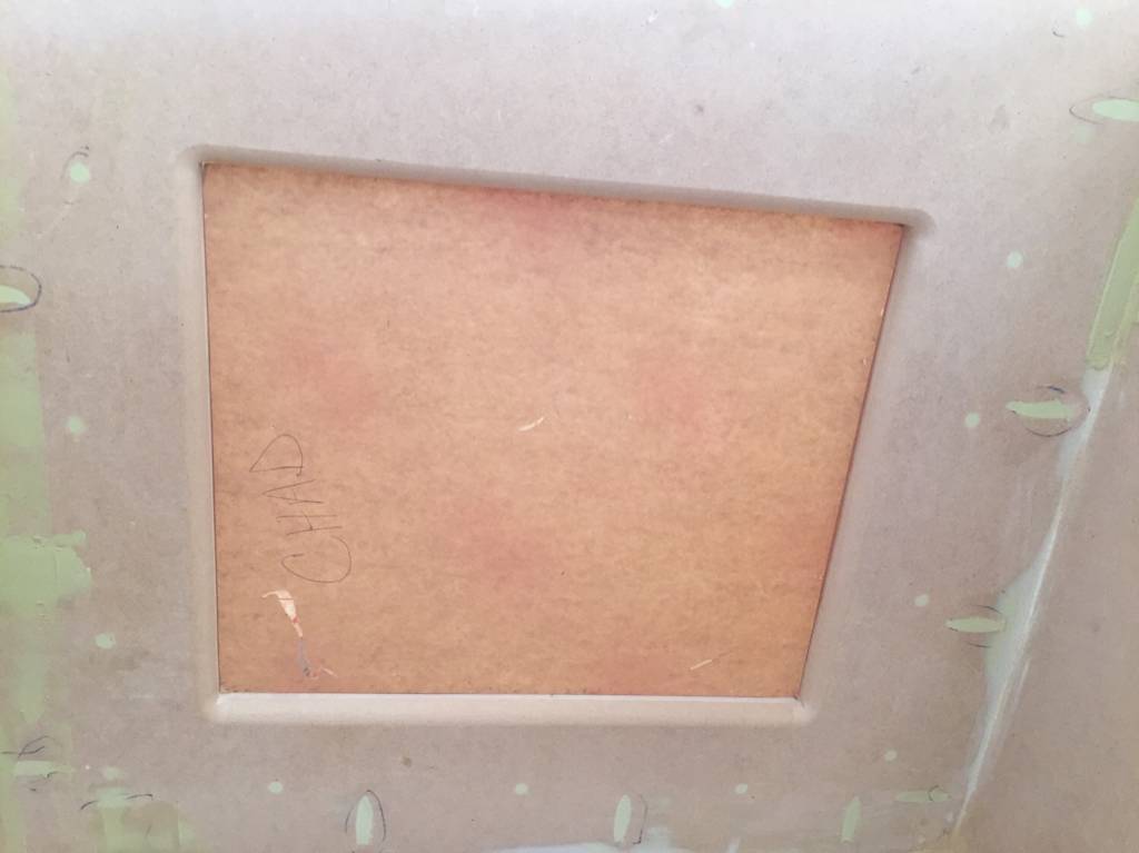

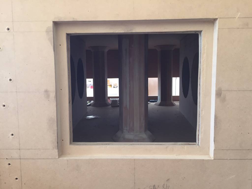

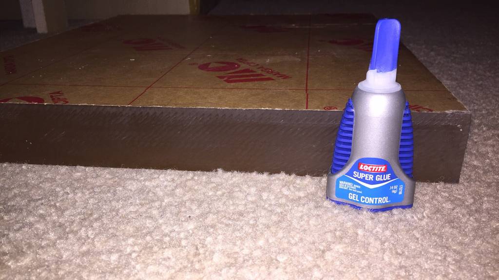

Got a really good deal on 1.5" thick plexiglass so we made it work. It's definitely solid that's for sure
Rounded the edge on the inside of the box around the plexiglass window. Adds a nice finished look

Woah...MDF pillars. There's something I haven't seen before. I would try and paint those, something that catches the eye when peering thru the little window you got going. Lookin' real nice and solid.
