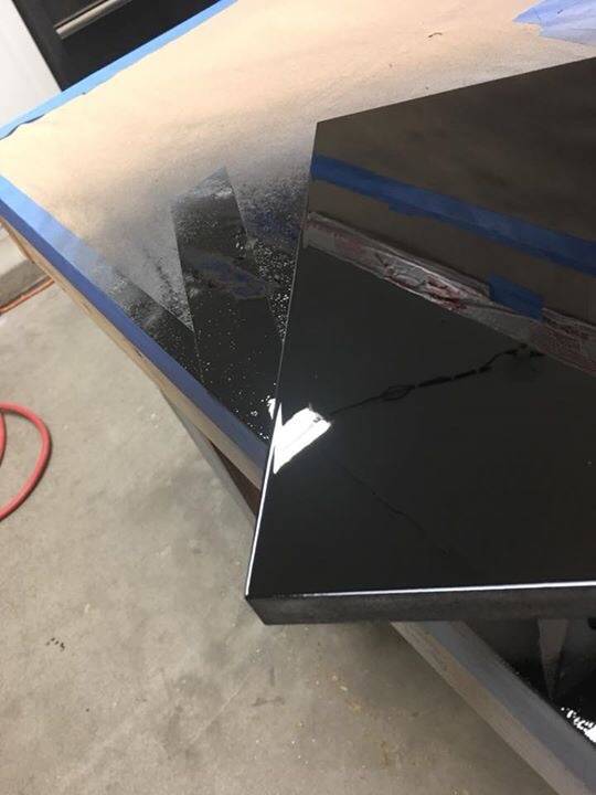

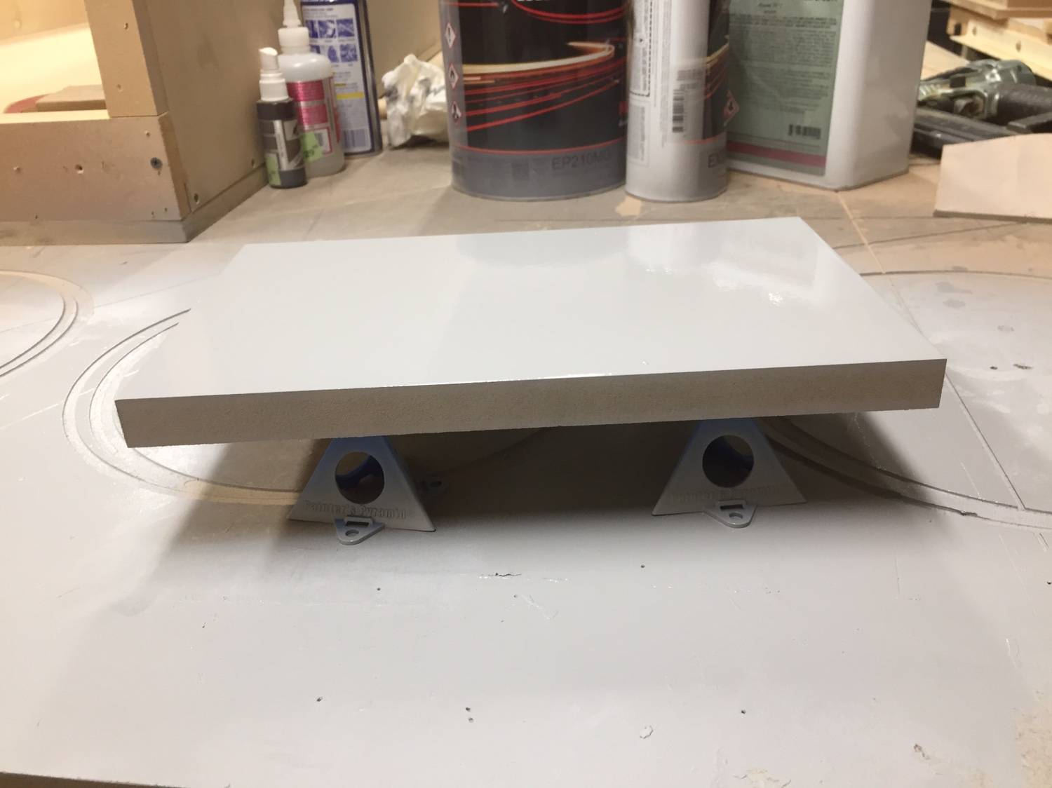

Tested out some of the primer and sealant on a small piece of mdf. Turned out like glass and should be even better with the new gun.

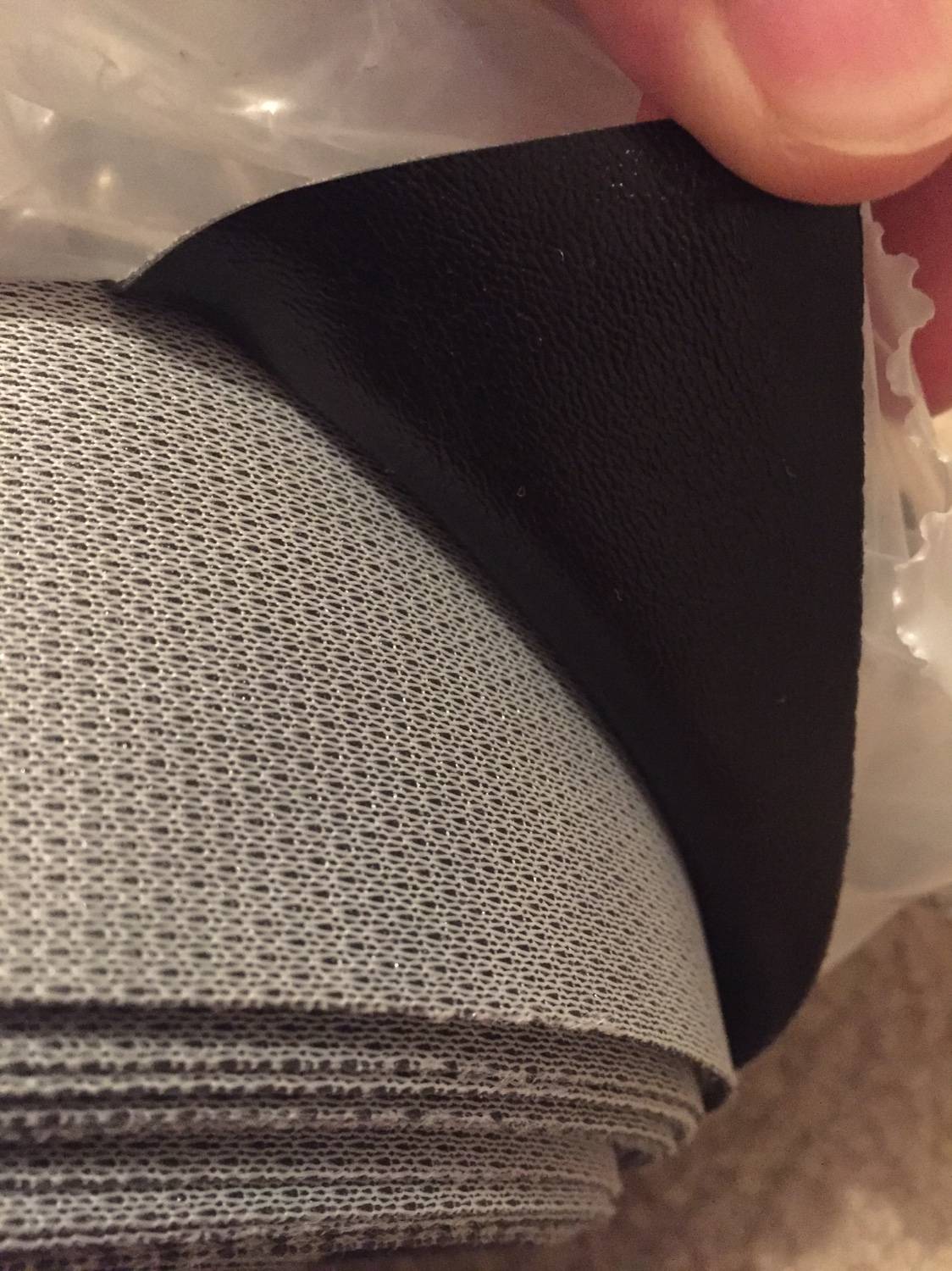

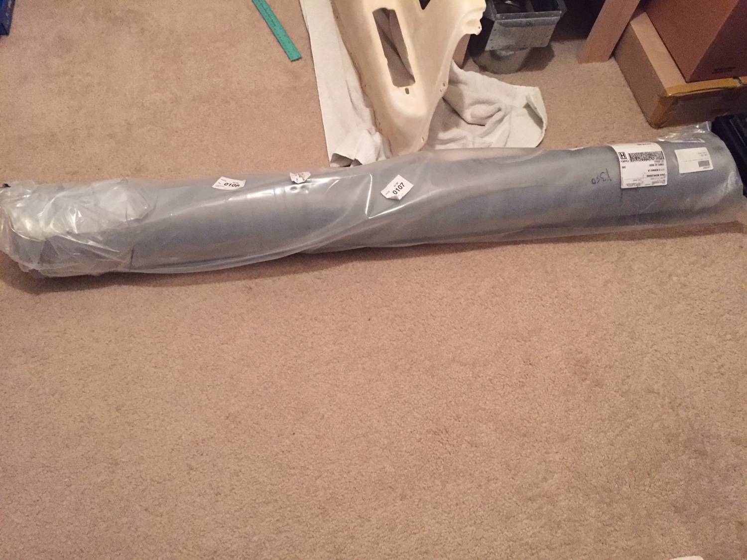

Got 15 yards of black Morbern vinyl for the outside of the box and interior of the truck. Will add some red or gray accents here and there.

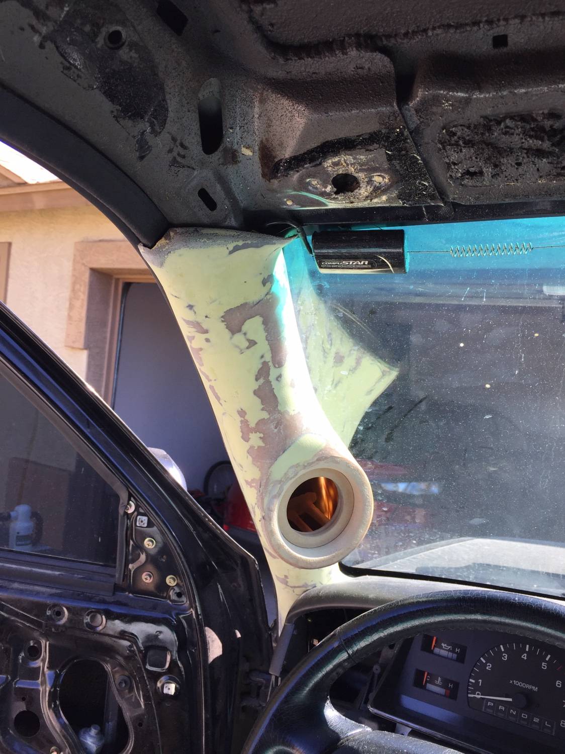

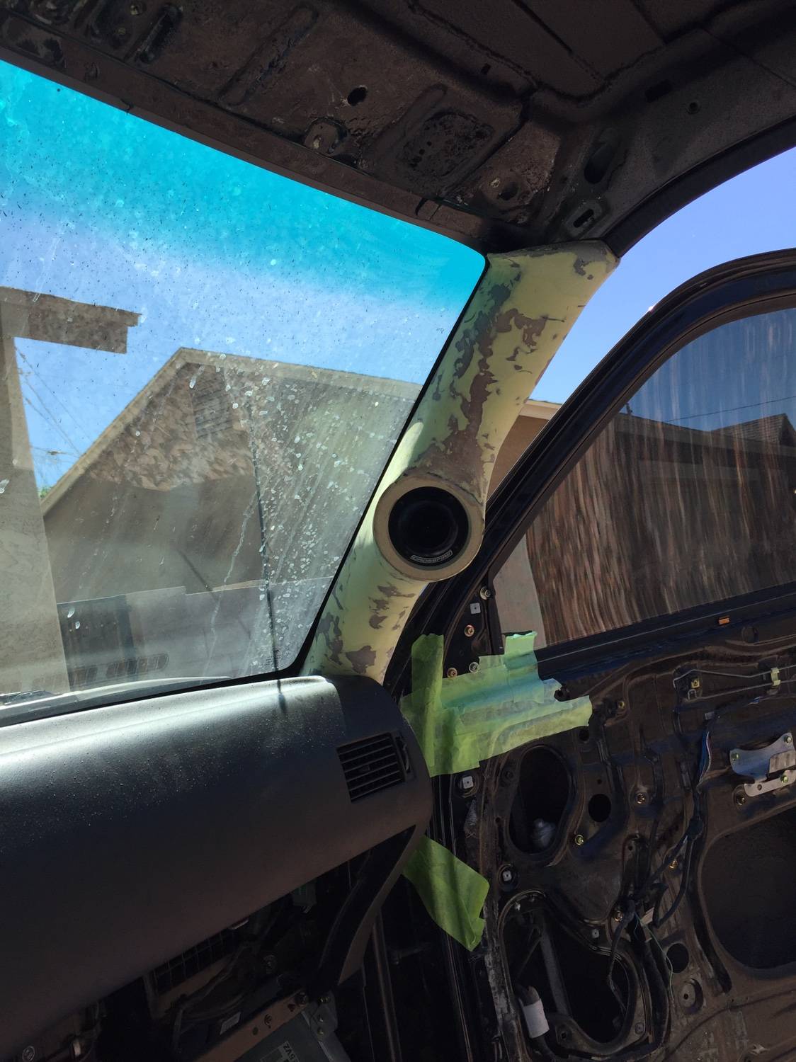

Test fit of the A pillars was a success. A little more sanding with 150 and some minor body work left. Coming along nicely!

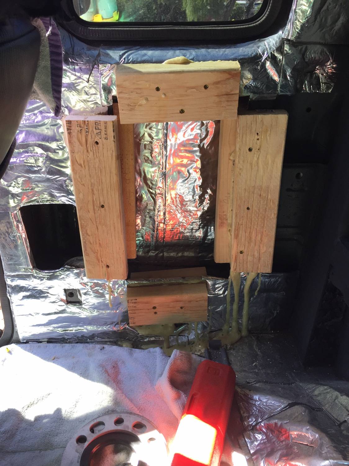

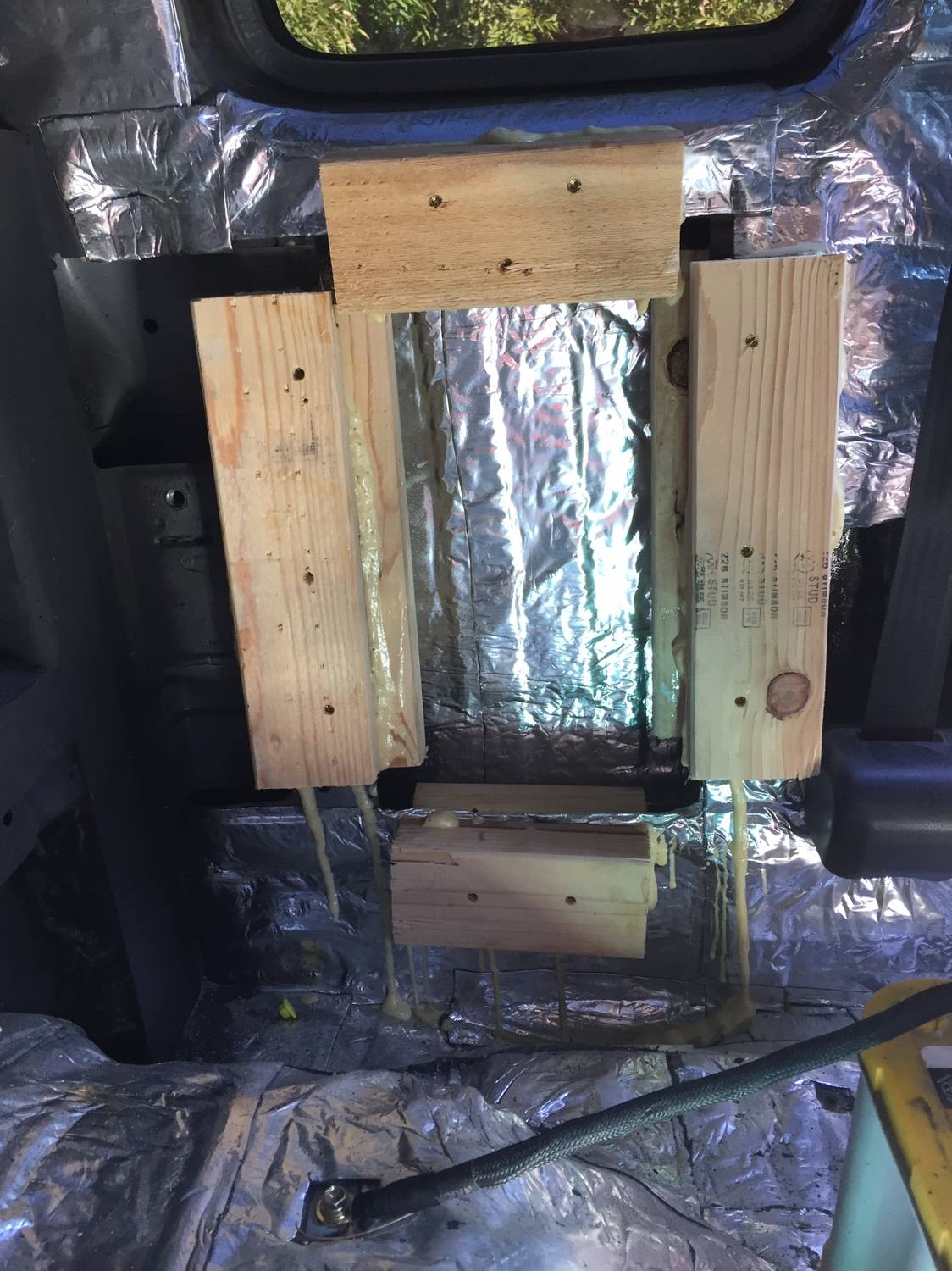

Started on the structural support that the side walls will mount to. These side walls will cover the two rear quarter panel windows as well as hold a 4k amp. Used gorilla glue and GRK fasteners. It's definitely solid.

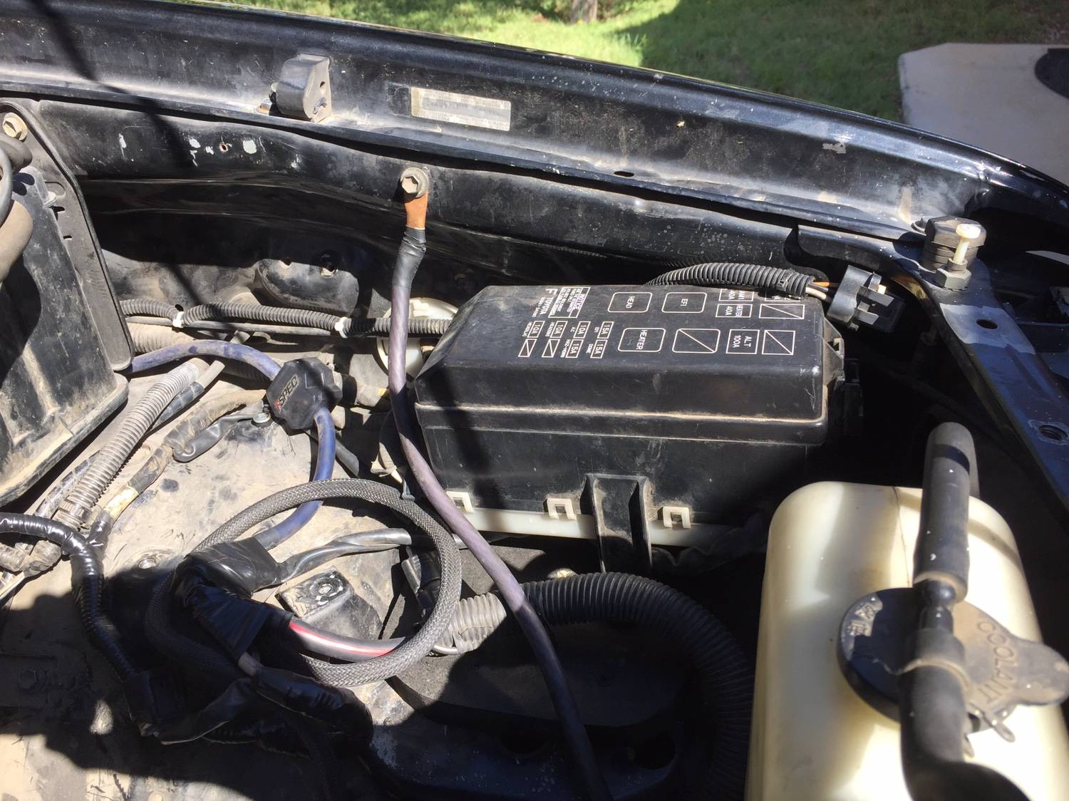

Relocated the stock fuse block so the 3 300a alts can fit.
Original factory location
New location

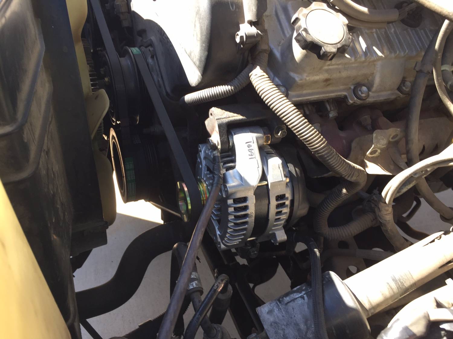

First 300a installed in the stock location. The bracket to hold the other two would have been done by now but we are having to tweak it a little to fit my needs. I wanted to be able to pull off the long triple alt belt and use a shorter belt (the one currently installed) with just one alt for long drives.

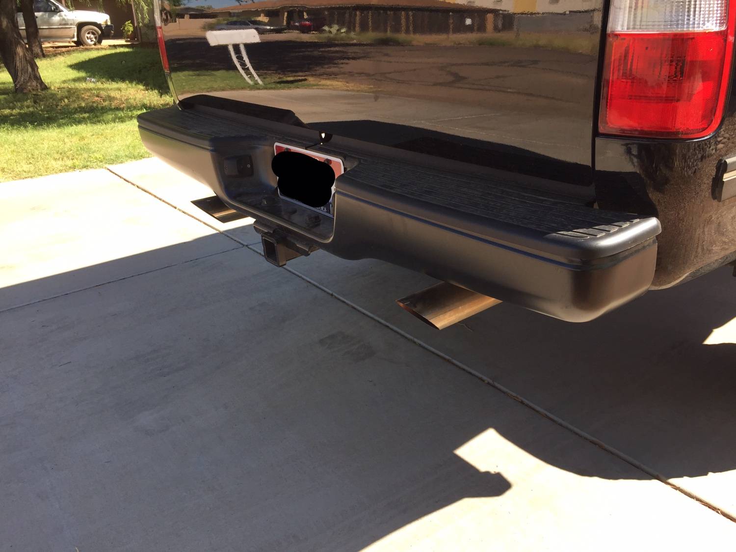

New satin black rear bumper installed. Now the bumper and side steps match. Just need to paint the front bumper and fender flares satin black so everything matches and accents the gloss black truck nicely.

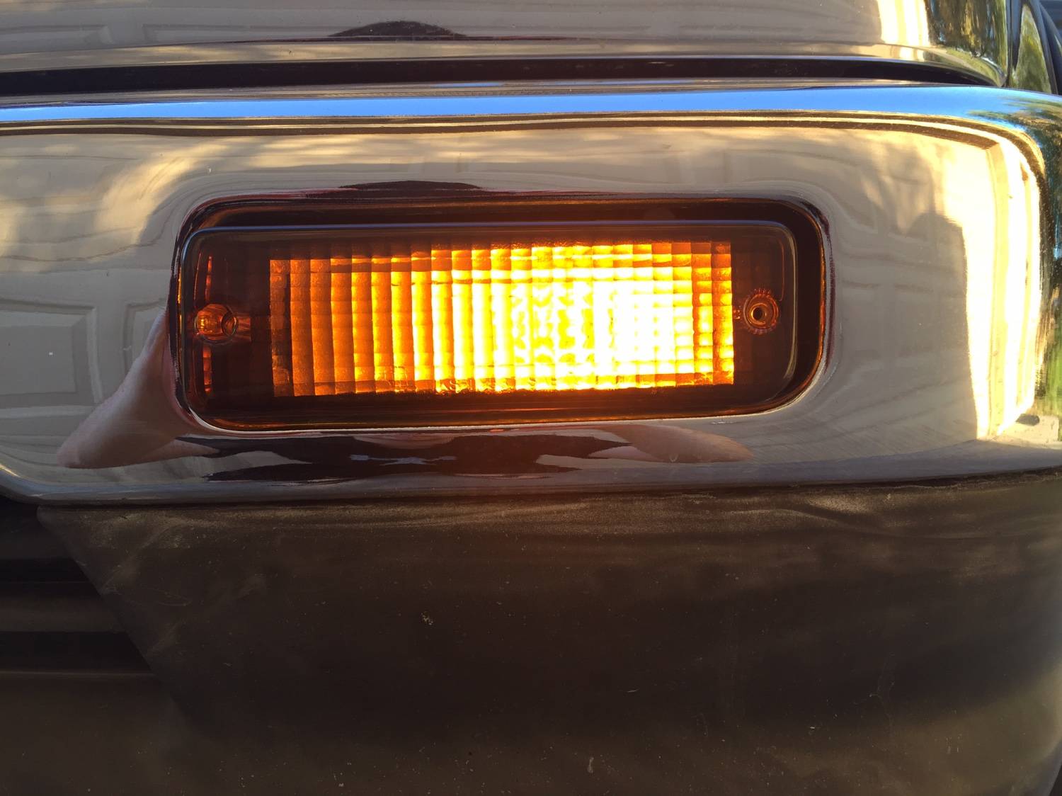

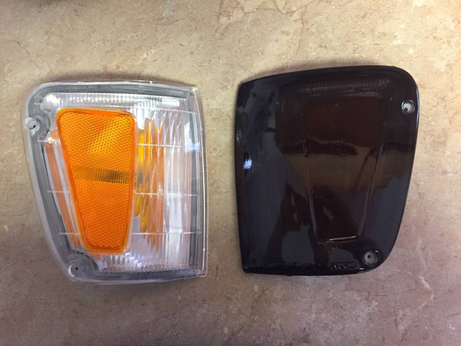

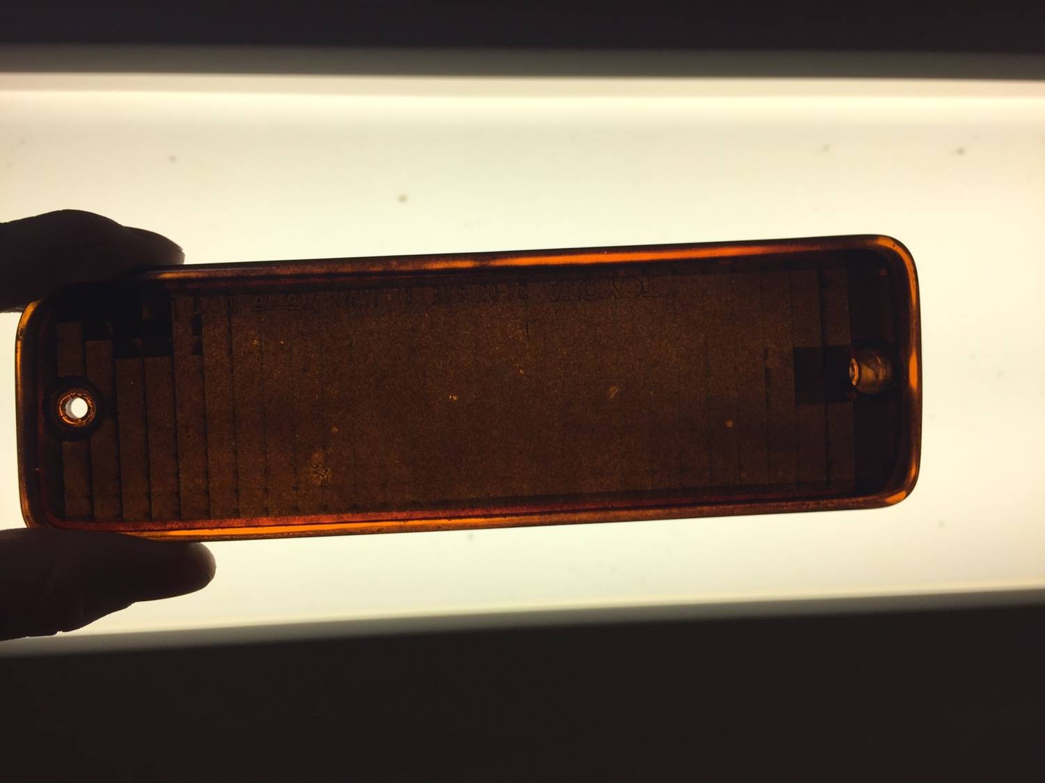

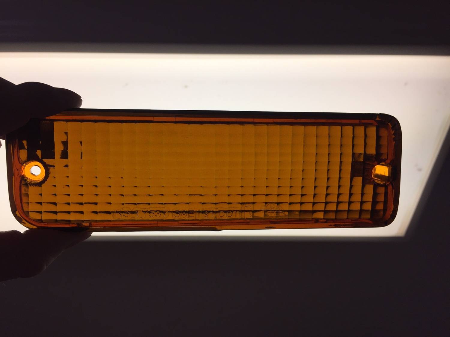

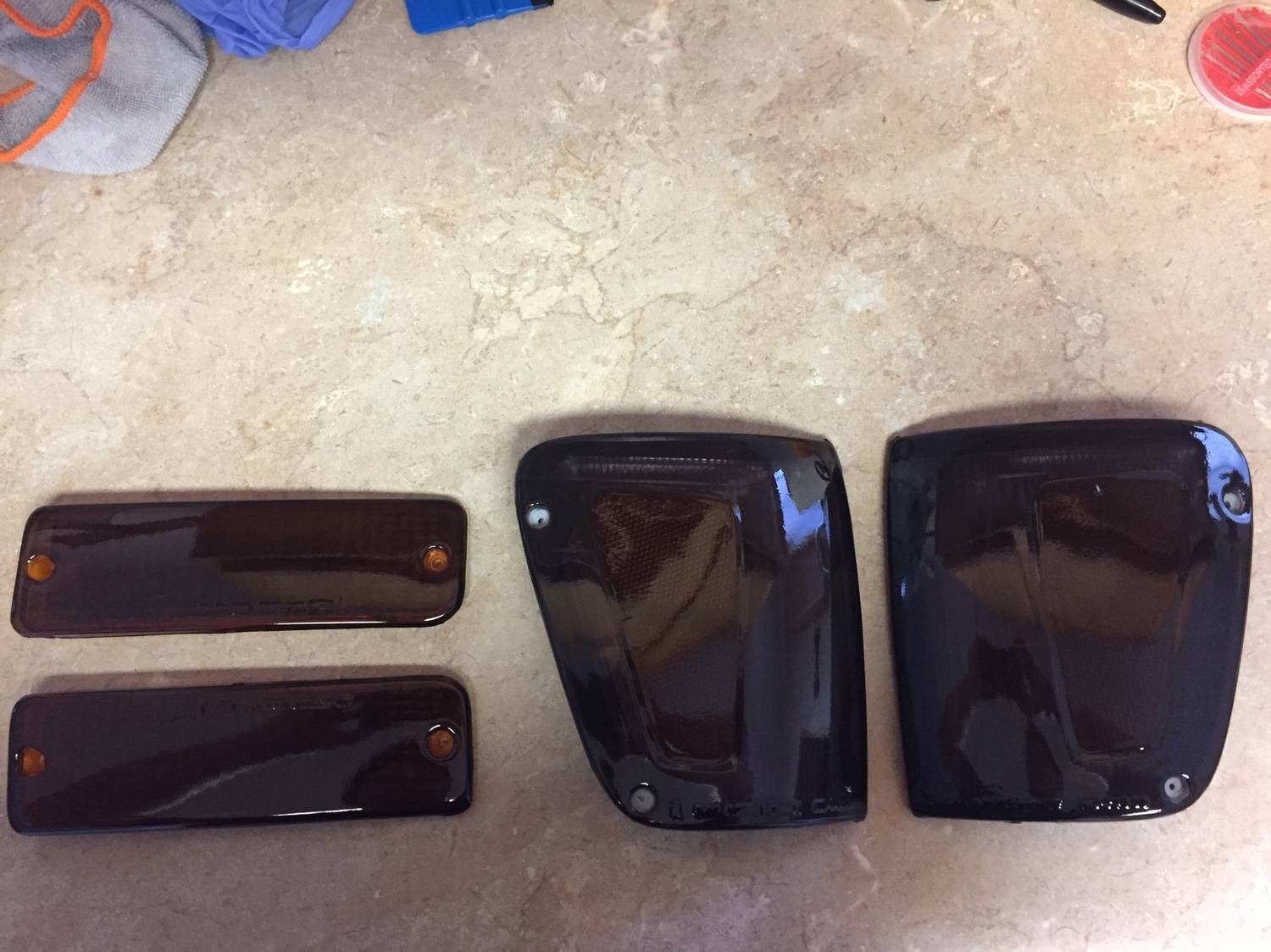

Previously I sprayed all of my lights with VHT Niteshades about 10 years ago. I touched them up a couple months back, but still wasn't too happy with the outcome. I bought all new signal lights and some 20% tint. This was my first time messing with tint film on lights and I'm very happy with the outcome.
Turn signals done with vht niteshades. Very foggy and hazy:
Turn signals done with 20% tint. Much more clear and bright:

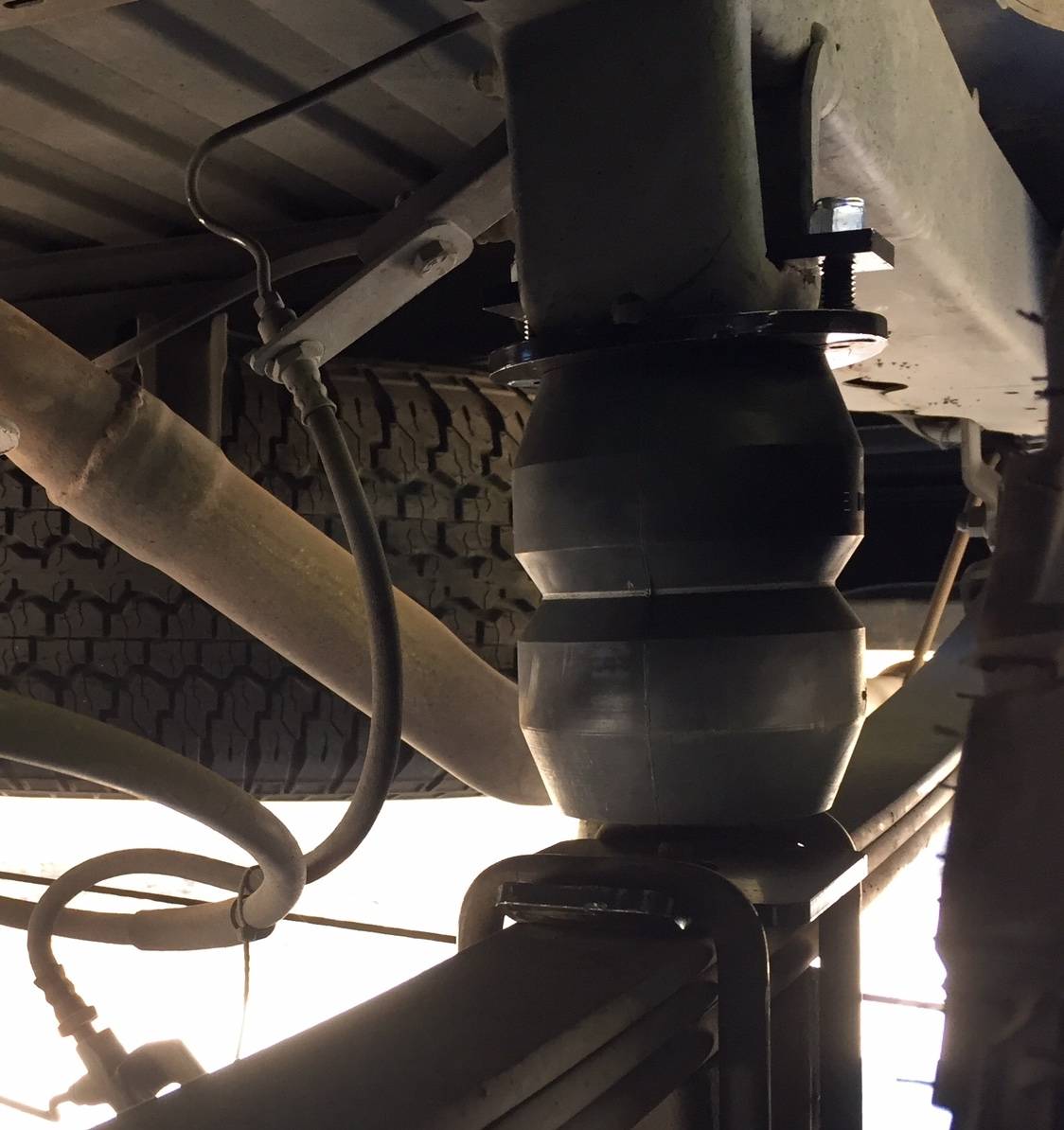

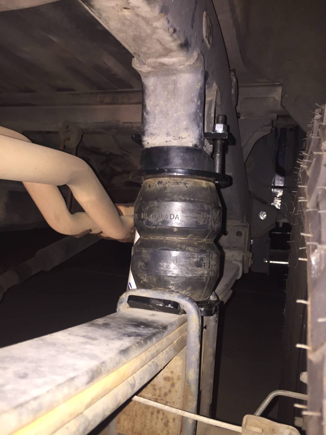

My truck has a 3" lift on it so there was about a 1" gap between the Timbren suspension support spring and the leaf springs. I added a 1" spacer above the Timbren spring. This completely filled in the gap. Now the back end of the truck shouldn't sag hardly at all when the box is loaded up.
Gap before:
No gap after:

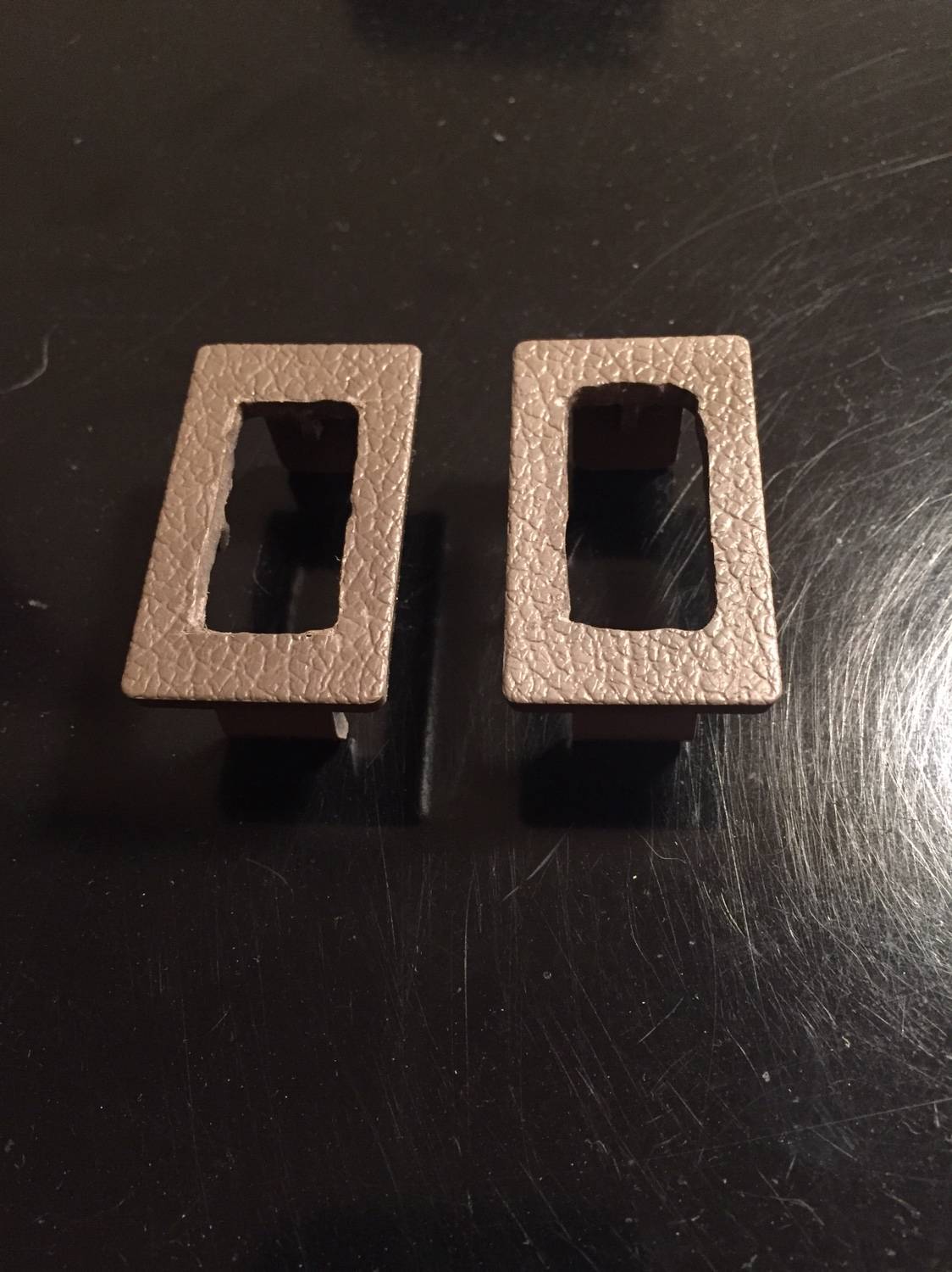

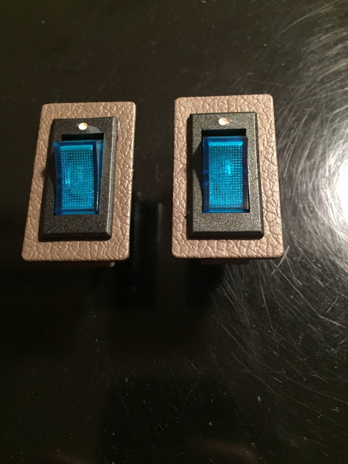

Cut out a section of the dashboard switch delete pieces. Two led toggle switches fit nicely now. One for the volt meters and one for the white led lights in the cup holders. The cutout pieces will be painted black.

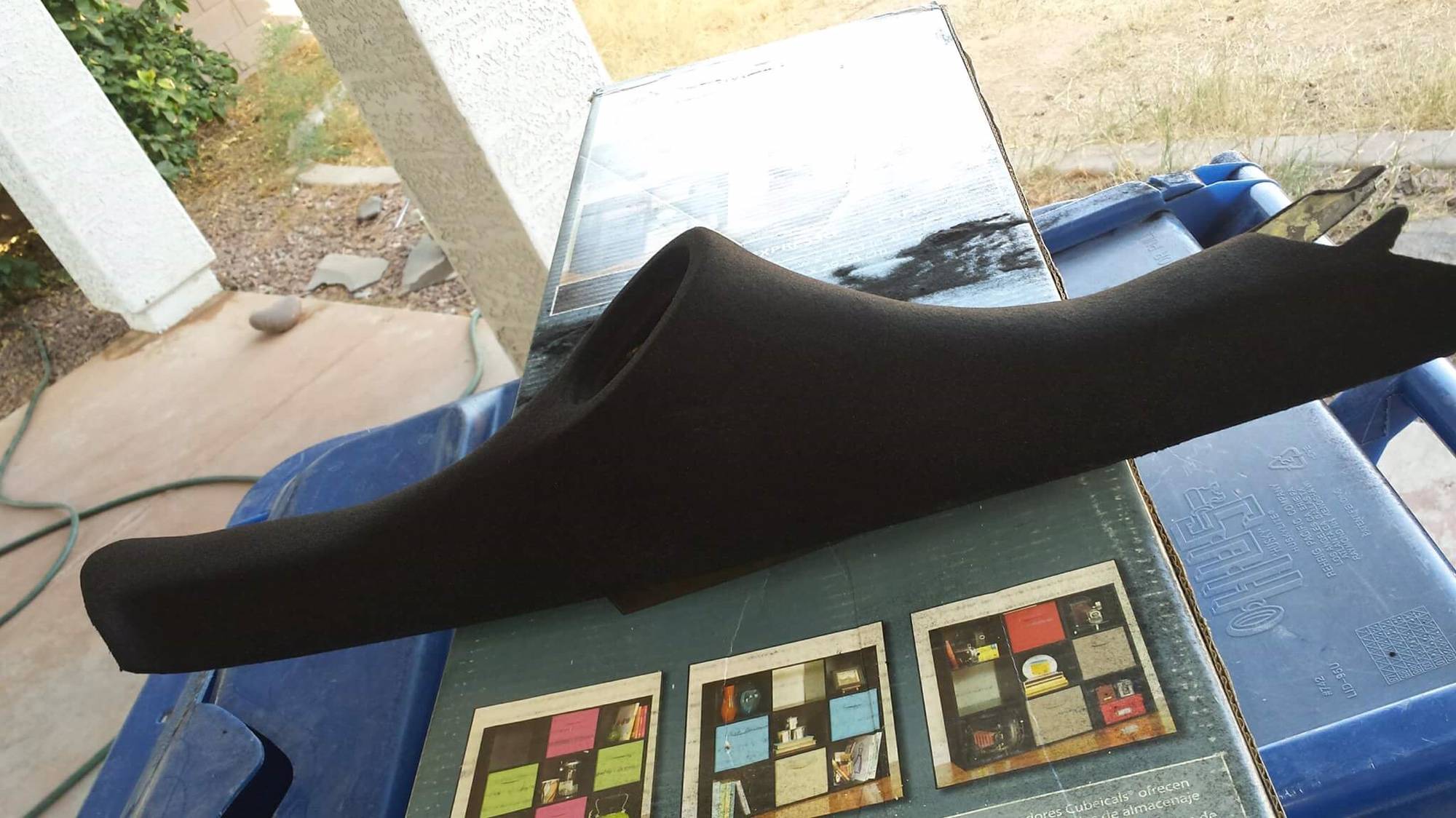

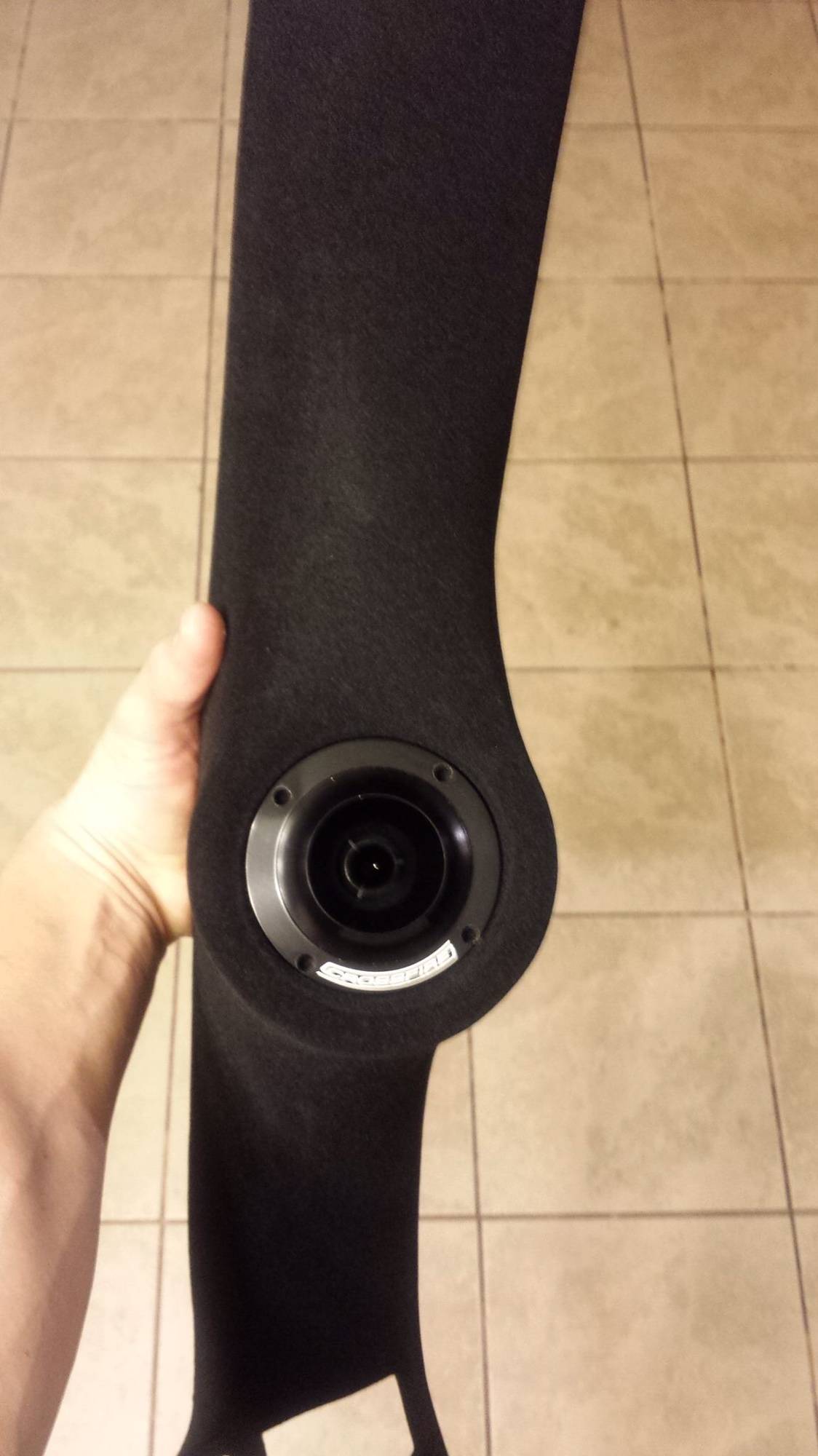

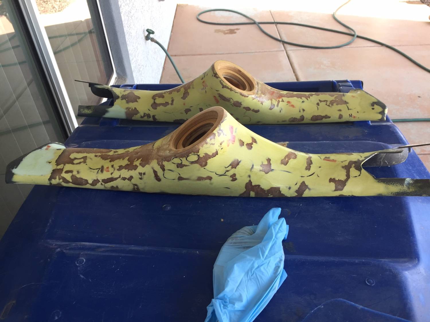

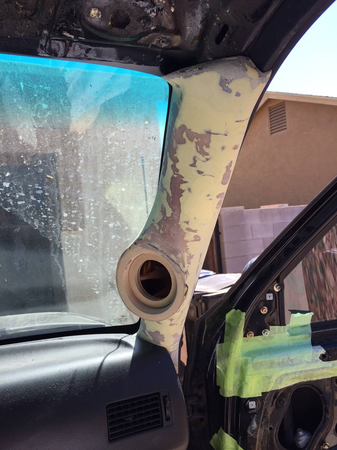

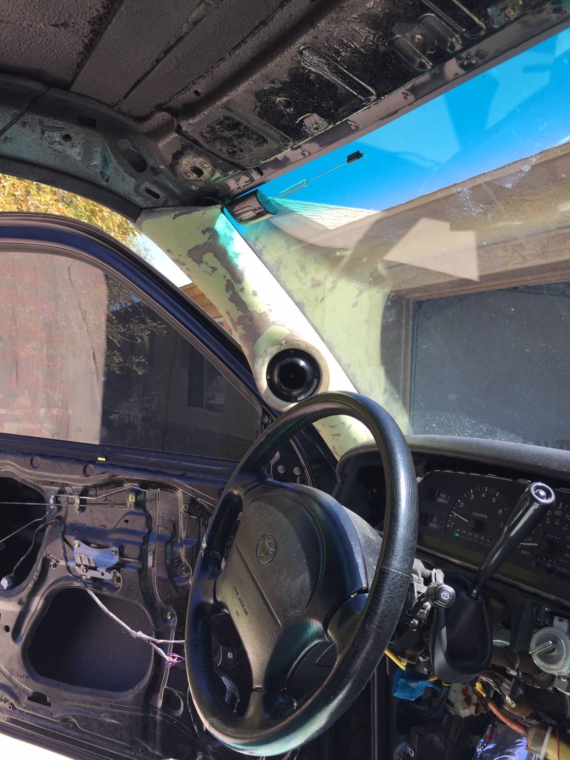

Finished sanding and filling the A pillars. We decided to use some black flock to cover them. Feels like suede. Turned out very nice!

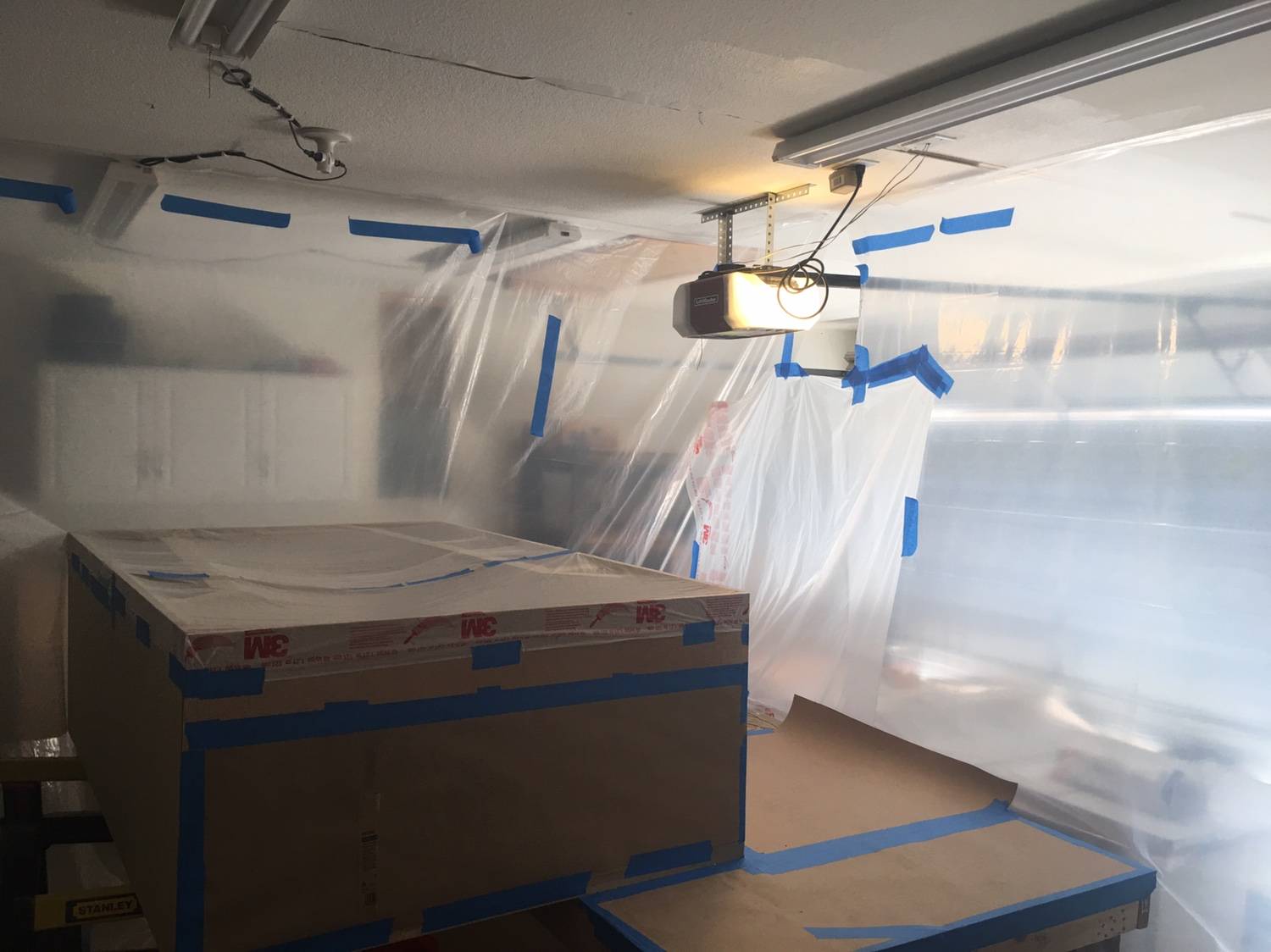

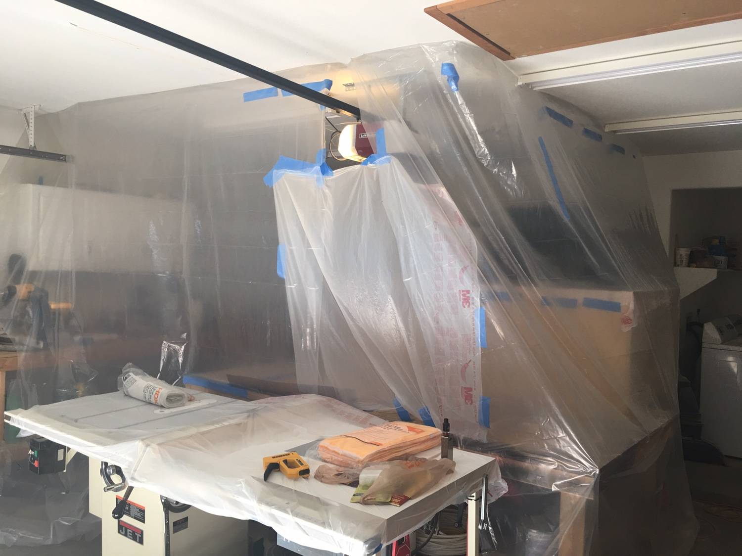

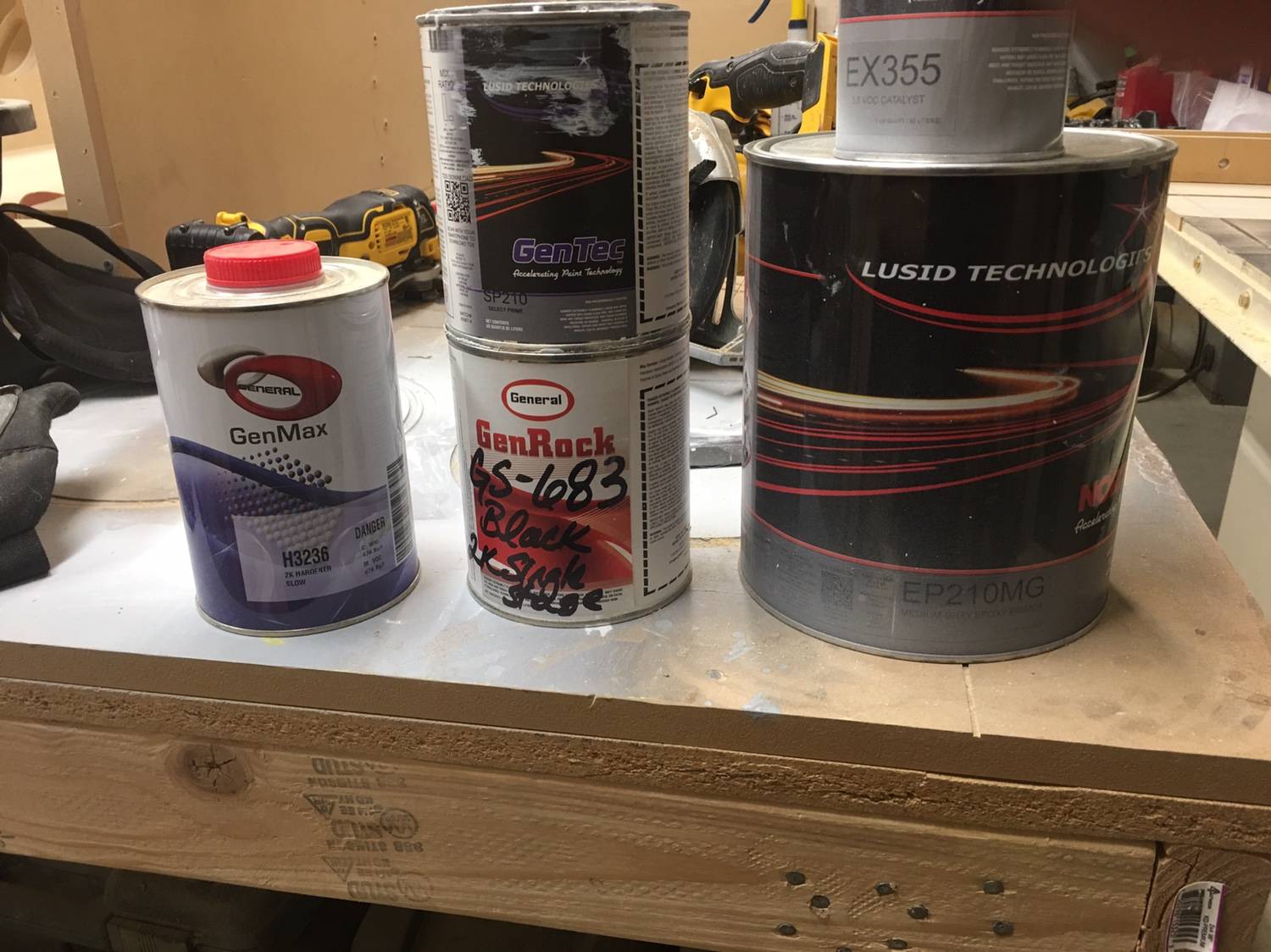

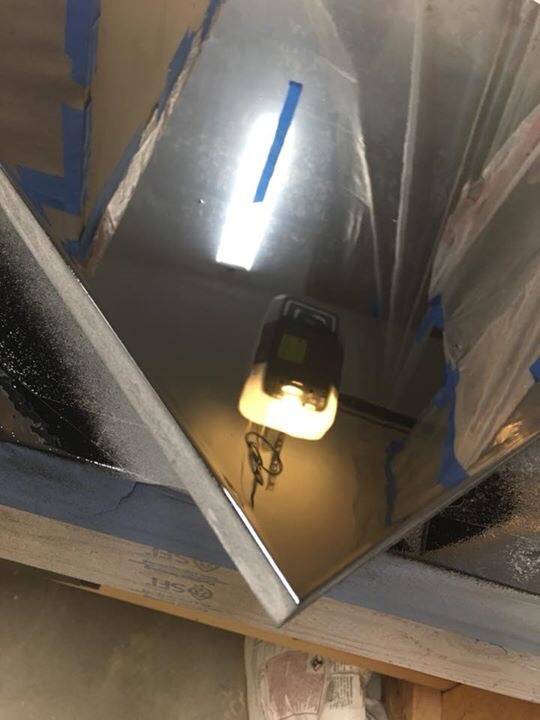

Got some paint supplies. Set up a temp paint booth at my buddies to spray the bracing and inside of the box.
My buddy tested spraying some epoxy primer, urethane primer, and black base. Turned out nice!

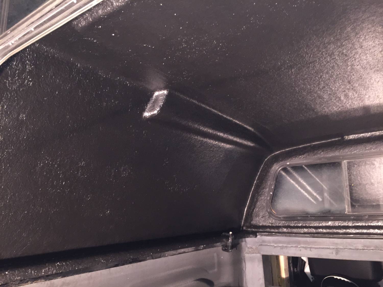

Got a second coat of flat black on the inside of my camper shell. It's all good to go now.

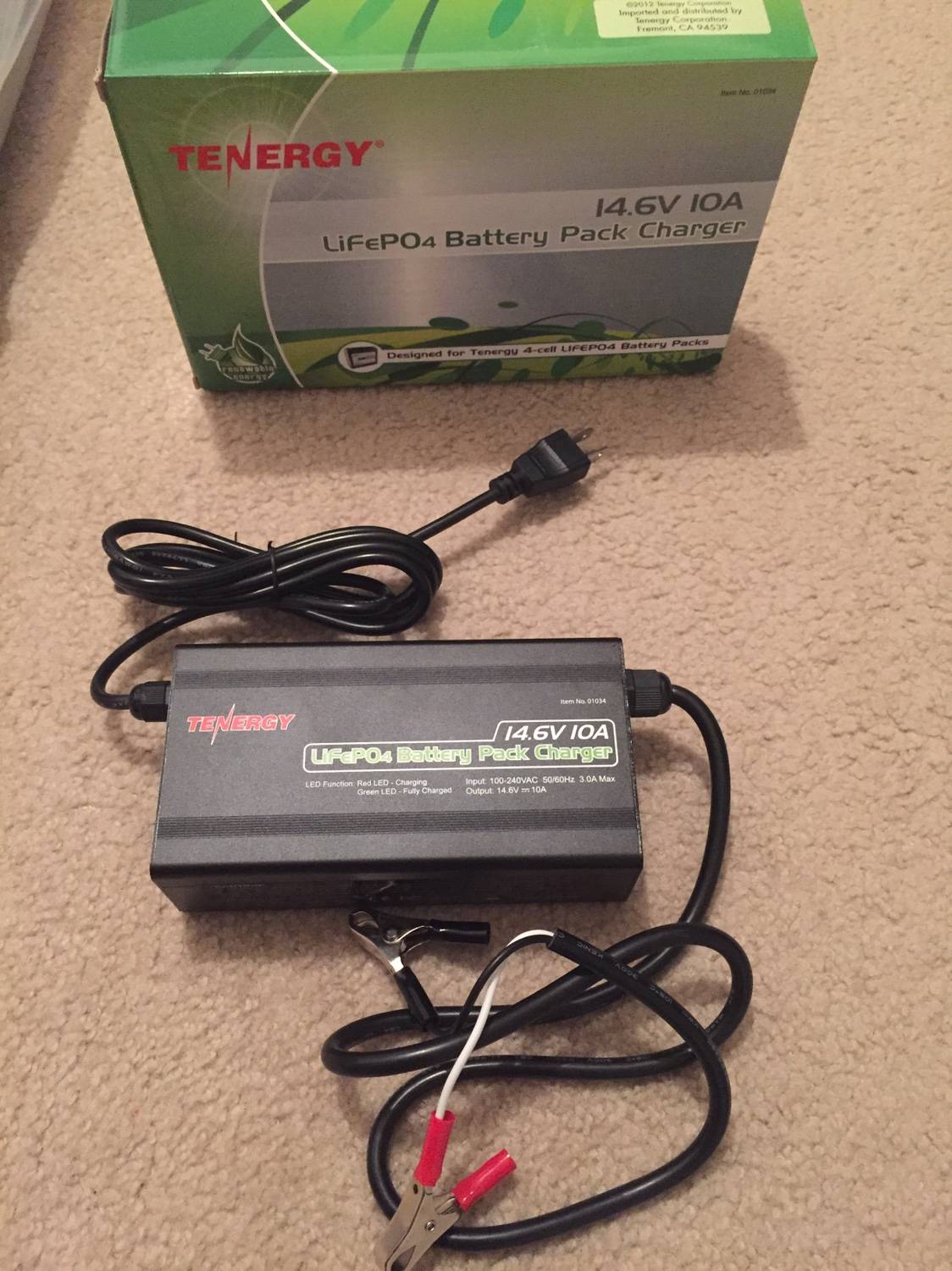

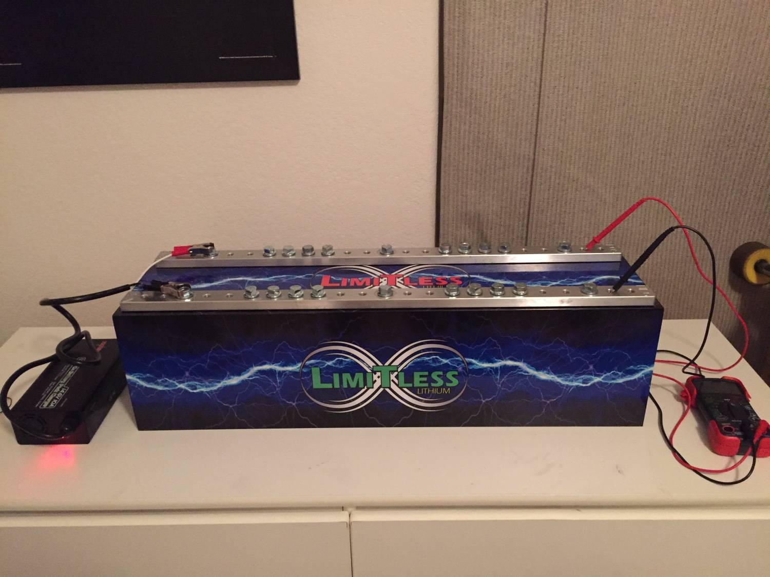

Got my 10a Tenergy Lithium battery charger. And my 80ah Limitless Lithium battery //content.invisioncic.com/y282845/emoticons/smile.gif.1ebc41e1811405b213edfc4622c41e27.gif

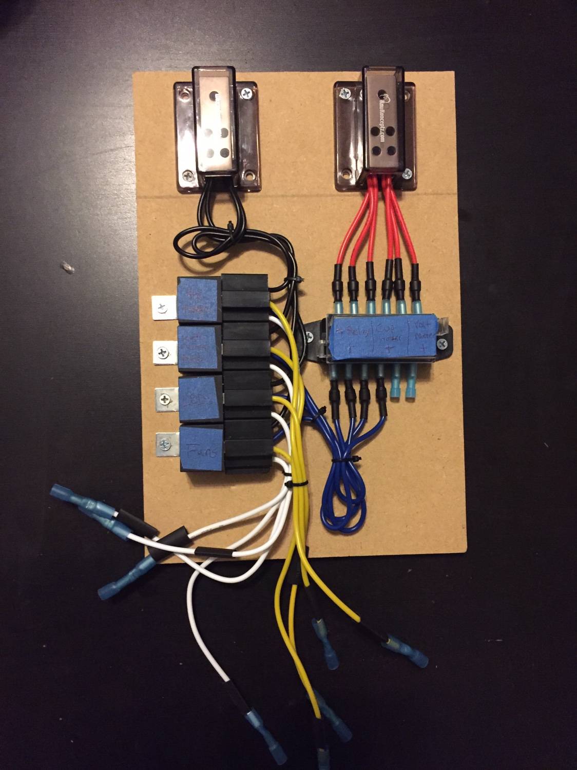

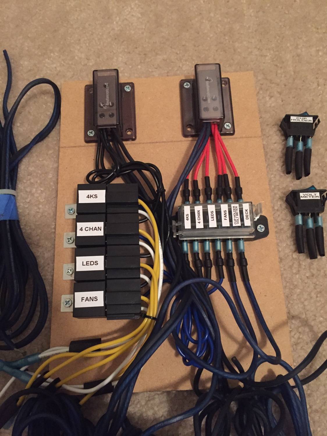

Started wiring up the accessories fuse block and relays. This will go inside the center console. It will power the rgb controller for the 4 rolls of leds, the fans for the amps, remote turn on for the 4k amps and multichannel amps, volt meters, and leds for the cup holders. Even though it won't be visible, I still wanted to make it clean and organized. Zip ties, crimps, and heat shrink

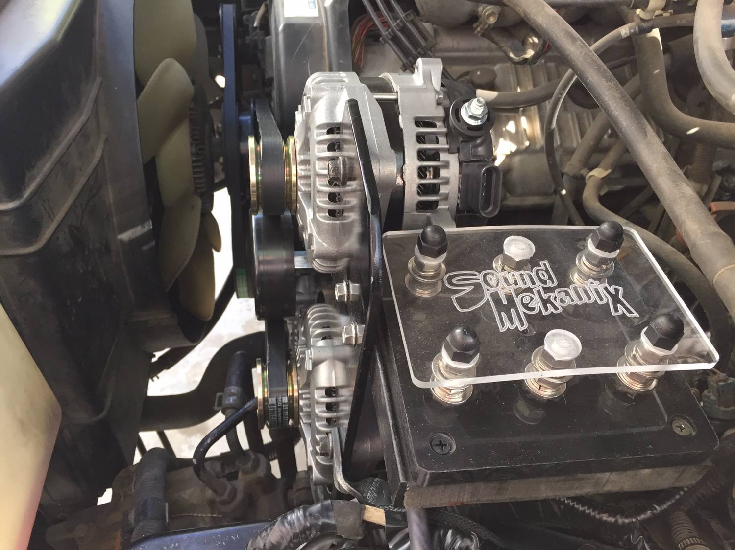

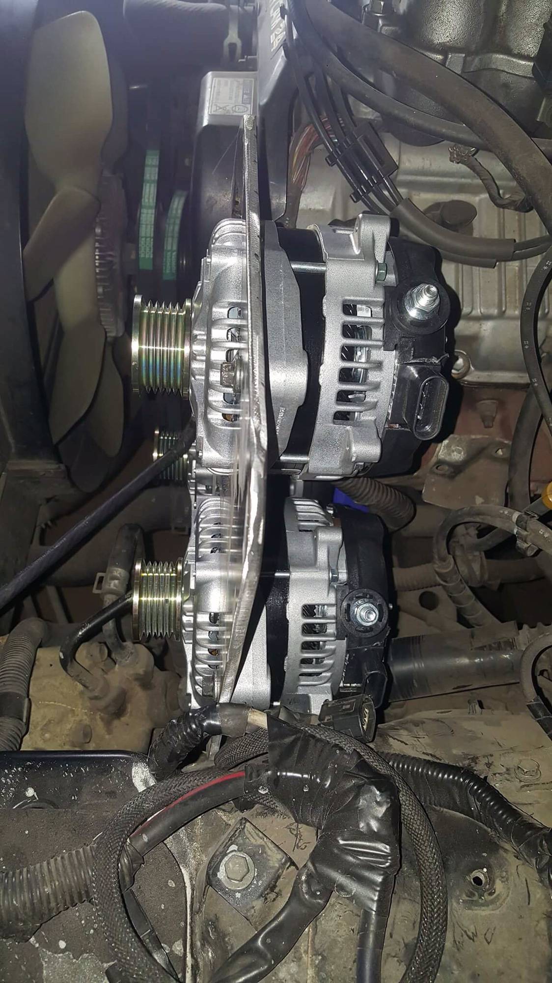

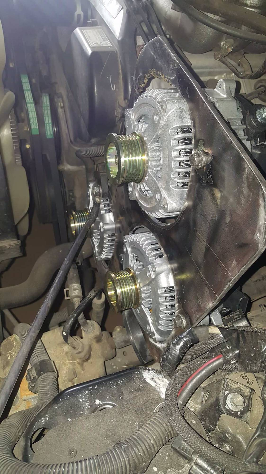

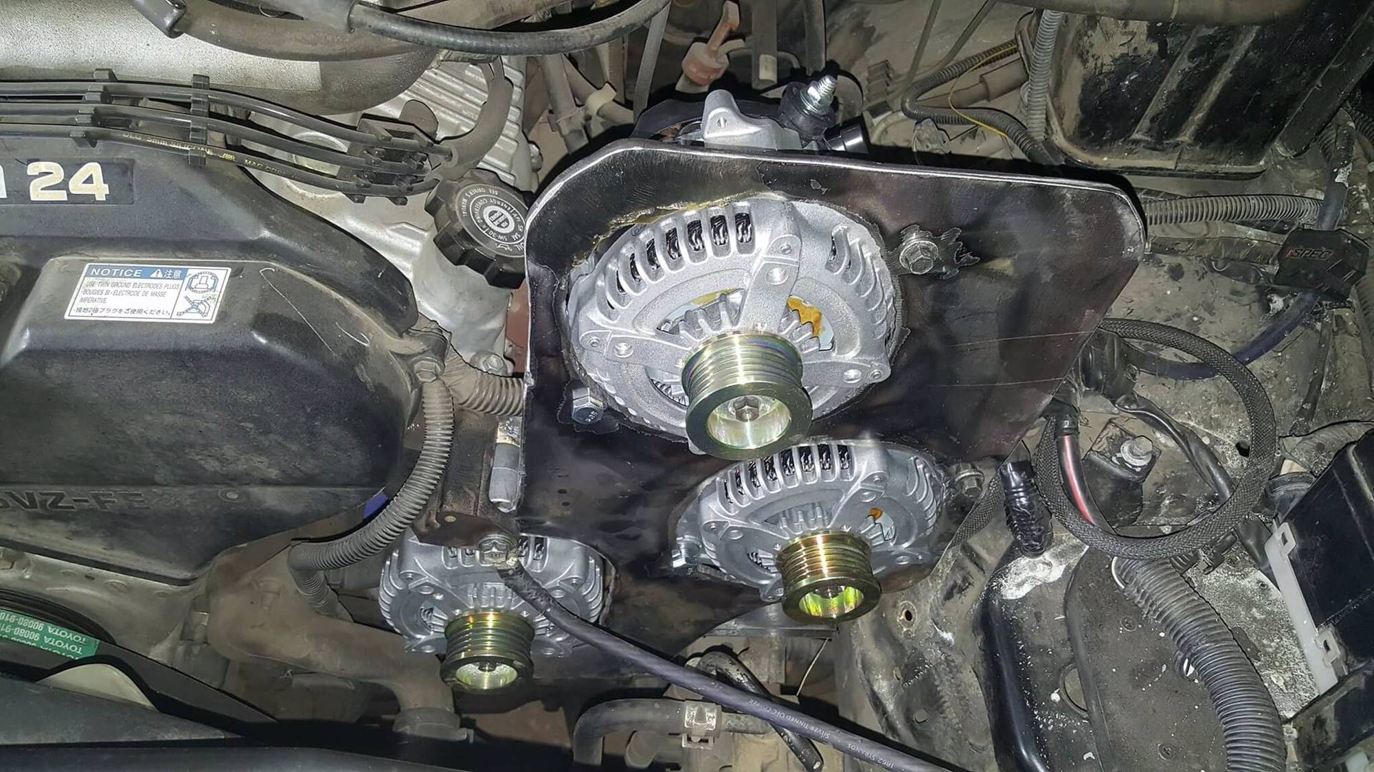

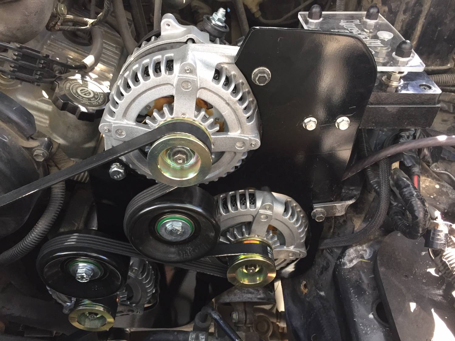

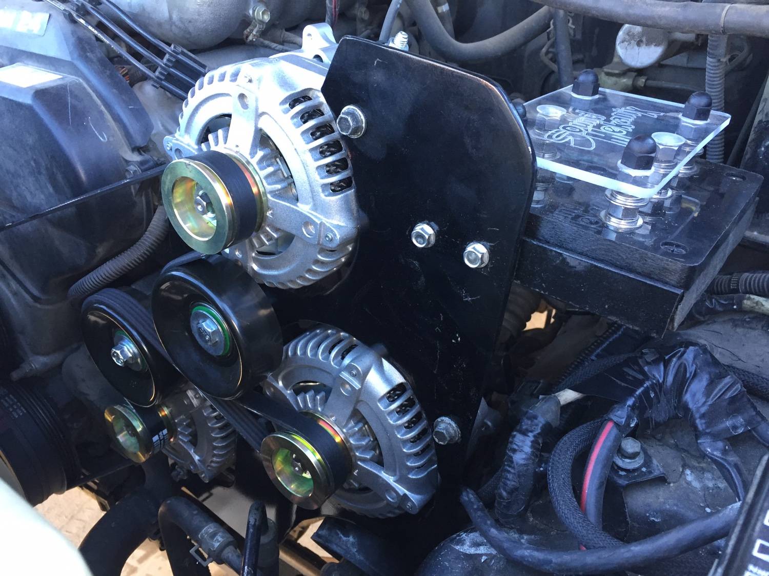

Triple alternator bracket is finally coming along! 1/2" thick so it's pretty solid as is. We need to fill in some gaps, make an L bracket for bracing halfway up on the backside of the bracket, add a second tensioner (we are utilizing the stock tensioner as well) and some idler pulleys.
nice work on the bracket!
Thanks man! I'm happy with it. We might have to do a couple little tweaks here and there but this is pretty much the final product.
Labeled the relays and fuse block for the center console power system.

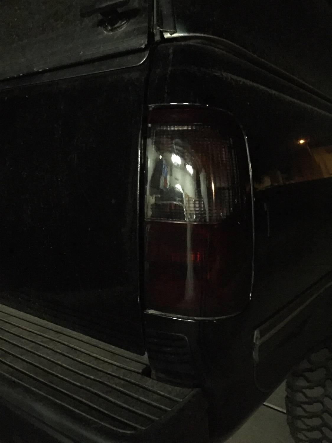

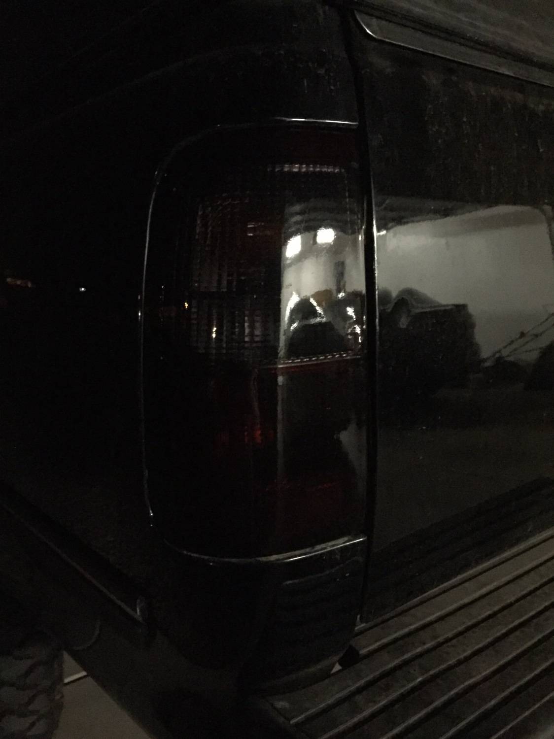

Tinted my tail lights. Going to be adding a 3rd brake light below the tailgate in the next couple of days.
Looking good man. Nice and organized, I like it!
Thanks man! Makes installing and fixing issues so much easier //content.invisioncic.com/y282845/emoticons/smile.gif.1ebc41e1811405b213edfc4622c41e27.gif

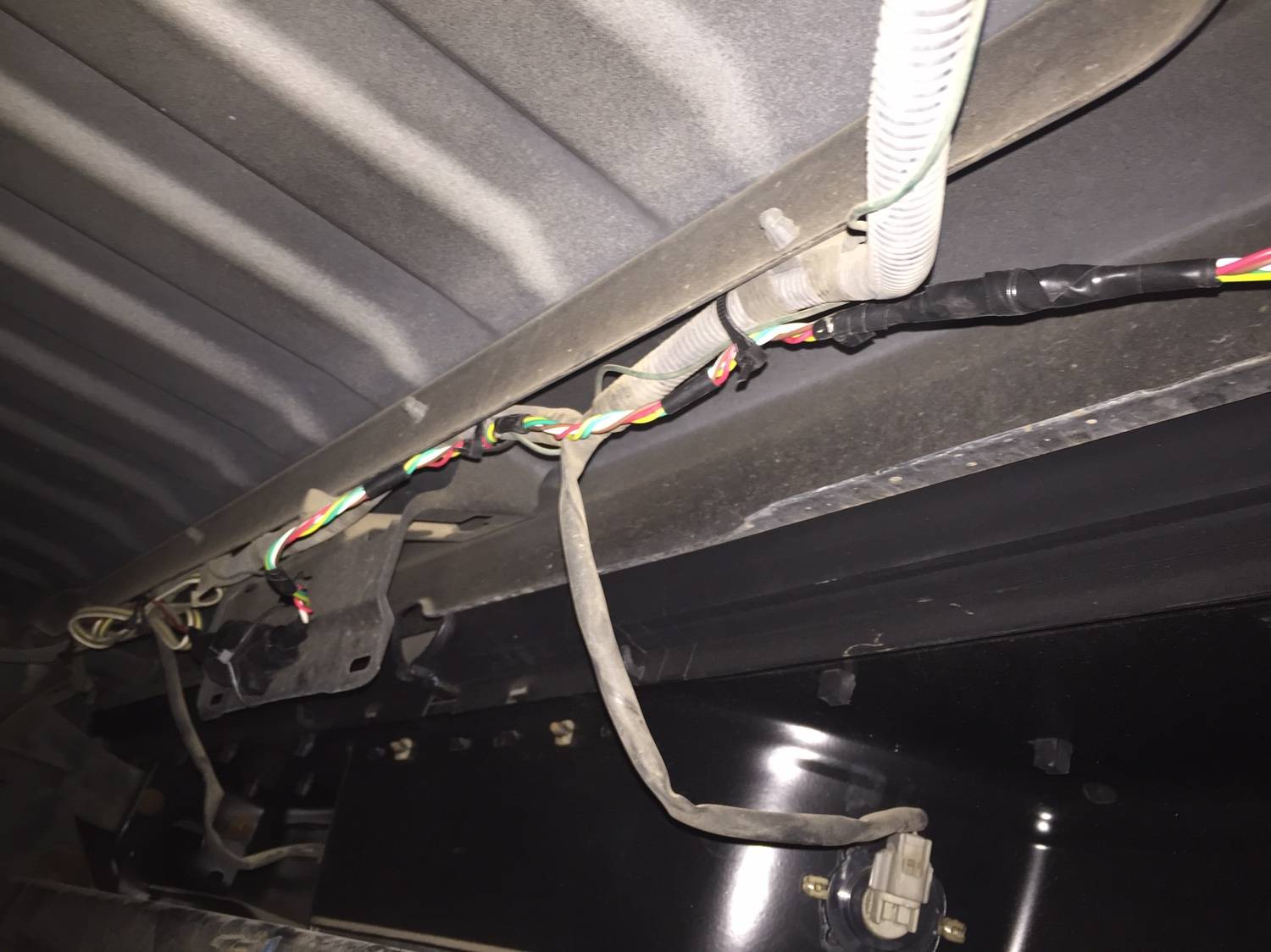

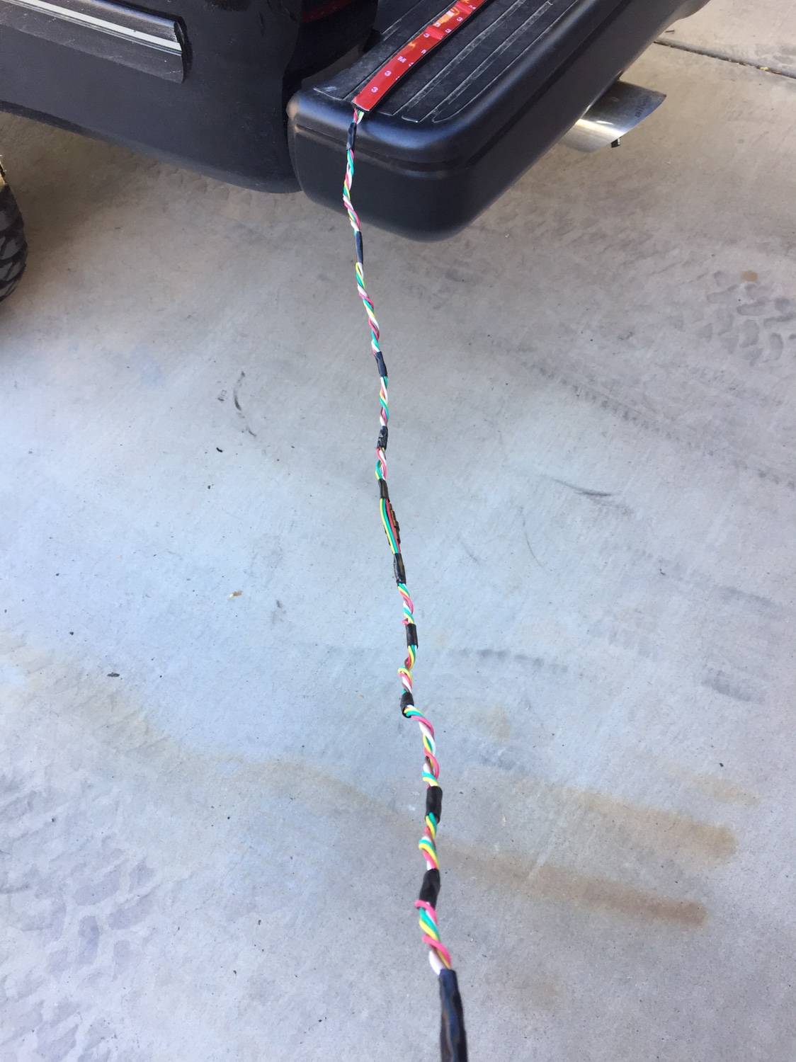

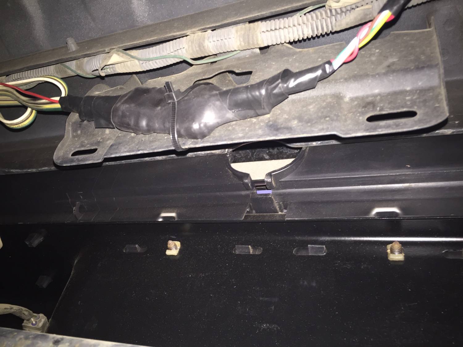

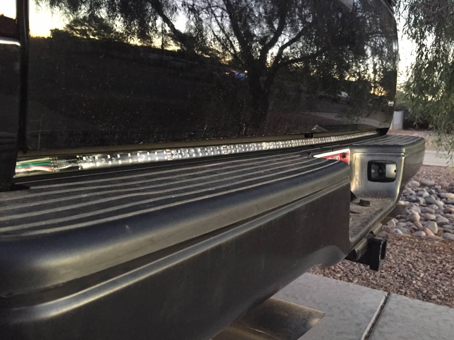

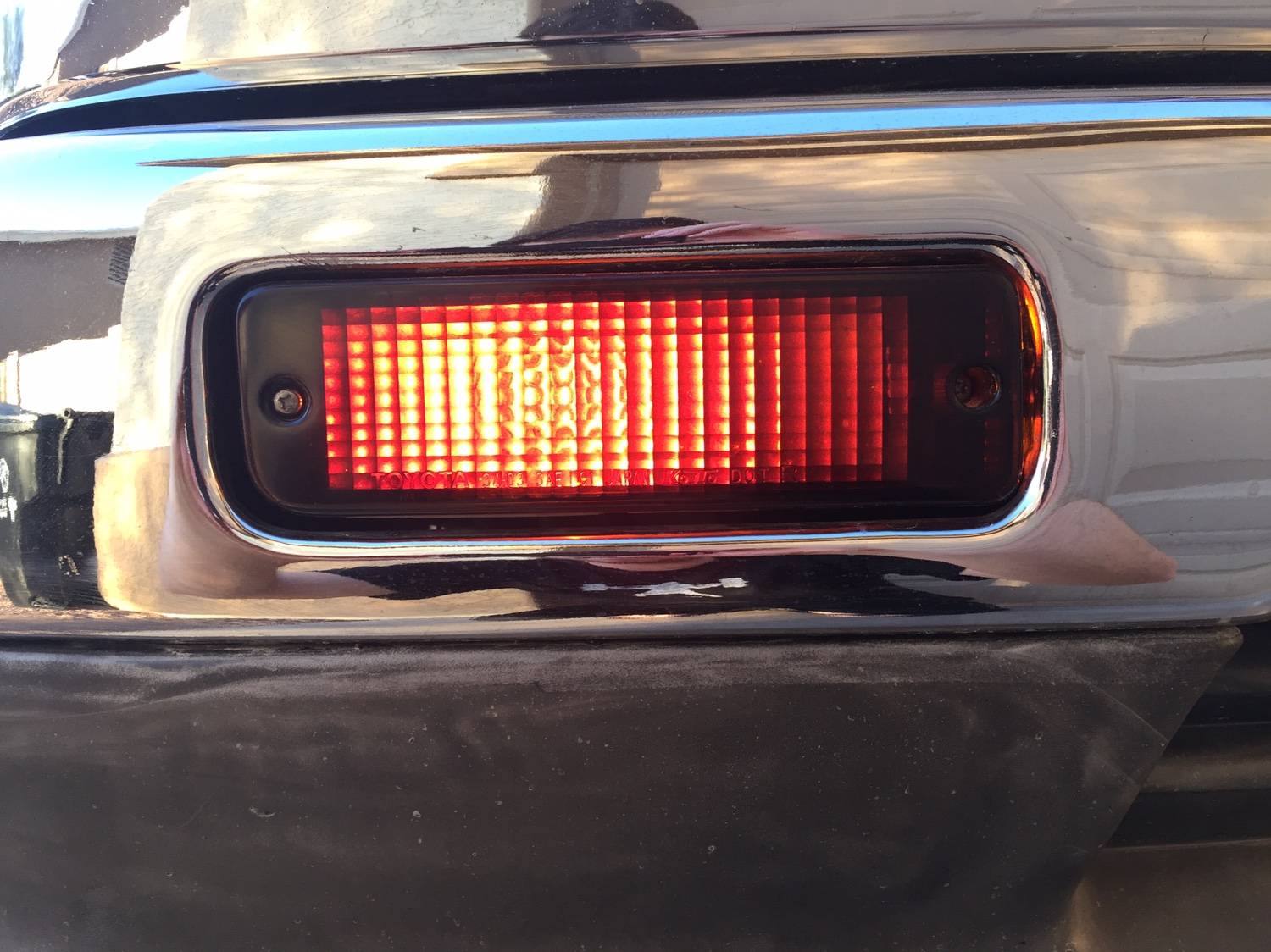

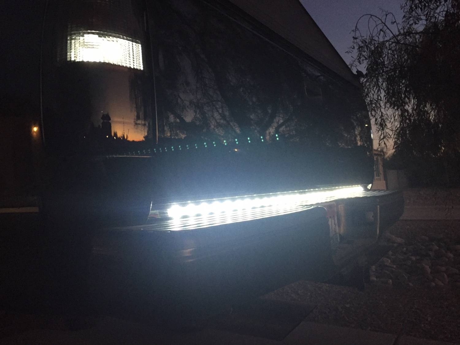

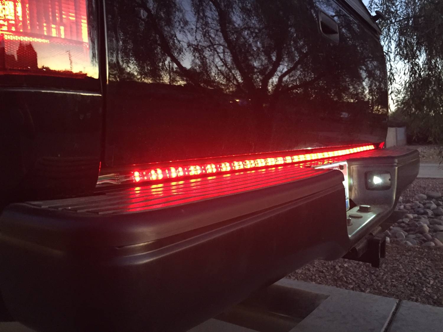

Installed a led tailgate brake light the other day. Got the wiring all cleaned up and ran. My truck was already wired up with a trailer plug so I just utilized that and also tapped into the reverse light.
Off
Brake
Reverse

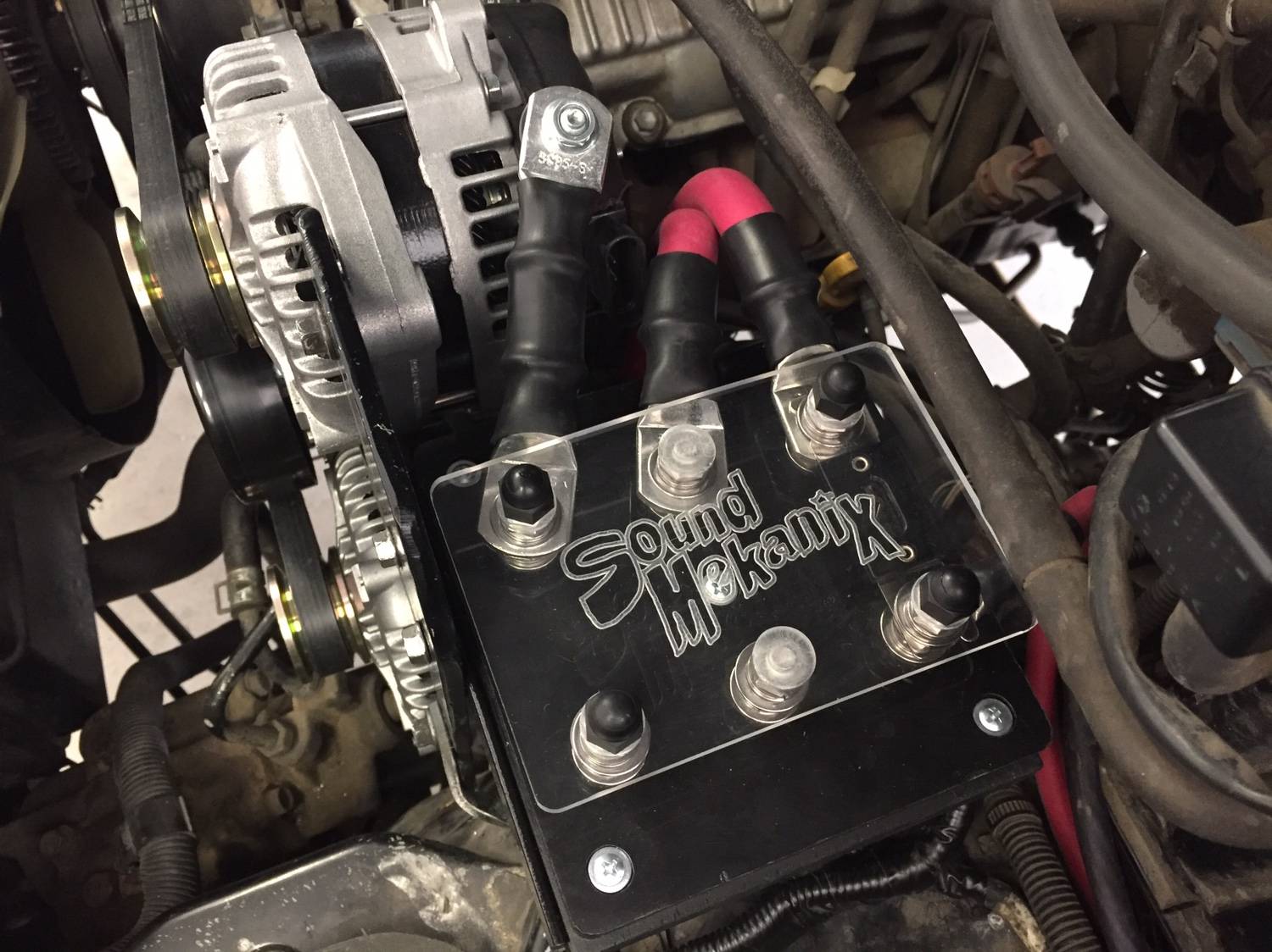

More electrical work done today. All three alt positives are wired up. Cut my alt grounds to size. Just need to drill through the frame now.
That 4/0 though!

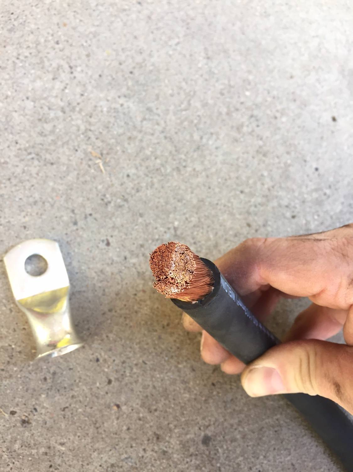

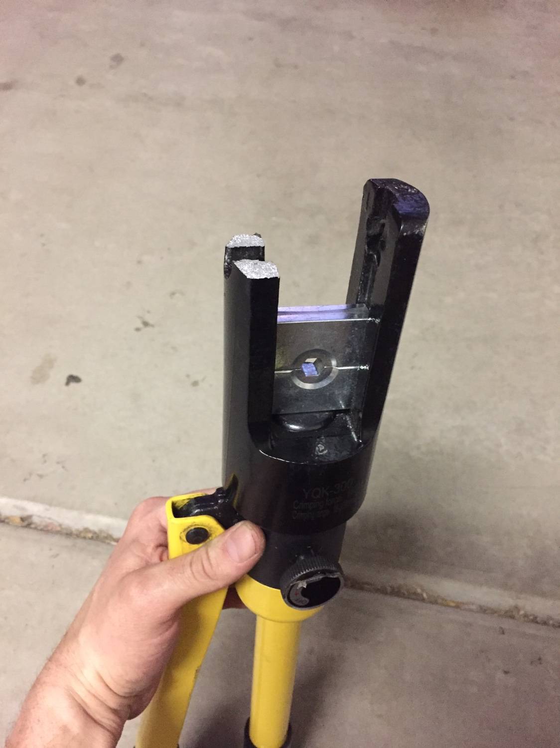

Broke my hydraulic crimper though so all other wiring has come to a stop. It broke when doing a 4 gauge lug too. Lame! At least I got over 100 uses out of it between myself and friends. A new one is on its way though!

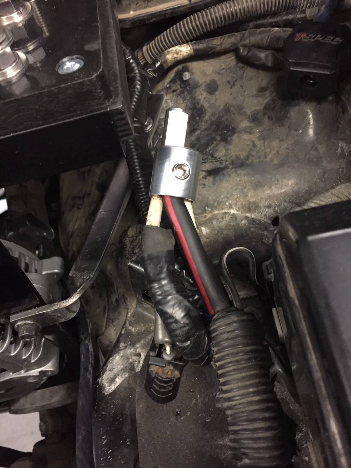

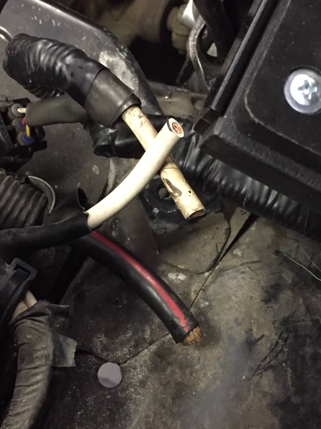

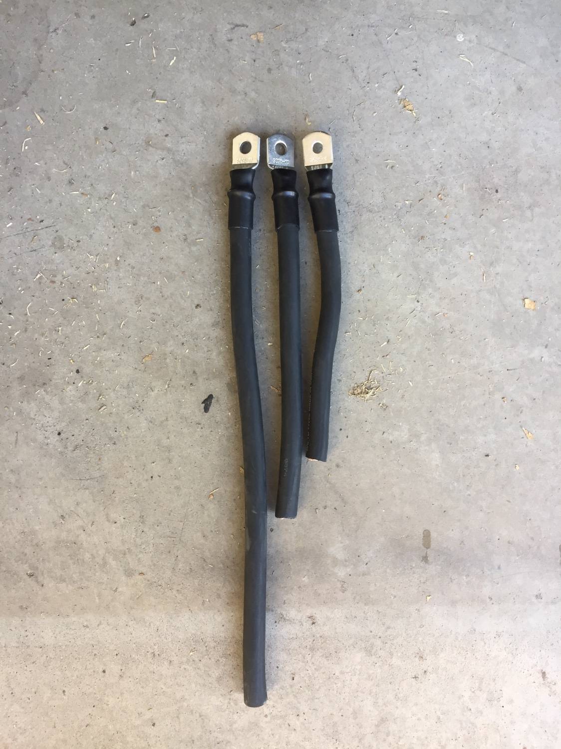

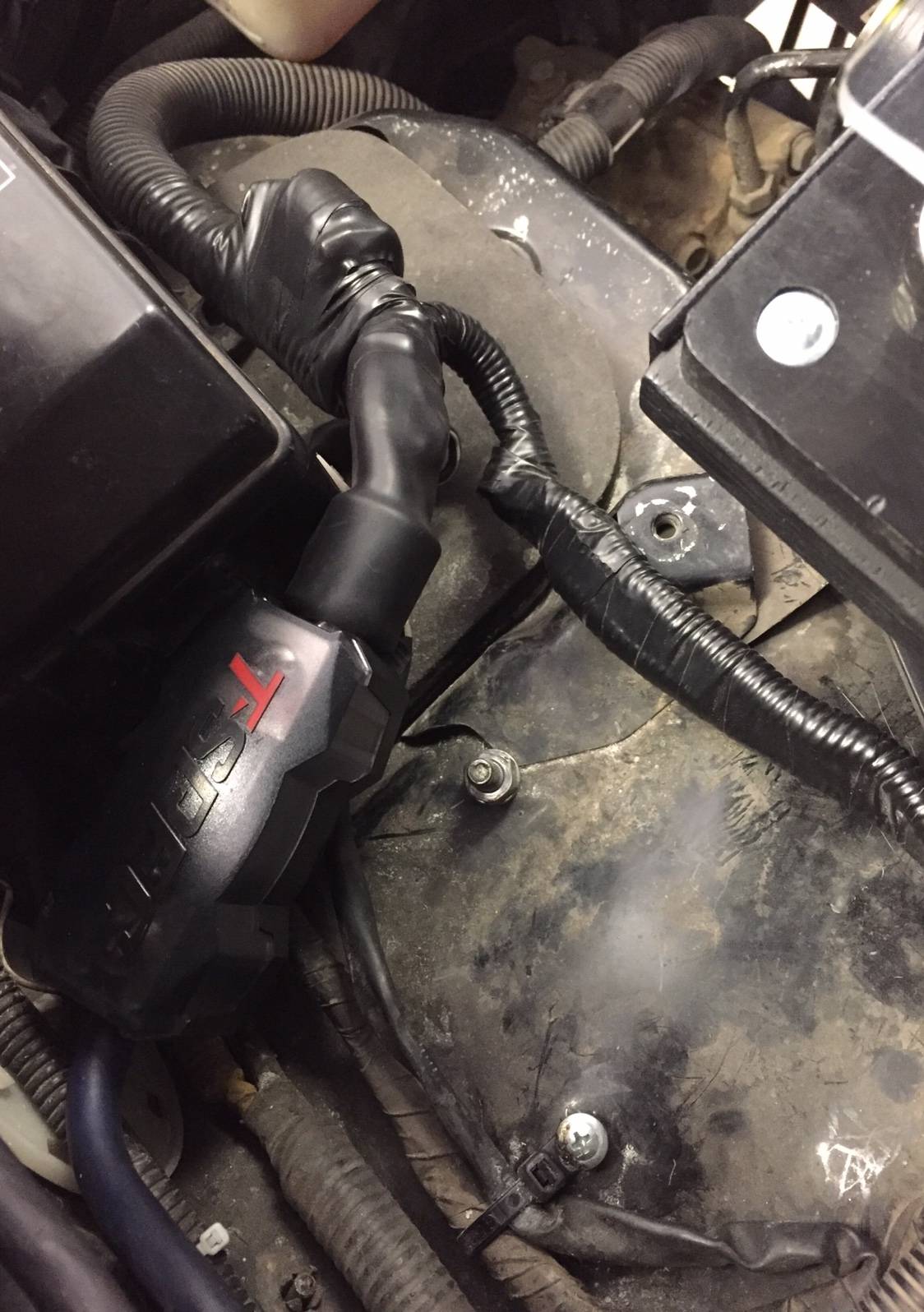

Cleaned up my factory wiring. Put all three wires into a 4/0 to 1/0 reducer.
Looks much cleaner now!

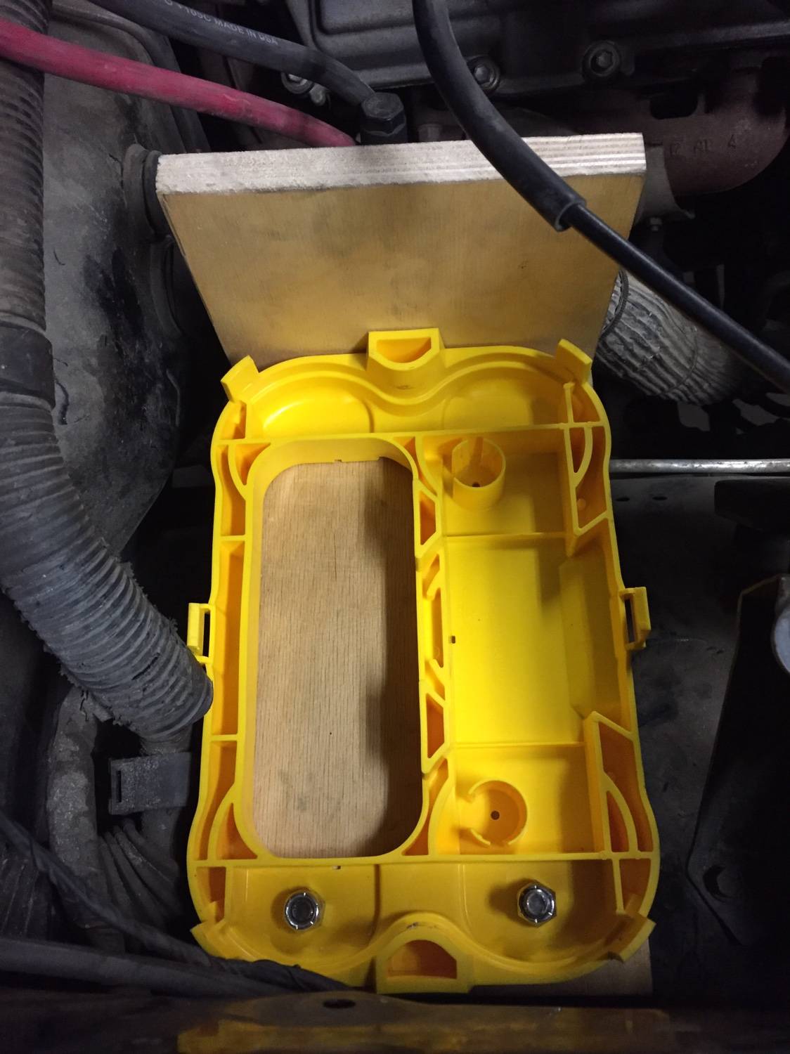

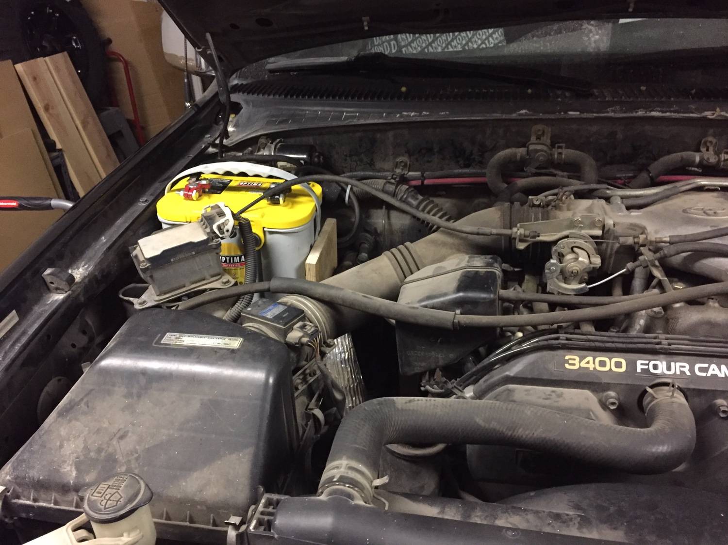

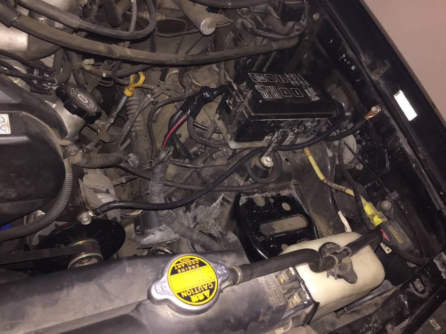

Decided to keep an agm under the hood so I can drive without having my Lithium hooked up. Had to move it to the other side of the engine since the triple alt bracket and factory fuse panel are where the stock battery used to fit. More to come!
