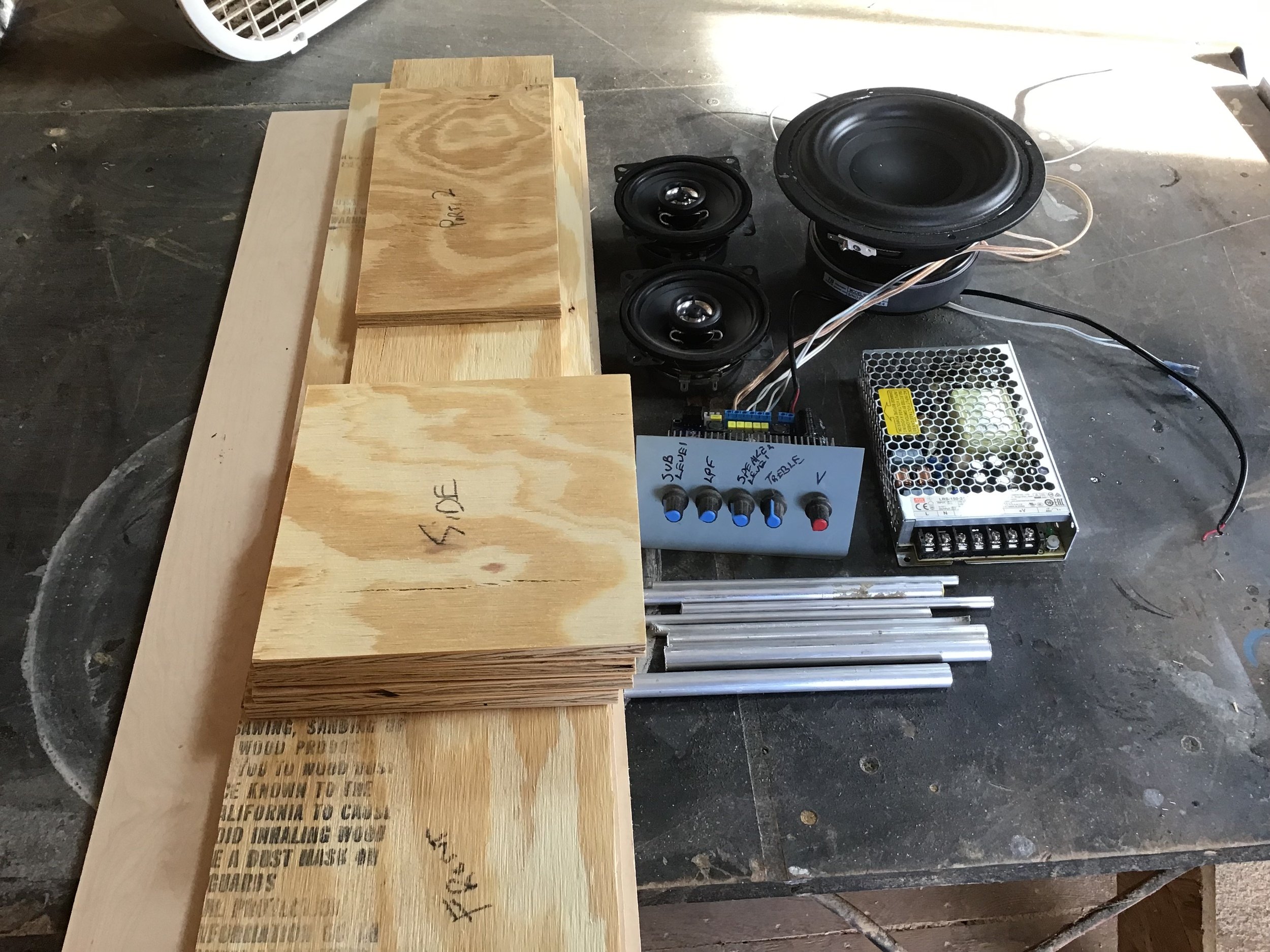

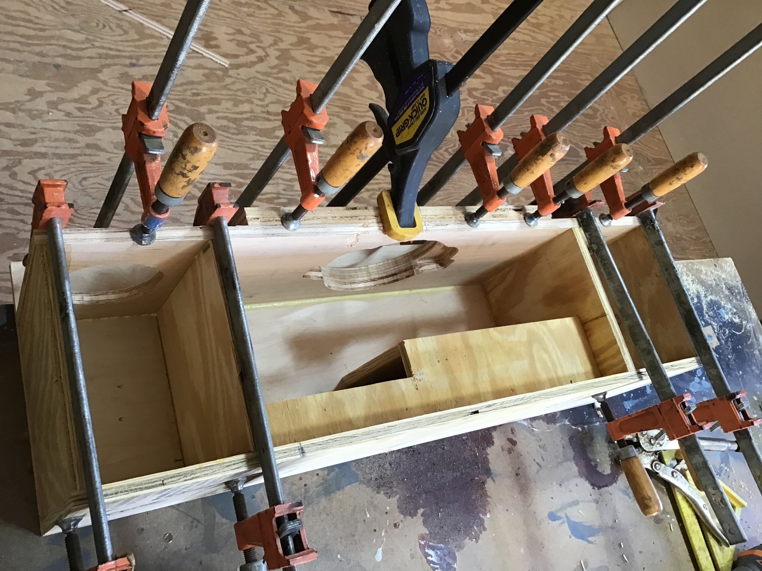

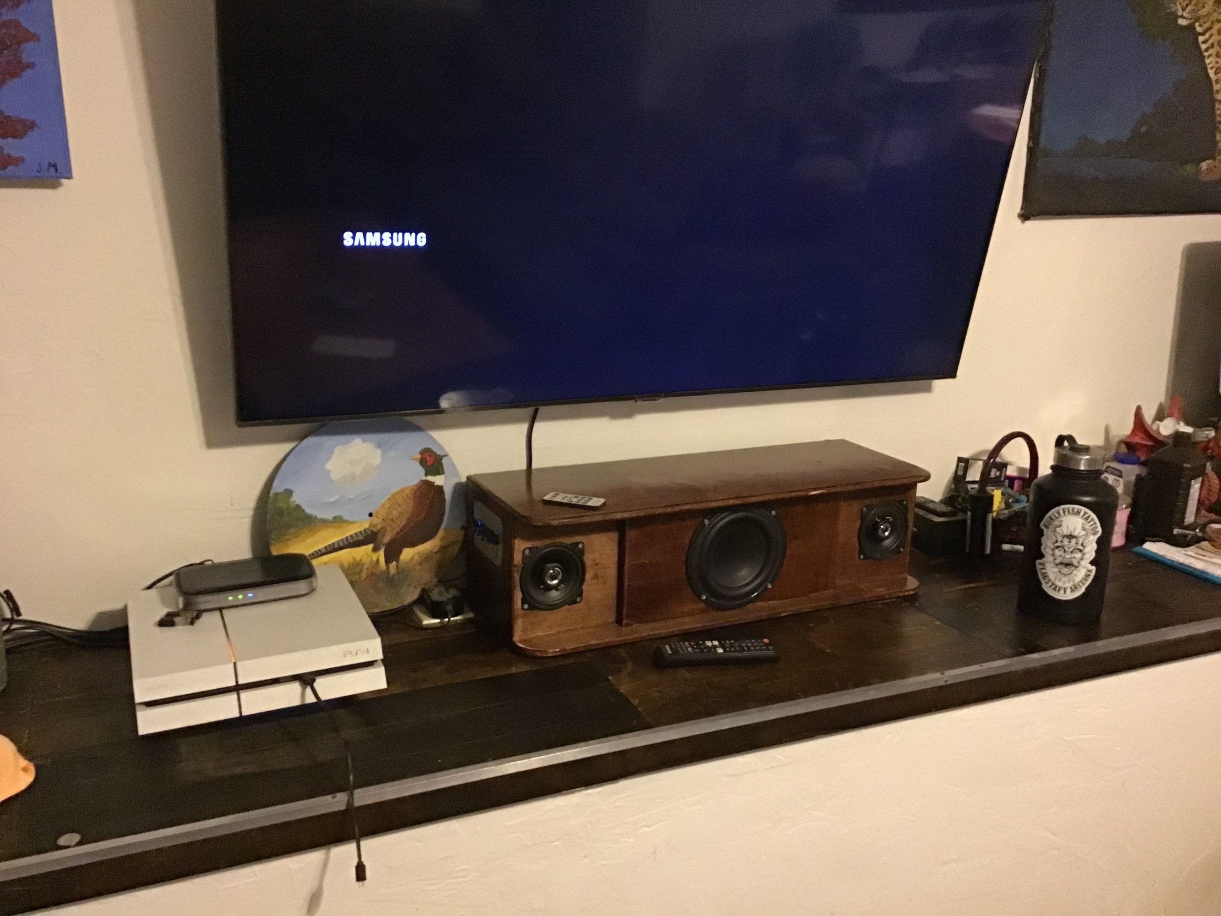

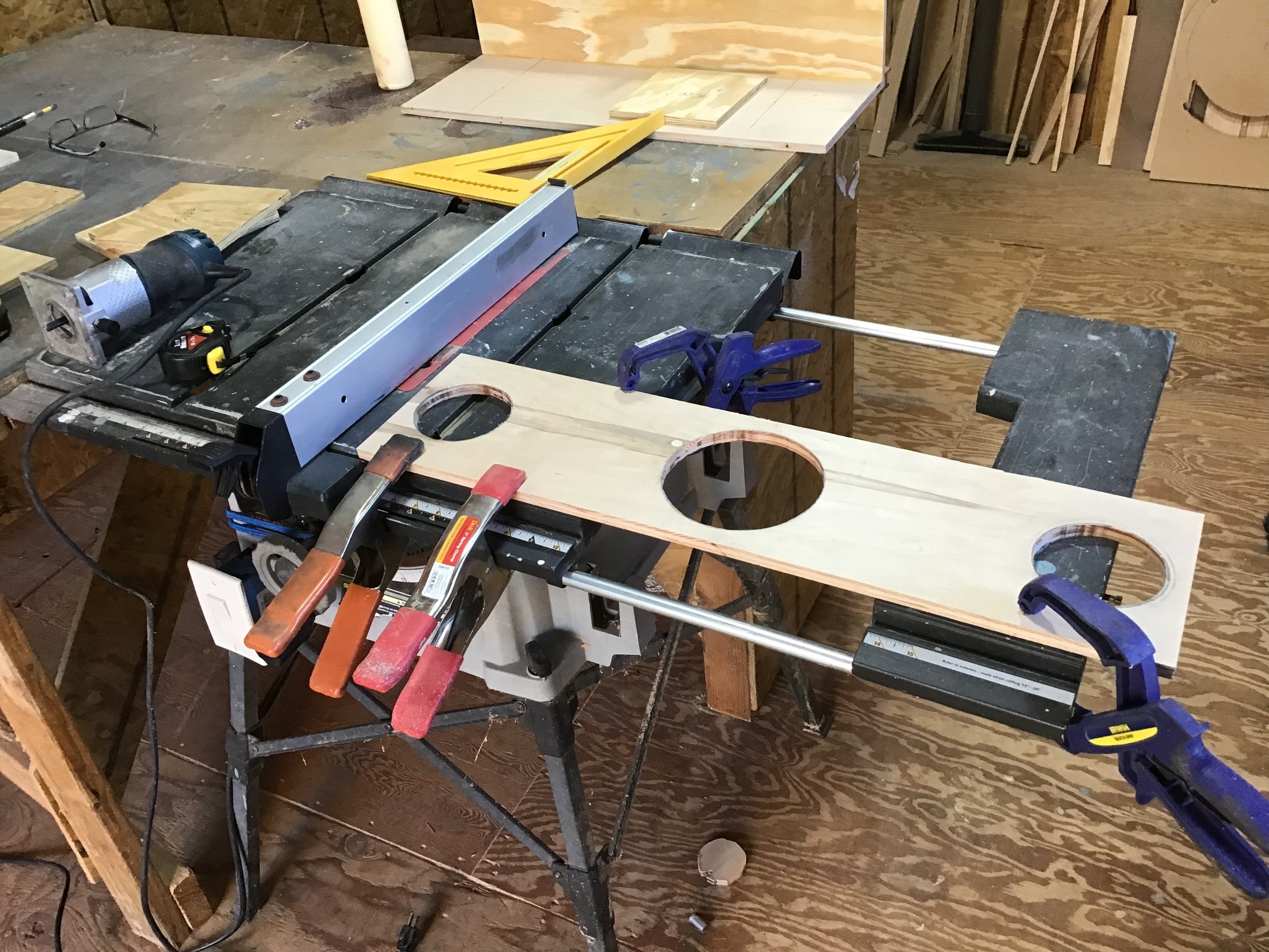

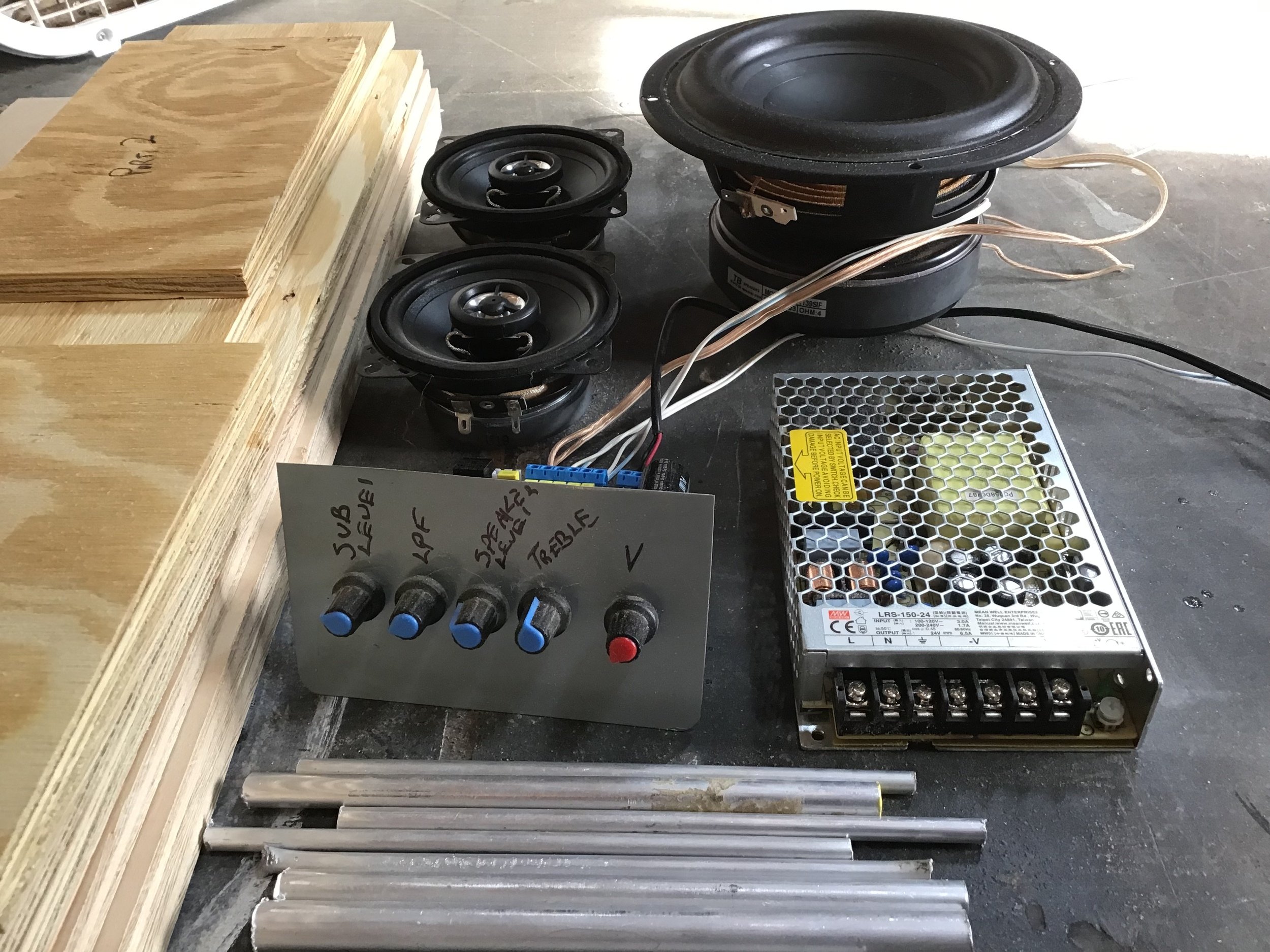

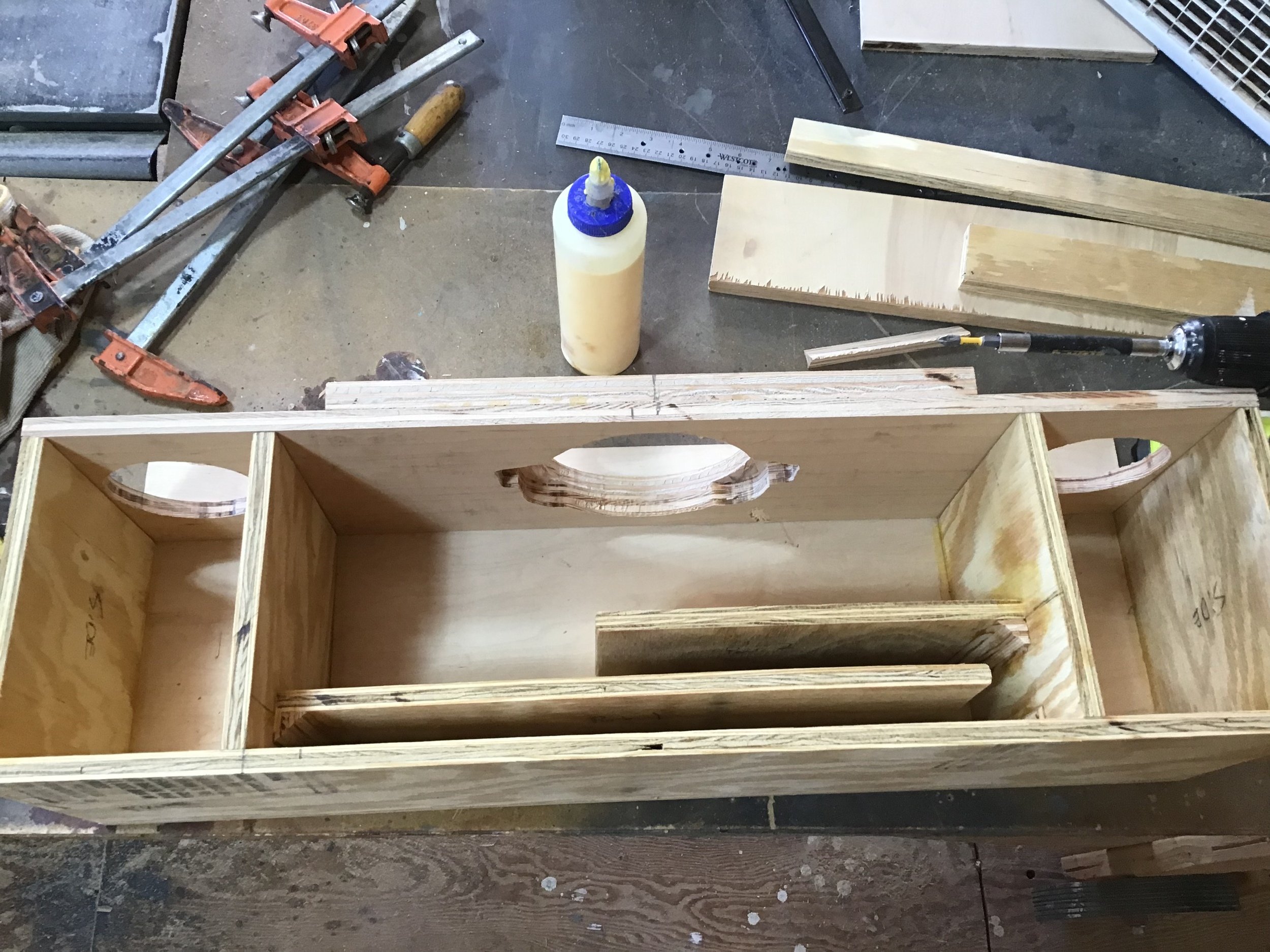

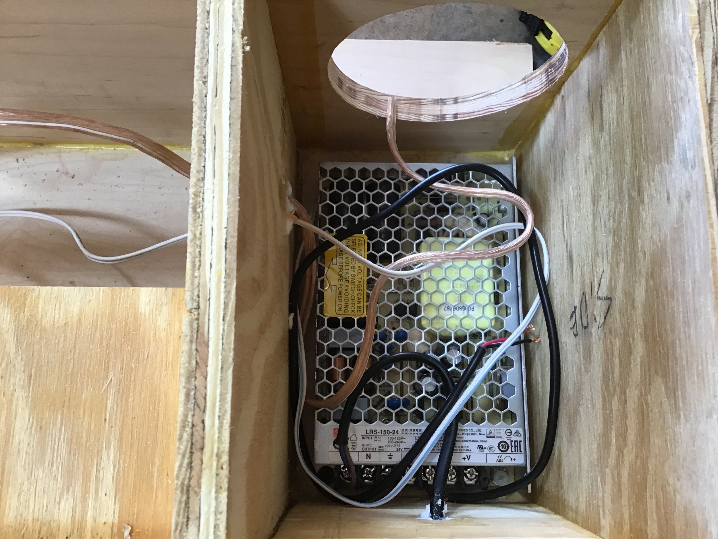

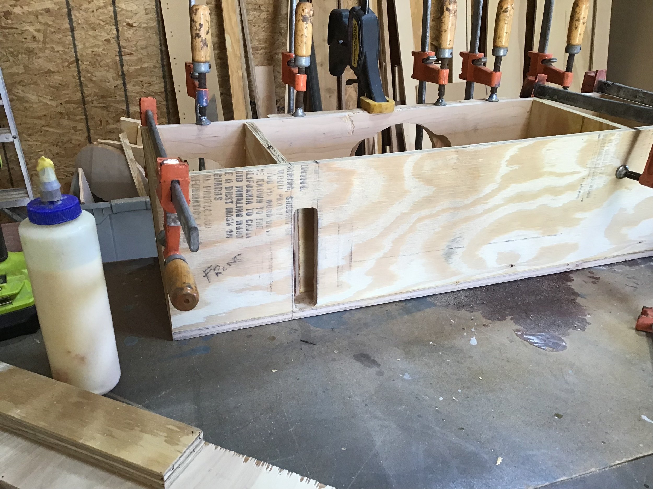

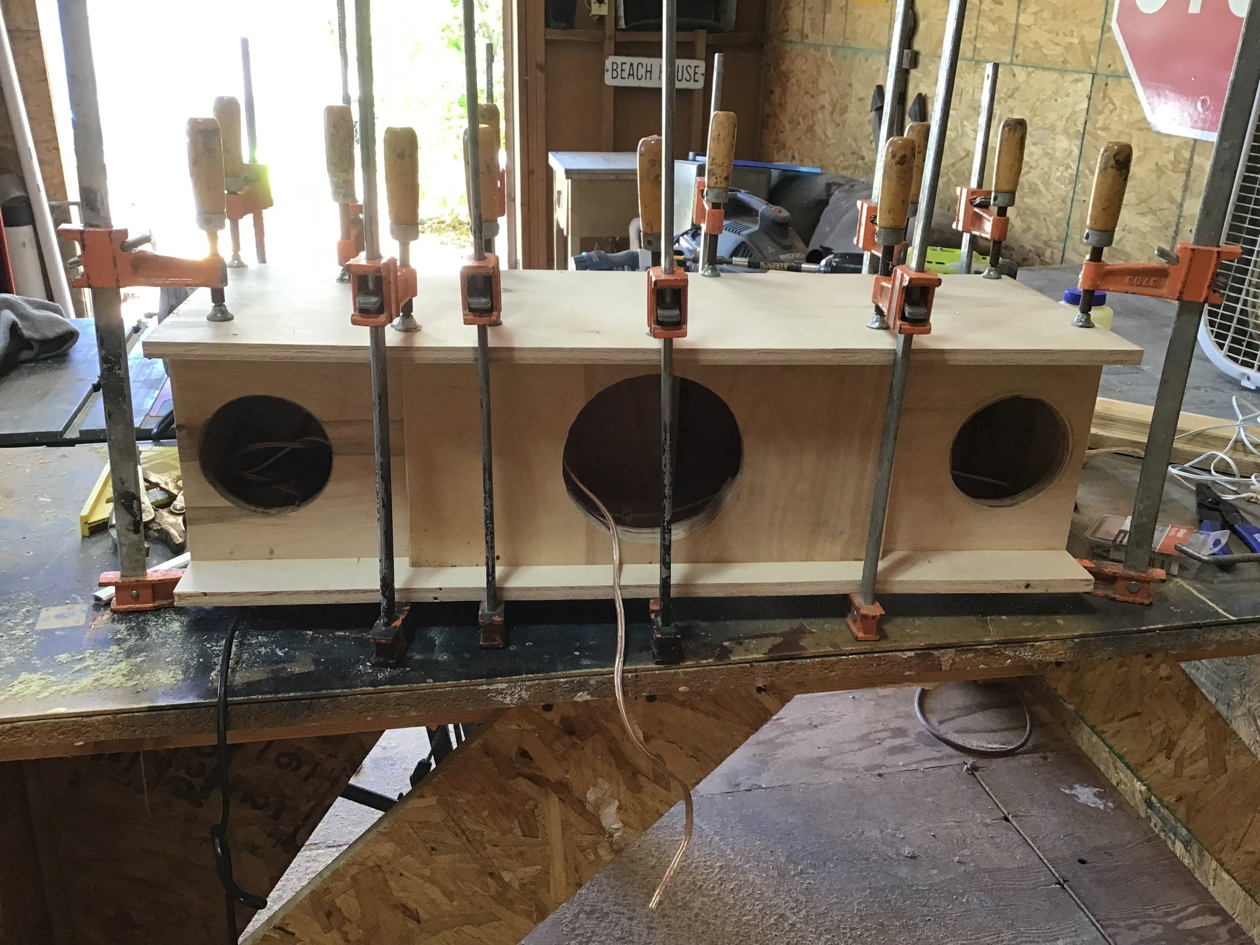

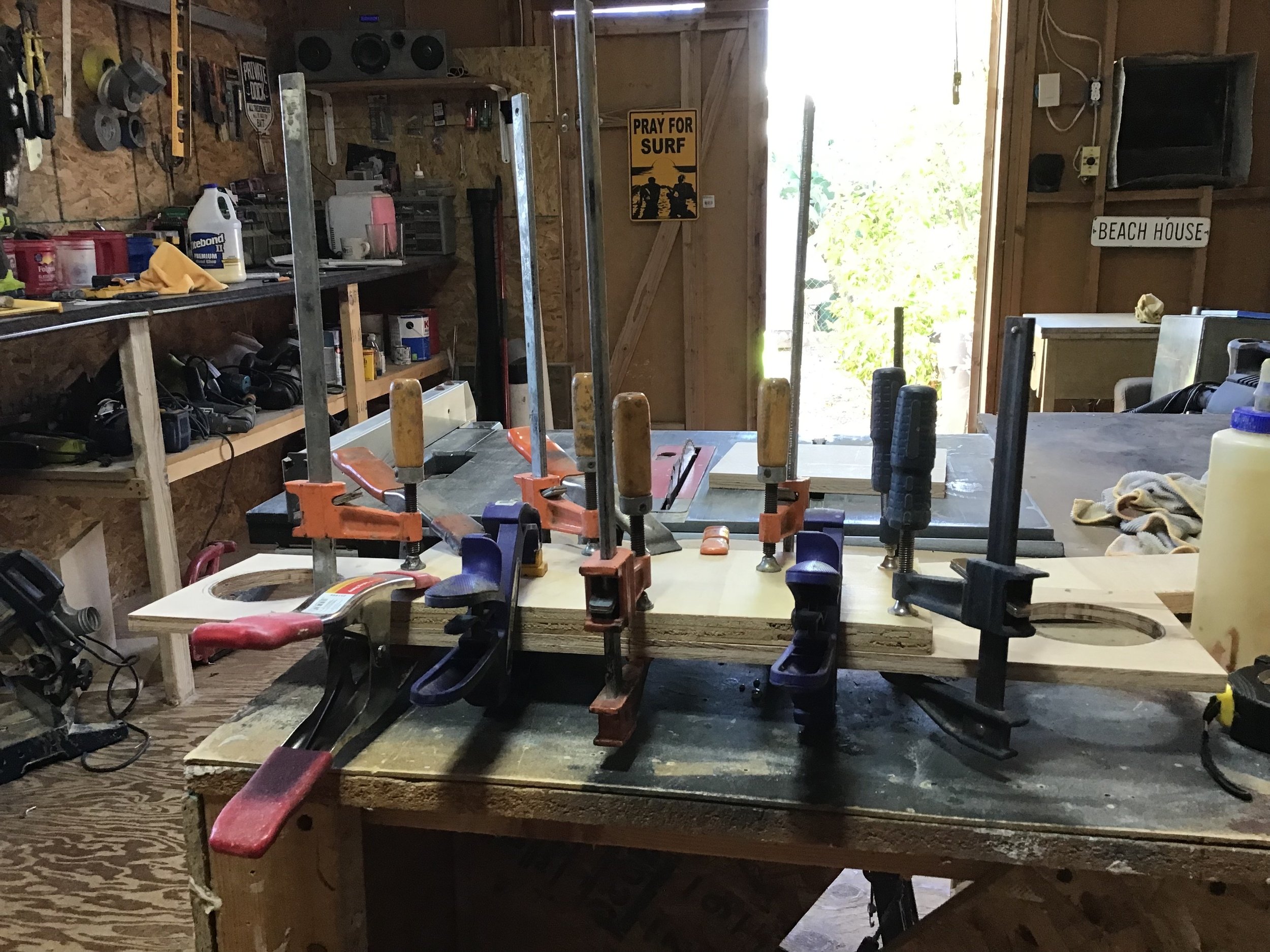

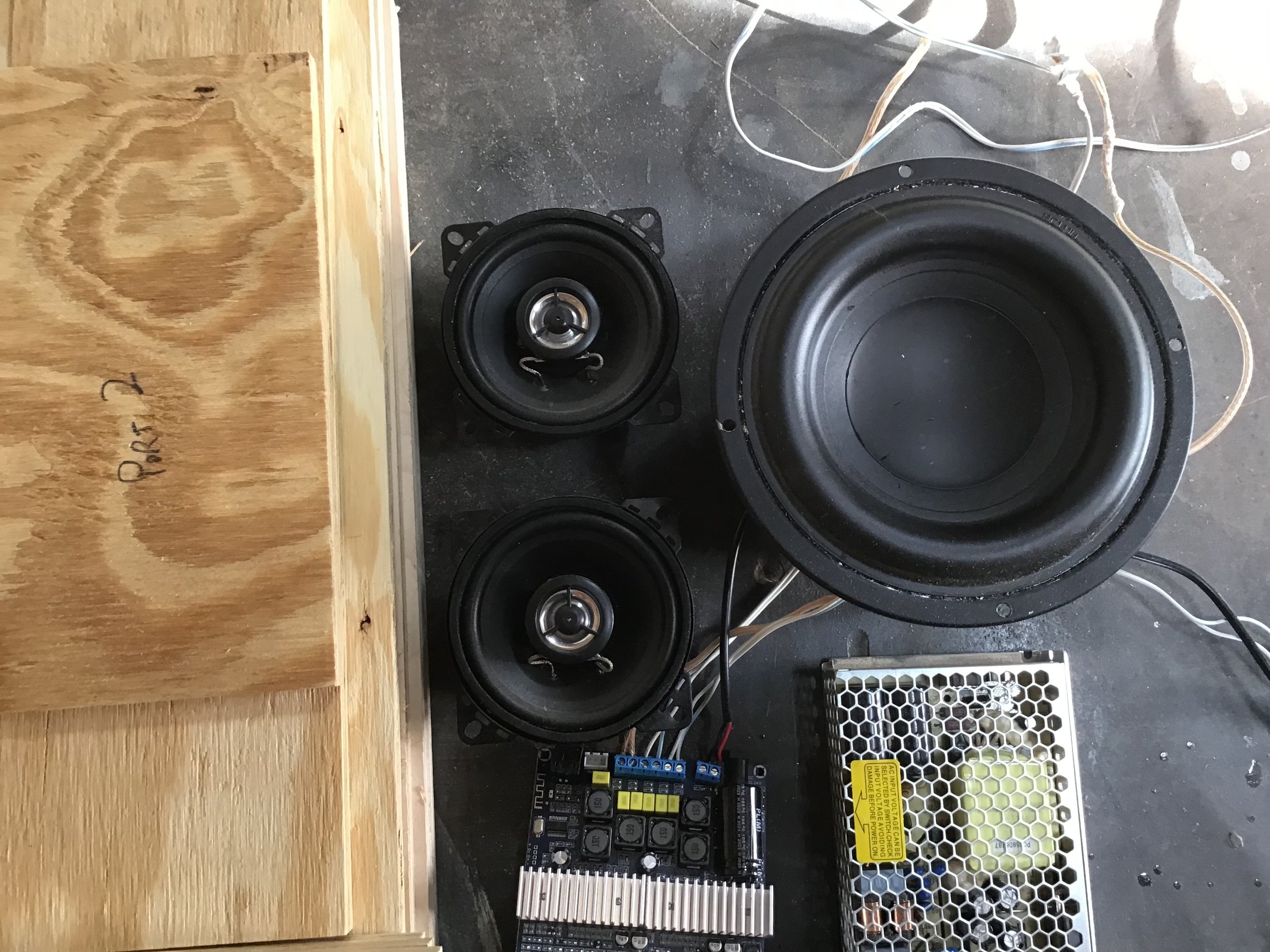

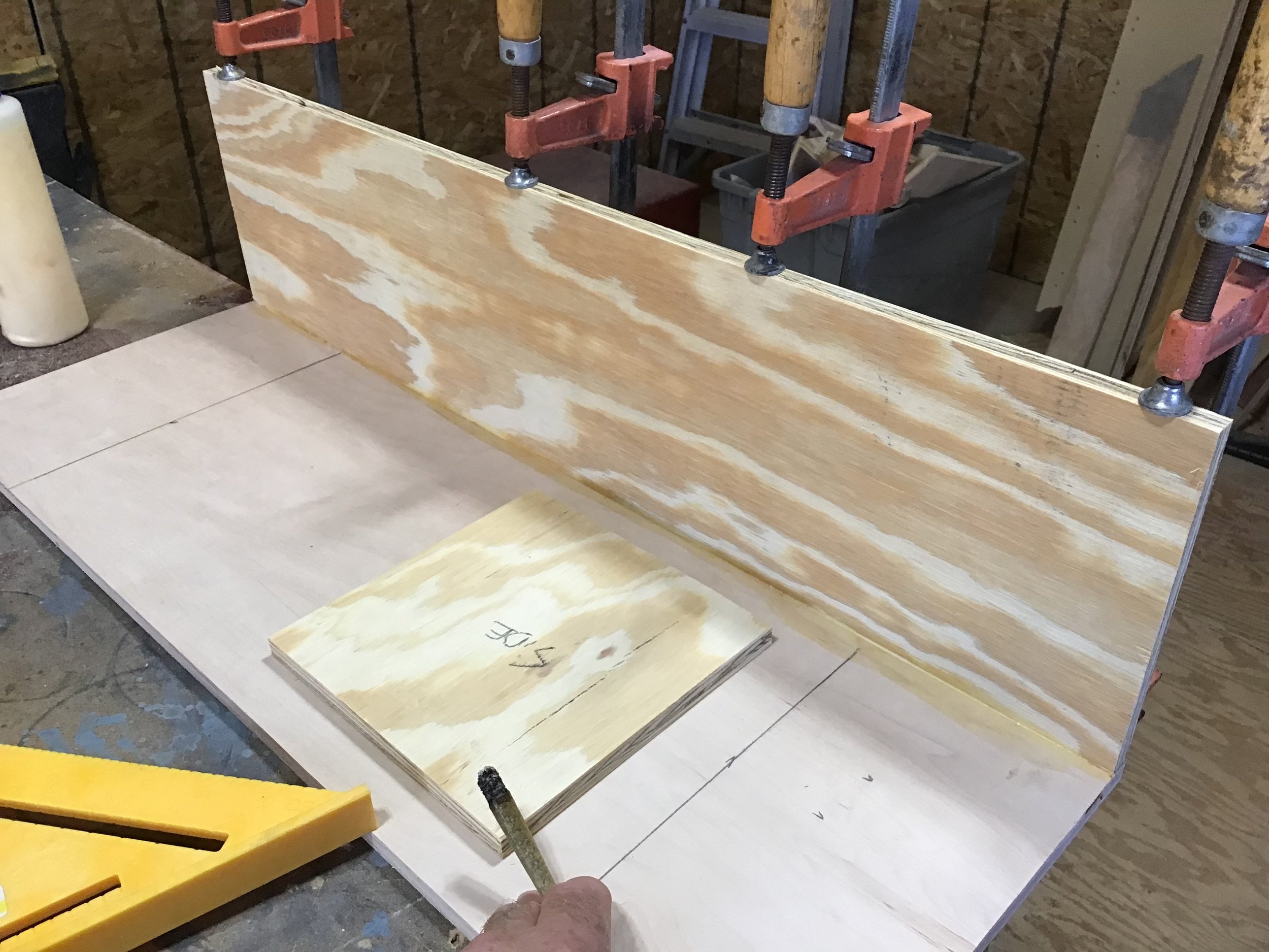

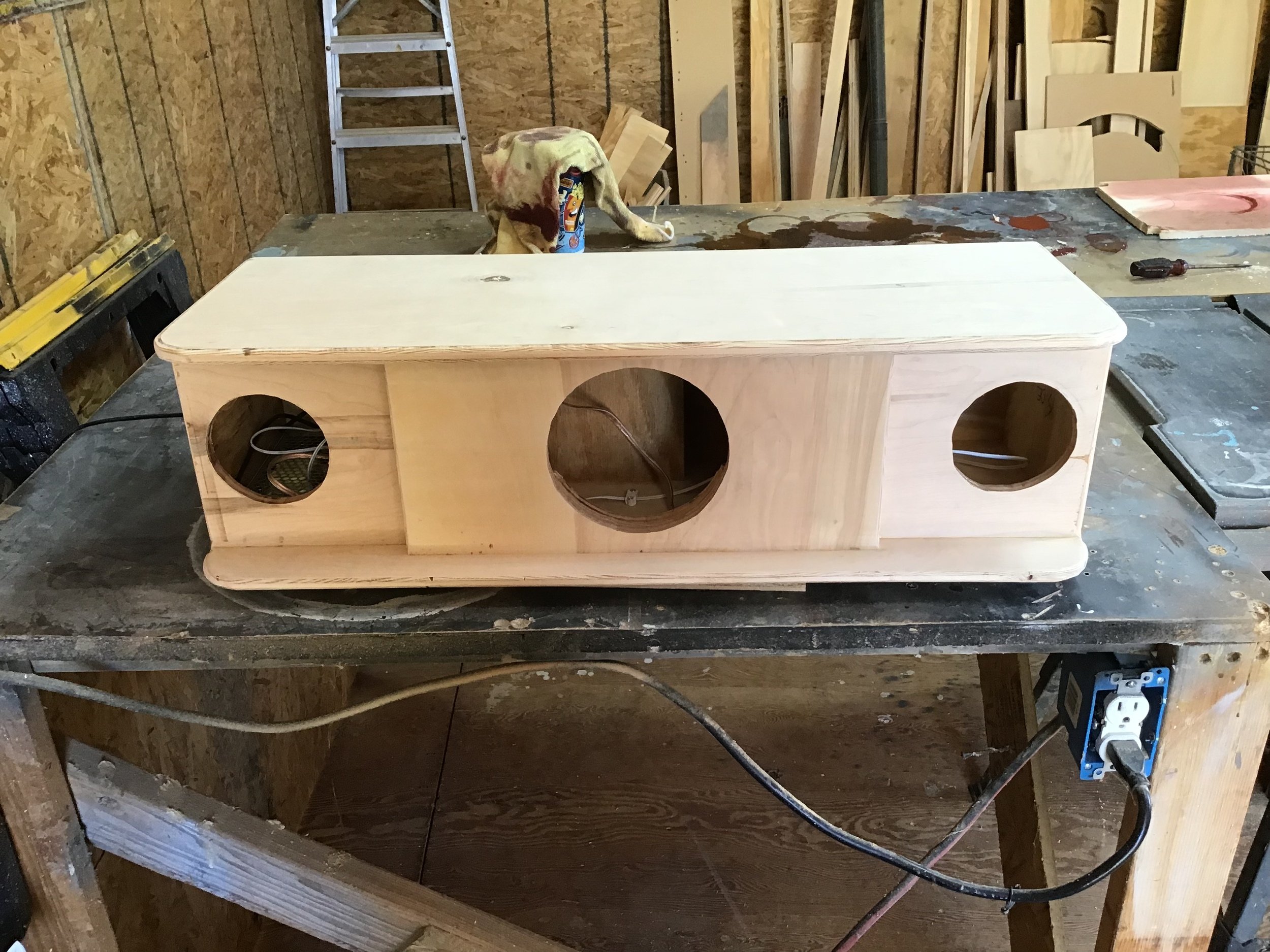

i liked the other one so much I decided to make another for my TV/video game room. 1 tang band 6.5 inch sub ported. .35 cubes tuned to 38 HZ. 2 Viston 4 inch coaxials. Subwoofer is low pass crossed at 150HZ. Coaxials high pass crossed at 150 Hz. Power supply is 24 volts 6.5 amps. Amplifier is a 2.1 channel 50 watts rms x1 for the sub. 25 watts rms x 2 for the coaxials. Amplifier has adjustments for low pass filter, sub level control, speaker level control, treble attenuation and master volume. Will also be adding rca connections for accessories. Using 1/2 inch scrap wood from the trash bin.
Also using various diameter aluminum rod from the scrap bin for the protection grill. 2 1/2 inch. 2 3/8 inch and 4 1/4 inch bars. All cut to 7 inches because that was the longest one in the trash. Times are going to get rough. Trash is useful.
View attachment 39058View attachment 39059View attachment 39060

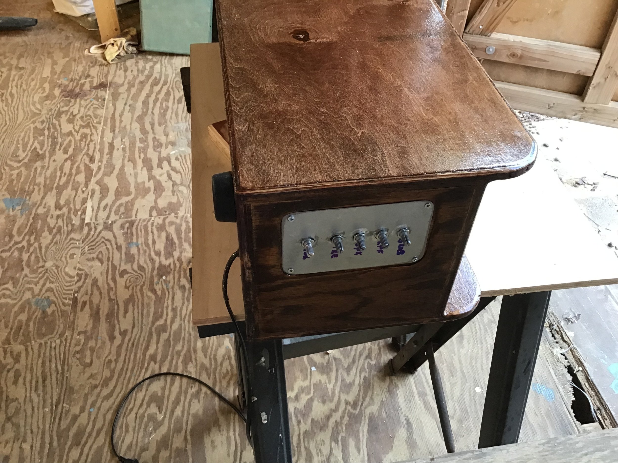

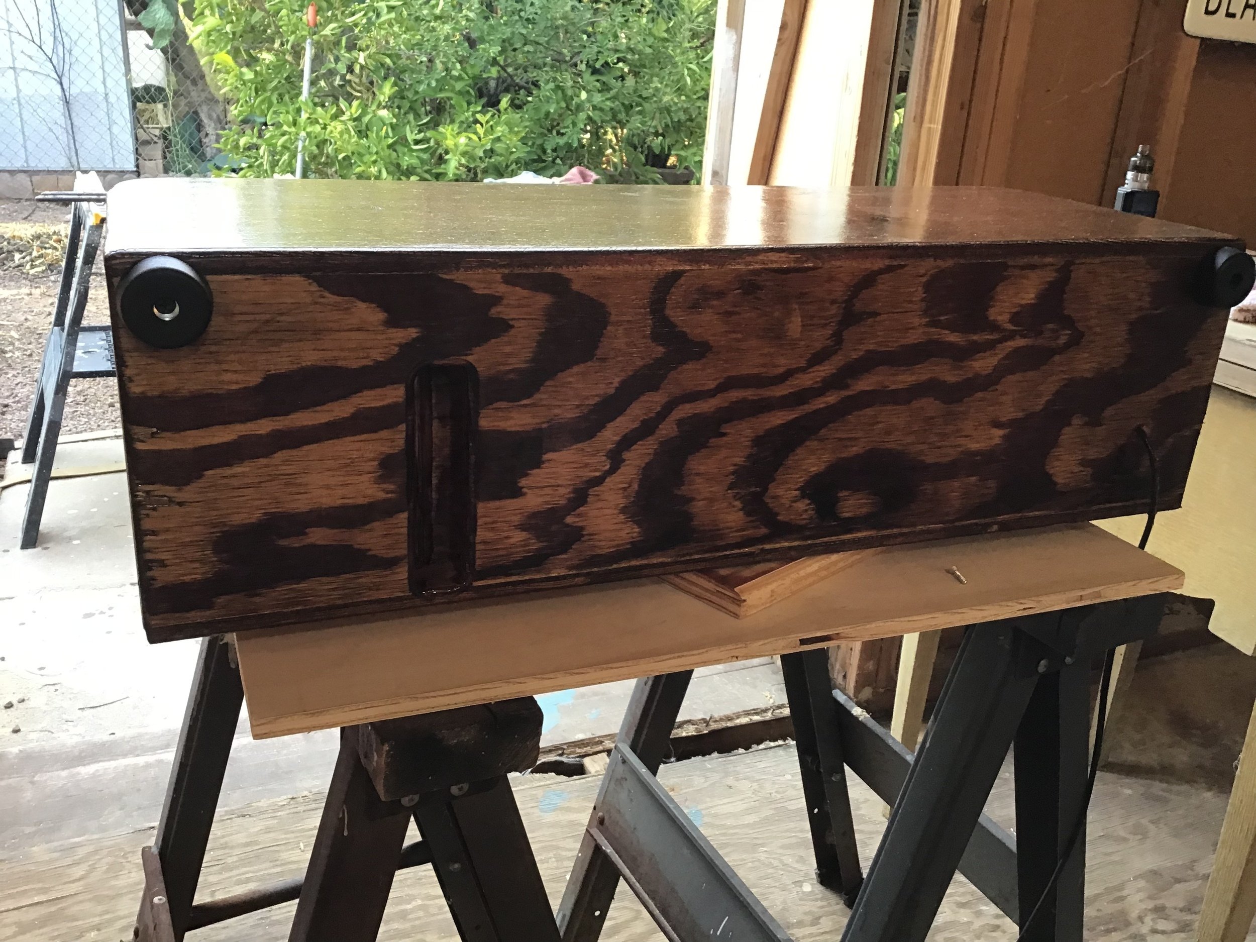

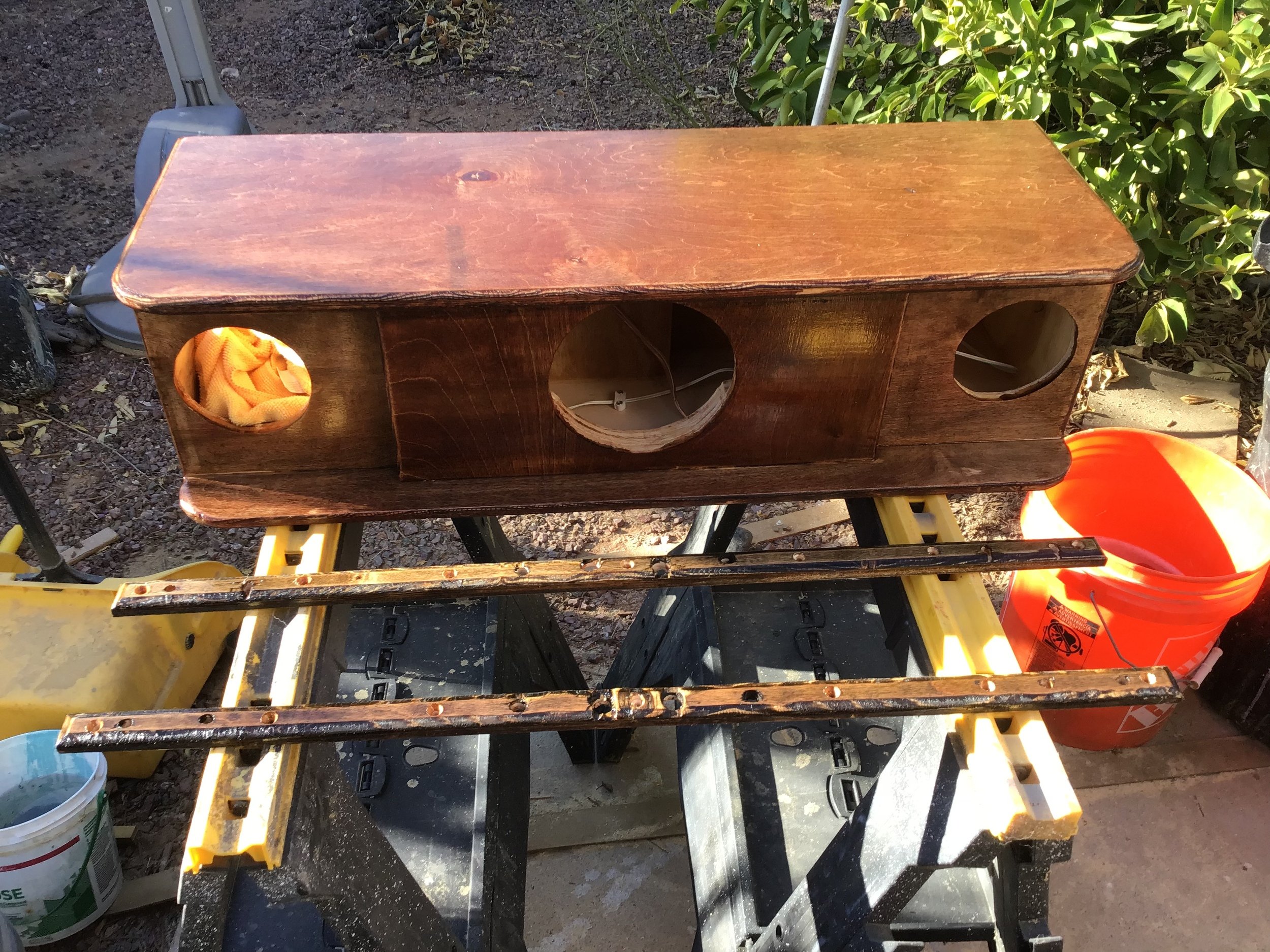

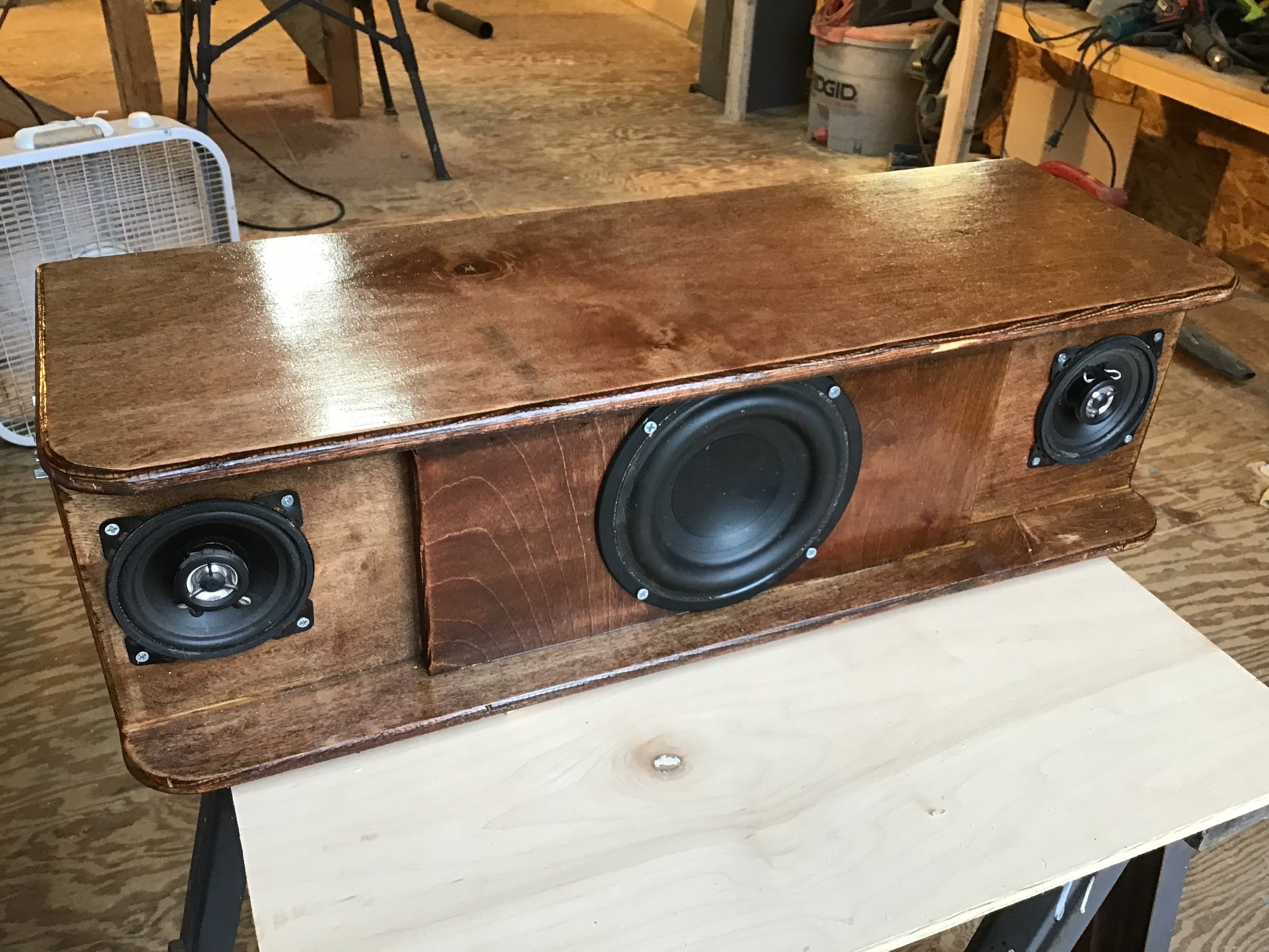

Sounds very nice. The front firing port style I had was a little louder, but this one sounds better. Will finish the grill tomorrow. Plan didn’t work so I will buy the aluminum bars tomorrow.
