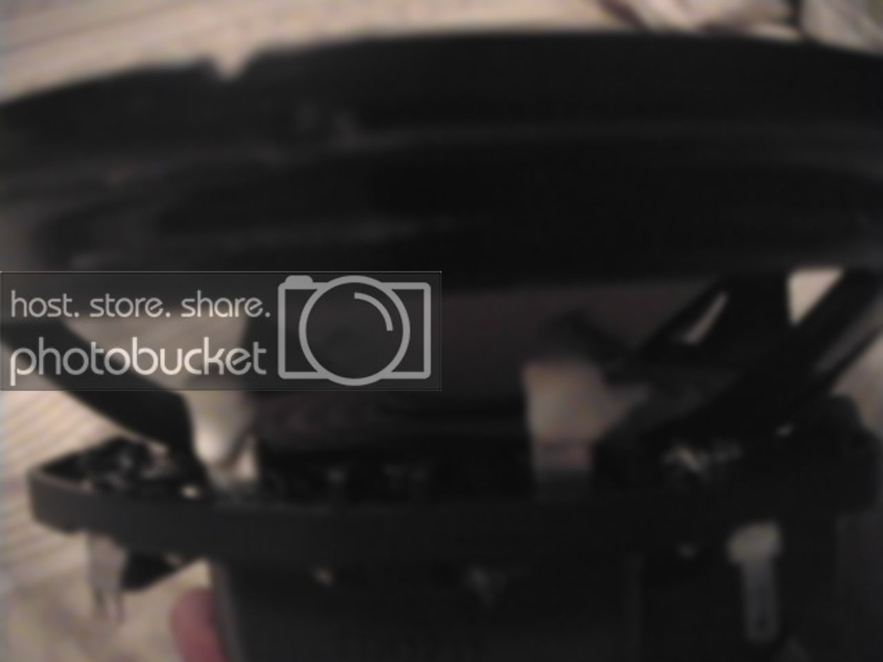

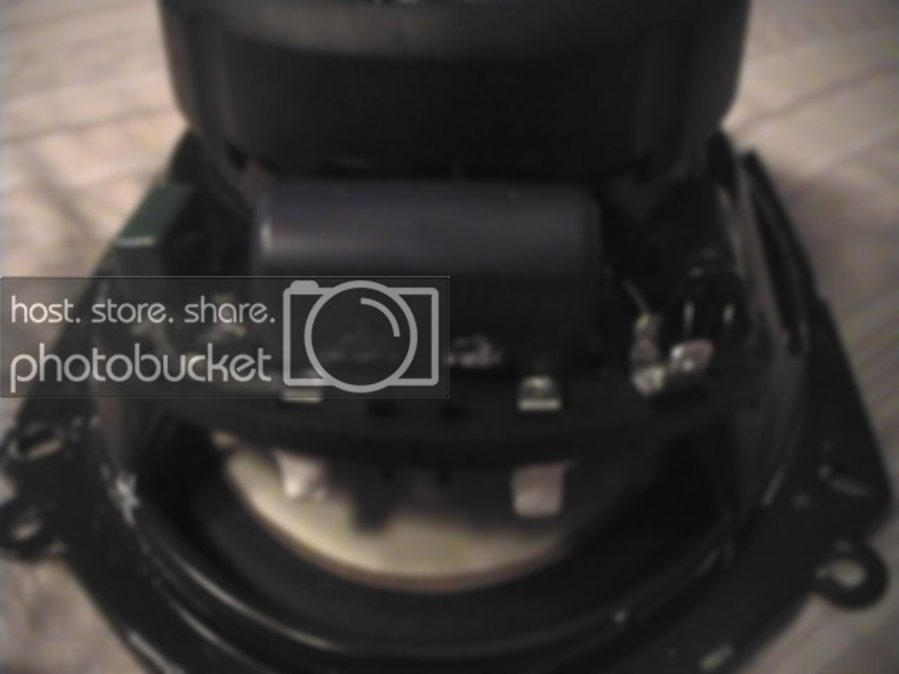

Blown woofer in coaxial?
can someone show me
Which pair of drivers is one not working. The slcs or the REVs? That is unclear.
Where you hook up the speaker wire is where you measure and you should get ~4 ohms.
If not:
Resistence is lower then 3 ohms (Actual resistence is going to be slightly off, so we say 3 to be safe):
- Could be a short. That could be in the voice coil of the woofer, or somewhere else.
Resistence is "nothing". if you get "OL"(overload) or "E"(error) you might have an open circuit. this means there is no path connection between the terminals. Maybe tinsel lead is disconnected. Maybe voice coil leads from tinsel leads got cut.
Hope thats helps a little bit.
