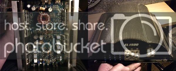

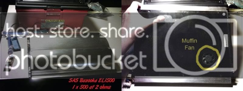

The bazooka EL series amps had problems with overheating but if you stick one of those $8 PC processor fans inside it and solder it to the remote on power lead, they'll run great forever. Ive bought 3 of them and done this mod.
the el1500's do last pretty good.
Thanks for validating that MrSector, most people see "bazooka" and weather they've ever owned one or not they down em. Nice to see other people have picked up on these el-cheapo bargin buys
