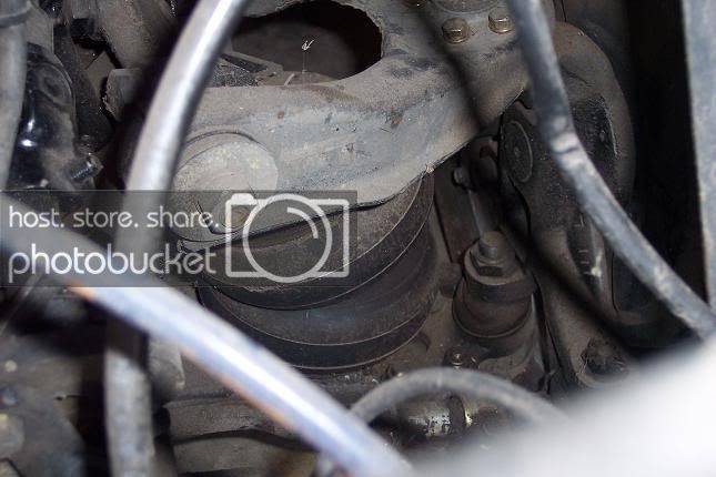

it will still get bagged but this deal came up and i couldnt say no to it. im going to bew cutting out the inner fender that is on it right now and raising it as far as it will go so i can fit begger wheels.

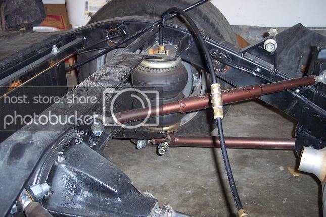

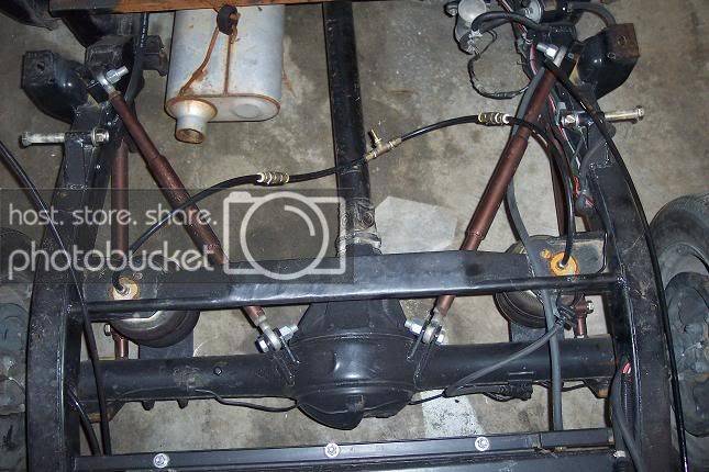

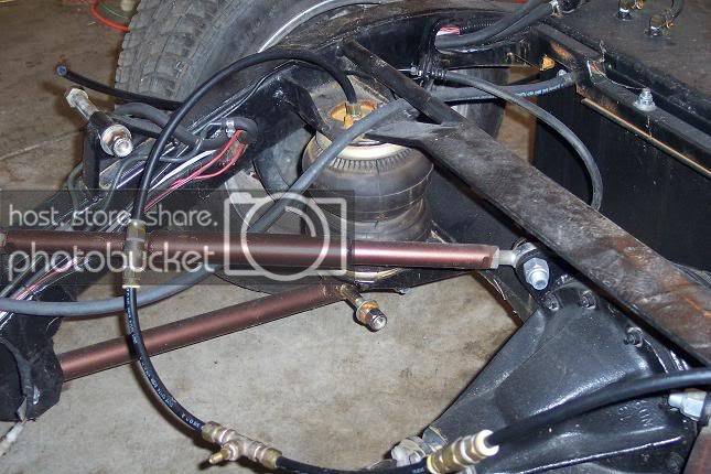

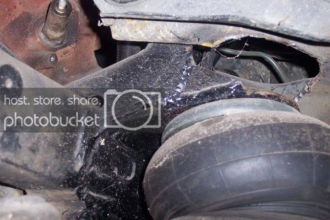

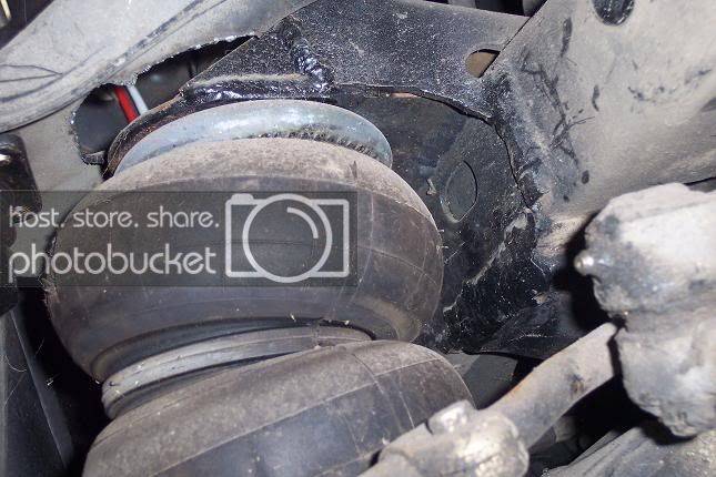

ok more pics of rear bagg setup

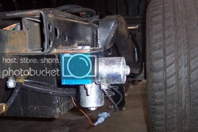

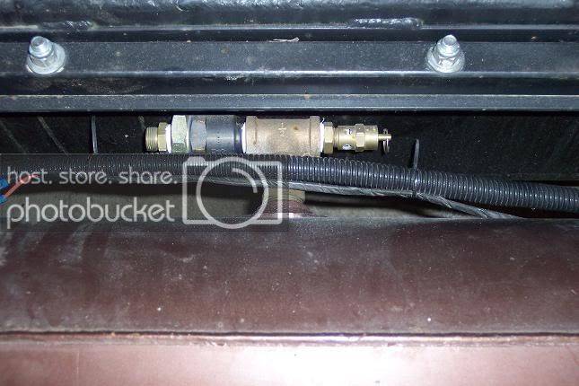

I dont see a compressor, where will you be mounting it ?
And nothing is connected to the tank, its just bare lines.
That thing isnt very high with the bags fully inflated, i would be a bit cautious of the front suspension hitting a speed bump even 45ing it.
C notching the rear doesnt seem like it would be beneficial, that truck isnt going to go any lower or higher by doing that.
I dont see a compressor, where will you be mounting it ?And nothing is connected to the tank, its just bare lines.
what do you know your from canada! canadians dont know cars they only know hockey!
J/p so heres how it will go
compressor will be mounted in the bed unless i can find an engine driven compressor that will fit under the hood.
ill be getting taller bags those are only 2500 baggs ill shoot for 2600-2800 baggs so it lifts up higher.
The c notch is so that it will aly out with bigger wheels on it. so technically it will be going lower. without the c notch and only a "Z"d frame i can only put 16" rims on it with the c notch i can go 18s
oh and nothing is hooked to the tank because the valves that are on it are someone elses they are coming of. so i have a t valve hooked to the bags so i can fill the bags form my craftsman compressor in my garage. but i have the air line there so when i get valves i can just hook them right up and not run any air line.
