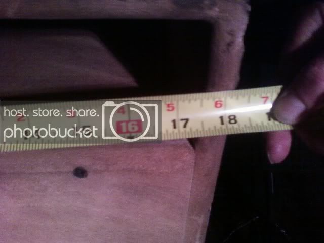

How can those ports be 18" long if they are basically the same length as the diameter of your 12" subs? At this point I dont trust your numbers to give any advice. Nothing personal, just saying find a tape measure.
well for one its 17.5 inches or i can read... its bigger then what u think...
heres a pic just to show its from the insides of the port -_-
Well Im still confused, because your video seemed to show the port approx the same length as the diameter of your speakers. Sorry if you consider this a flame, I just really dont see how things add up here. 12" speaker, 18" port. The video should clearly show a discrepancy in the size of these two objects. Am I seeing the enclosure wrong or what?
